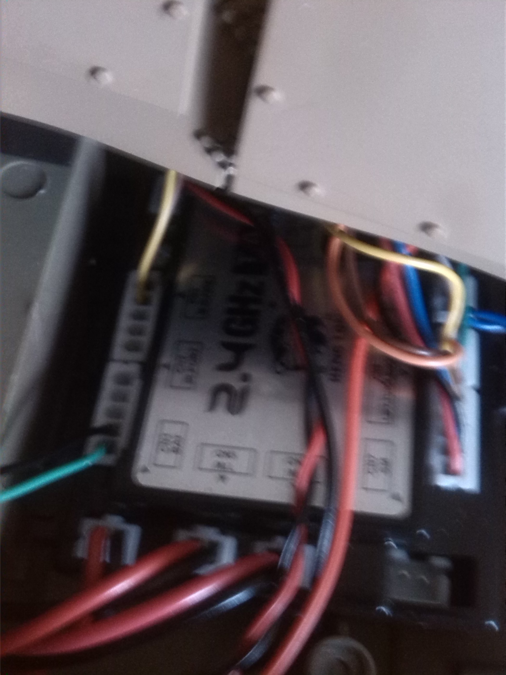

I'll bring a high intensity bulb on Sunday, don't bother buying one, they are about a £1 per million from China.
The strange thing is that the new RX18 is identical to the old one, same sockets, same wiring, same everything, including the IR sockets. This makes me wonder whether they are retaining the board layout because they have a new IR system under development? Pure guesswork on my part.
Using the IR plug to power the muzzle flash gives a fast double flash, but it will do for now.
I had a couple of spare 5 pin plugs so I am using those, but you can see where the muzzle flash wires go. The green is positive and the black is negative, green is the end pin.

Thanks for that. I have a number of both 5 & 2 pin plugs that John got from Clark's for me.

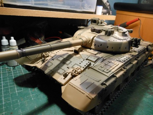

The best advice I can give you is to assemble the brackets on the rear bin carefully, and triple check the mounts are around the right way for the storage tube that attaches to it. Don't glue the bin to the turret whatever you do, or you will never be able to take the turret apart.
I found a perfect invisible match to the green paint, and that is Vallejo US Dark green 70.893.
Having seen a few pics of real T90's I am tempted to paint the whole tank in this colour.
