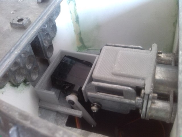

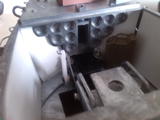

Cooler still, Mato stuck the elevation servo at the back of the turret with the arm sticking skywards, and then secured it by sawing off the moulded servo mounts and using two screws/locknuts. It looked pretty messy.
I removed the screws/locknuts, took the arm off the servo and pointed it downwards, and then re-attached it with the barrel level. I will need to adjust this once I have it hooked up to a board, as it will self centre.
I am now making a housing for the servo with a lid on it, and will find some way of clamping it all to the turret floor. I won't be using the elevation anyway, but at least everything will now be out of sight, and there will be no sign that there are two servo's in the turret.

There we go, a nice clean inside to a Mato M36 turret. Will do some shell casings after I have figured out how to nail the servo down.
