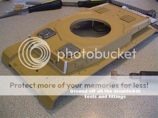

The Heng Long moulded tools had to go of course so I dremelled (is there such a verb?) those off, together with the wrongly positioned air vents on the transmission hatches. I'll replace the tools with metal ones later. I think I'll make new air vents with milliput after I've zimmed the hull. Dremmeling away the tools also ruined the (inaccurate) treadplates on the tinwork so I glued tread-patterned plasticard along each side, covering the HL original pattern.

Cut out the driver and co-driver hatches and replaced with functioning metal ones.

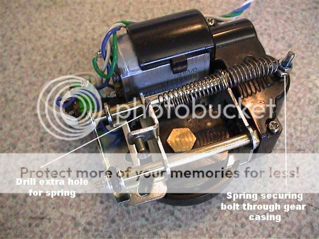

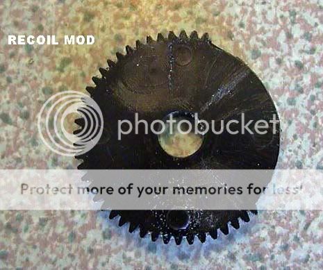

Everything screwed together OK so I pulled it all apart again (as you do!). This time to have a go at Glory71's snap-recoil mod. I must admit it works a treat and looks great (many thanks for that tip Jon!).
You can watch a video-clip of his recoil mod here:-
http://www.youtube.com/watch?v=qbDw9L4mU9s" onclick="window.open(this.href);return false;
I needed to grind off a few more teeth than Jon recommends though as you can see from the oppropriate pic. I think that might be because I used the shallower recoil unit (smaller cog).
