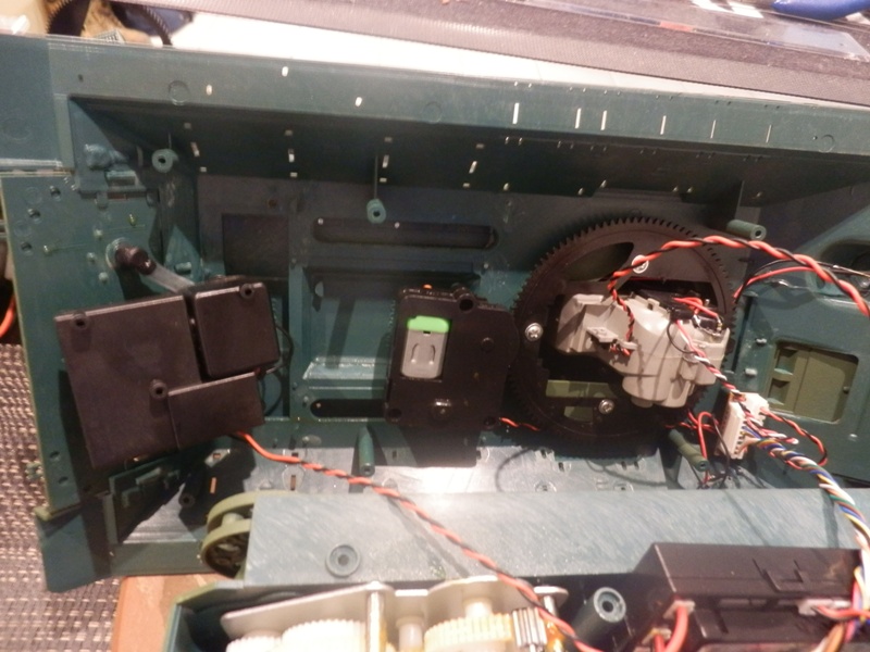

Ive been doing a bit of googling on the suspension height for these '85's & the H/L version sits too high(as everyone mentions) but just what is the right height ?
Most opinion is that the model needs 3mm or 1/8th" inserting into the curved slot that the suspension arm travels in, but this would only equate to 48mm on a real tank.................. :S :S
Just doesn't seem enough.
To only drop a real tank by 48mm, or if one was riding high by 48mm, I cant see it making a big difference.
If I wanted the actual dimensions of a Tiger 1 = no problem, but a T34/85 = not so much detailed info.
I will try the 3mm when I can & see how it looks.
Some period pictures show the arms sitting at 90deg to the hull, and an H/L would need a lot more spacer in the groove to make the arms sit at 90deg than 3mm. This is loaded and perhaps on a slope.
From what I can see in my minds eye from mucking around before I left, it would need at least a third of the groove filled, say 6mm(1/4") ? (I rang the Mrs today to ask how long the suspension arm slots were !=20mm vertical)

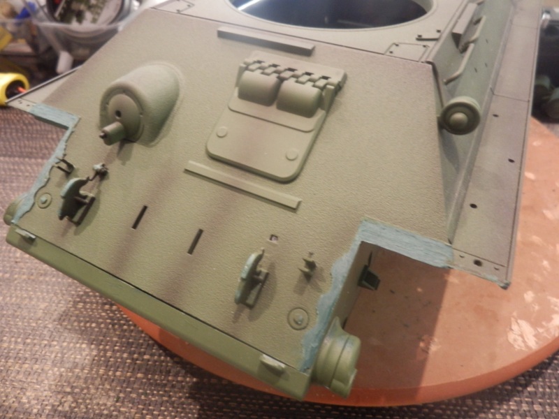

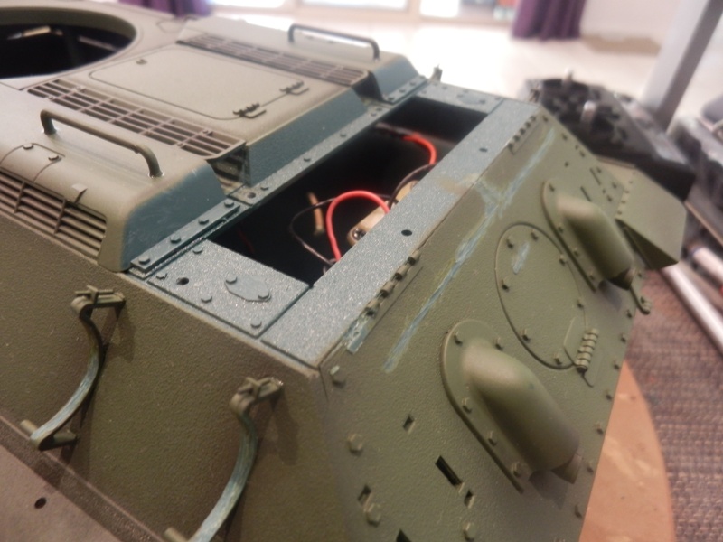

Removed the mudguard sections on the front & mowed off the remnants down to just proud of the armour.

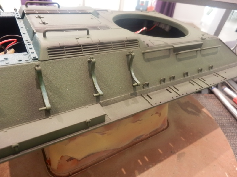

Ground the auxiliary fuel tank locating tags out of the mounting frames & fitted them all. As the bedspring screen will be obstructed by the tanks, these will not be fitted, but the mount bases will remain.

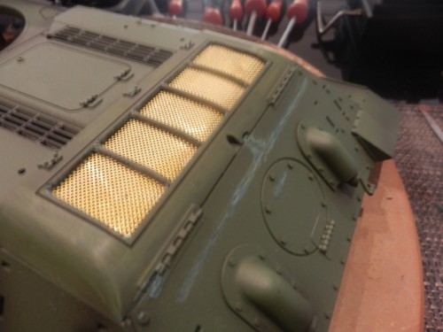

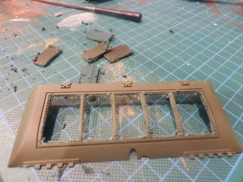

Hacked the moulded mesh out of the rear engine cover, dressed the inside & secured the P/E mesh. Added a bit of wear & tear.
It was pretty easy to get off, but the hinges are proving A BIT of a pain.
Also removed the moulded lines to the smoke fluid drums on the rear, as well as the moulded handle on the trans cover.
Added all the kit tow hooks, handles and lashing rings, which I maust say went on really well.
There sure are a lot of factory holes in these T34/85's so makes smart to use the bits for the holes where possible. :eh:

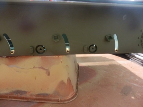

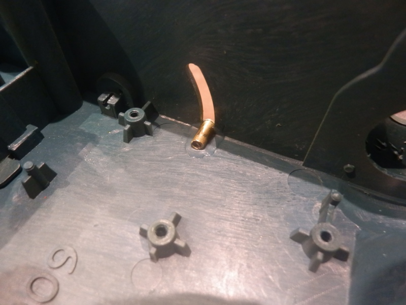

Got the suspension spacer/lowering devices cut & placed. 3mm tube used & held in place with epoxy.
