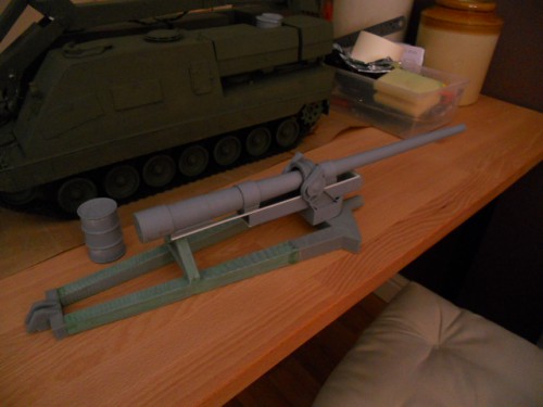

Currently doing the undercarriage, which I have had to split into four sections to fit onto the print bed, but yesterday I did the recoil blocks and fitted them. Amazingly they slot into the recoil bed and the whole barrel/blocks assembly slides back and forth. Bit of a shame that the gun will be built in transport mode, so the barrel will be locked down in the rearward position.

Did the chassis today, redid the front tow hitch to both shorten the length and beef it up a bit so that nothing snaps off when towing. It is now in three sections all made as solid as can be with plastic weld. Woz was right, that stuff works perfectly on PLA plastic, it's as if it is all one solid object. Any fine detail will be done with styrene as there is a limit to what it is worth doing with the printer.
Next task is the front bogey, it's quite simple to do, but the wheels and tyres are a challenge. I could print wheels, but would never find tyres to fit, so I may as well find some Lego wheels and tyres, and design inserts to make them look the part. I can also print wheel adaptors so that they will go straight onto a steel rod.
I am getting to grips with Openscad now, it took a while, but it was worth it.

Fantastic work Rob, it's almost magical watching this come together. The part about printing bits to marry technics wheels to metal spindles sounds like modern alchemy! Watching not just with interest but total amazement. This is one of my sources of big technics wheels

Ooooh brilliant find Rob - this would have saved me enormous problems on the bedford build. On your long tom build though you could use technics axles to save the adapters, I did on the 5.5 inch howitzer. If you pm me what you need I may have some I can send you. Alwyn
