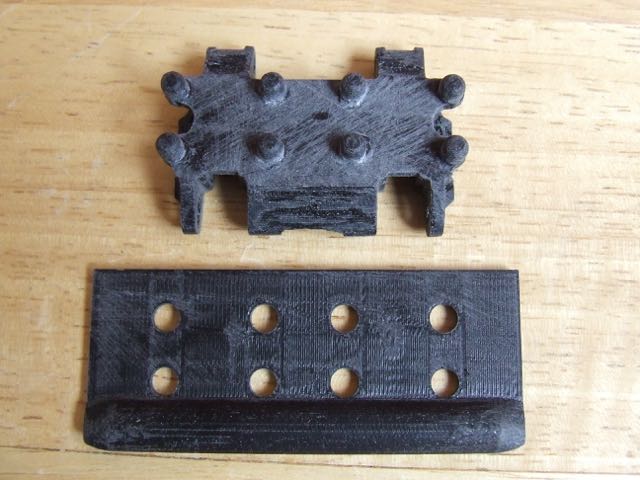

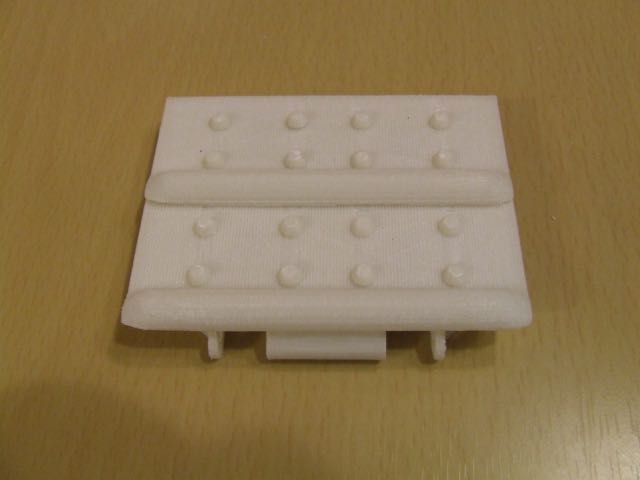

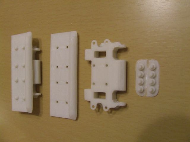

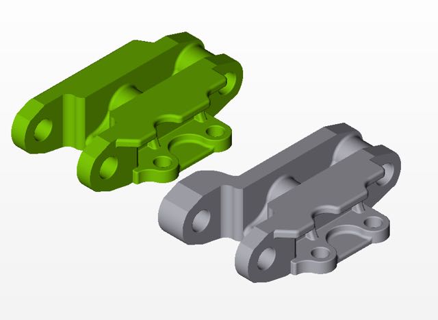

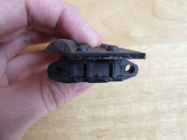

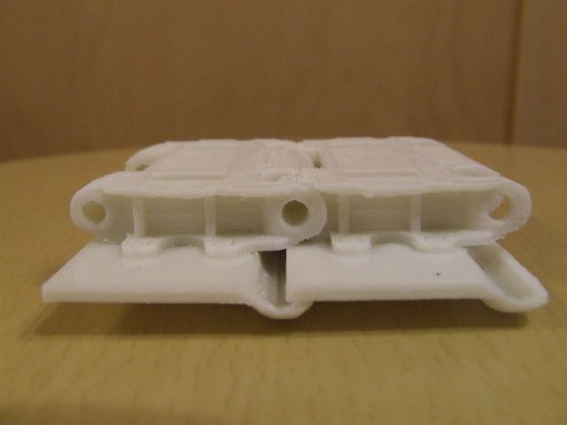

One of the major factors in my being able to build my First World War Tank, was first finding a Laser Cutting Firm that would put up with me, then my Brother purchasing a MakerBot 3D Printer. The Printer has been invaluable in enabling me to make parts I would simply not been able to left to my own abilities. It has also given me the confidence to 'Have a Go' and print parts off multiple times, tweaking the design each time as I go.
Two years ago I only used my CAD Program for 2D Drawings, now I don't even give it a thought about having a go at making parts in 3D. It is simply a case of picking a program and being prepared to take the time to get comfortable with whatever program you go for.
As has been pointed out, one of the issues with printing is often deciding how to break the object into a printable final product. Again this is often just a case of trial and error. After a while you get to a point were it just becomes second nature to how a part is going to need to be printed.
I have attached some photos of the Track for my 1/6 Scale Tank that show just how many changes I went through and the different ways of approaching the same subject.
In the case of my Tack Links, after finally getting the design to a point were I was happy i then had the part Powder Printed (The Blue Link) by an Online Firm before getting it cast in aluminium.
Helen x

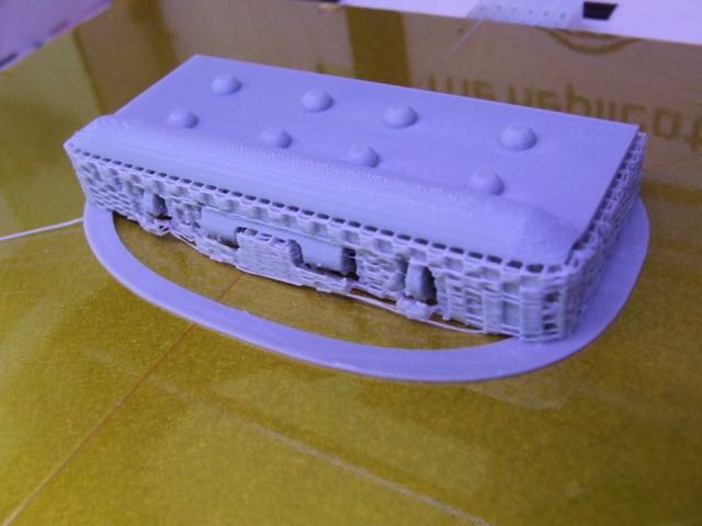

I decided to have a go at printing one of the 1/200 tanks out (this is it minus the supports but before any clean up.) It's 30mm long.
This was done at quite a fast speed at 0.1mm* layers (with a 0.4mm nozzle) and I think it's not bad considering I haven't set up my printer for fine detail. Someone managed to get my model of printer to print 0.02mm layers and with a 0.2mm nozzle the level of detail that that can already be achieved is incredible (if you're prepared to spend a bit of time calibrating it all up).
The only down side is the amount of time printing takes. The Cromwell in the pic took 40 mins to print. At 0.02mm it'd take about 5 times that, so 3hrs 40. Add a 0.2mm nozzle you're looking at 7hrs and remember that I printed it at a fast speed (60mm/s) for detail you need to drop it down to about 20mm/s so now you're looking at around 21 hours for a super detailed 1/200 scale tank. The more expensive SLA printers take just as long.
Mind you once it starts printing you can be doing other things (designing the next part) and you can print out as many copies as you like.
*0.1mm is about the thickness of a piece of printer paper.

What I had to download:
Marlin Firmware flash upgrade for Arduino.
Pronterface printing software (this has Slicr embedded).
Along the way I was stumbling over bad connections, so had to isolate them and resolve them. I ended up pulling the pins out of the plugs, heatshrinking the ends and then plugging individual pins onto the board. It was way more secure and 100% connections.
Once I had understood what the guy was telling me about Z offsets etc, and figured out how to store settings for every print run, I was good to go.
I have done my first print with everything set up as it should be, and I was mightily impressed. Basically straight out of the box it printed perfect rectangles with perfectly round and very small holes in there, perfectly smooth sides, and verticals all true.
I honestly thought that it was all going to be way more complex than it was, but it really was a straightforward build. Probably comparable to building a Tamiya RC tank?
It didn't cost the earth, and as it is a Reprap, it means that if there are any upgrades I can download them and print them for free. If anything breaks or wears out, I can just buy the component from any of the suppliers.
What does this printer have?
An LCD screen with SD card support. It allows me to put an SDCard with the files on it into the LCD housing and print without needing a pc connected at all.
Self levelling bed. Not many have this, and it is the key to quality printing.
USB connection to PC.
Power supply included.
Prints PLA - No need for a heated bed.
Best way to print:
Mix up a teaspoon of sugar and water in an eggcup. Stick it in the microwave for 20 secs. Stir and store.
Prior to printing, pour a small puddle onto glass. Spread around with sponge and leave to dry. It leaves a tacky surface.
Print, and the first layer sticks perfectly to it.
When printing is complete the part comes away with minimal pressure, or run the glass under a tap, it melts the sugar mix and releases the part from the bed.
Cleaning the glass - Acetone or wipe it with airbrush cleaner and it removes every mark, all ready for the next print.
All in all I am pleased with what I bought, the build experience, what I have been learning along the way. and the quality of the printing. There is a wealth of free info on the Reprap forum, as well as all over the web, so the solution to every problem is never far away.
