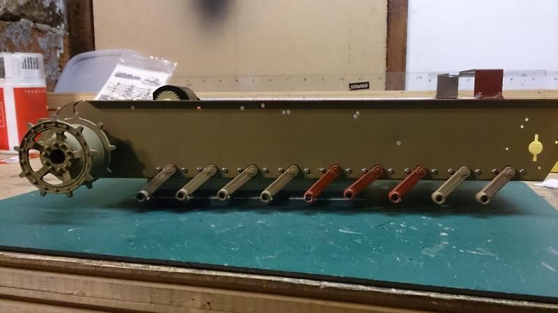

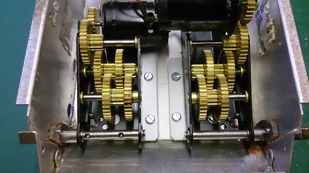

Bit more progress, I was slightly worried that the gearbox's might start to work themself loose when they finally get put into operation, so I have gone and fitted a couple of support struts made of 2mm thick plastic strip that is bolted all the way through to the metal chasis.
That will hopefully stop the little sods from going for a walk.

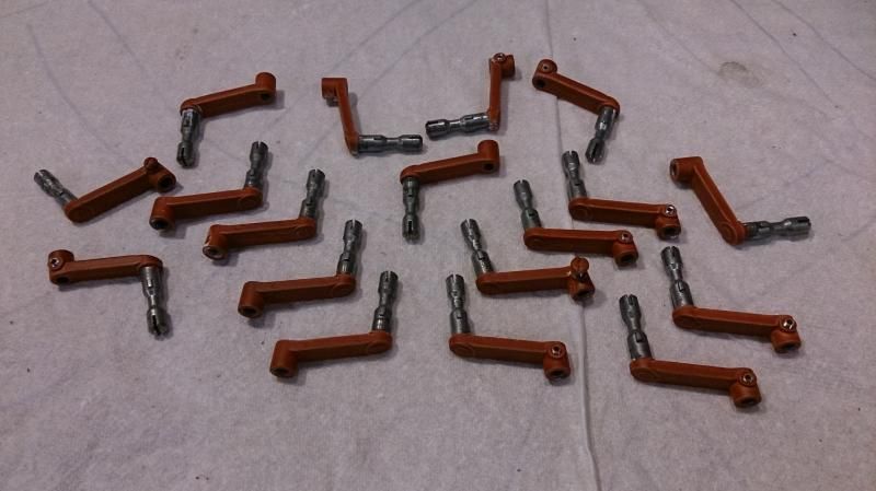

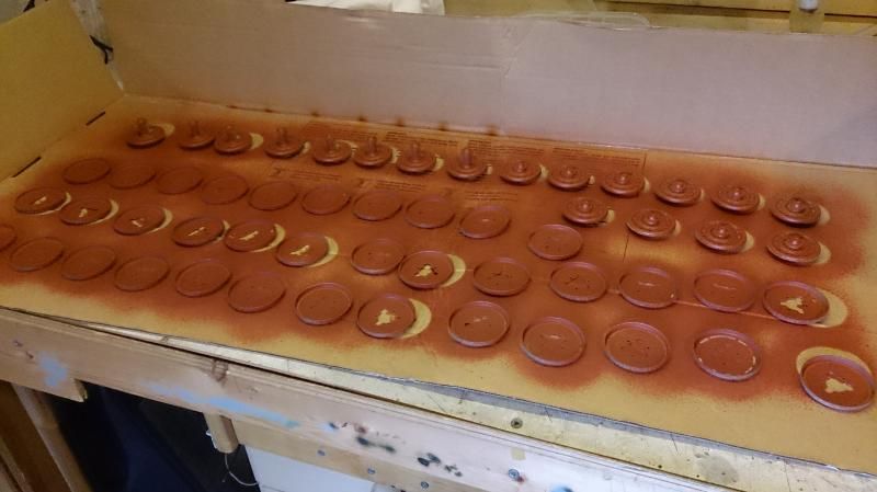

I have at last started and finished the one job that I was not looking forward to, and that was painting all the wheel axles and the wheels themselves (why oh why is there so many of them :crazy: ). They were all given a coat of red primer and when that was dry, a top coat of Tamiya dark yellow (XF60). I have left some of the wheels in primer only because of the plan I have in my brain of how I want the finished model to look ------- though this could change.

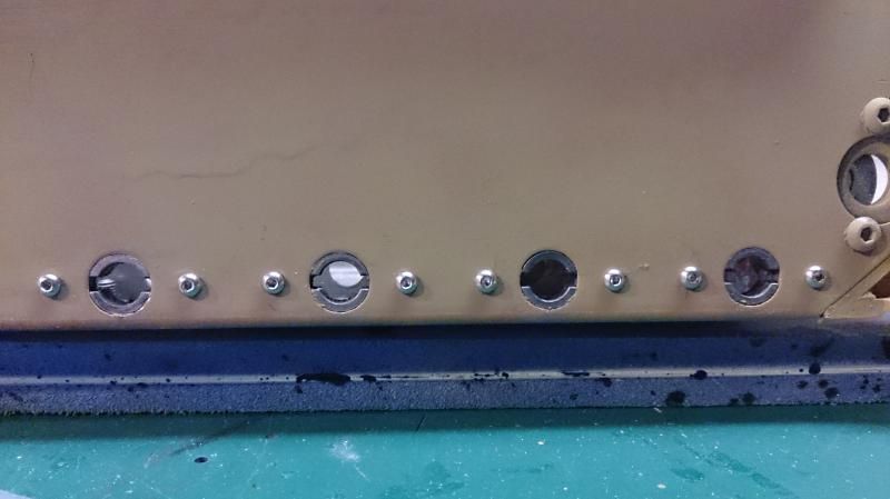

Also gone and ditched all the original axle support bracket screws (most of the heads got chewed up when I removed them during the initial strip down) and replaced them with some stainless steel allen headed bolts sourced from good old E Bay.
And finally for now, here she is with all the suspension arms fitted.

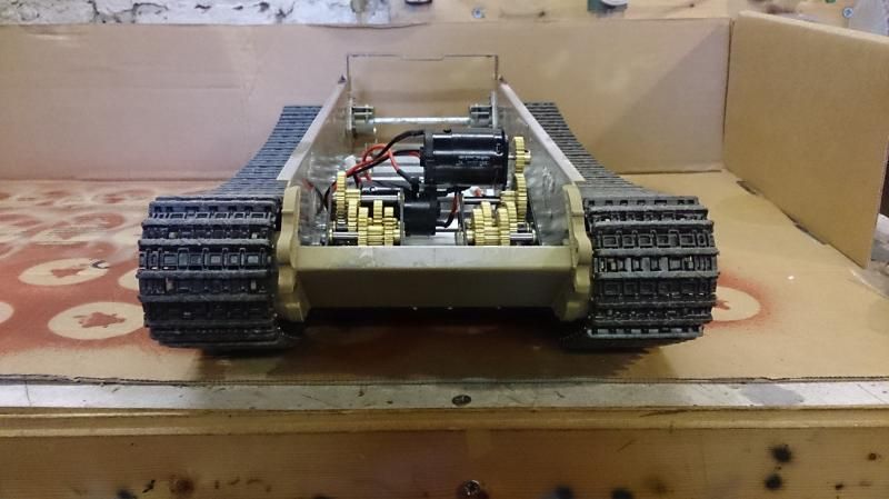

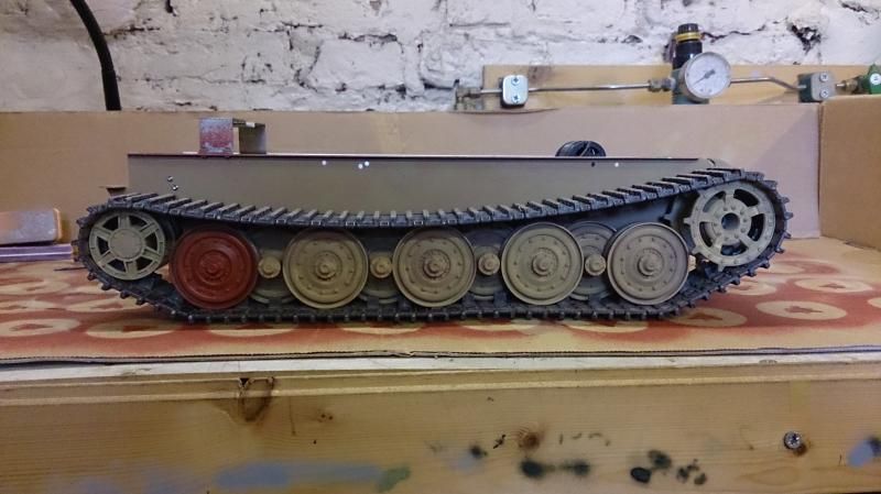

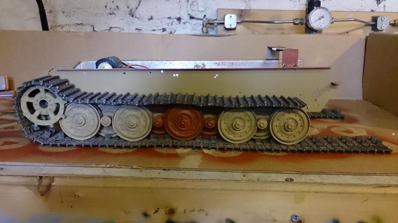

Being thundering along this weekend, I have got the new bushes fitted in all of the wheels, and what a difference they have made, compared with the original ones, no more wibbley wobbley :D . Tracks also fitted (just to see what she looks like) and it is now looking a bit like a tank.
Rear wheels fitted and the original tension system but back on, and after a bit of adjustment I have got it to my liking.

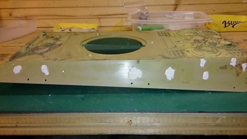

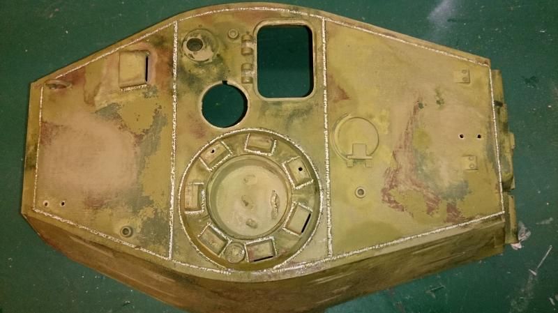

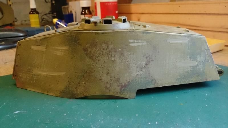

Started work on refurbishing the turret, first up was to remove the original fixing 'tabs' for the spare track links.

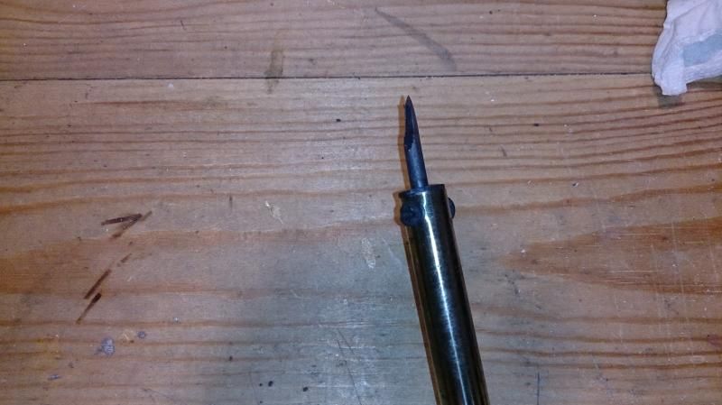

Then its simulating the welds on the turret joints, I have made a 'pointy' attachment for my soldering iron
I then glue 0.5 mm plastic rod along the weld seam, and then gently press the hot soldering iron along its length a bit at a time.
Progress so far.
Gave myself a rest after a while (welding slowly driving me mad) and filled the old fixing holes on the hull.
more later
Martyn.
