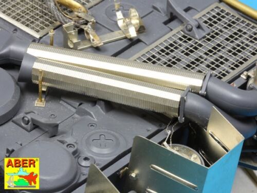

As has been stated previously I wouldn't bother with the aber set if there's an equivalent voyager set available. The aber set is far less user friendly and 90% of people won't notice the extra detail. I'm intrigued by this solder paint, I'll have to try it out! I used some leaded solder on mine, seems to work ok. I definitely need to invest in an etch tool and a decent soldering iron.

I bought the Voyager and Aber grills for both the KT and Tiger and to be honest Aber still do the best grilles for both. They have more detail and are a closer fit.
