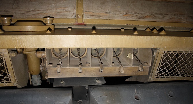

The 'sheet metal deflector' at the rear of the tank has been quite a difficult part to find a photo of. It seems to me that this structure was a very flimsy addition to the development of the tank, (late J and L up to the introduction of the deep wading exhaust on the M), as it is almost always heavily damaged when pictured in photographs. The 'Panzer Tracks 3.3' book is a great help but its always a plus to have a photograph to help with positioning!
For anyone interested i have found one picture! Google search (panzer III images) and scroll down the page until you come to 'Axis History Forum-Panzer III tank pictures' Click on this link and then scroll down to the 24th photo and "hey presto"!
