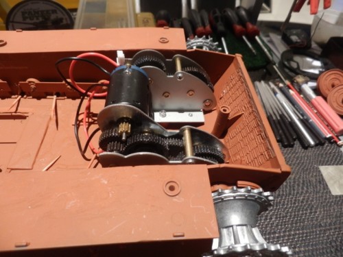

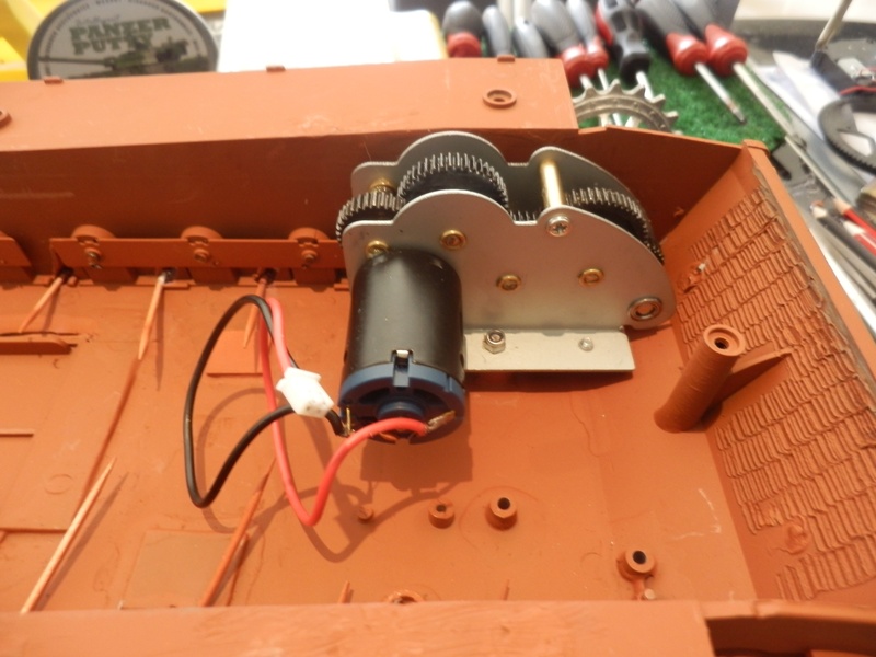

Got the gearboxes in F05.
Had a bit of piss-farting around to get them level and square with the hull so that any track run problems would be reduced.
I stuck the idler screw into the tensioner, and ran a length of cotton from it along the hull sides over spacers to get a datum measurement for the drive sprockets.

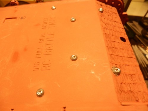

Then, I used M3(thats NOT 8 million 37th's for you left hand drivers with weird measurements!!)stainless cap head screws with Nylok nuts to secure each gearbox to the hull.
I secured the middle one, then checked the measurements before securing the next 2 in each, using the drive sprockets as leverage to get them in the right spot.
The screws were also set with PVA during the tightening process so I should not have any coming loose.
I know this process is a basic one normally, but as this hull had all its locating pegs busted off, and the mounting points split & cracked when I got it, I had to pay more attention :/
You will notice the zimmerit on the inside of the hull.............. :problem:
This was to stress relieve the front hull section and bring it back straight.
As I used a melt method to get the effect I wanted, it caused a slight bow in the lower hull front, which I corrected by simply doing the same thing to its inside as I did to the outside !
I have a lot of work ahead to set the roadwheels in place to match the track run correctly, but hey, thats part of the fun ;)

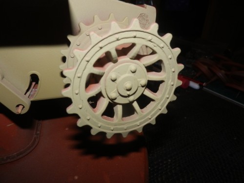

I did however remember along the way to get hold of some magnets. Most of you jokers use them in one way or another, but me, its a first.
I added 3 in each hub cap for the drive sprockets.
They hold on real well and still allow easy access to the retaining bolts onto the gear box shafts.

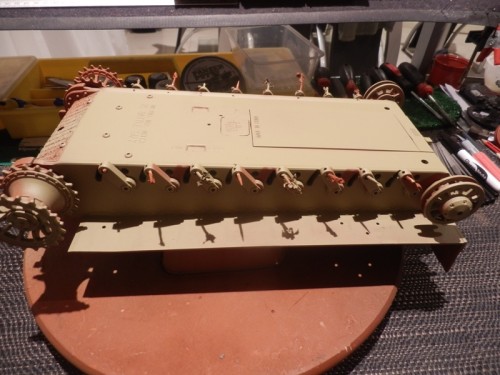

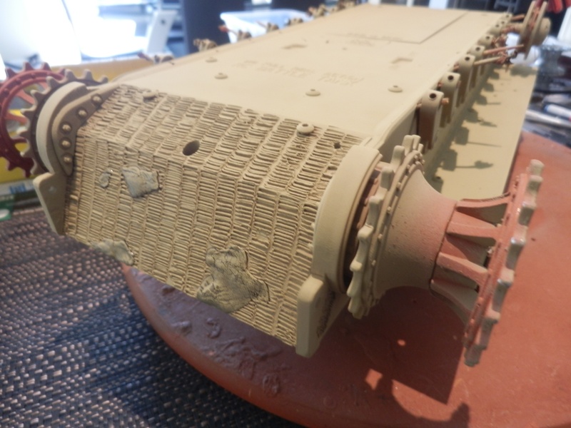

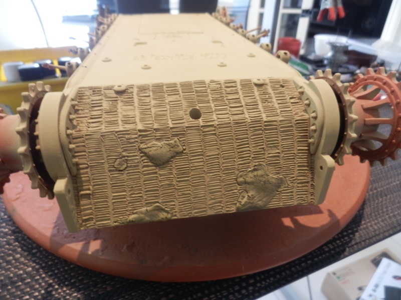

Got all the suspension grooves opened out, and the roadwheels coated in XF-60 Dark Yellow.
I also did the lower hull areas where I was a bit frugal with the TS3 can.
I had a fair old bit of a special Dark Yellow brew I made ages ago as an experiment.
Added a bit of Buff into it as once its washed- it darkens a lot.
So, to get a lighter look from fading and general exposure to the elements on a repaired hull that has late running gear fitted, the colour seems ok.

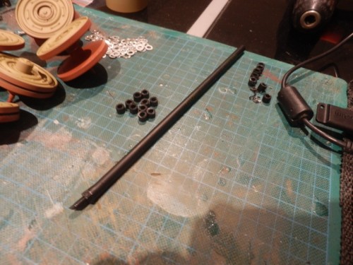

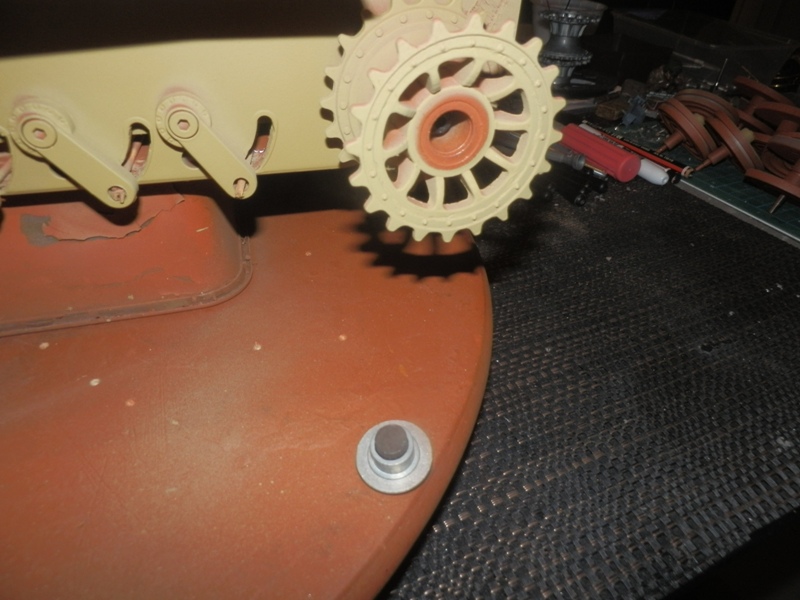

I also had to address the issue I had with spacing the double roadwheel sets out from the suspension arms.
Tripped via our chain hardware shop(Bunnings for us down here) and simply walked around with a sample axle in one hand & a set of Vernier calipers in the other.
Taigen axles are 4mm O.D. at the shaft section, found a bit of tube, actually Garden sprinkler riser tube, nylon, black and 200mm long for $0.97c.................(thats about minus 100 GBP/USD for you guys with proper currency!!)so it was in my fiscal demographic :thumbup:
Dug out my old nylon tube cutter I had for airbrake work in trucks and sliced off 5mm rings.
I will fit them shortly & se how things pull up.

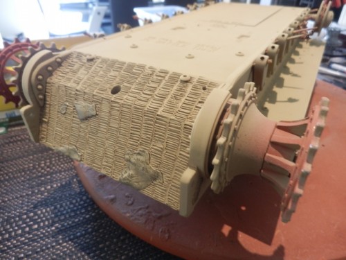

The lower hull sponsons, and roadwheels have also been coated in clear sealant.
I remembered to use Panzer Putty on the sections of missing Zimmerit, wow that stuff is SO user-friendly :thumbup:

Sprinkler Riser
Sprinkler Riser

In the 4th pick you can see the effect that clear seal has to darken the Dark yellow brew, where the drive sprocket is unsealed.
There is also the dusting and pigment to think of later on.
Its going to be a roughy, but I still want it close to right. ;)

I always thought that XF-60 was correct by itself for Dunkelgelb. Are you correcting for sun fade? Or, is it just not quite right out of the bottle?
"Panzer Putty" is that a brand name? My next build will involve zimmerit; so, I'm looking for a good putty to work with.
Raminator
Posts: 1309
Re: FEHRMANN GRUPPE TIGER 05
Post by Raminator »
The Panzer Putty is for masking; you can see it in the second and third pictures covering up the holes in the front glacis' zimmerit. Herman did the zimmerit by melting the plastic with a heated screwdriver.
Glad to see some more progress boss, and that clear coat darkening the basecoat actually answers a question I've been worrying about lately.
