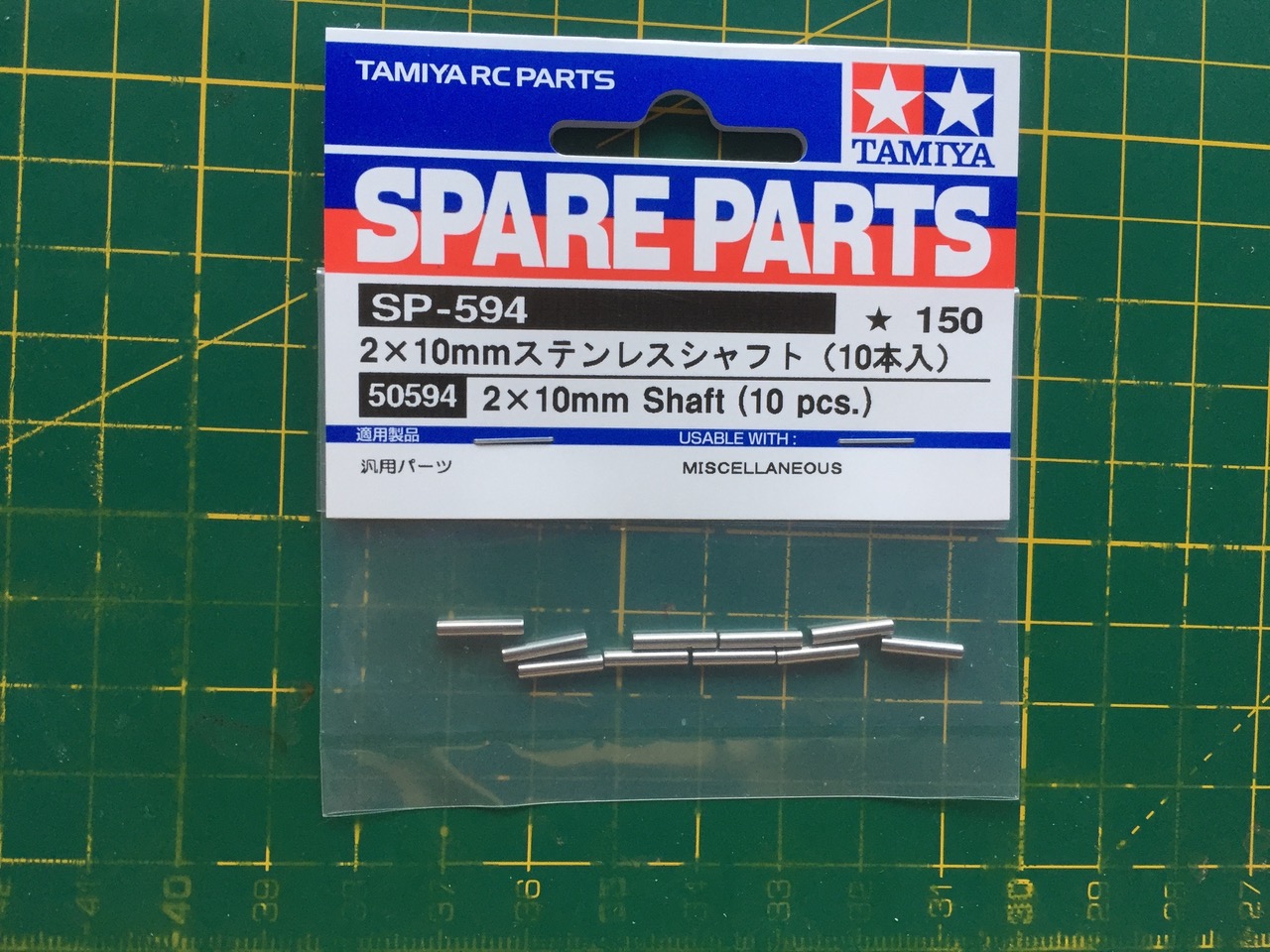

I don't have the parts bag containing the 2x10mm metal shafts I need to make the roller bearings for the turret ring. These rods are crucial to the turret moving smoothly (when paired with nylon rollers), and are a feature of most Tamiya tanks.
Modelsport supplied me with a handy pack of 10, and they were cheap too
('Cheap' and 'Tamiya' make a perfect oxymoron
https://www.modelsport.co.uk
