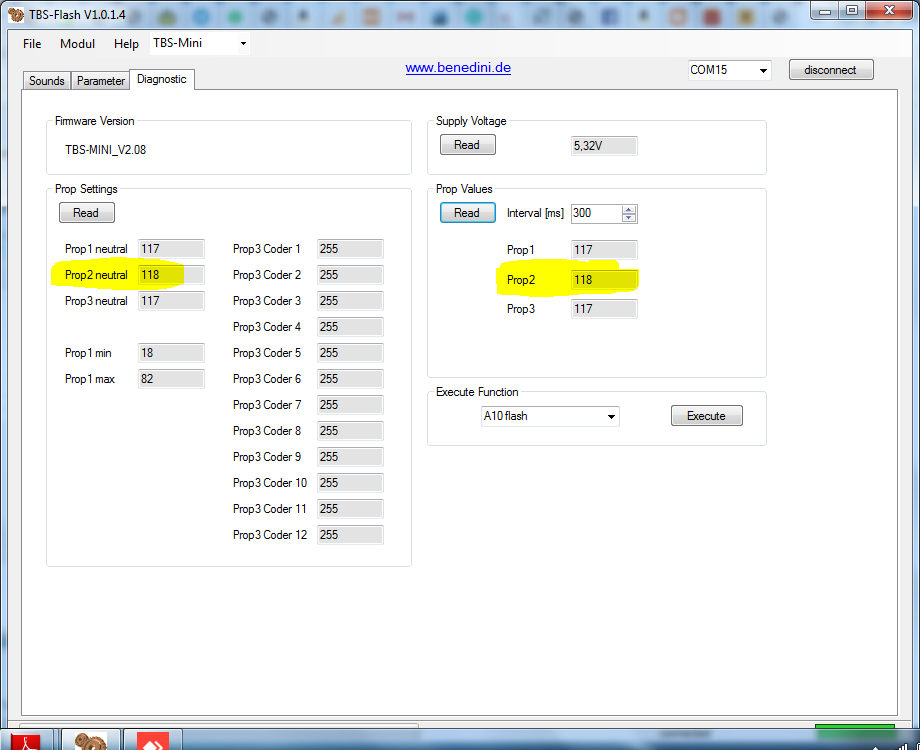

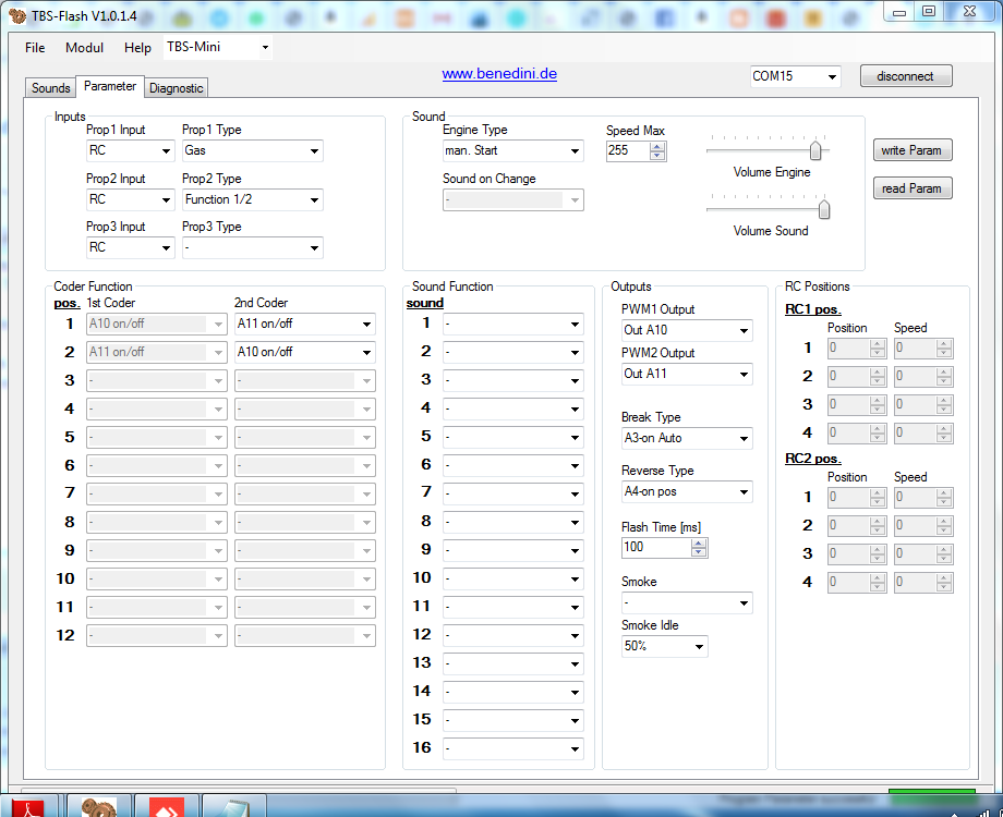

Prop2 on "Function 1/2" type, set up on a RC channel linked to a 3 position switch, outputting -100,0,100. Position 1 as "A11 on/off". Position 2 as "A10 on/off". A picture would be better:
So A11 will light on and off if switch is moved from center to top, and A10 will do the same when switch is moved from center to bottom. Well... A11 does, A10 don´t. I have to cycle through A11 again to light off A10. Servo monitor on transmitter clearly shows -100,0,100. Is this a normal behaviour?

Ooops !! I fixed it. I saw on the Diagnostic tab that Prop2 neutral and Prop2 actual value on the center position did not match. So I offset the response curve on my transmiitter till both values were the same. Now it works as expected. :)

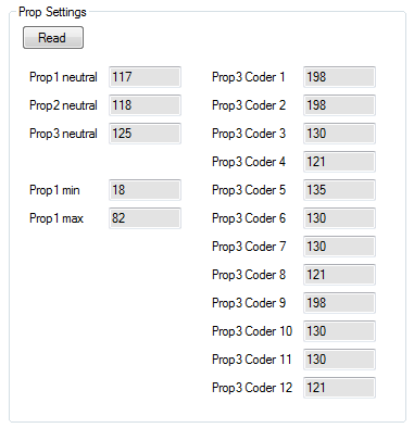

I managed to get values for my Prop3 coder, but believe me I don´t know how I did it. It is absolutely confusing.
I see they are directly triggered when the know reaches the assigned position. I saw on your video yoy first select and then trigger with a switch.
Prop3 values.PNG (11.09 KiB) Viewed 5795 times

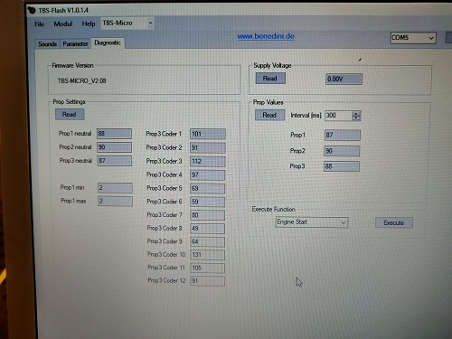

leano81
Posts: 1
Joined: Fri Aug 14, 2020 5:55 pm
Re: Dasmikro (TBS Benedini clone)
Post by leano81 »
hello can you help me, my dasmikro has these values, the gas does not work, the engine does not make sound, only horn and secondary sounds work
