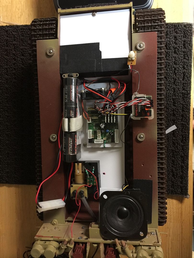

Kaiser may I ask you a few more questions?

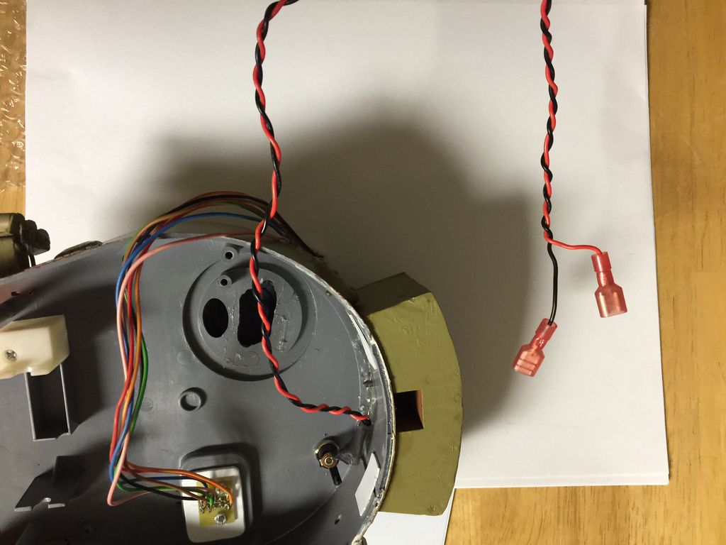

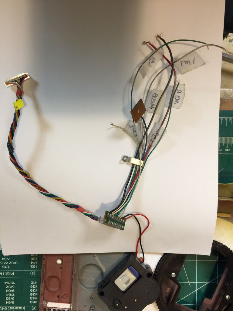

In this first photo of the turret rotation wires, apart from the rotation and machine gun can I just snip off the ones I don't use, not going to have headlights.

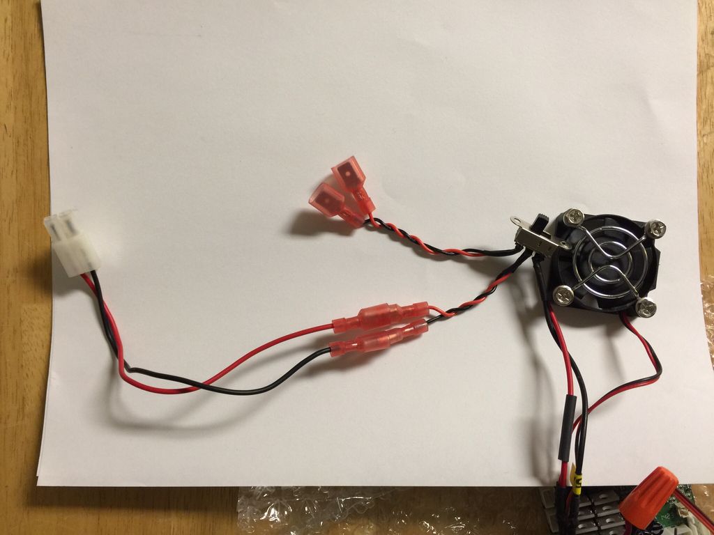

The next is the tamiya batt plug cord , w on /off switch. It has 2 extra wires that I think goto the final photo a charging port in the turret.
Are these wires in any way useful? Or should I just cut them also? Finally that little fan is wired into the on/off switch wire also, any harm if I just snip its wires off?

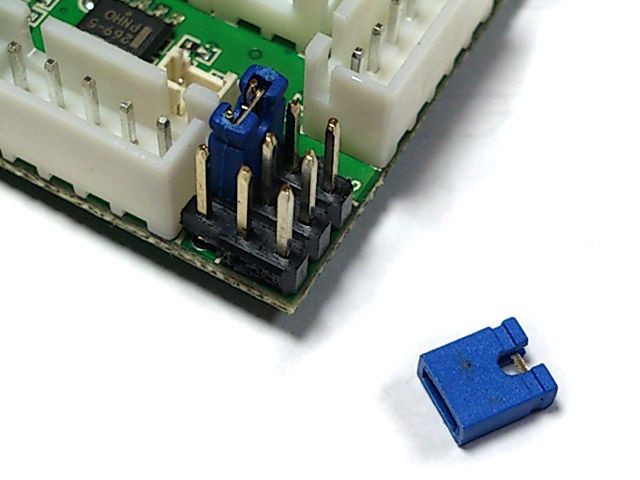

Oh and where do I get the little blue thing for the Clark board? Didn't come w board when I bought it?
