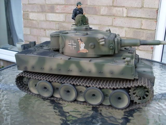

Just one question fynsdad... did your Tiger commander pay a visit to Hawaii.. or do all German Hotties wear flowers in their hair ?
I'm kidding
...She's beautiful

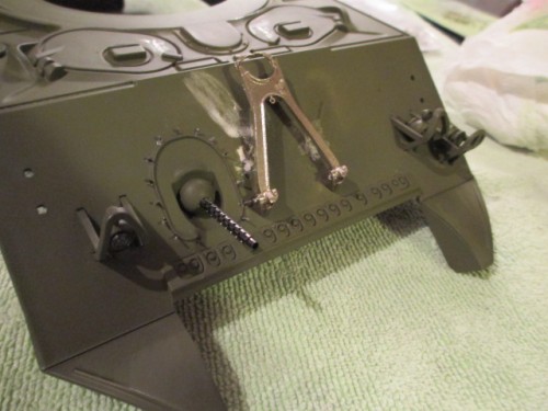

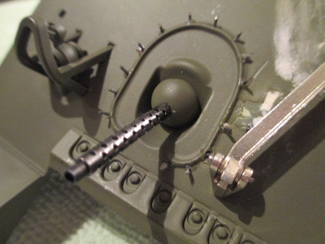

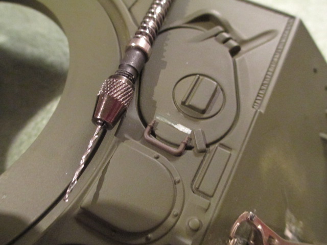

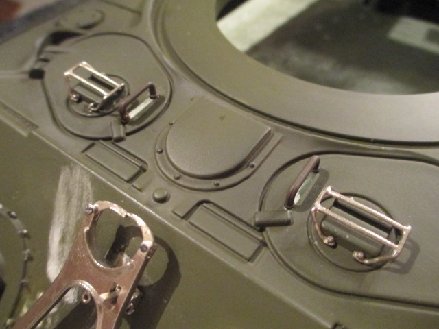

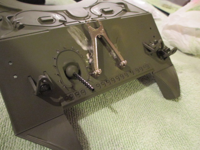

26th Day: Made some progress tonight on the upper hull. First off I got out the bow .30 cal from Tamiya and tried a test fitment. The hole in the HL ball mount was a tad small but a 3/32 bit gently rotated by hand opened the mount up back to the LED. A test fitment of barrel and shroud looks really good. I will need to visit the local Home Despot for a length of fibre optic to insert to bring the flash to the muzzle of the gun as it is quite long. Next I used a #61 bit in the yankee drill and eyeballed mounting holes for a couple of plastic Pershing hatch handles I had found in Spares. After that was complete, I finished up the night by mounting a couple of Schumo periscope guards on the front hatches over the molded periscopes. (Note that the HL Pershing hatch handles and the Pershing periscope covers by Schumo fit the Sherman hatches exactly. I suspect many of the add-on parts for these two tanks are the same but check to make sure) Pictures:
- Hatches drilled and handles mounted along with nice periscope guards
- Hatches drilled and handles mounted along with nice periscope guards.JPG (94.83 KiB) Viewed 1632 times
- Number 61 drill and plastic Pershing hatch handle
- Number 61 drill and plastic Pershing hatch handle.JPG (88.32 KiB) Viewed 1632 times
- .30 cal barrel and shroud fitted
- .30 cal barrel and shroud fitted.JPG (95.37 KiB) Viewed 1632 times
