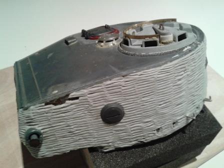

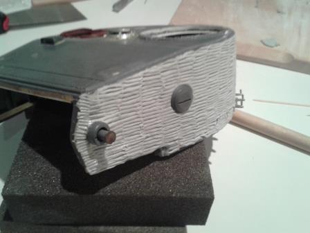

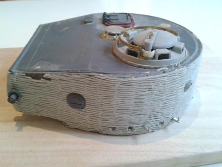

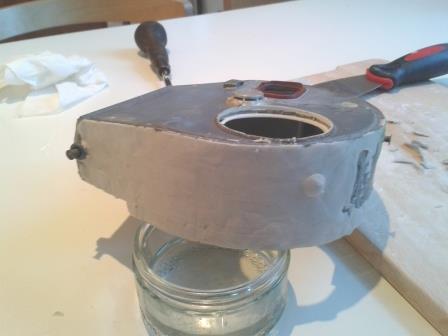

Turret zimmerit
The turret certainly looks a lot better with the zimmerit back in place.jpg (25.89 KiB) Viewed 6185 times

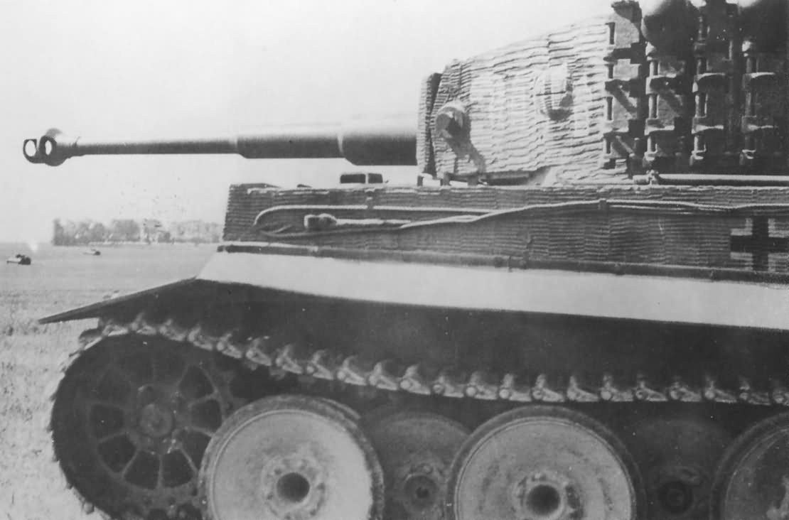

This view clearly shows the difference between the zimmerit patterns on turret and hull.jpg
This view clearly shows the difference between the zimmerit patterns on the turret and hull of most Normandy Tigers. The turret has a cruder pattern than the rest. The turret sides - bent into a distinctive horse-shoe shape - were manufactured separately from the rest of the tank and had their zimmerit pre-applied in a local pattern before final assembly. Once the main armament was installed the gun mantlet had the same texture zimmerit as the rest of the Tiger and this even extended around the front of the turret sides. Interestingly, some Normandy Tigers had the finer pattern over the entire vehicle - presumably the turrets had been supplied without the paste being pre-applied.

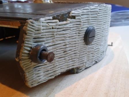

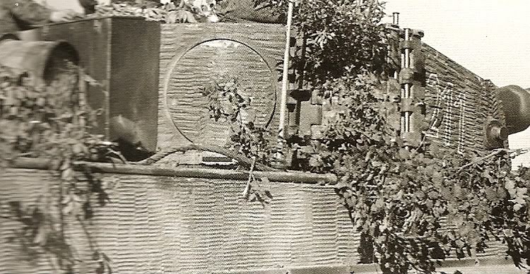

Here you can see how the smaller zimmerit pattern was applied to the front edge of the turret sides.jpg
Here you can see how the smaller zimmerit pattern was applied to the front edge of the turret sides.jpg (26.45 KiB) Viewed 6187 times

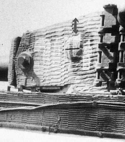

Yes, it's our old friend Tiger 334...
A larger view of the same Tiger whilst on exercises in France prior to D-Day.jpg
A larger view of the same Tiger whilst on exercises in France prior to D-Day.jpg (67.4 KiB) Viewed 5506 times

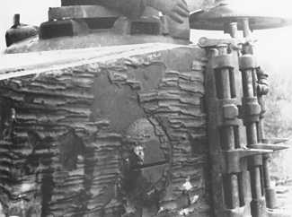

Flaking zimmerit on the front of the turret.jpg (10.3 KiB) Viewed 6187 times
As discussed already above, most (but not all) Tiger 1s in Normandy had a different pattern of zimmerit on their turrets compared to the rest of the tank. The turret style was rougher, with broader indentations and less obvious demarcation between each vertical application. Unfortunately I have chosen to model one of these vehicles. Even more unfortunately none of my fancy zimmerit stamps will replicate this pattern...
So it was with considerable irony that I was forced to return to my humble screwdriver...

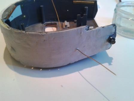

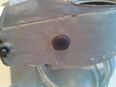

Turret zimmerit continued...

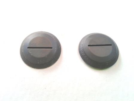

The Tamiya turret side vision ports - note the one on the right is upside down.jpg
The Tamiya turret side vision ports - note the one on the right is upside down.jpg (14.69 KiB) Viewed 6185 times

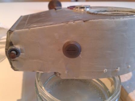

Once I had ditched the old stick-on zimmerit I also got rid of the old metal side vision ports - the vision slit itself was just the wrong shape.
Luckily my Tamiya sprues came once again to the rescue. Because these were designed to fit into holes on the sides of the Tamiya turret I sanded down their reverse. However, care has to be taken to ensure they stay the right way up - the slit is actually cut a little below their mid point...

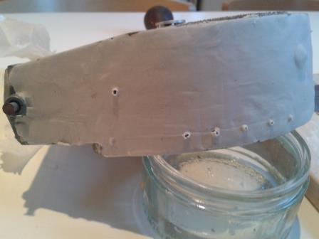

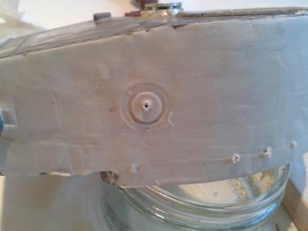

A thin layer of Magicsculp was spread along on of the turret sides.jpg (22.39 KiB) Viewed 6185 times
I had already drilled holes to help me locate the turret vision port and spare track support brackets.jpg
I had already drilled holes to help me locate the turret vision port and spare track support brackets.jpg (20.16 KiB) Viewed 6185 times
The location holes from the other side.jpg (20.93 KiB) Viewed 6185 times
The Tamiya turret vision port was then pressed into the putty....jpg (21.63 KiB) Viewed 6185 times
Then removed so the excess could be trimmed away.jpg (20.78 KiB) Viewed 6185 times
This allowed the vision port to sit correctly closer to the side of the turret.jpg
This allowed the vision port to sit correctly closer to the side of the turret.jpg (20.4 KiB) Viewed 6185 times

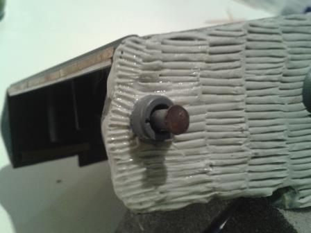

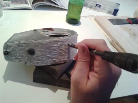

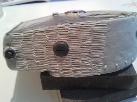

The pictures can do most of the talking...
A rougher texture for the zimmerit was then added using my trusty old screwdriver.jpg
A rougher texture for the zimmerit was then added using my trusty old screwdriver.jpg (24.99 KiB) Viewed 6185 times
The beer bottle was also an 'essential' accessory...
Work in progress... note the portion at front of turret left untouched.jpg (26.98 KiB) Viewed 6185 times
One side of the turret home - but not quite dry.jpg (25.05 KiB) Viewed 6185 times
The correct smaller pattern zimmerit was then added using my Imperial Modelbau stamps.jpg
The correct smaller pattern zimmerit was then added using my Imperial Modelbau stamps.jpg (24.81 KiB) Viewed 6185 times
But there's always room for a little wear and tear.jpg (30.38 KiB) Viewed 6185 times
Another view of one completed turet side.jpg (29.64 KiB) Viewed 6184 times

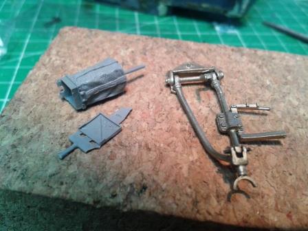

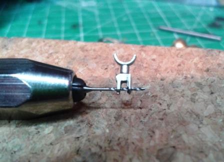

The only answer at the time of writing is the Schumo option. Not too expensive and beautifully cast in white metal. But not easy to build...
There are other additions which I have already mentioned above, such as the Aber armoured barrel sleeve and resin cast Gurtsacks (canvas bags holding the ammunition) from David Parker at the AFV Modeller Magazine shop. The only problem will be putting them all together. I have made start...

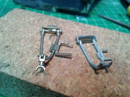

Schumo (top) and Hachette (bottom) cupola AA mounts compared.jpg (33.14 KiB) Viewed 6260 times
The correct shape of the Schumo part is clearly apparent.jpg (33.93 KiB) Viewed 6260 times
On the left is the resin Gurtsack by David Parker from the AFV Modeller Magazine shop.jpg
On the left is the resin Gurtsack by David Parker from the AFV Modeller Magazine shop.jpg (33.58 KiB) Viewed 6260 times
The Schumo barrel cradle was drilled out with a pin vice - fiddly work!.jpg (28.6 KiB) Viewed 6260 times
