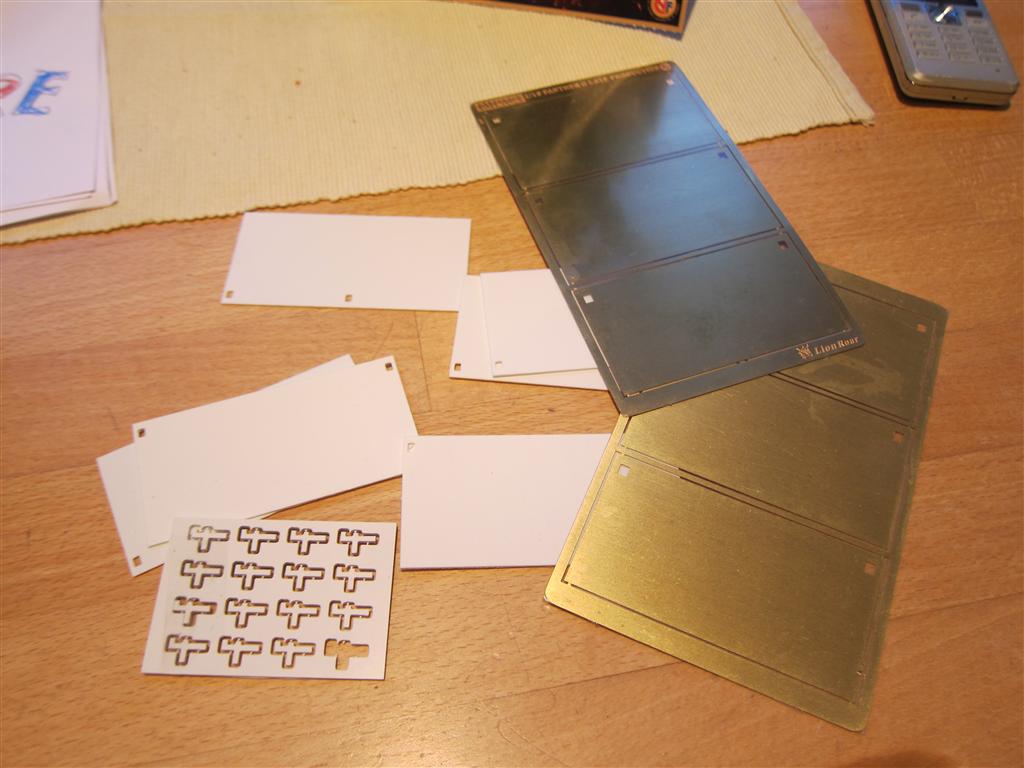

Updates 10/21
I already had the side skirts bought way back but waited for the metal tracks to get fitted before attempting to attach it since I wanted to know the final width of the tracks so I can make adjustments to the side skirts (if necessary) so it wouldn't snag during running.
The side skirts are from Tank Modellbau and I bought it from Welshdragon models. I could've made them myself but these are machine cut and are measured very precisely.
Fitting them was straightforward. First I measured where they attach. As you can see I started from the rear fender since this had a definite edge I can align with the edge of the side skirt piece.
I marked the fastening holes through with felt pen so it would mark the tank's fenders.
Then it was just a matter of freeing the hook fasteners from the sprue... (By the way, I wasn't cutting through my wife's precious table mantle as it is under the tabletop glass. A thing to remember for you husbands deciding to use the dinner table as a work table ;) )
and gluing it to the side fenders. Here is a pic with the fastening hooks in place. My confidence in this thing holding while the tank is in motion has now gone as the hooks themselves are so small and narrow, I don't think there's enough surface area for the plastic glue to get a really good hold. Anyway I am thinking I'll just attach the skirts when the tanks is in static display (or running very slow) and remove it when I really want to tear the track.
Here are two side views of the tank with the side skirts on. I'm thinking whether to leave the last side skirt off as I think it looks better. However having the side skirts does change the look of the tank. I kinda miss the 'uncovered' look of the tracks.

Thanks for the info Eastern. I look at it as a large scale model more than anything else (more static display than battling). Although I am interested on the fastening hooks you mentioned. Are they carried by Welshdragon? Can you send me a link? :) Thanks.

Thanks for sharing the settup on the side skirts. I'm building a JP and got both the TM ones, and then I bought some 'odd stock' with some minor cosmetic stuff on them from mitosal. 8 doallars ore so for 2 complete set's. Just need to build some hangers for them.
Odd stock
http://mitosal.com/oddstock.htm
The set with the hangers seems to be this one .
http://www.welshdragonmodels.co.uk/aber ... -165-p.asp
Seems you get fenders , hangers and side boards like here.
if you use this link you see a 'click here for PDF' to se the manual
http://www.bnamodelworld.com/armour/arm ... tamiya-kit
