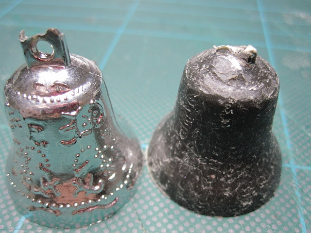

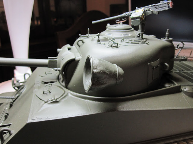

PA SPEAKER Mk I
The bells, the bells, :wtf:
Got these, courtesy of Von kraftwerk, thanks
First thing to do was get rid of the chrome plating.
Next, I re shaped using Milliput to get a more cone like shape, made the dent, then used some small guage wire to form the lip around the edge.
Made the internal horns by cutting a small circular piece of plastic then fixing on some scraps from a model spru.
A bit more sanding, but didn't want it to look too smooth, and a coat of paint, job done.
Temporary fit to turret to get a first impression.
I'm happy with the front on view, although still a bit small, but not sure on the side elevation.

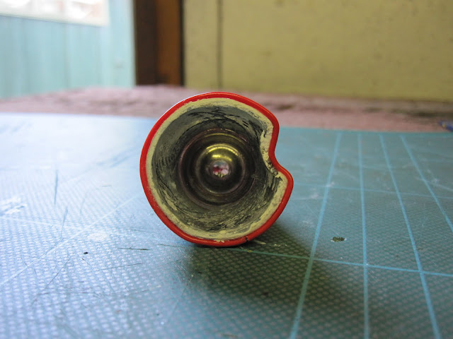

PA Speaker Mk II
Hi all,

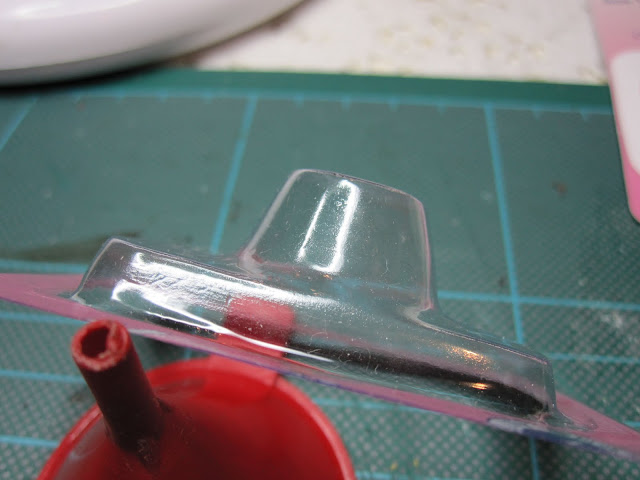

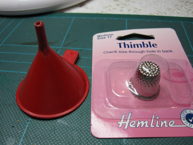

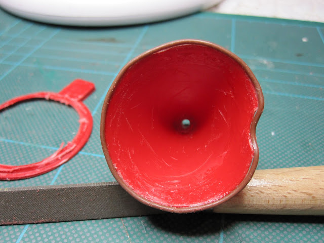

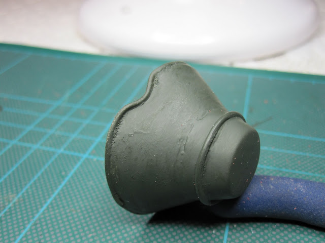

As mentioned in previous message, I have been looking for small funnels, and found this in a model steam engine store. My thoughts were to use the cut down funnel and fix a thimble on the rear to form the correct shape. I had no info on the size of thimbles, just that they came in small, medium and large, so I asked the other half to get me a medium when she was in town, so here are the starting conponants.
The thimble turned out to be too small, but the plastic bubble pack it was in looked much more promising.
The first thing I did was to cut down the front of the funnel to get rid of the rim and make it a bit smaller.Formed the "dent" by applying heat, and this time I thinned the edges ,before fitting the small wire that forms the detail.
I then cut down the plastic thimble packing and , after cutting off the rear of the funnel, fixed it in place. Then added some more small cable to form the rear detail.
I re-used the inner horns from speaker Mk I and painted .
Temporary fix to the turret for photo shoot, and I think you will agree, this is much closer to the actual speaker on Oddballs tank.
BFN :wave:

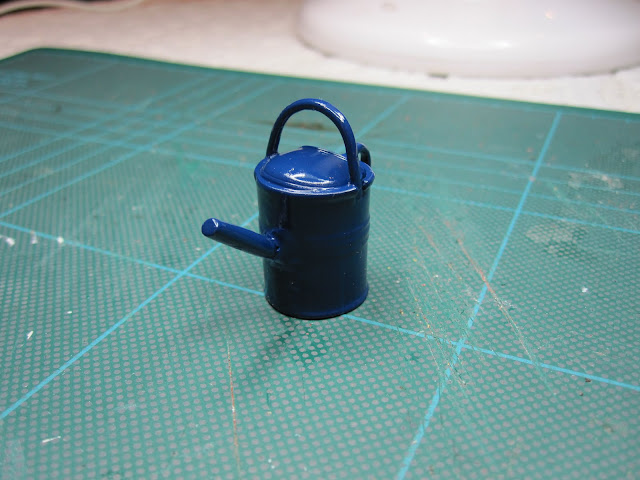

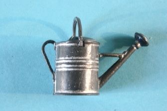

The Water/Oil Can
Got this miniture watering can from a dolls house shop.
After cutting about a bit, re-fixing the spout higher up, and painting, we have the finished article, ready to sit on the front fender.
BFN :wave:

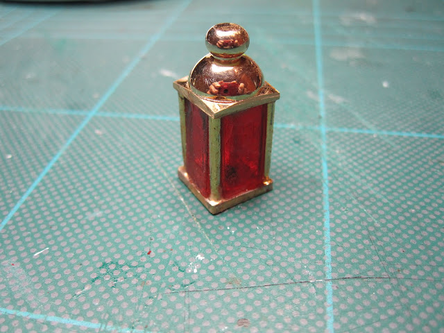

The Lantern
Again, sorced from a dolls house shop, this coach lamp is the starting point.
More cutting about :/ removed the base and the lid, streightened the corner posts and cut down the lid.
Thinned down the lid and base, then cut some clear styrene and coated with "Clear Red" paint to form the glass panels. Fitted panels in place and fixed lid to finish off the lantern ready to go on the opposite fender.
Have still got the little 12V lamp and am toying with the idea of making it a working lamp.
BFN :wave:

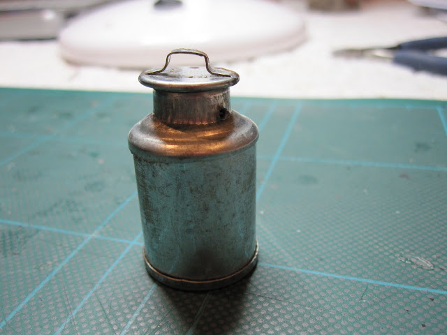

I have managed to find a milk churn to hang on the back of the tank.
These dolls house supplies are the dogs doo daa's :haha:
Temporary hook up to rear of tank to check for size,
Looks good compareing to the film.
BFN :wave:
