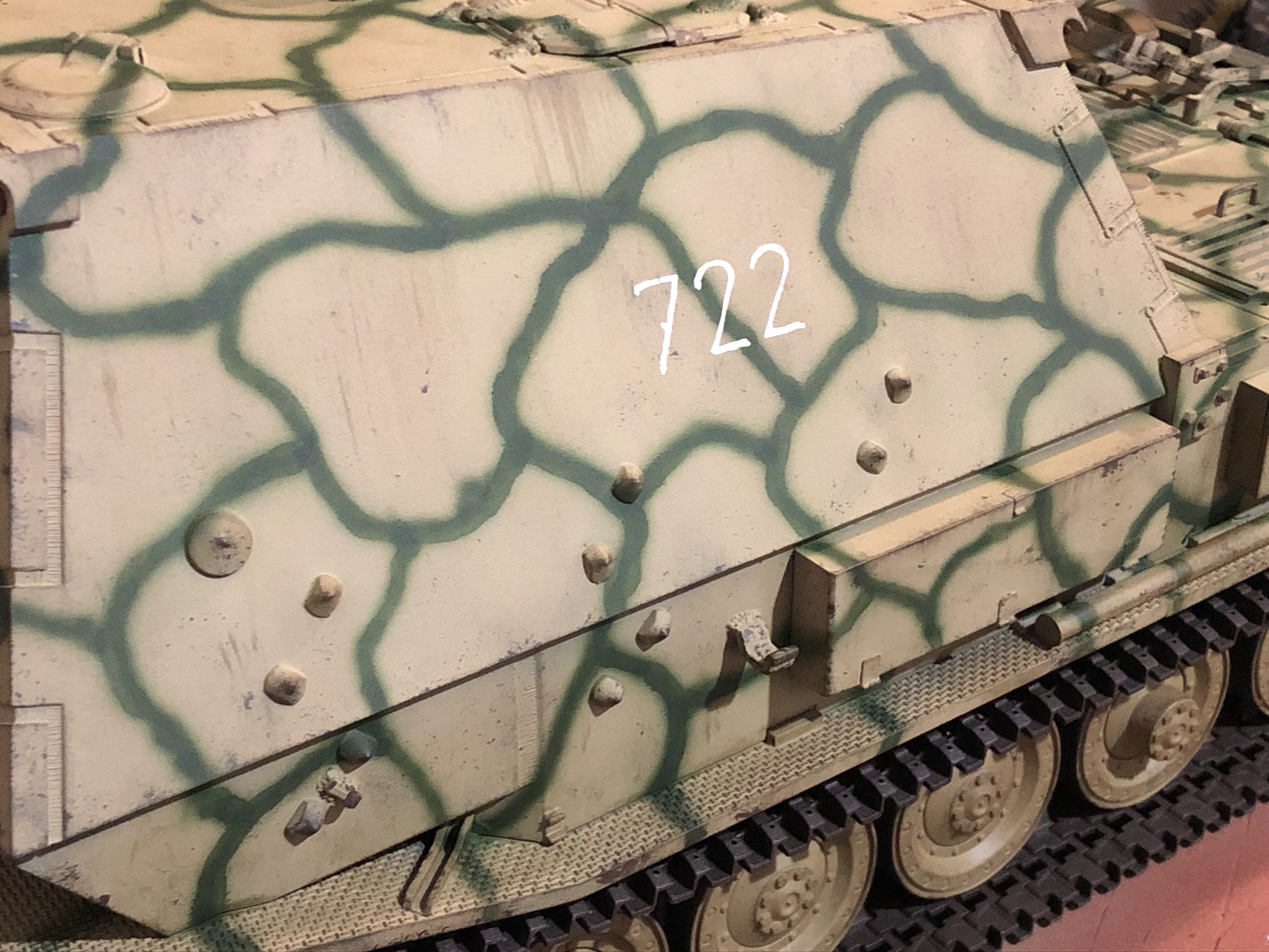

HERMAN BIX wrote: Thu Oct 16, 2025 10:57 am Its sealed, and chipped.
Still a way to go.
Yeah Ummm, No more of that malaise or self deprication or lack of confidence posting Sir, She's looking fantastic.
On the flip side, I get it.
Keep it up, can't wait to see what's next :thumbup:

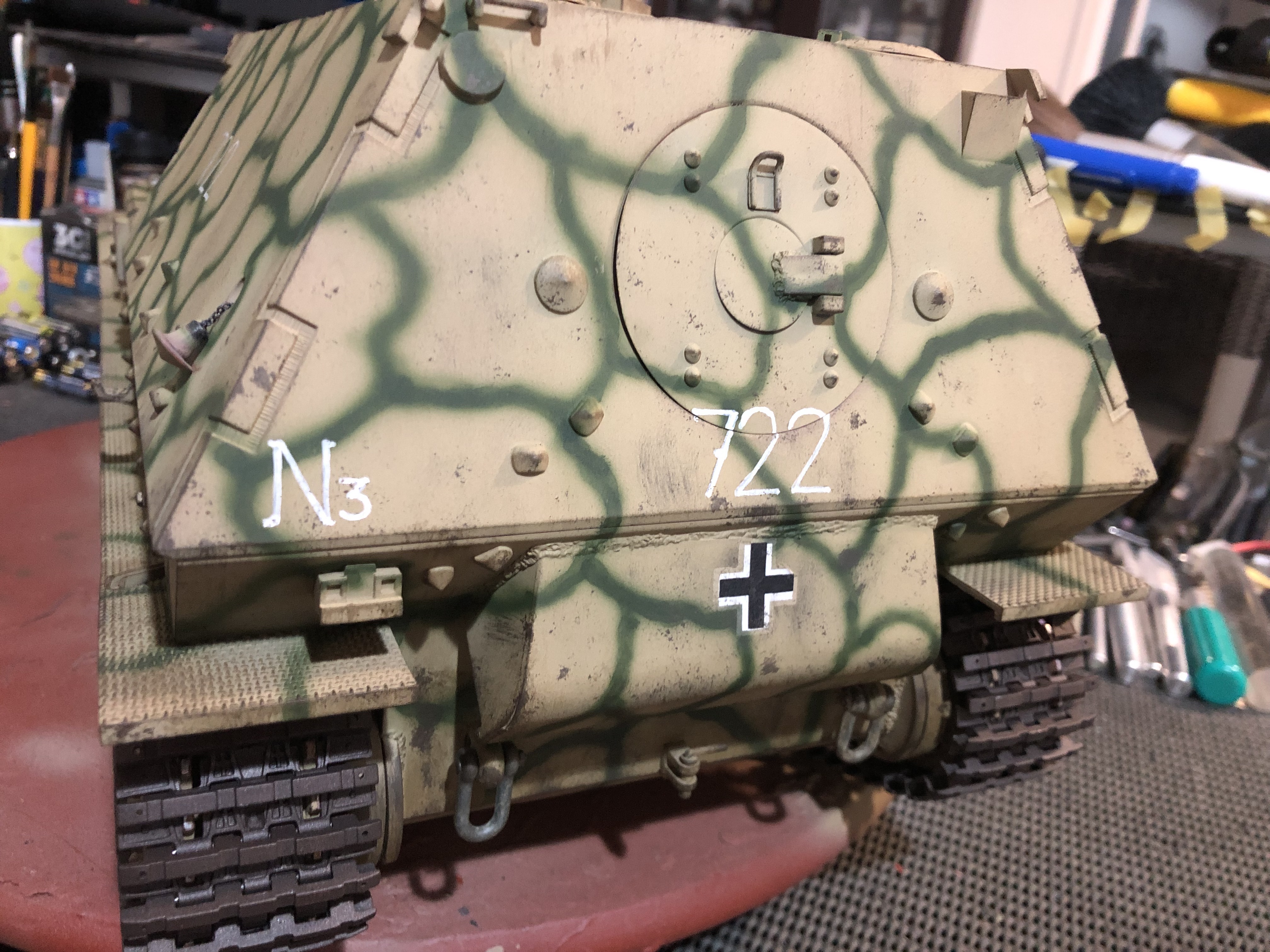

Another compliment on your chipping. I've never been able to master it so subtle is the only way I can go so it's nice to see someone far more talented than me use the same restraint :D
Posts: 11859
Re: (SELF PROPELLED ARTILLERY) FERDINAND 722, Kursk, Sch.Pz.Jg.Abt. 654, Oberfeldwebel Klarmeyer

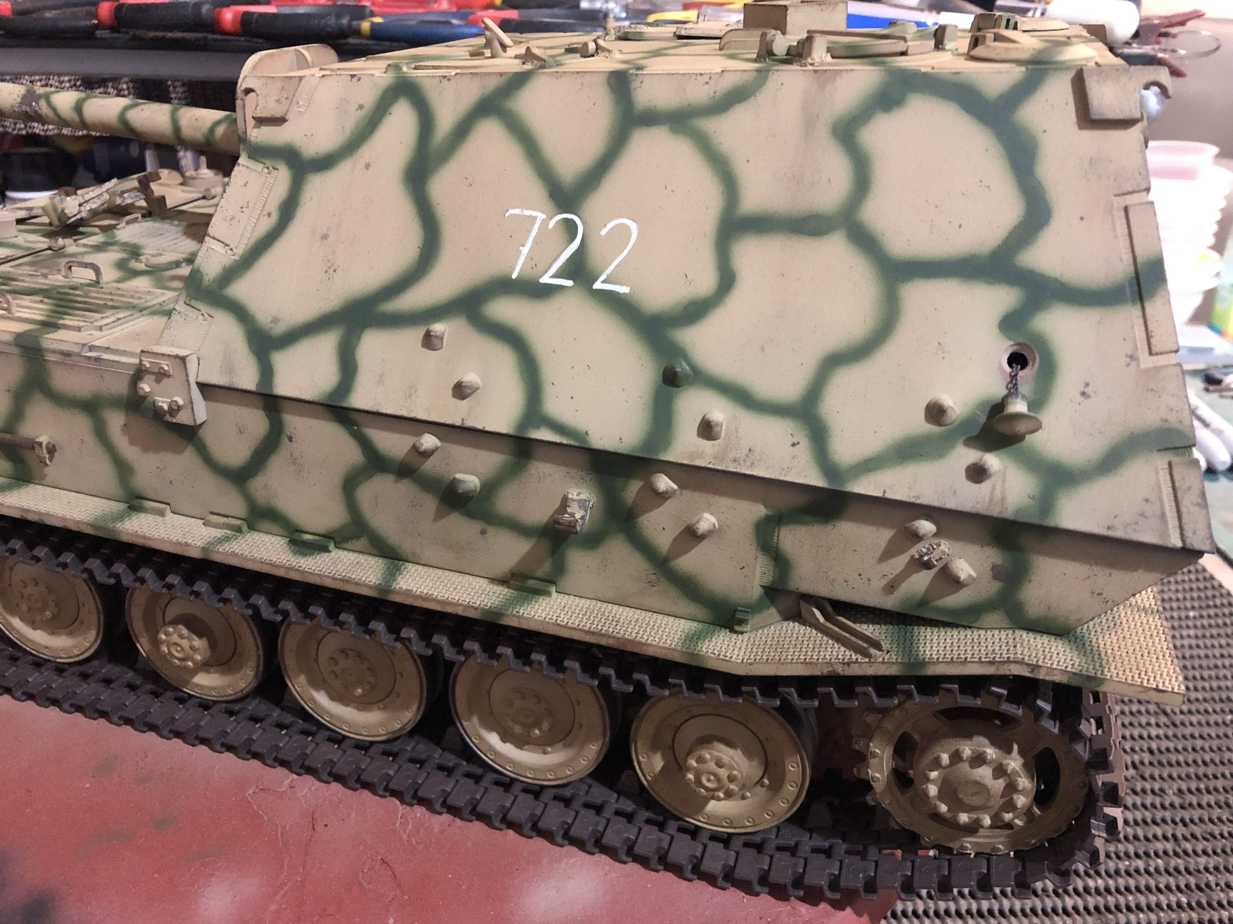

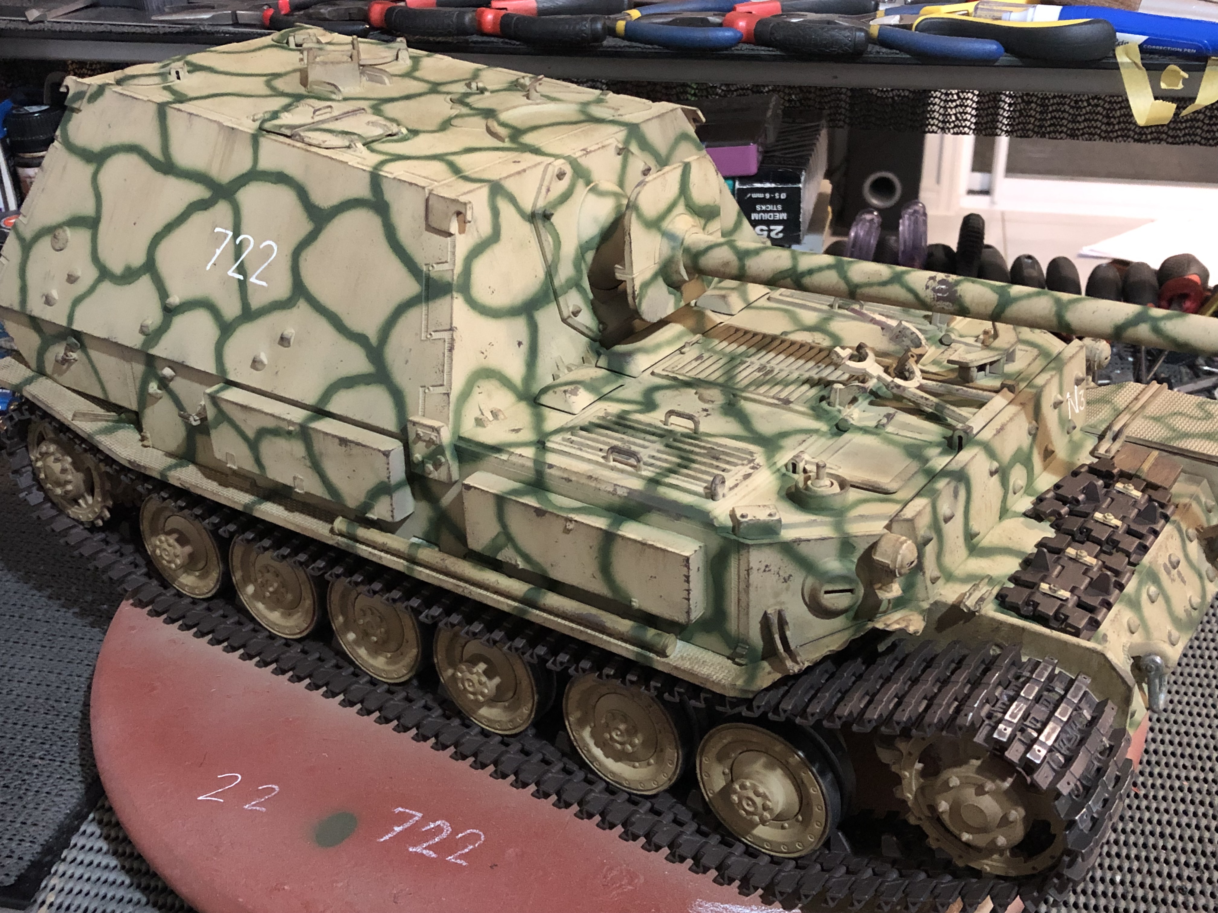

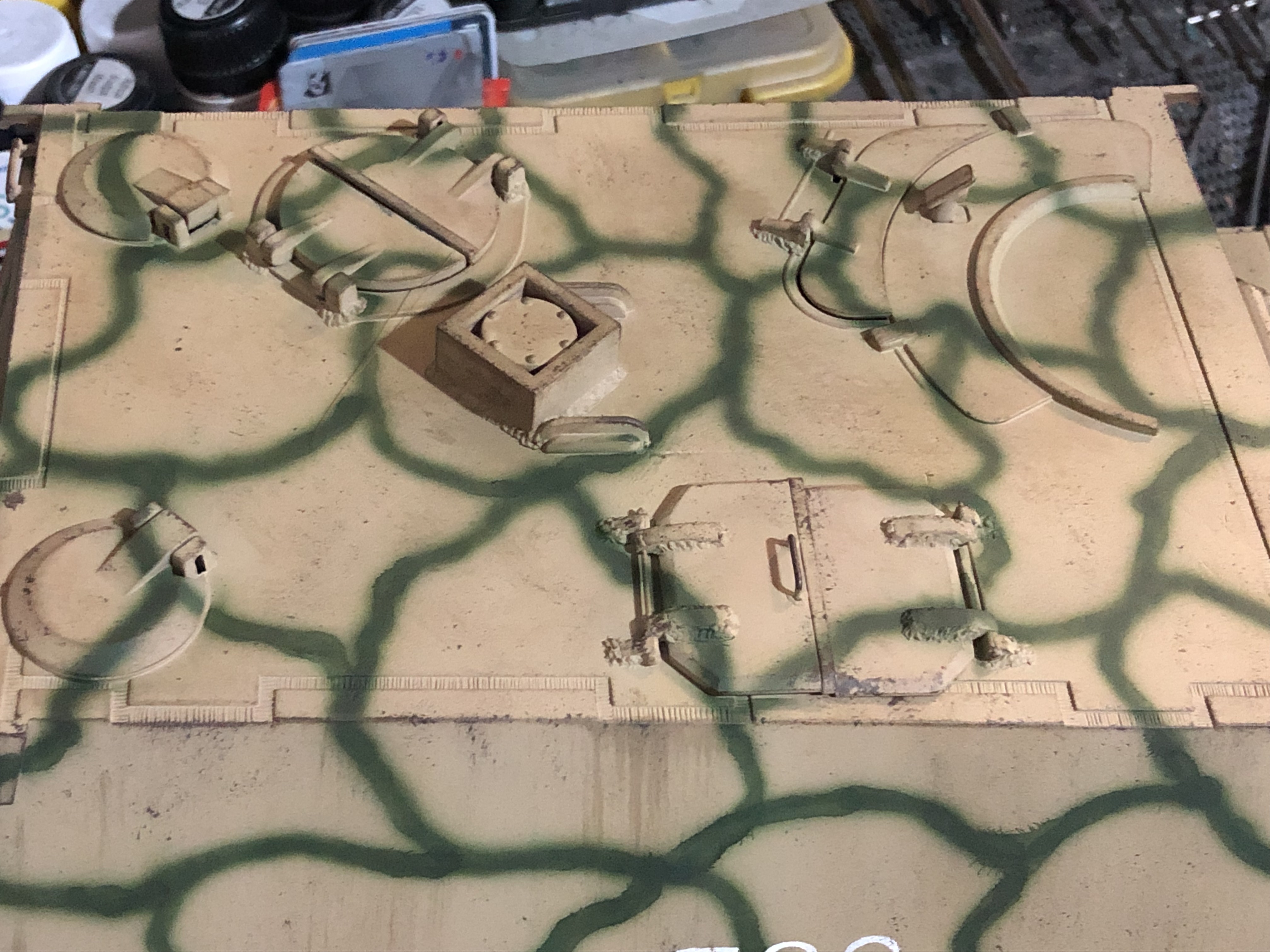

Normally I'm a heavy weatherer but in this case trying to be less-is-more is the order of the day.
Still to sort the tracks out and add light pigment to the lower but the upper is effectively done.
I accidentally made & used a filter/wash/glaze...........that meaning, I used an old filter bottle to stick a figure on while I painted it, forgot it was ballasted with water, chucked some turps in it and a splosh of German Wash for dark yellow (but barely any) and shook it.
Thinking I had reconstituted the filter residue.............. :lolno: :headbang:
Was a smelly & dirty water that went on with a wide brush in vertical sweeps down then up, & wouldnt you know, it damn well worked. :crazy:
The water content carried the residue & enabled it to be very very disipated & random in depth & density which showed once the water evaporated.
No cunning plan, no strategy, pure blind fluke :O
Sometimes it great to turn a ^&$%-up into a win ;)

It really enhances the tank mate a very fortunate mistake :thumbup:

HERMAN BIX wrote: Fri Oct 17, 2025 4:02 am
MonsieurTox wrote: Thu Oct 16, 2025 5:09 pm Stunning work. I like your dunkelgelb very much because it's not that "dunkel" ;D I think it looks better that way than the off the shelf dunkelgelb from various brands that really look too dark to my taste (even more after some filters/weathering).
Your chipping is spot on, very well balanced, we can see it but it's not overdone!
That’s high praise indeed Sir, from you that creates gold out of thin air !!
The Gelb is a blend, very lightened, devoid of any green hue. I do need to make a new batch, base ingredient is XF-88 Dark Yellow 2 mixed with MiG 20005 and 20010 as they were too low in volume to use alone so bunged it all together, added XF-57 Buff and stirred !!
Keeping in mind these things were new for the Kursk battle, looked after a lot, and only trained in for a relatively short time.
Not much paint degradation but a lot of crew traffic on the roof & engine deck.
I reckon it’s enough
Thanks again for checking in
Thank you very much for the recipe!
I had no idea you could mix Tamiya with MiG paints as Tamiya are not true acrylics, but it seems to work well!
Yeah chipping is enough no need to make it look like a wreck!
And thanks for your kind words!

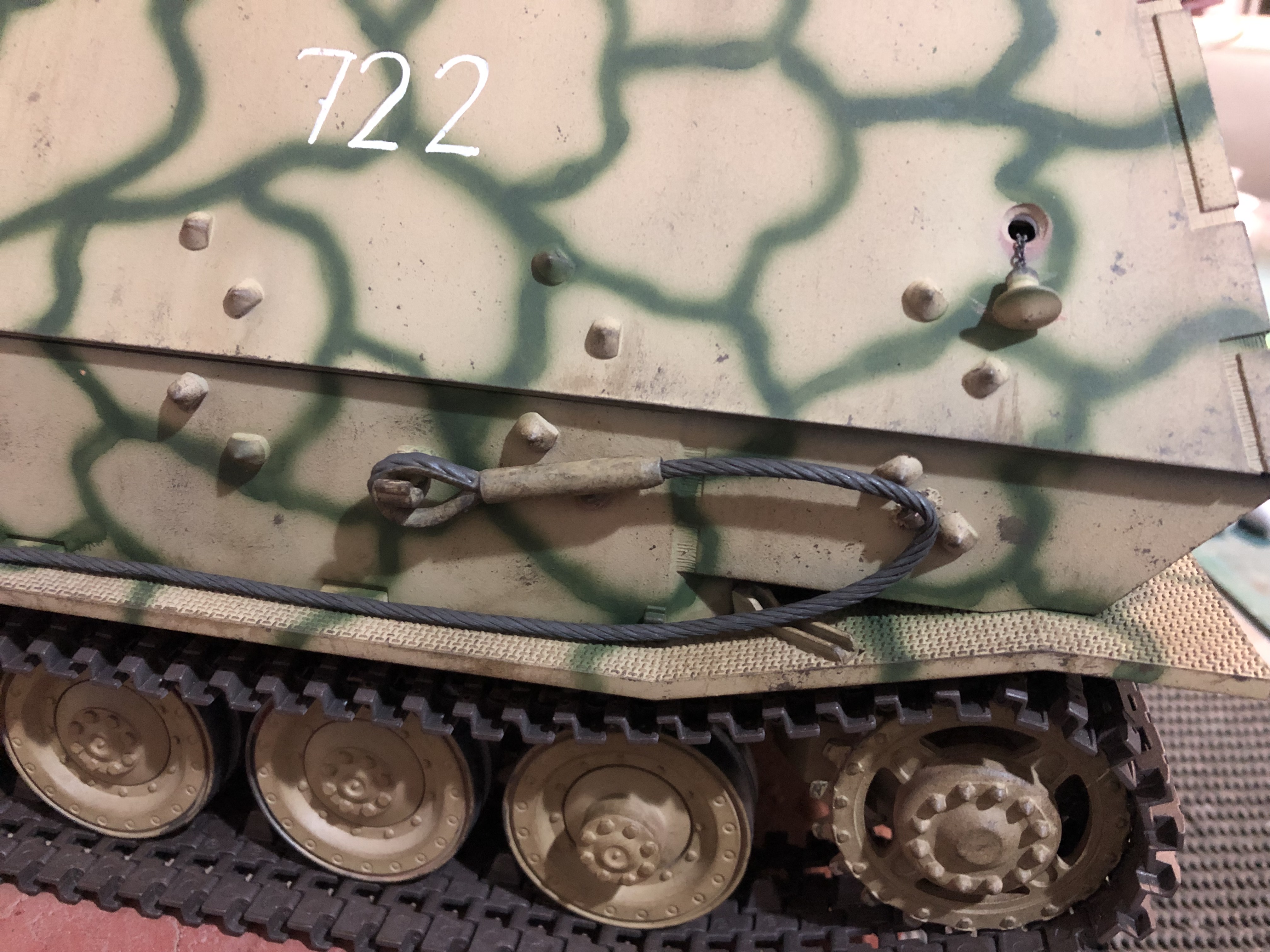

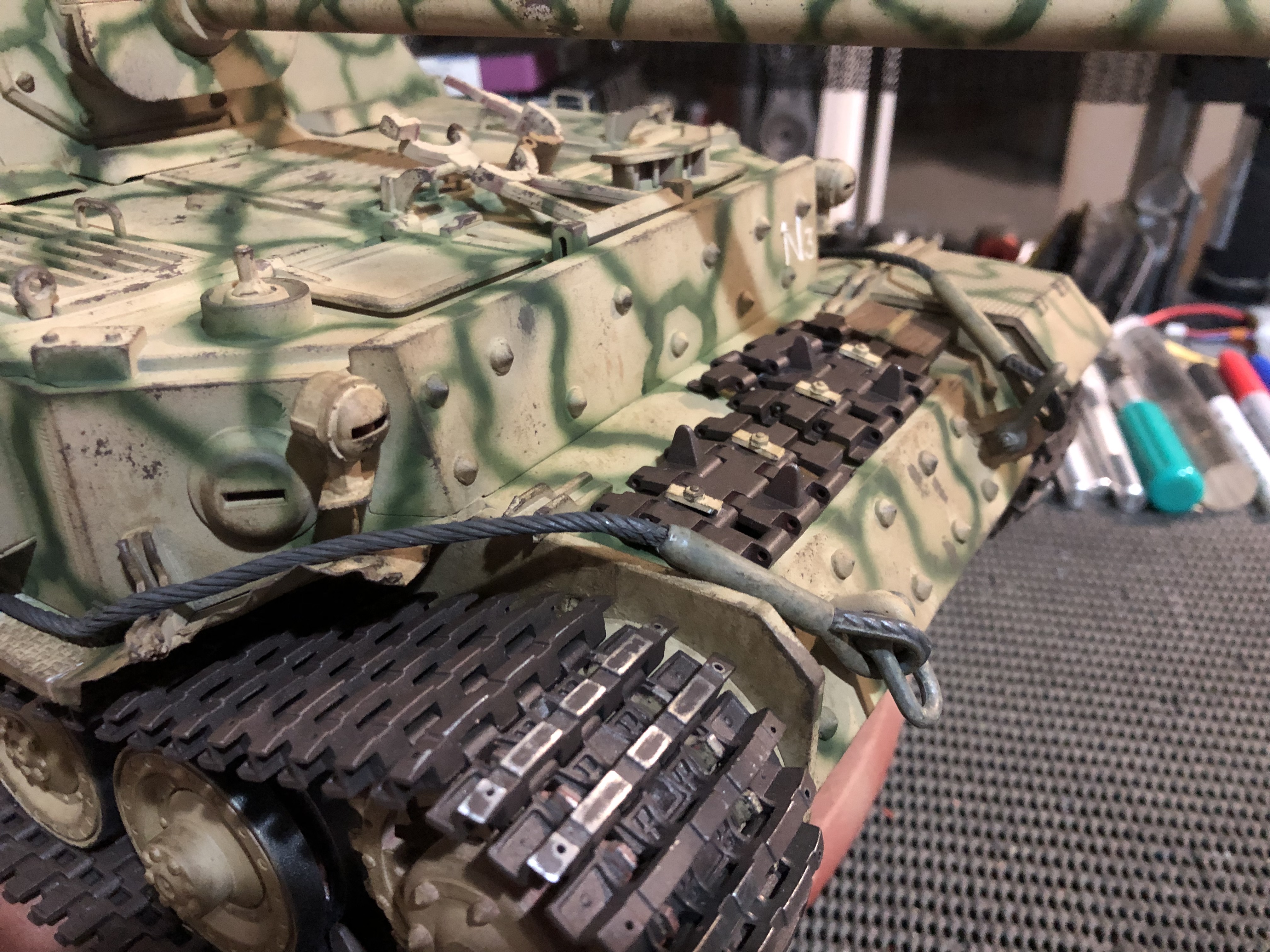

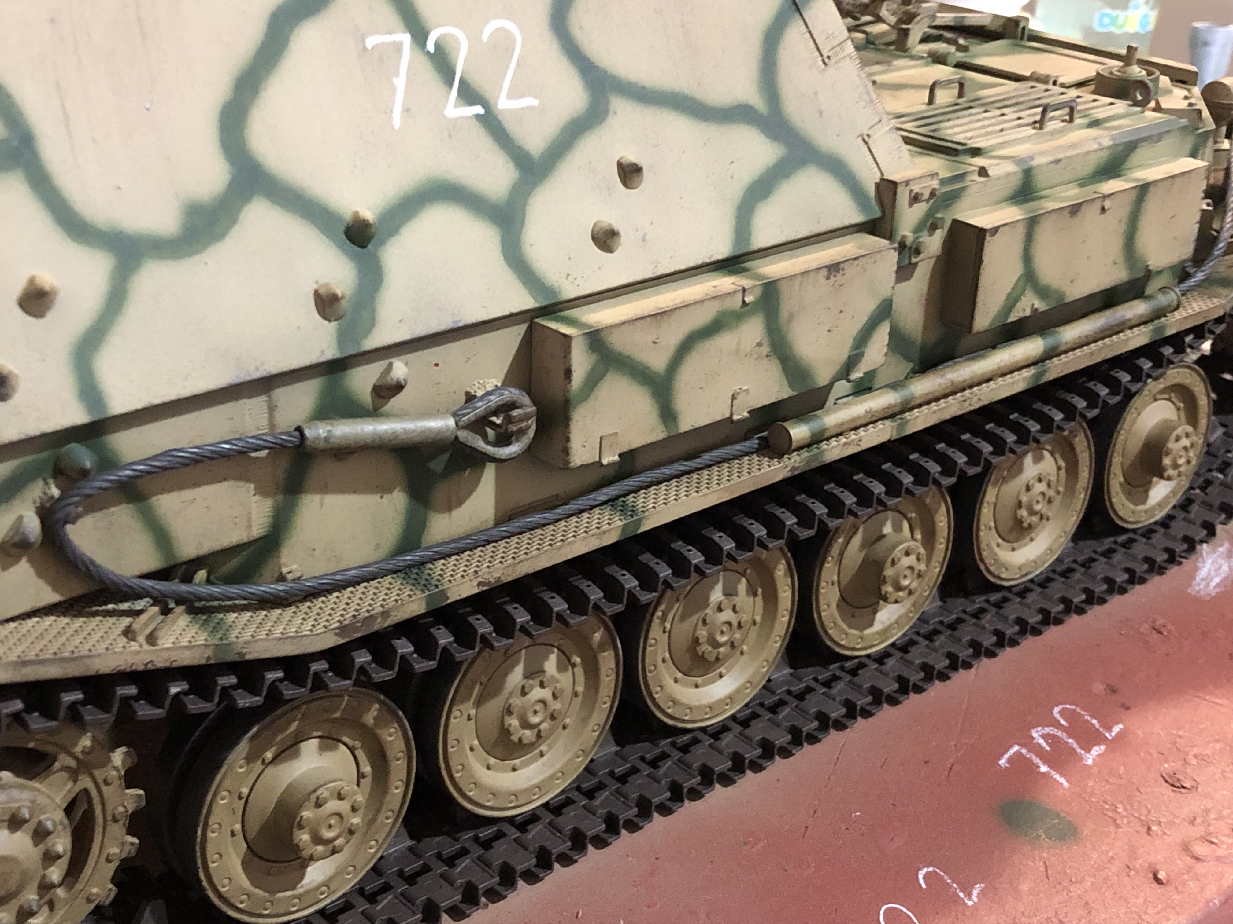

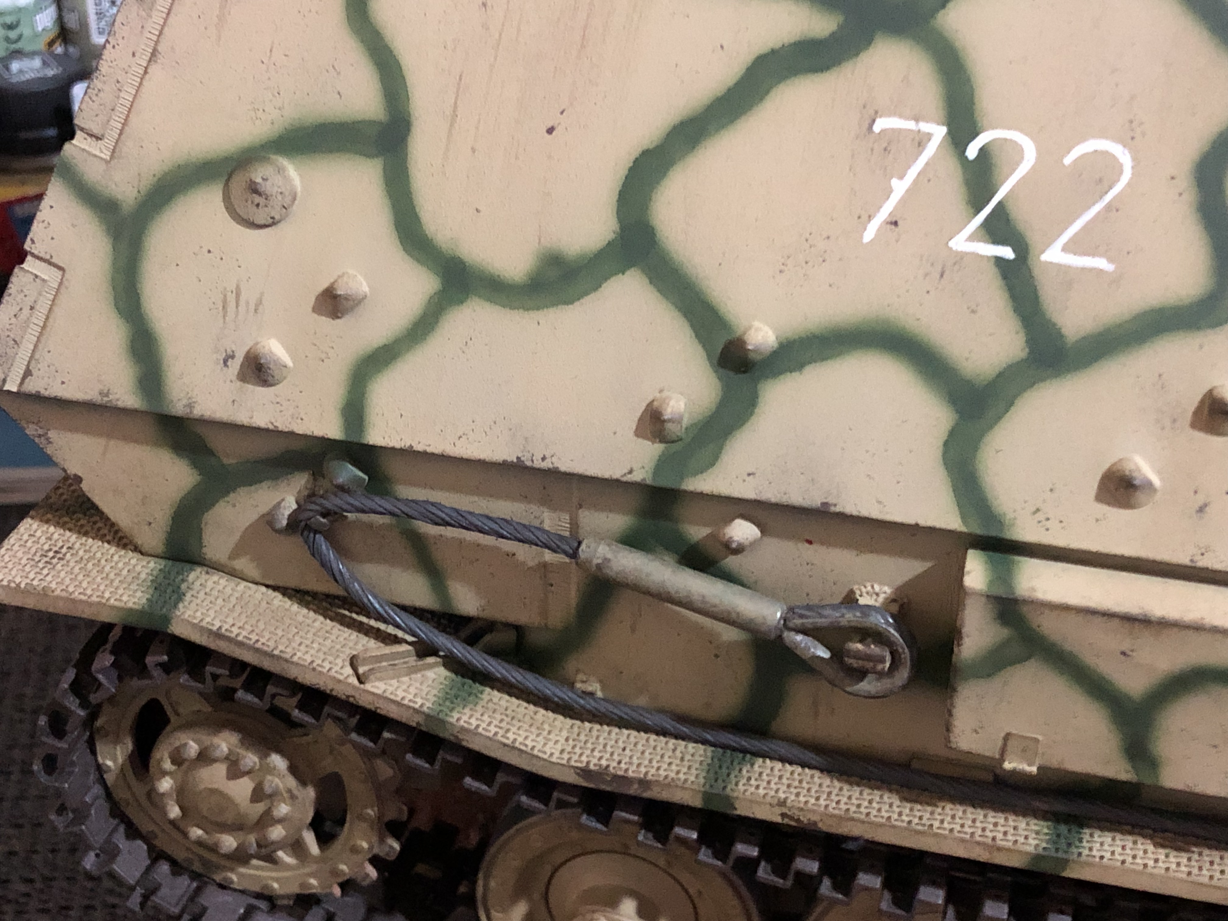

Tow cables fitted.
Had to be shortened a wee bit which is easy enough with a drill to remove the glued end slugs out of the ferrule.
Painted with remnants of spray bombs TS 38 and TS4, then brushed with straight XF-63 German Grey until saturated.
The ferrules and loop eyes were touched up with dunklegelb then blended then washed.
Bent to shape & spot painted any exposed copper showing & went over them with track wash MiG 1002.
Set in place with spots of gel super glue where required & left the front ends secured only by the clip on shackles so I can access inside for inevitable maintenance.

Really like how youve done the tow cables :thumbup:

Stormbringer wrote: Sun Oct 19, 2025 12:08 am Really like how youve done the tow cables :thumbup:
Cheers Mr Stormbringer, they are not easy to do actually!
The paint just bounces off them ?!!
I always burnish them with a flame burner before paint
