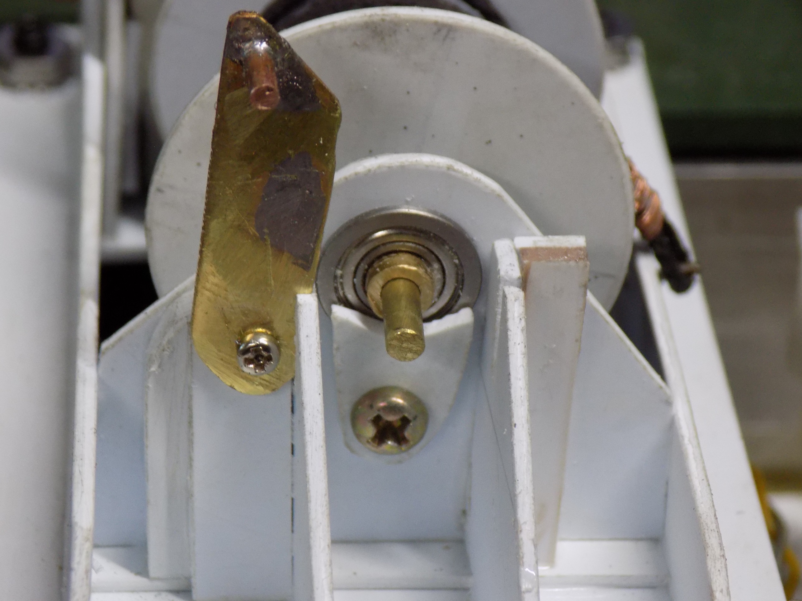

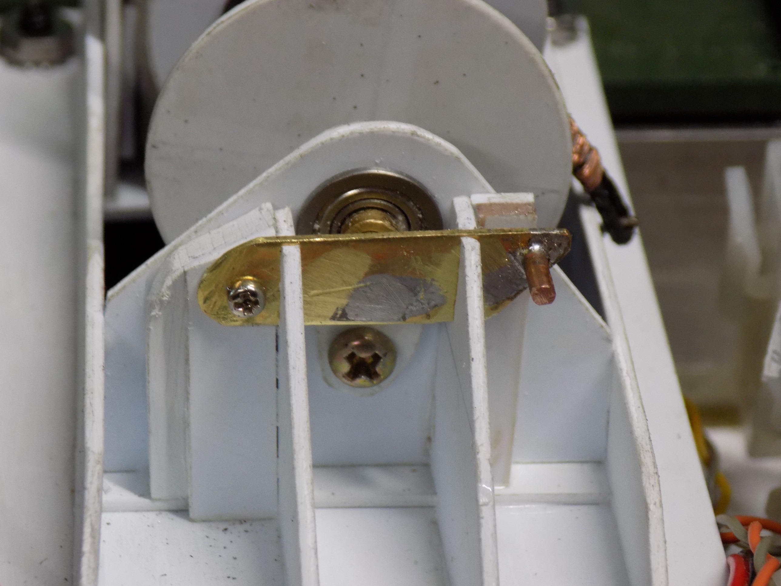

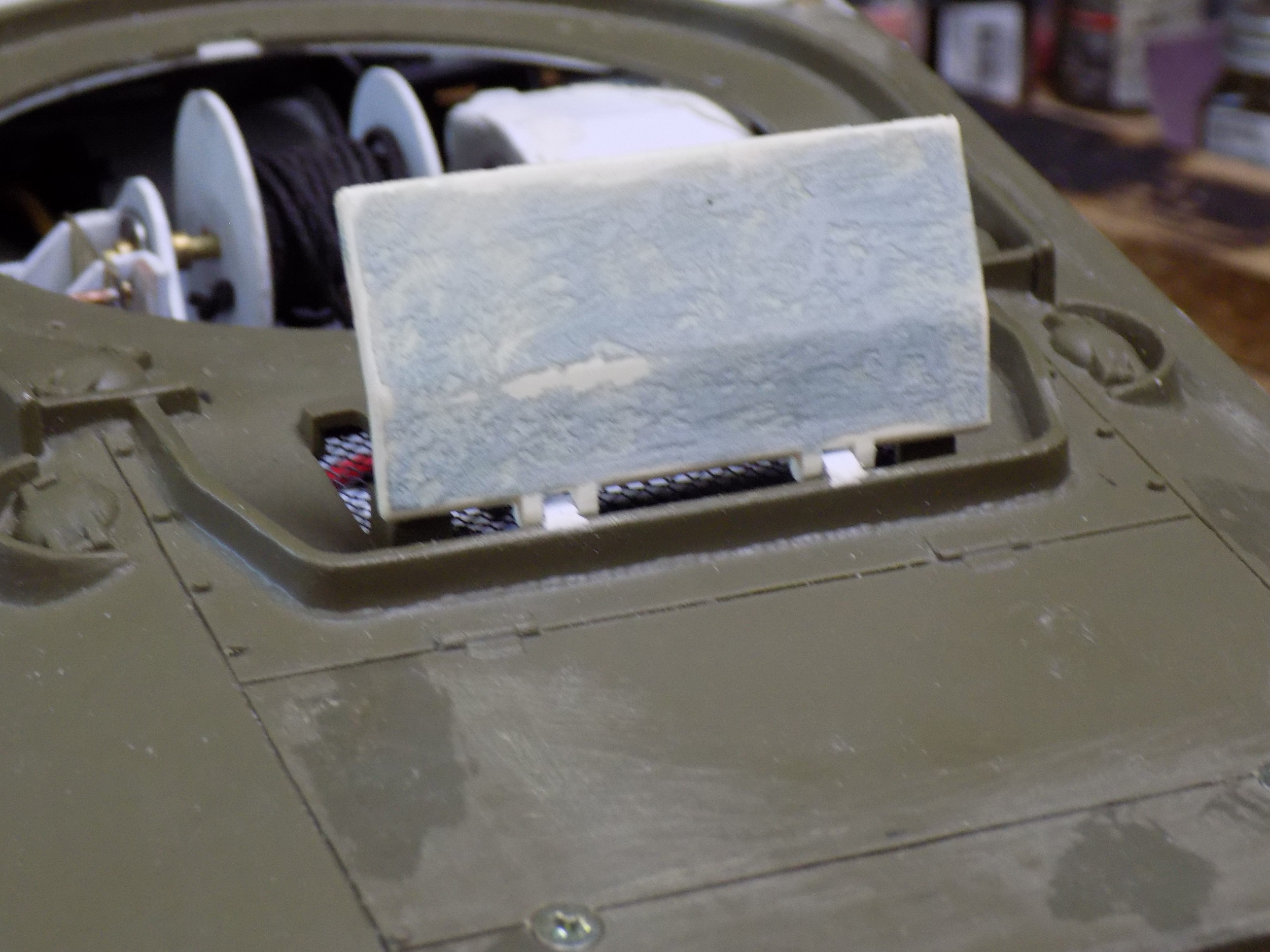

So I had an idea to make the free wheeling winch a bit easier. Using a hook it will be possible to route the cable though any of the three openings. The hook will also be used to raise the "gate". The big phillips screw is my bearing retainer (flanged). And I never mentioned that because this is a Tamiya control system, the winch speed is proportional (can be really slow, the earlier video was basically full speed).
- M32 127.JPG (1.05 MiB) Viewed 65 times
- M32 128.JPG (1.15 MiB) Viewed 65 times

I'm sorry Eric I must admit I had to look at your picture and reread your post several times to understand what you meant. Do I understand that if you open the "gate" you may use different gearing ratios? Tiny ingenious mechanics elude me. But seeing what you scratch build continues to impress and motivate me.

MrChef wrote: ↑Wed Dec 06, 2023 4:21 pm
So as an alternative to having a charged battery on board and using the system to spool the cable in and out....
I started with a hard to access clip and then on to the gate that with the gate closed (or clip in place) the drum is engaged with the motor's drive gear. With the gate open I can move the drum away from the motor about a quarter inch putting the drum in free wheel mode (neutral) allowing to hand wind/unwind the rope.
Ooooohhh OK got it... Genious!

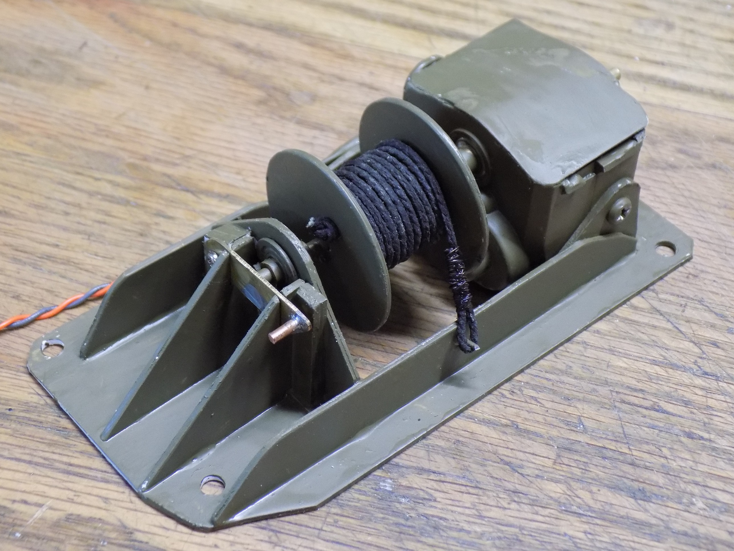

If it wasn't clear from the pictures, the winch assembly is removeable. I measured the cord when I had it off for painting, it's six feet (about 2 meters) long.
- M32 131.JPG (1.41 MiB) Viewed 64 times

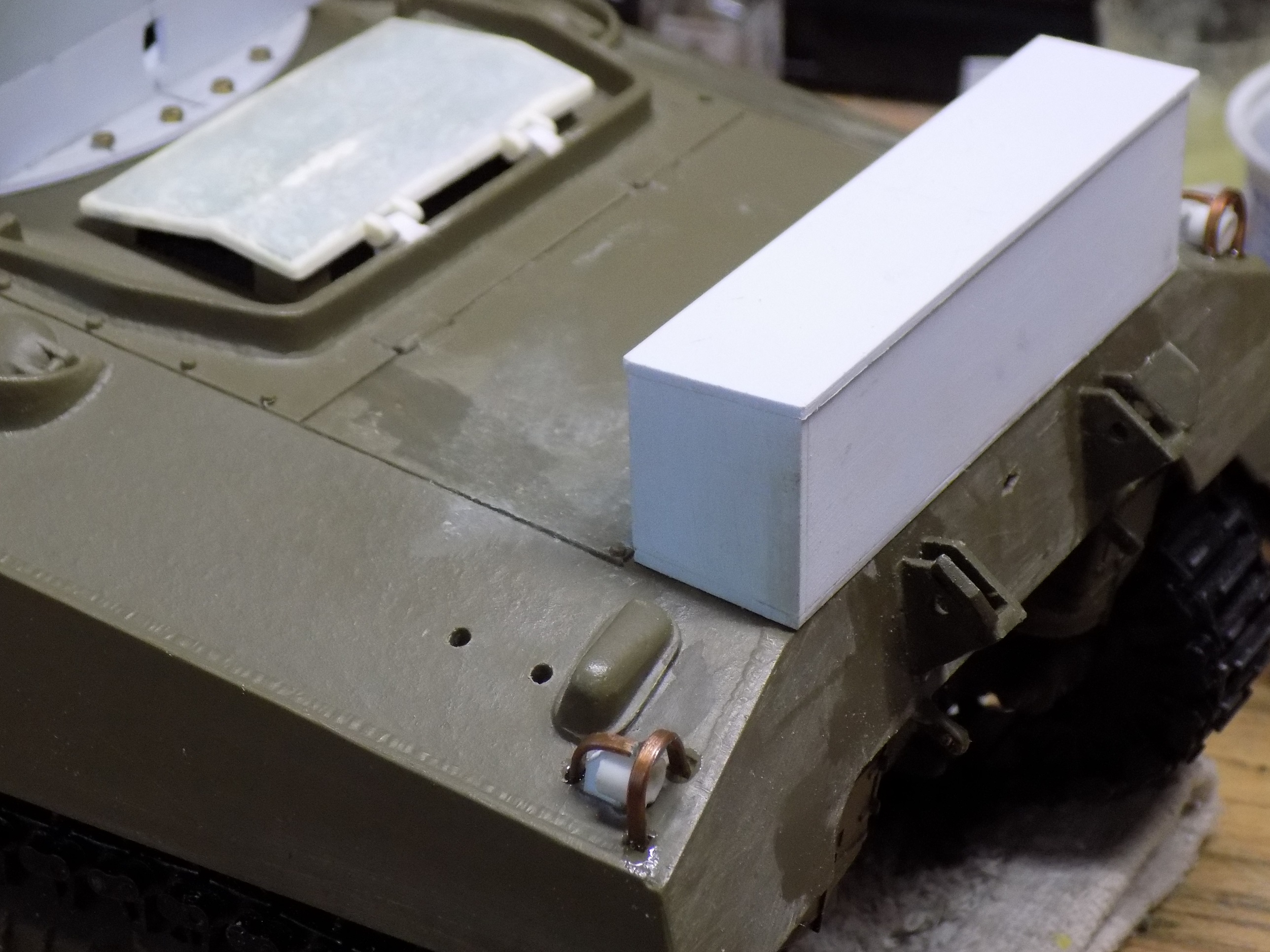

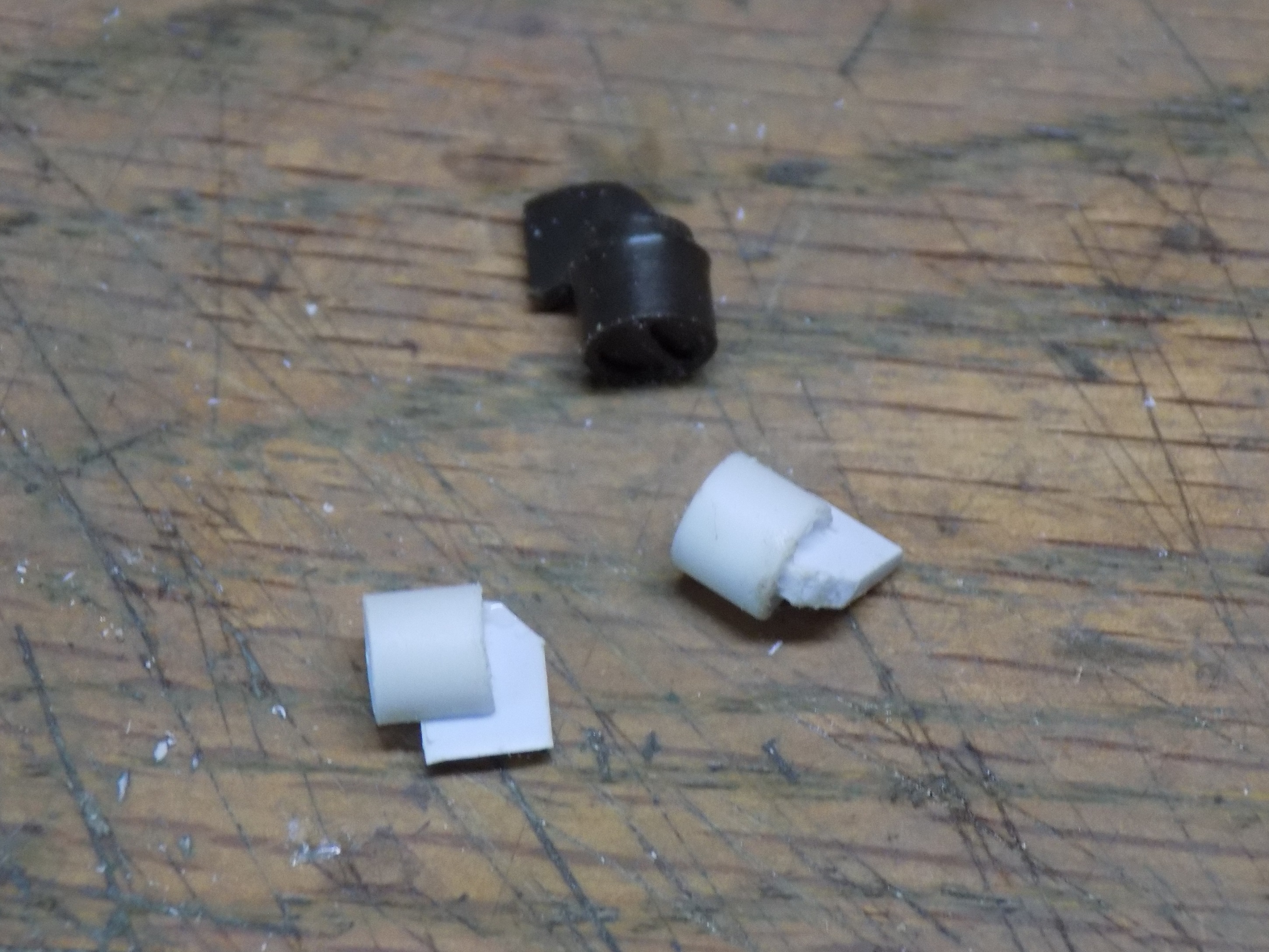

For whatever reason, I have only one Tamiya tail light. The H/L versions are awful so I made a couple stand ins. The rear guards are epoxied. Started the rear tool boxes, pictured is the third version. Remember, this whole build is without "plans/blueprints", I am only using reference pictures to pull this off. I cut my original box down two times to arrive here. There are two pins that are epoxied to the hull and the box has a friction fit.
- M32 130.JPG (1.49 MiB) Viewed 64 times
- M32 132.JPG (1.18 MiB) Viewed 64 times
