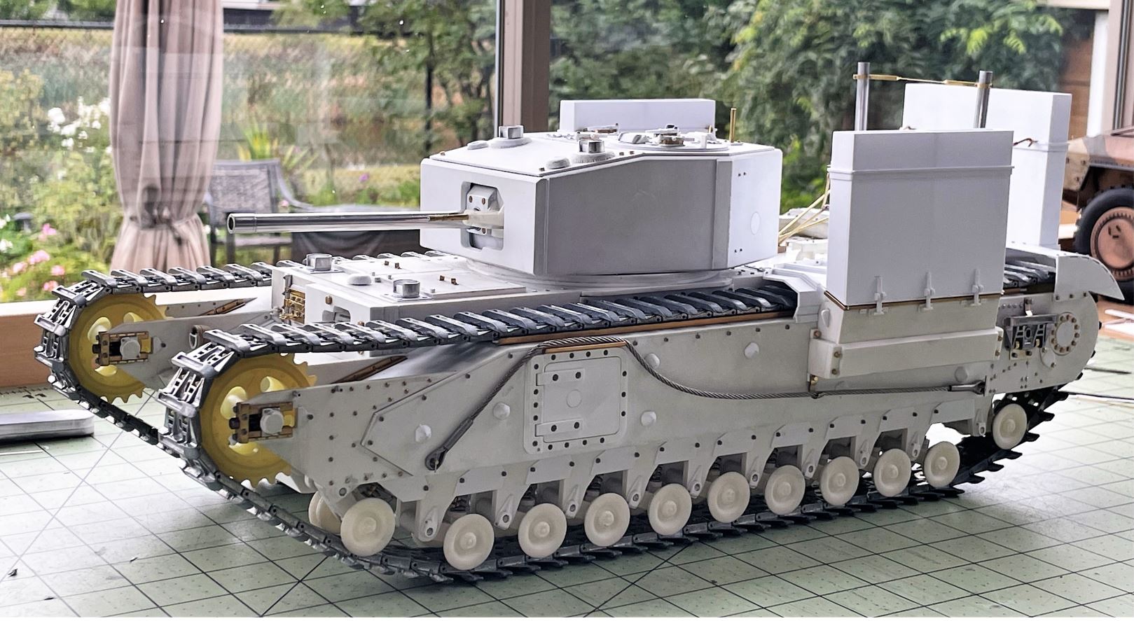

With these following posts concerning added details, deep wading equipment and crew, the construction phase is completed.
I decided that the Churchill could be displayed at different phases of the raid;
- With crew on turret and with all deep wading stacks up during embarkation and on the TLC (Tank Landing Craft) prior to closing the hatches on the final approach when the enemy shooting started.
- With deep wading stacks without crew on turret.
- Without crew and deep wading stacks, other than exhaust that was no jettisonable.
- Crew escaping the vehicle through side doors

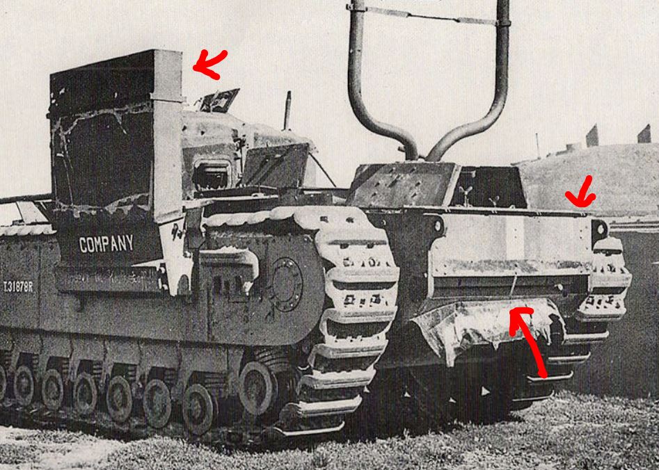

The AFV Club kit provided good reference of the air intake and engine compartment deep wading equipment and attachments.

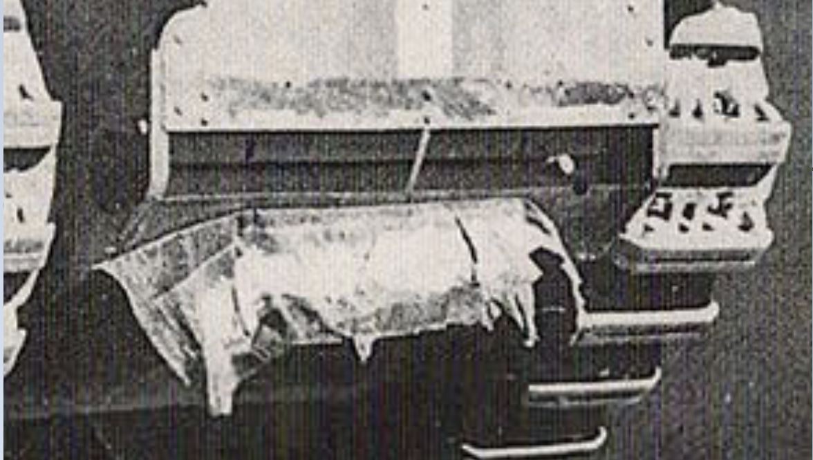

Upon landing on the beach, the crew had a mechanism to jettison the air intake and engine ventilation stacks on the sides and rear. In some cases, the jettison device was not successful and created issues. In addition to the left stack still in place, this picture provides added detail about a metal plate at the rear and also a support for the engine ventilation stack. You can see remain of the waterproofing material as well.

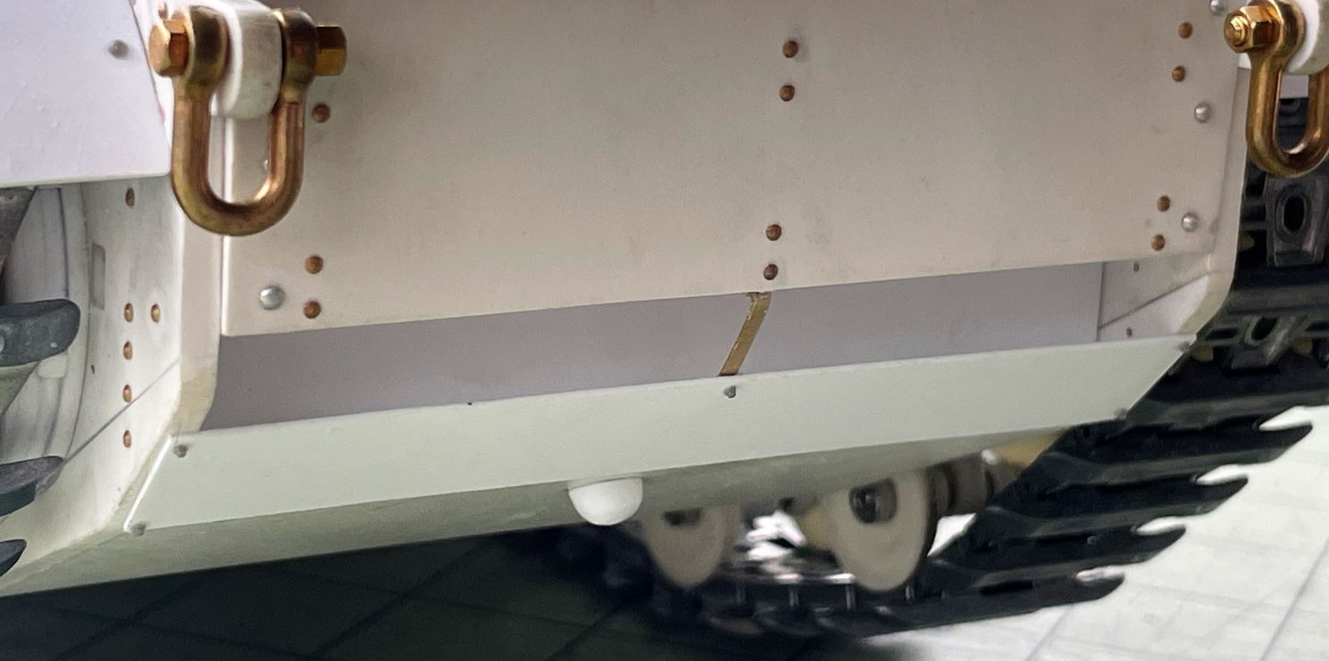

Looks like a light metal sheet plate is bolted to the bottom of the hull, under the remaining water proofing canvas. It features a thin bracket in the middle.
Reproduced

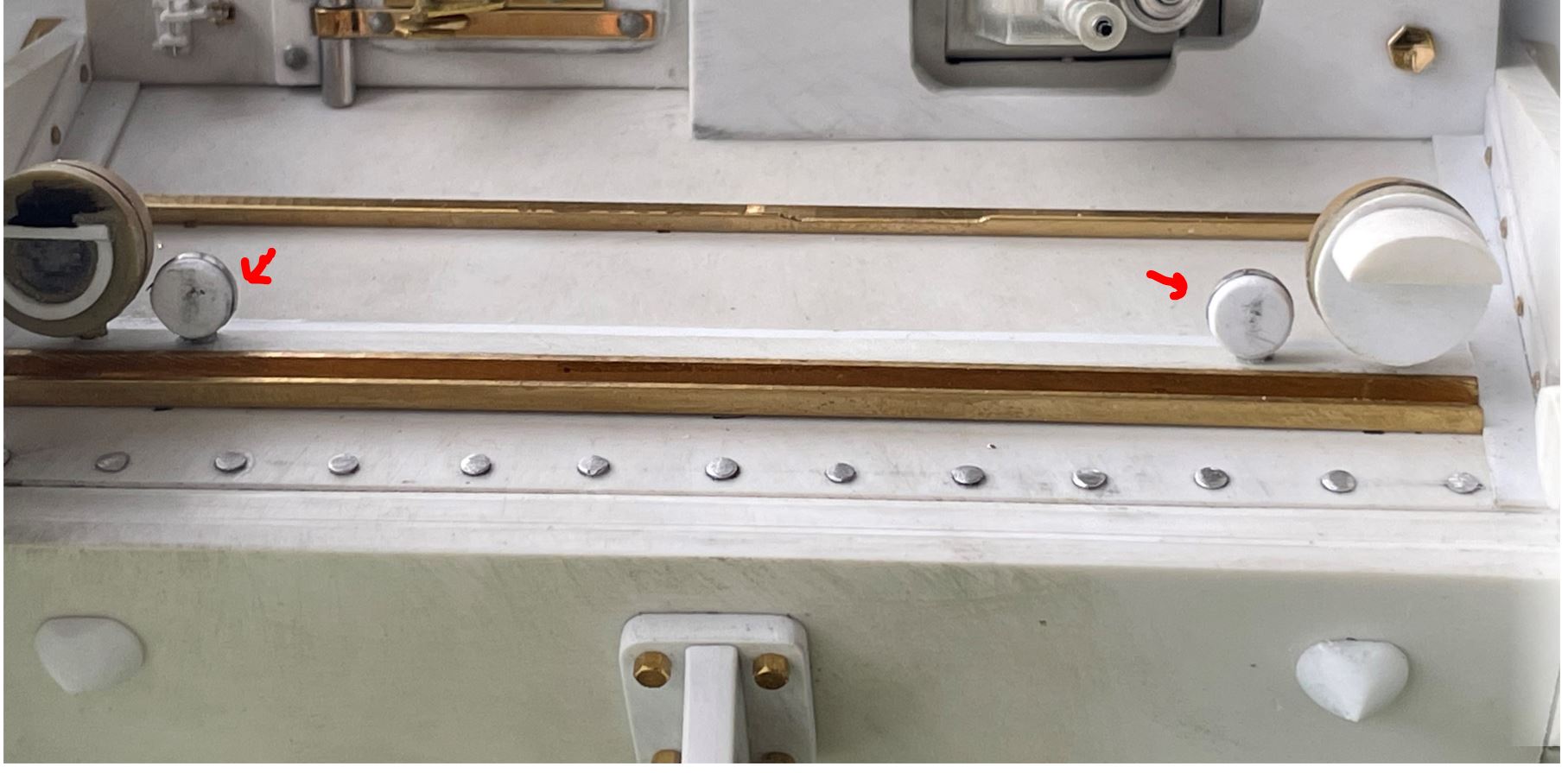

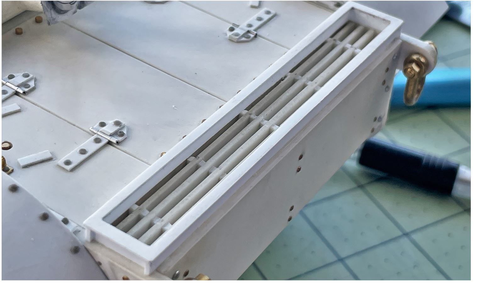

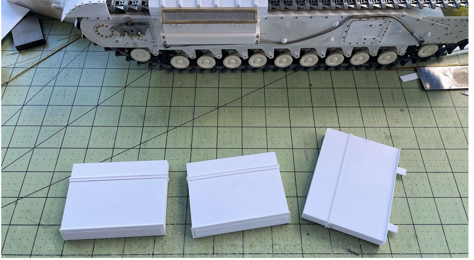

There is a base for the engine ventilation stack that is permanently attached to the hull.
Reproduced

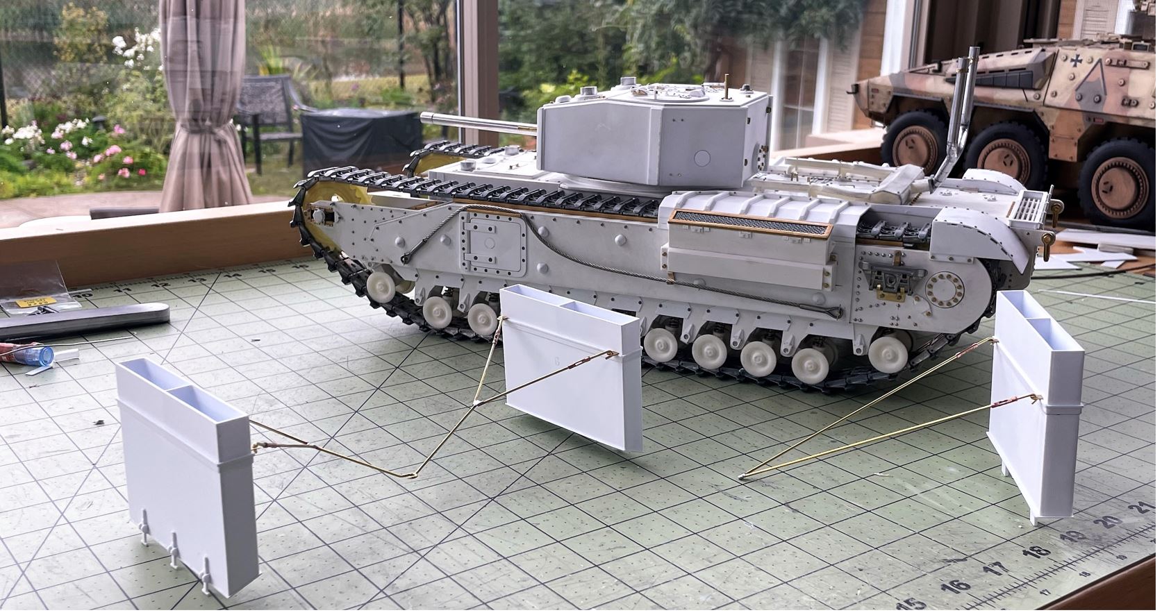

Added positioning lights at the front.

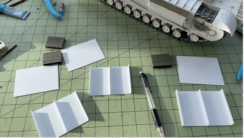

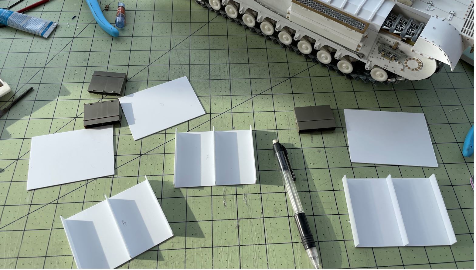

Construction of the stacks. They are square and easily reproduced with the right measurements.
Reproduced and ready for the design of the attachments.
continuing on following post

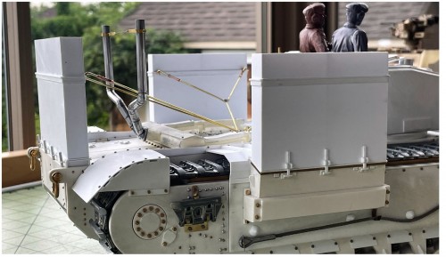

Re: RC 1/16 Churchill Mk III - Dieppe Raid 1942 - Build

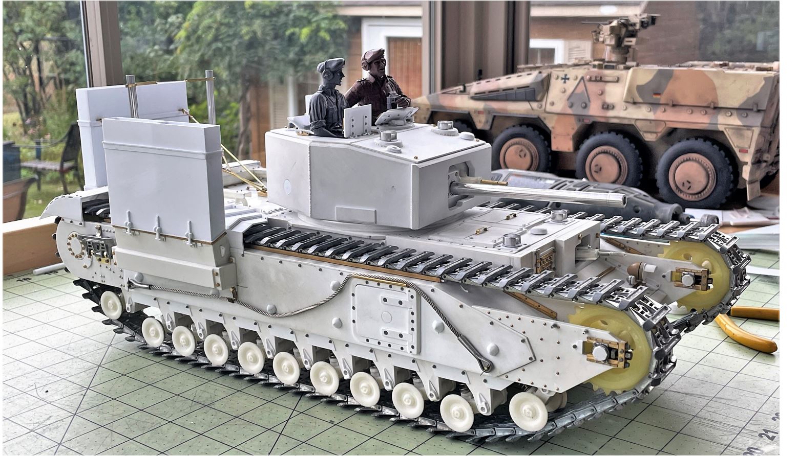

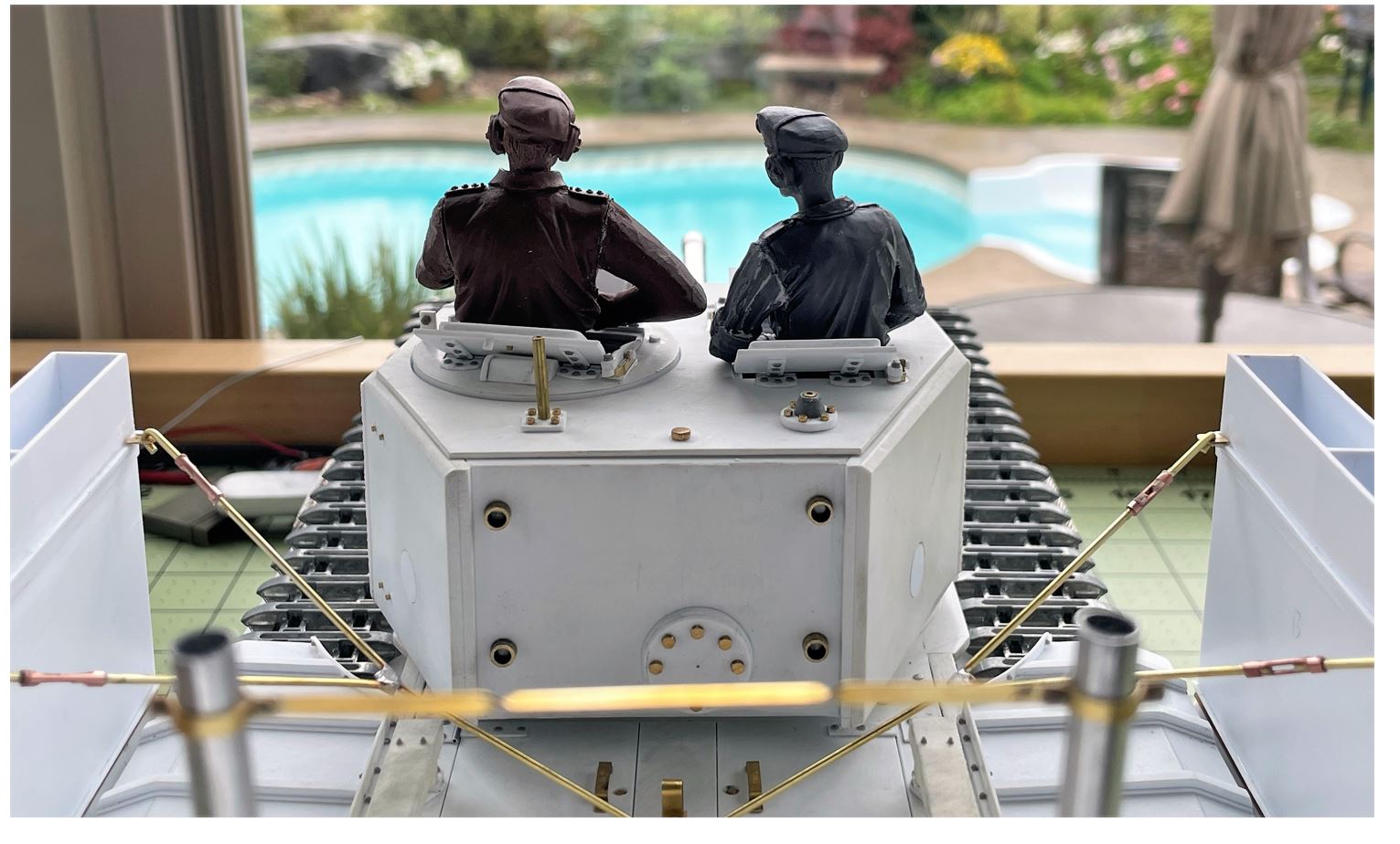

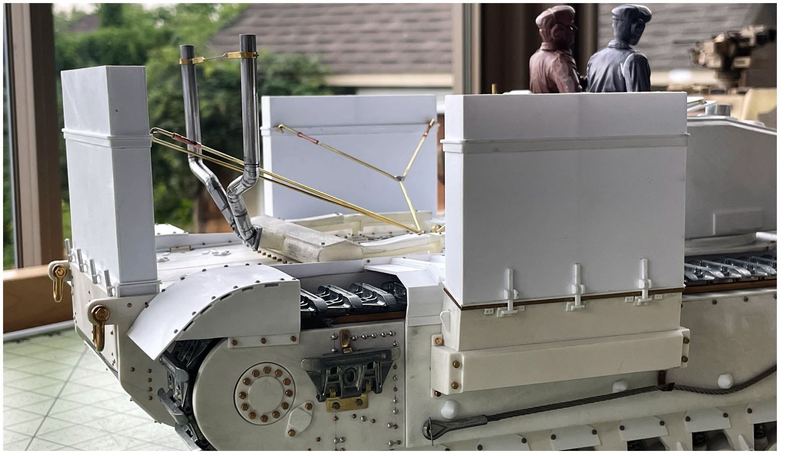

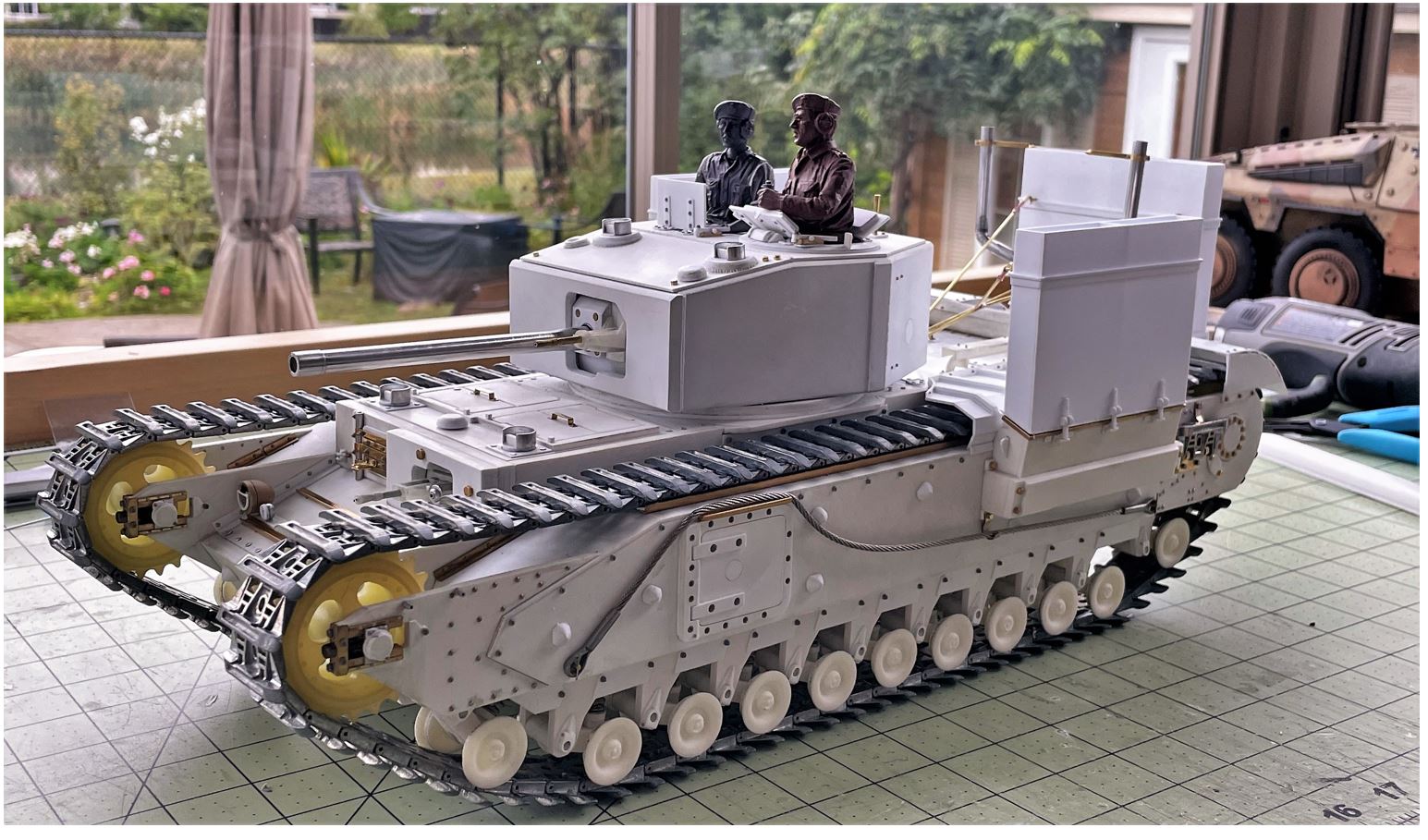

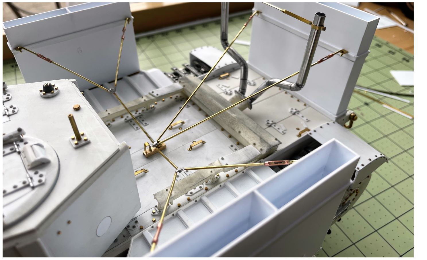

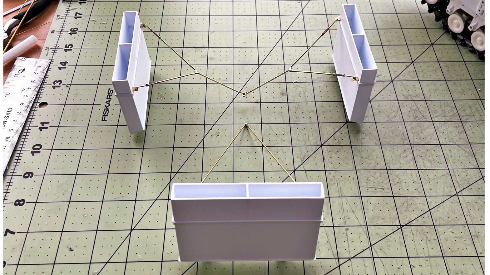

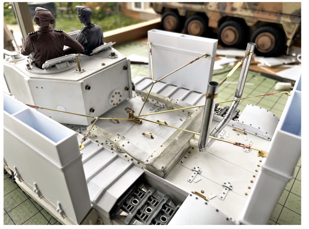

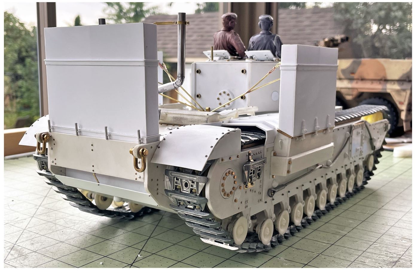

Views of the Churchill Mk III with complete deep wading equipment.

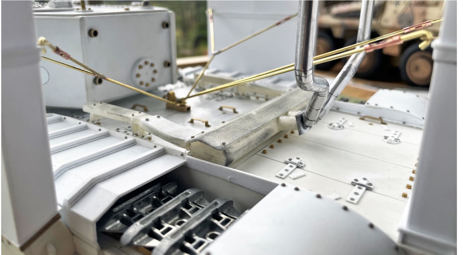

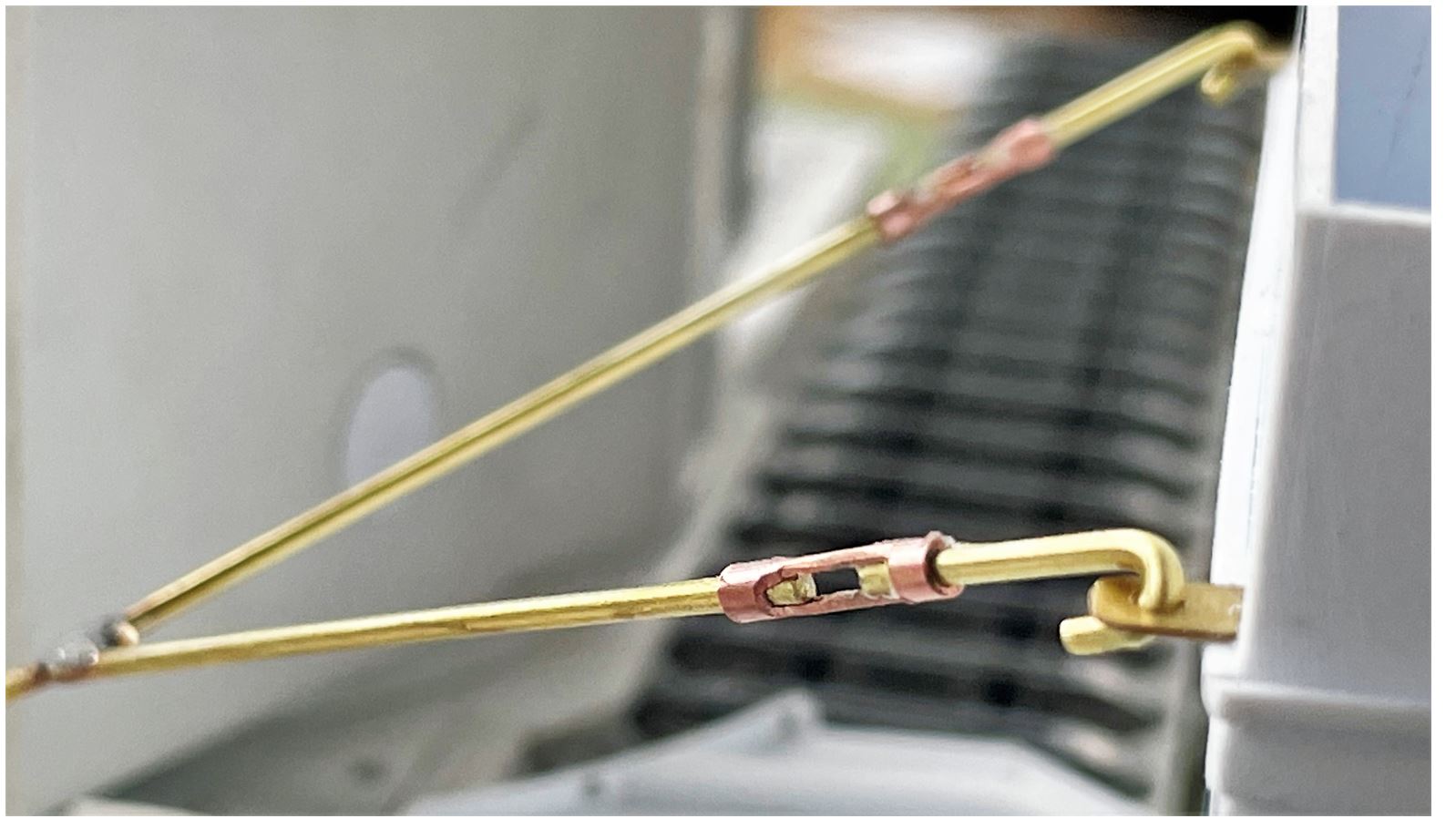

It was very tricky to repro the cabling, fastening rods and attachment. My patience was extended to its limits. These were very small in pictures and 1/35 kit, and originals of these obviously did not survive the war.
The deep wading stacks are of course removable. Some very talented individual could one day make the release mechanism functional, but there would be a lot of complexity in it.

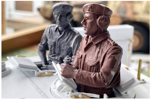

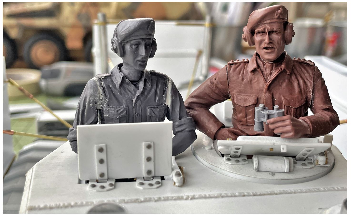

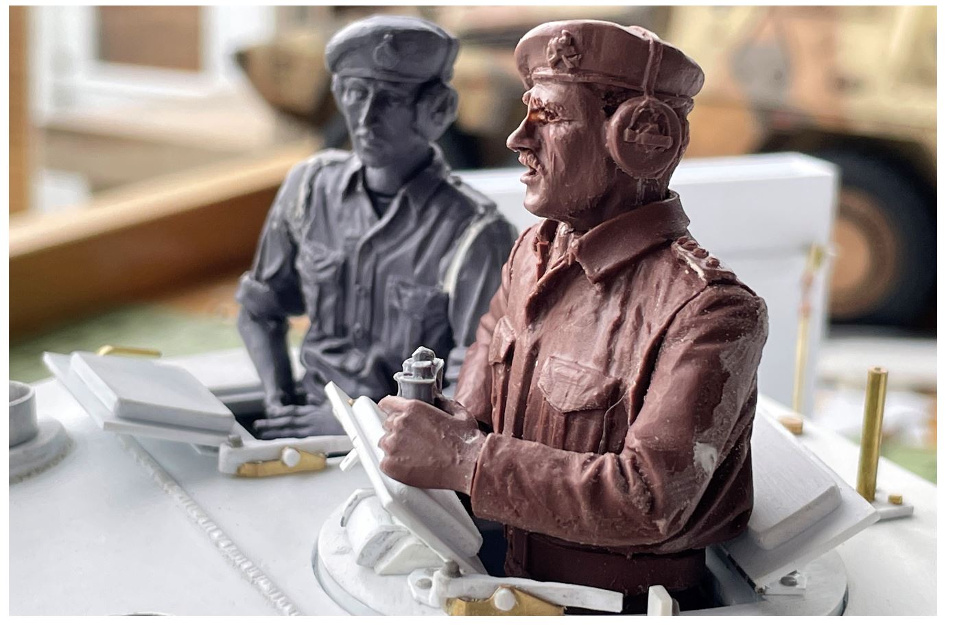

These are DGS commonwealth tank crews. They look good and i appreciate the apprehensive anxious expressions. They fit well but the body of the gunner on the right side is too short to properly hang on the turret like this on a wide hatch. I will have to extend the length of the body a bit. I also removed his cup of tea he was holding. Pretty sure he had other things in mind prior to hitting the beach.
Such view on tank crews on Dieppe raid standing on the turret hatches open would only have happened for the embarkation on the TLC and during the channel crossing. The crew got inside and closed the hatches when the TLC began receiving hits. The accompanying sapper units and RN TLC crew were not that lucky and were massacred by concentrated machine gun and mortar hits. The tank crew would not have lasted one second hitting the beach without being fully protected by the armor.

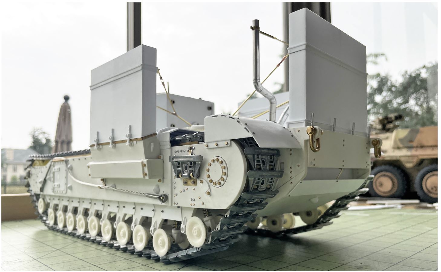

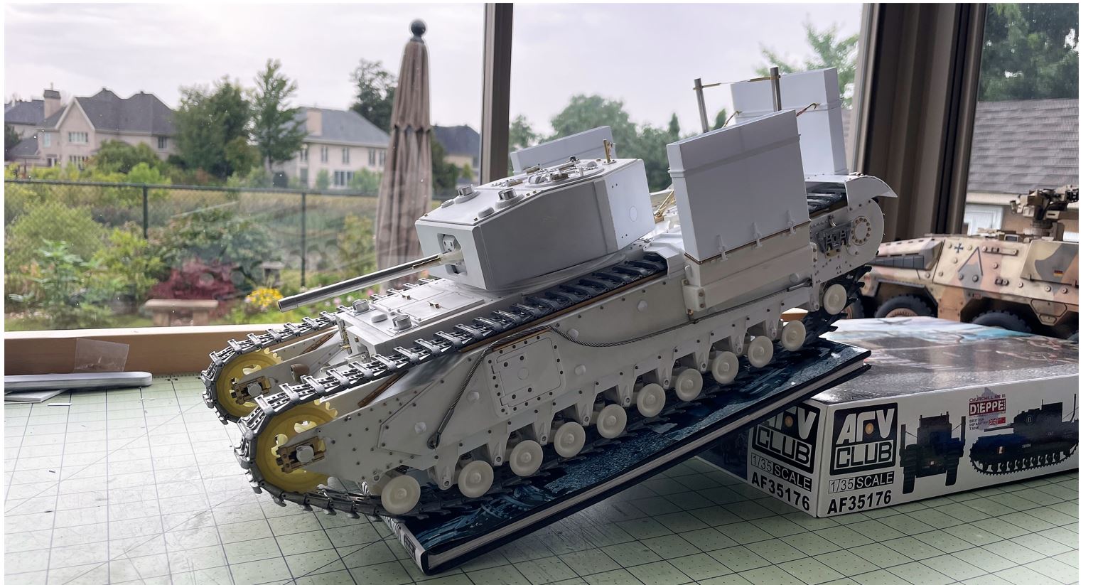

Additional views of the completed Churchill Mk III with deep wading equipment and crew.
Simulating the tank going down the TLC ramp.
Its one thing to start a Churchill build, its another to complete it. I am very happy with the results a was able to achieve during the construction phase. I must say that there is very little of the original Ludwig kit parts remaining apparent. But they got me to start the build and now i have a Churchill.
