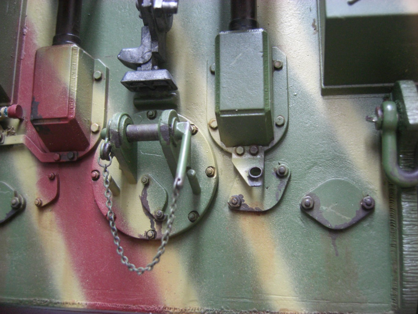

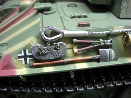

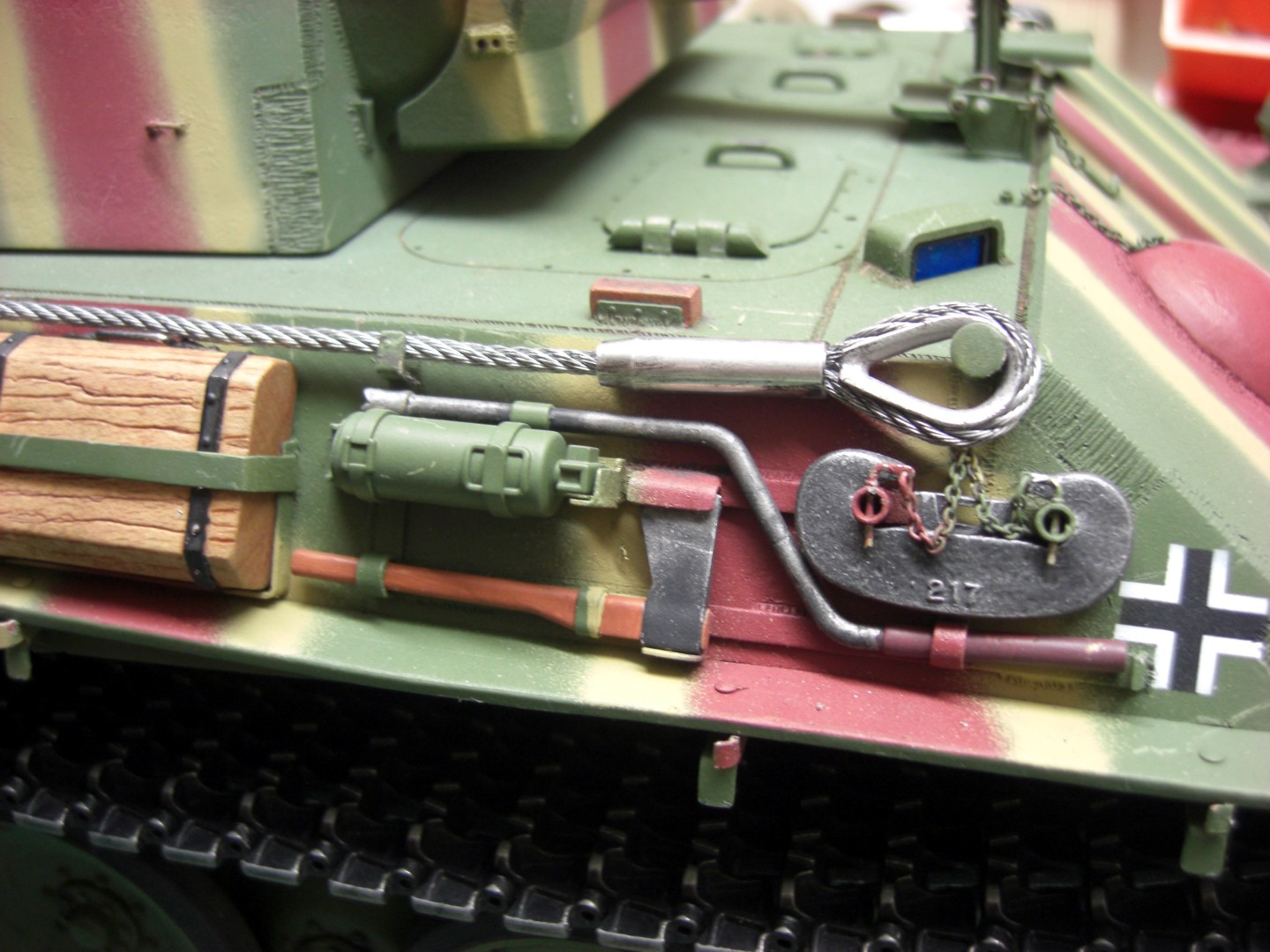

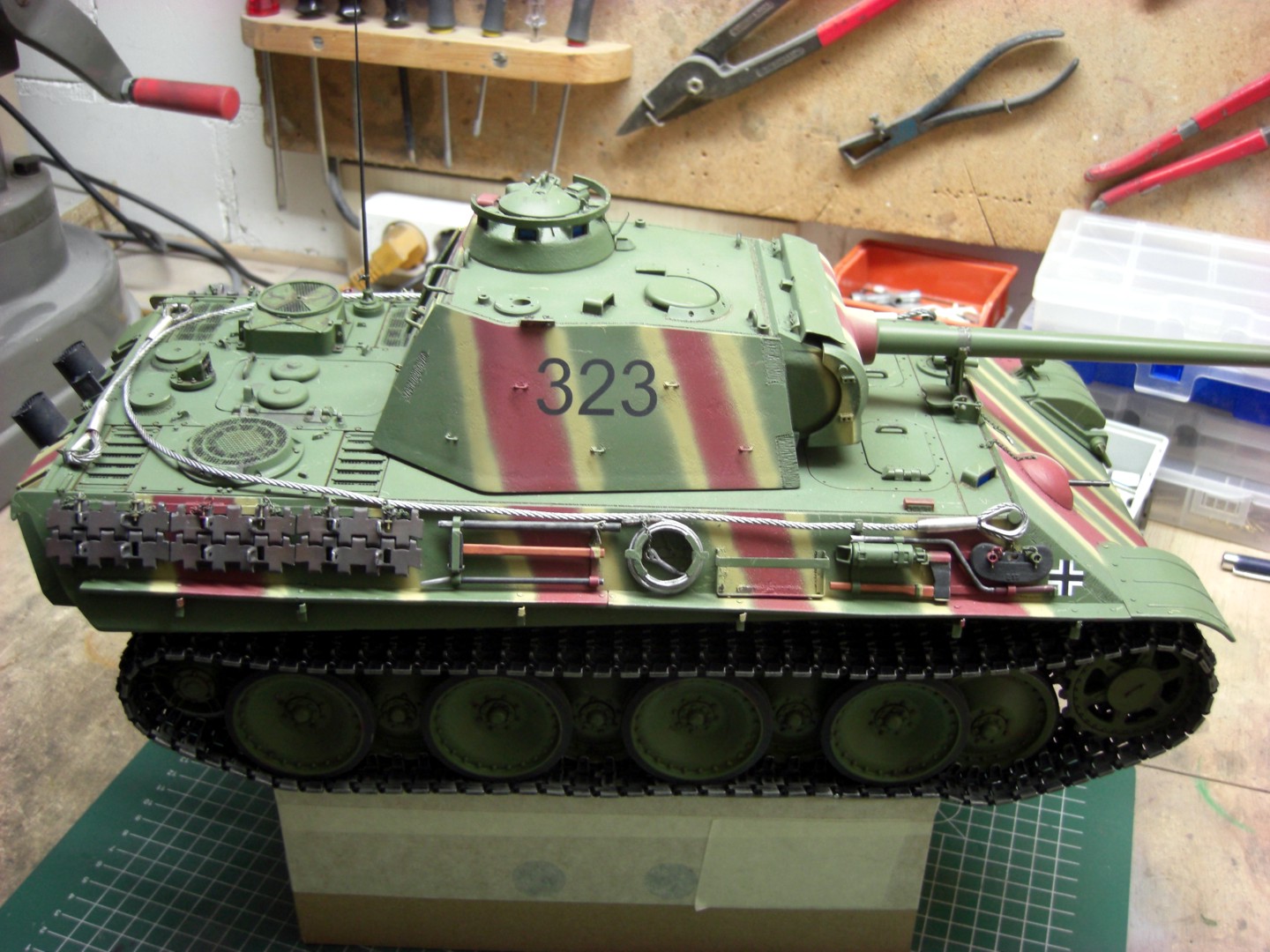

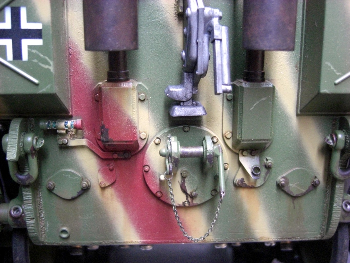

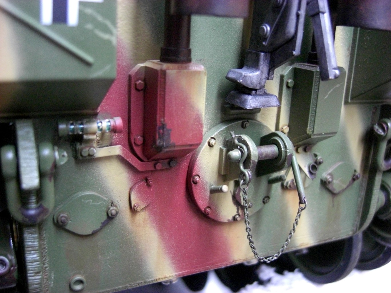

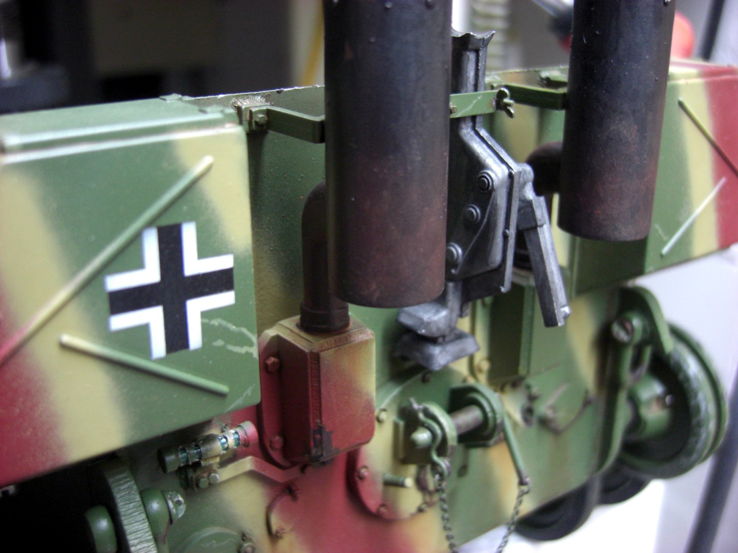

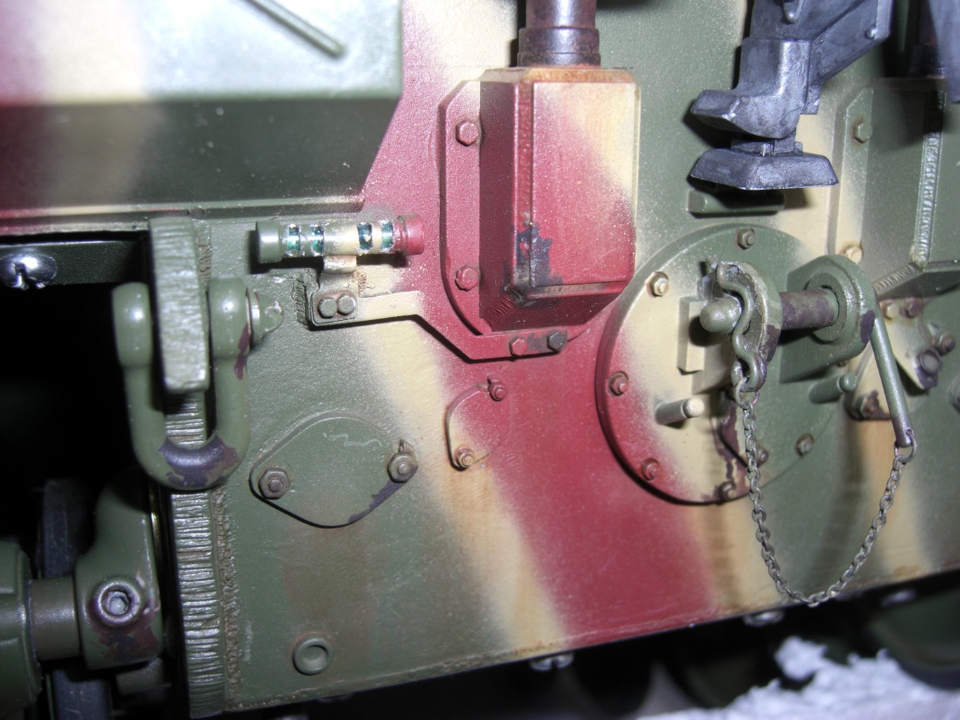

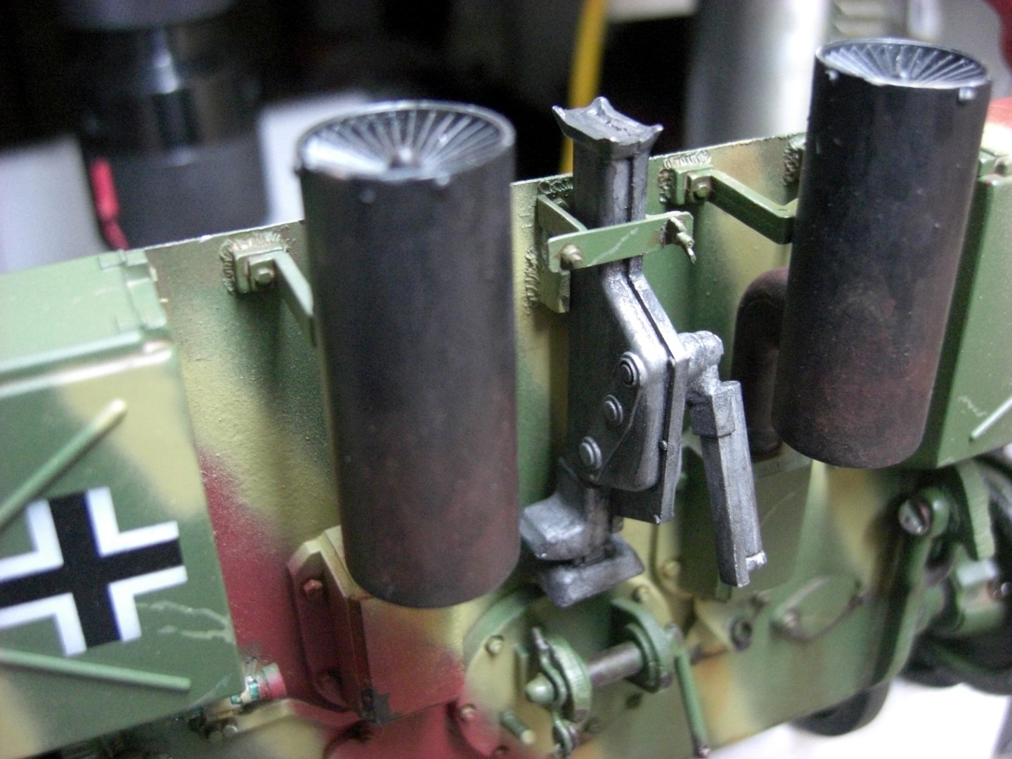

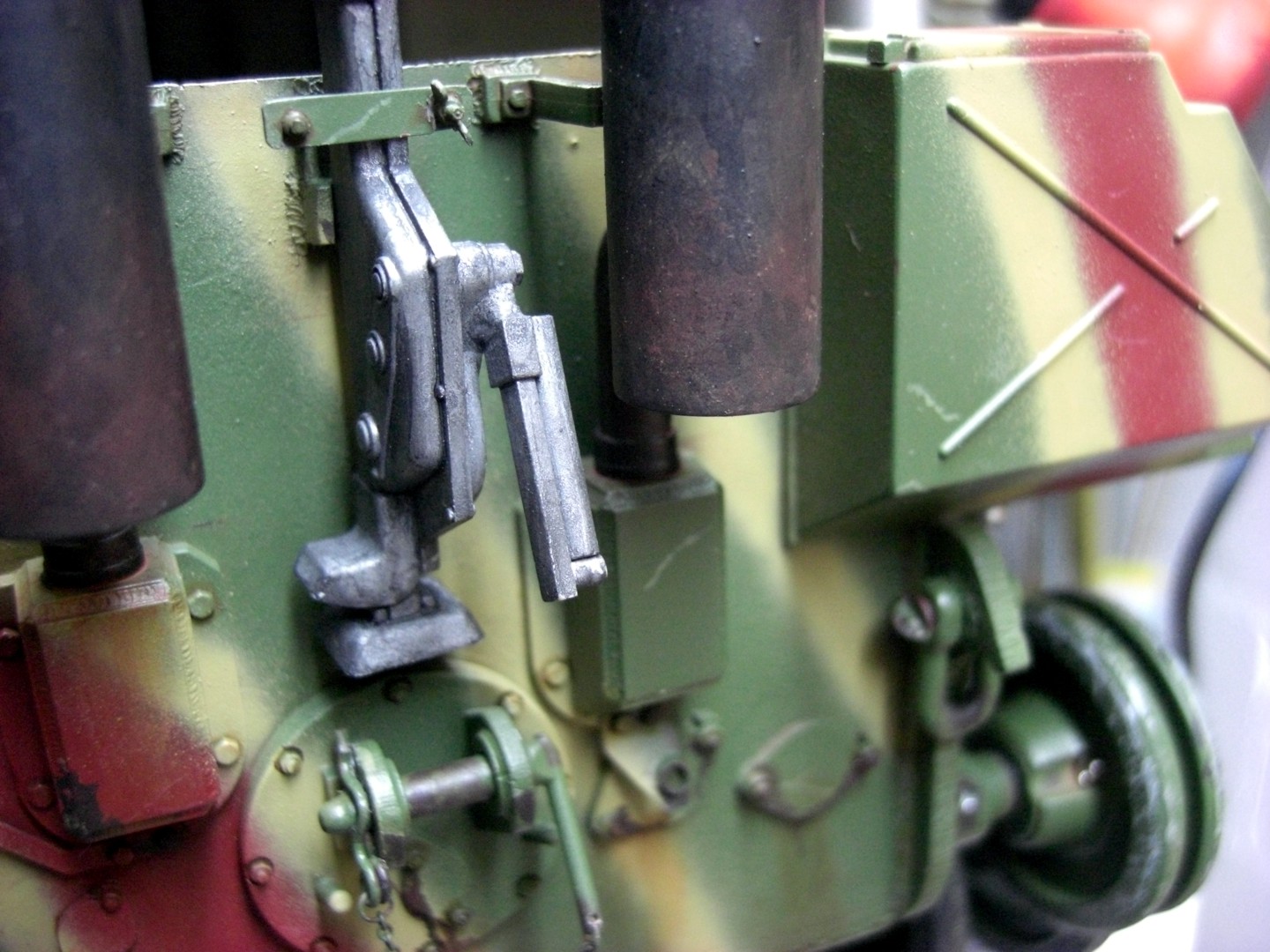

After the exhaust system, it goes straight on at the rear plate. Here I've added a few more signs of aging, a few runners, but again very discreet.
Much is there not to say, so again only pictures...
This was also again only a little step and I think the time of big steps is now again ended...

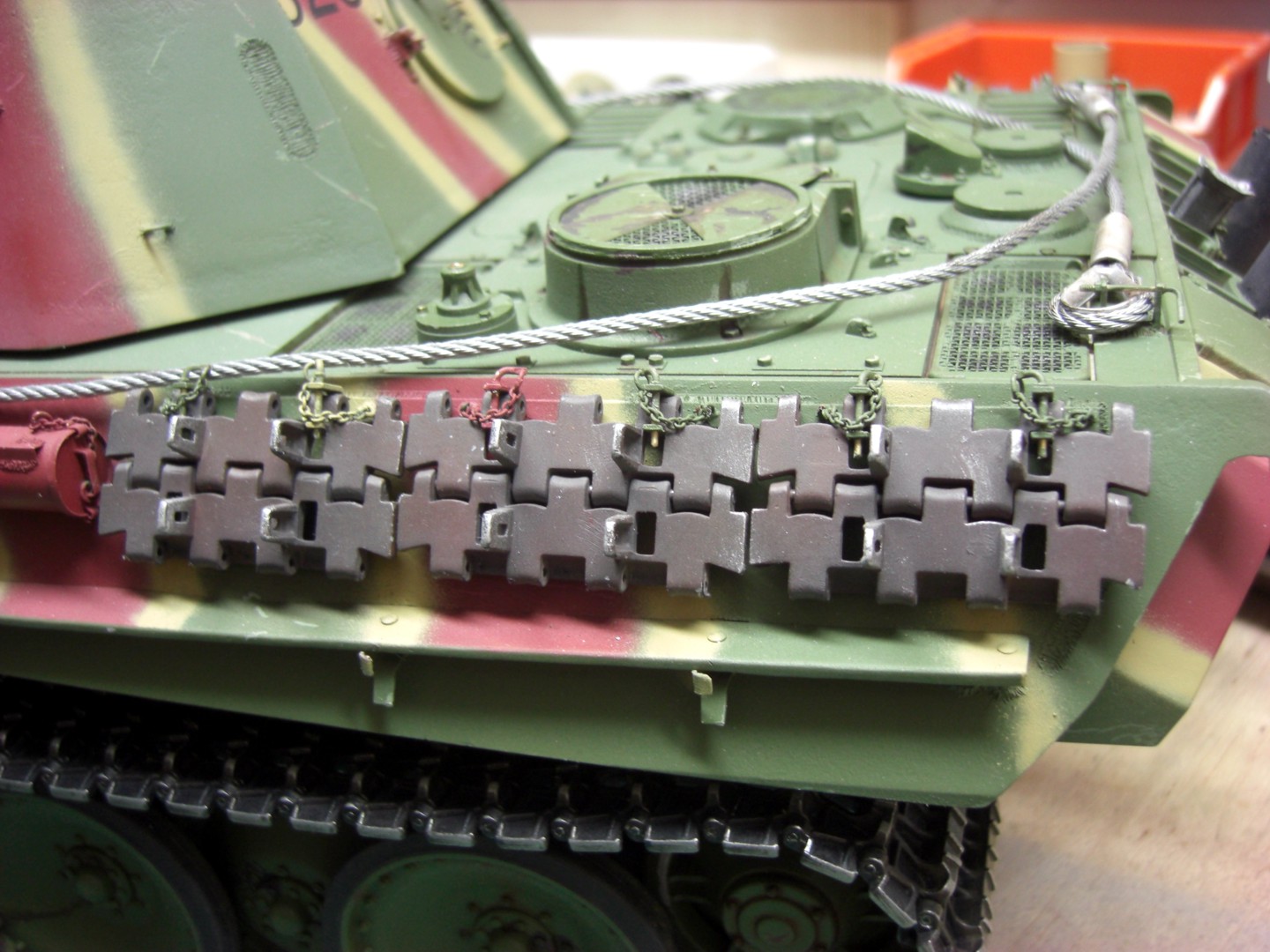

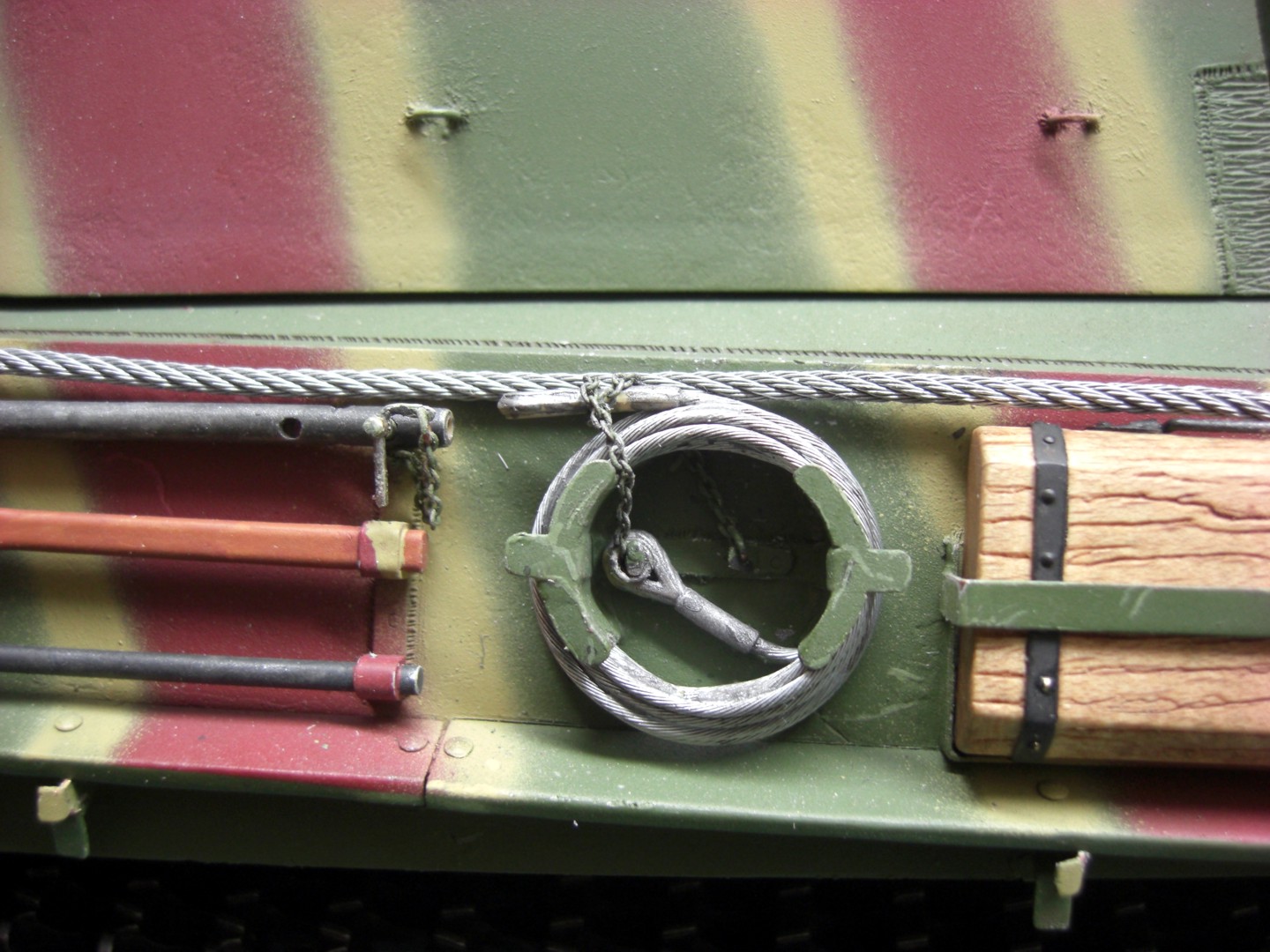

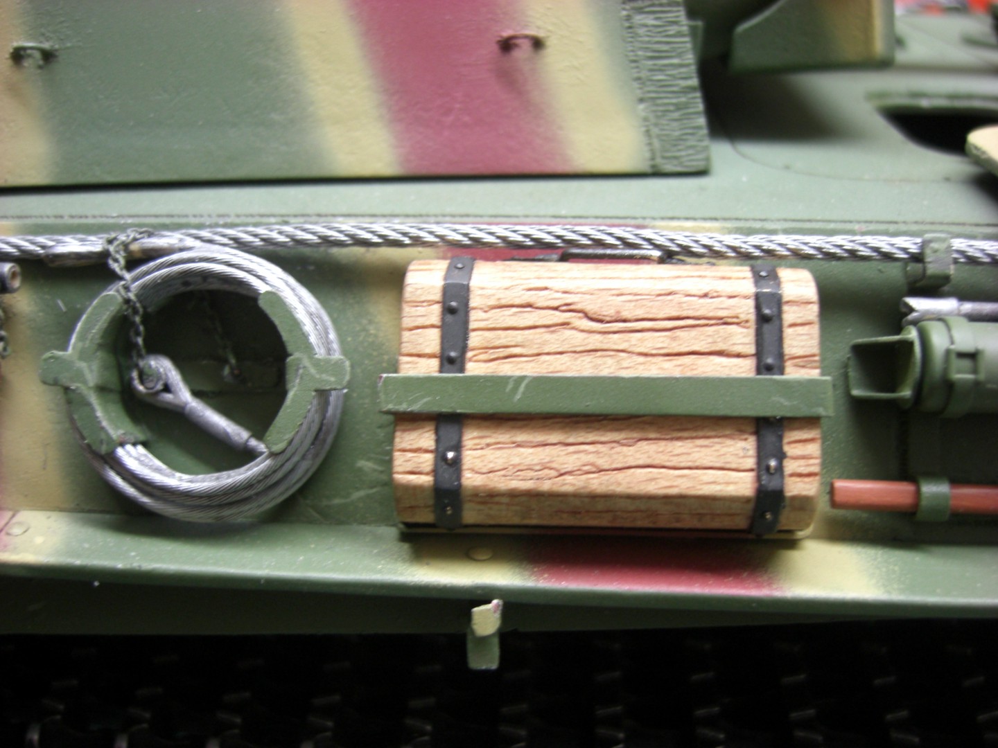

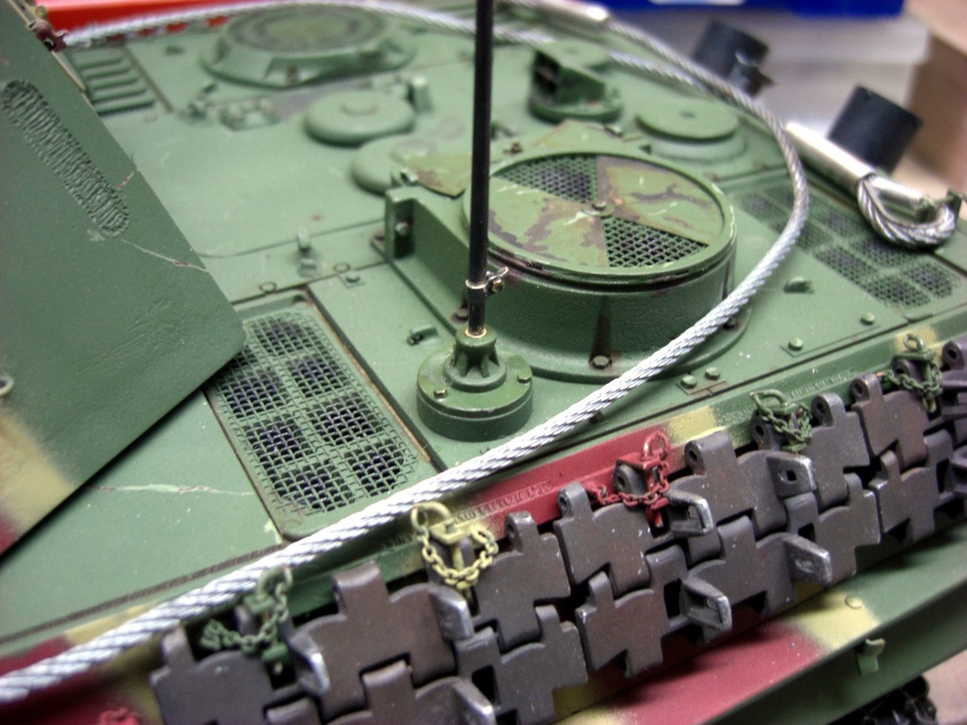

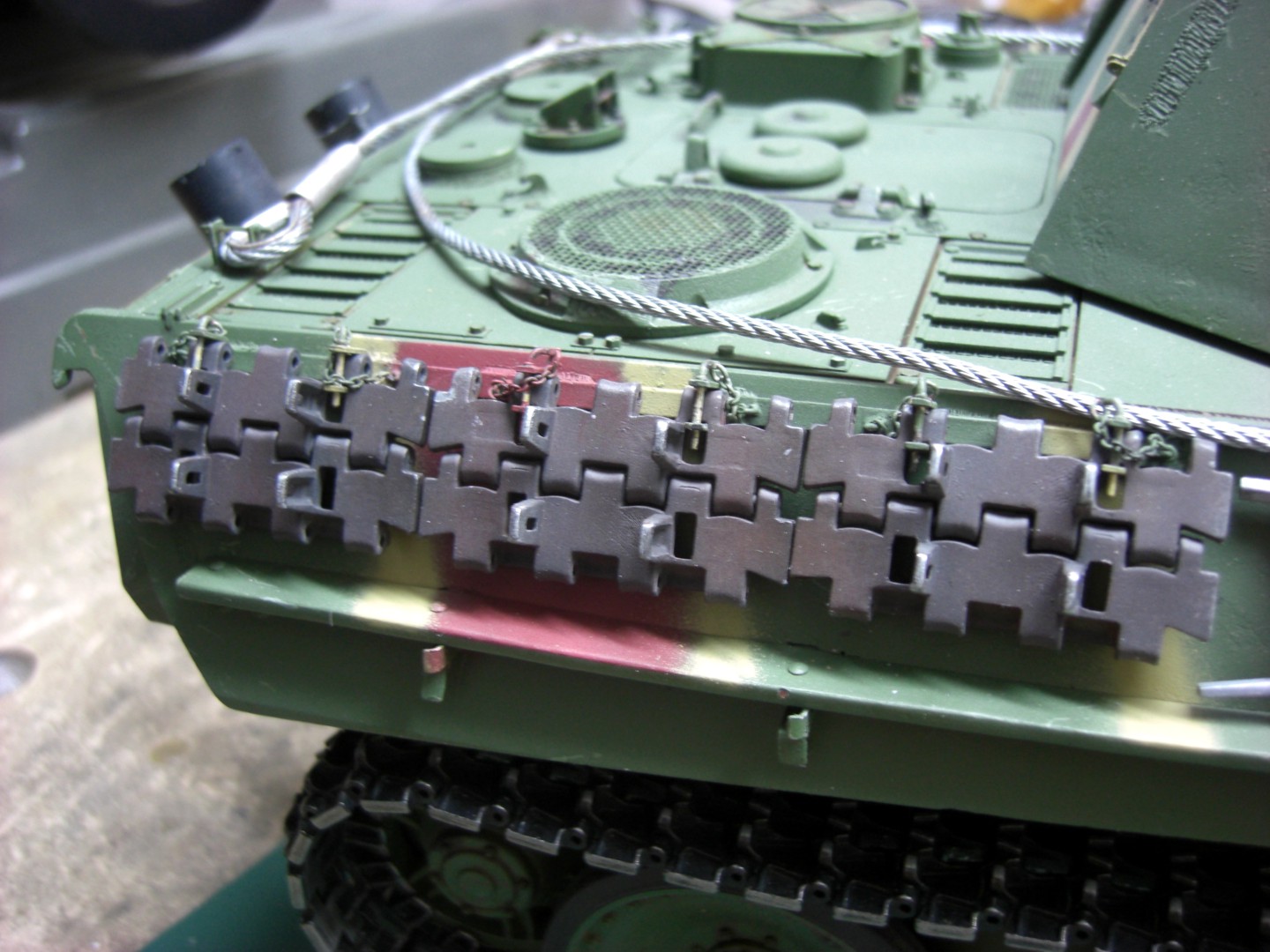

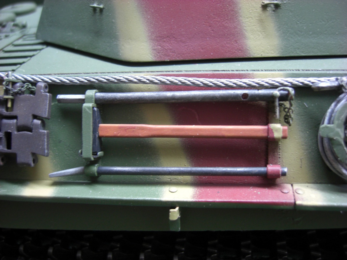

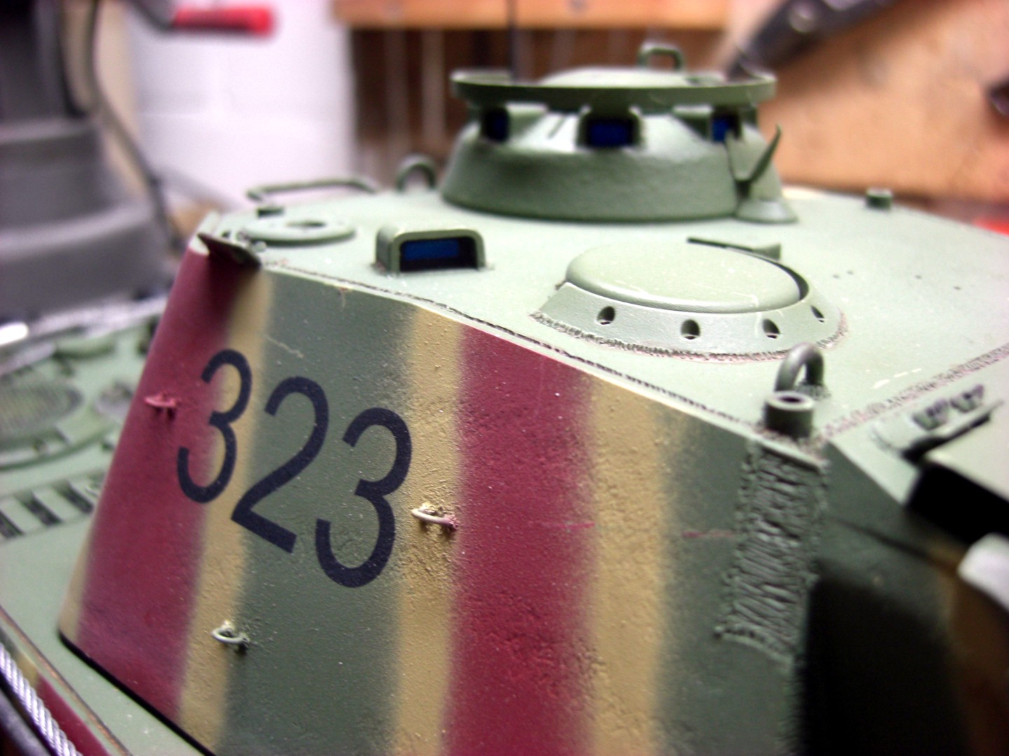

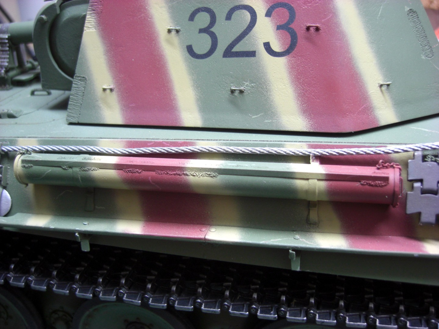

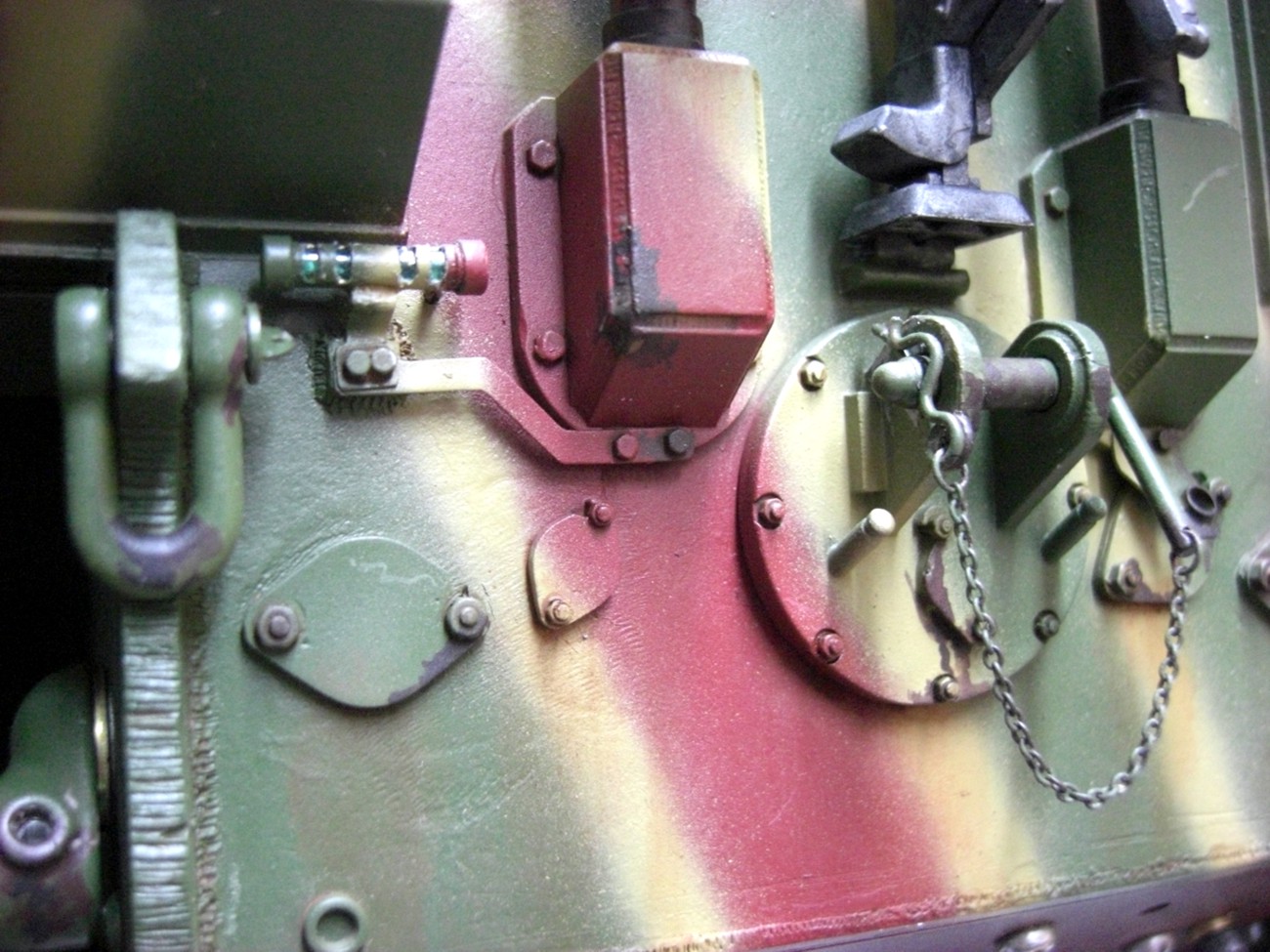

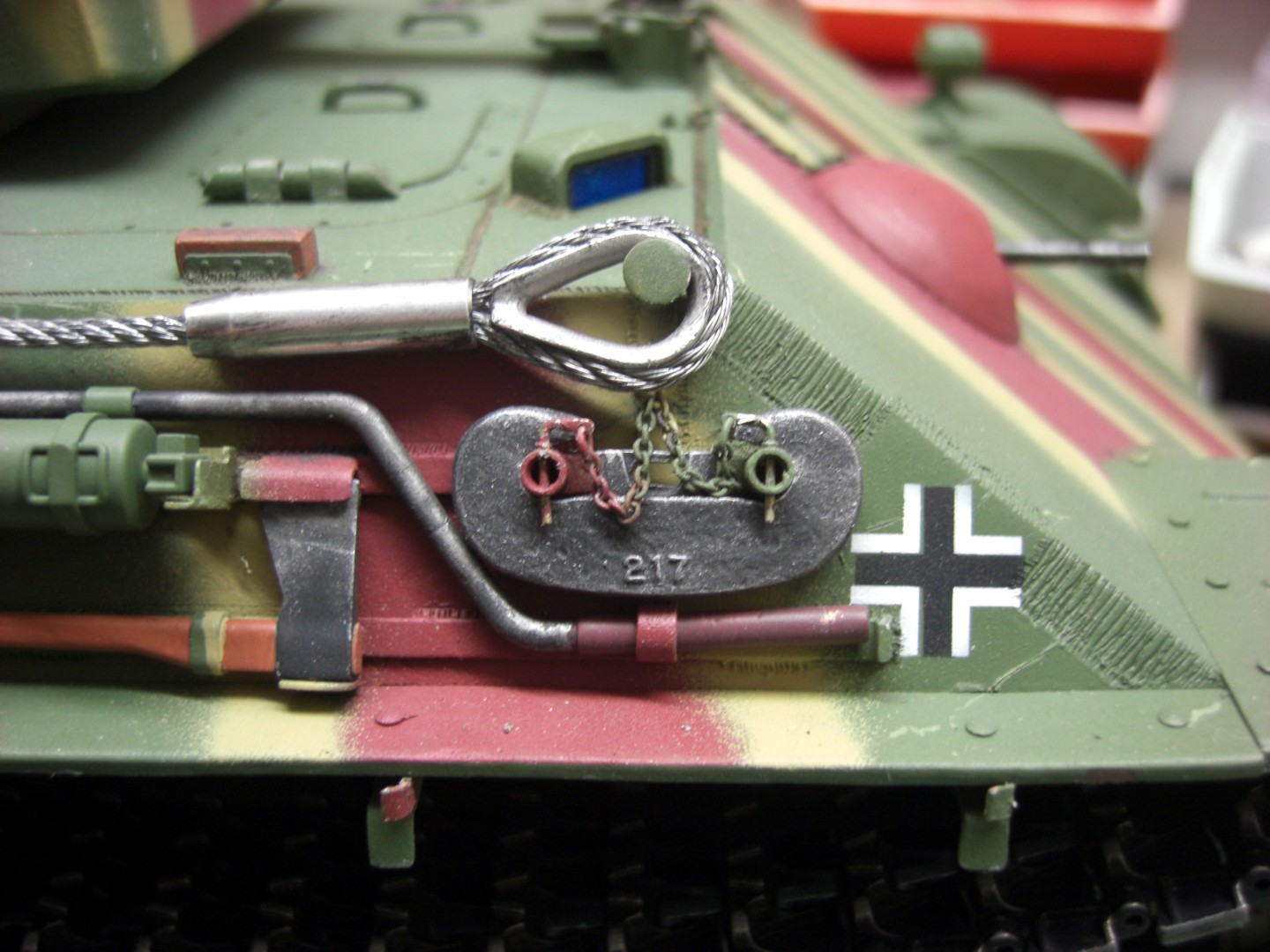

In the interim are all handles added, also the tow ropes and the rope for the chains. And also without many words, again pictures…
My little wooden block, or also called wooden suitcase...
Some things are already dry brushed, like the C-hooks…
…and now the left side…
Always only little steps, but the end comes closer...

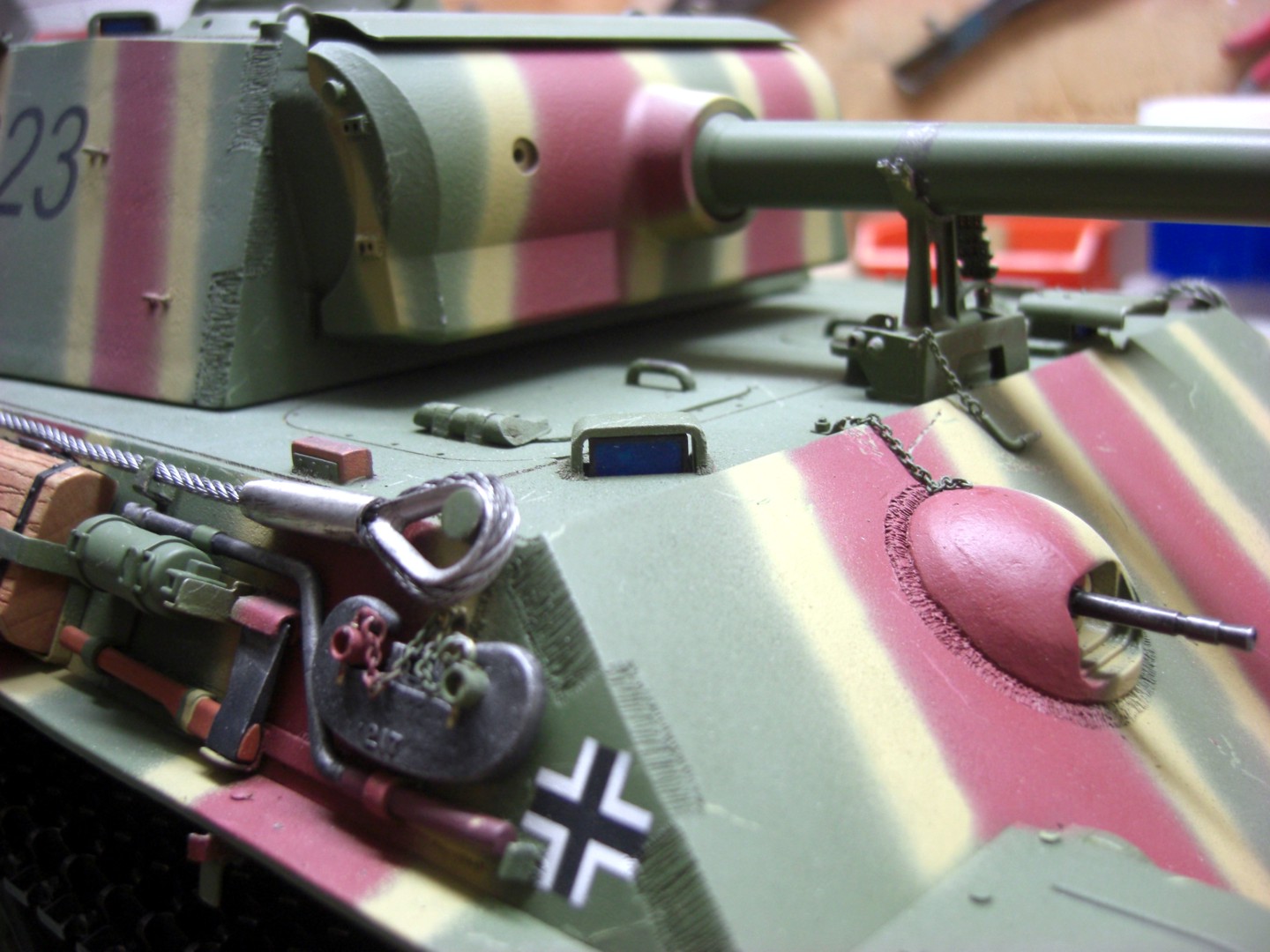

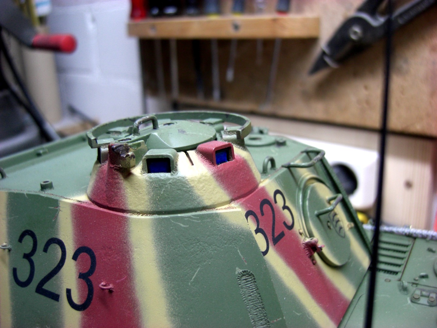

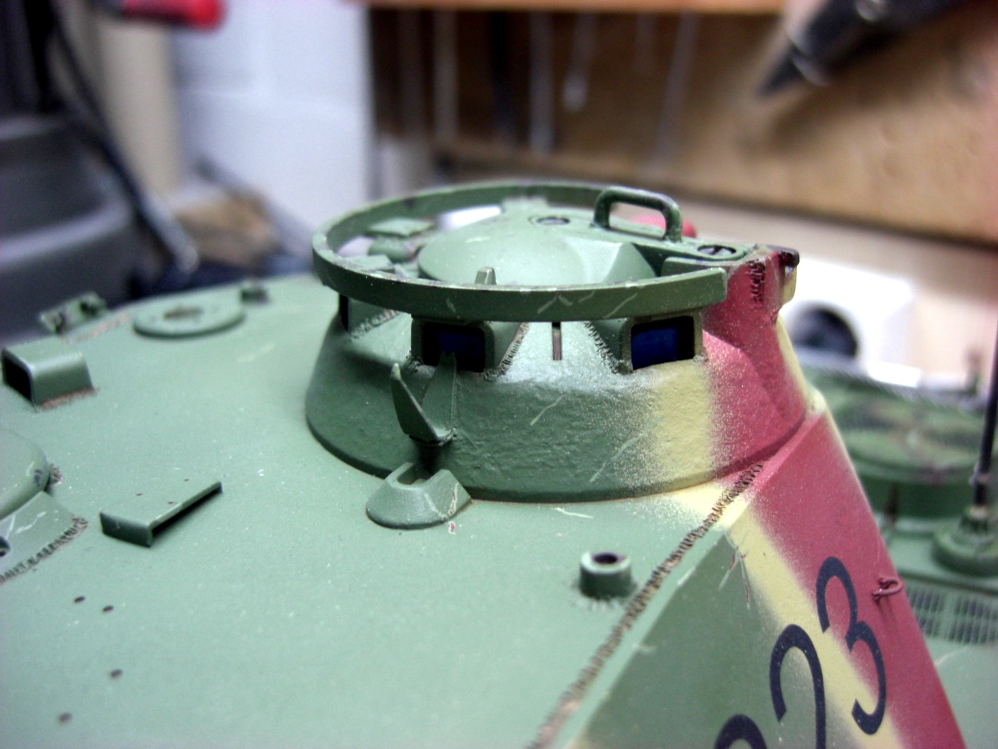

Hello guys,
again a few details added, the Panther has received periscopes, thereof again a few pictures…
…it will slowly...

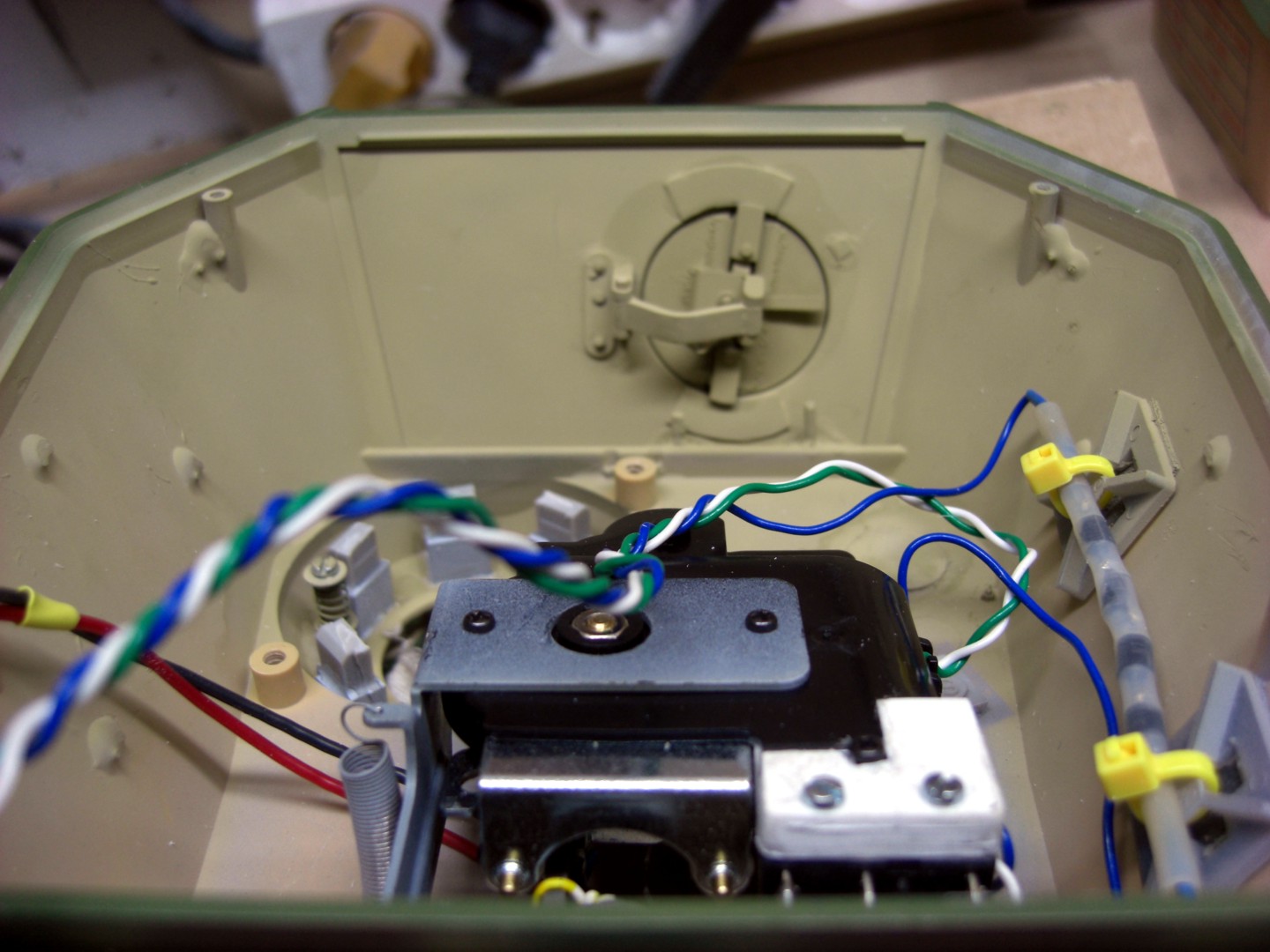

A little addendum, the turret has at the inside also received interior color.
And here a bit closer for the details at the rear turret hatch like weld lines, reinforcements for the lock and right the holder of an eyelet for padlock.
Finally have the periscopes at the inside also received color, however at this picture not to see…
…it will slowly...

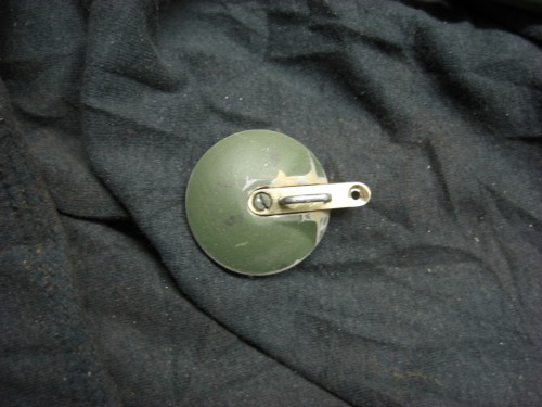

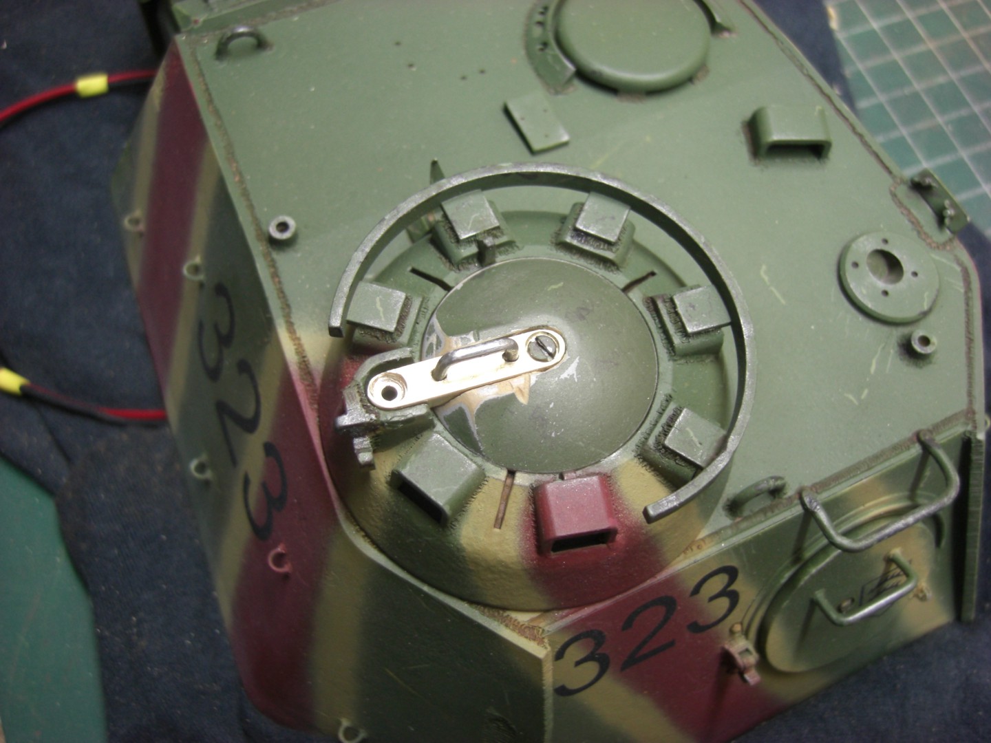

Panther G on the Eastern Front 1945

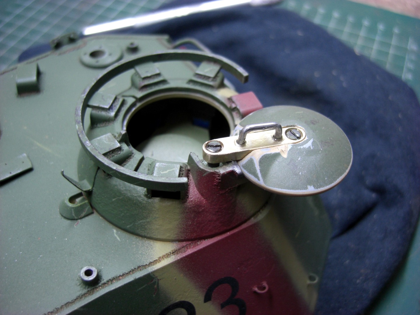

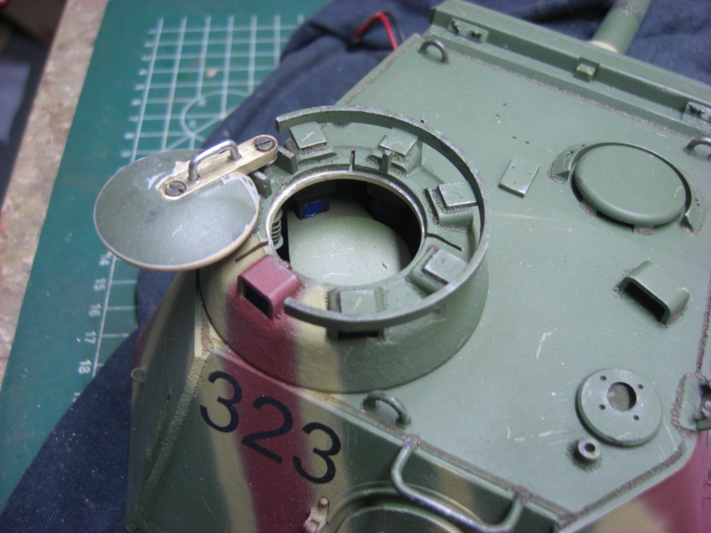

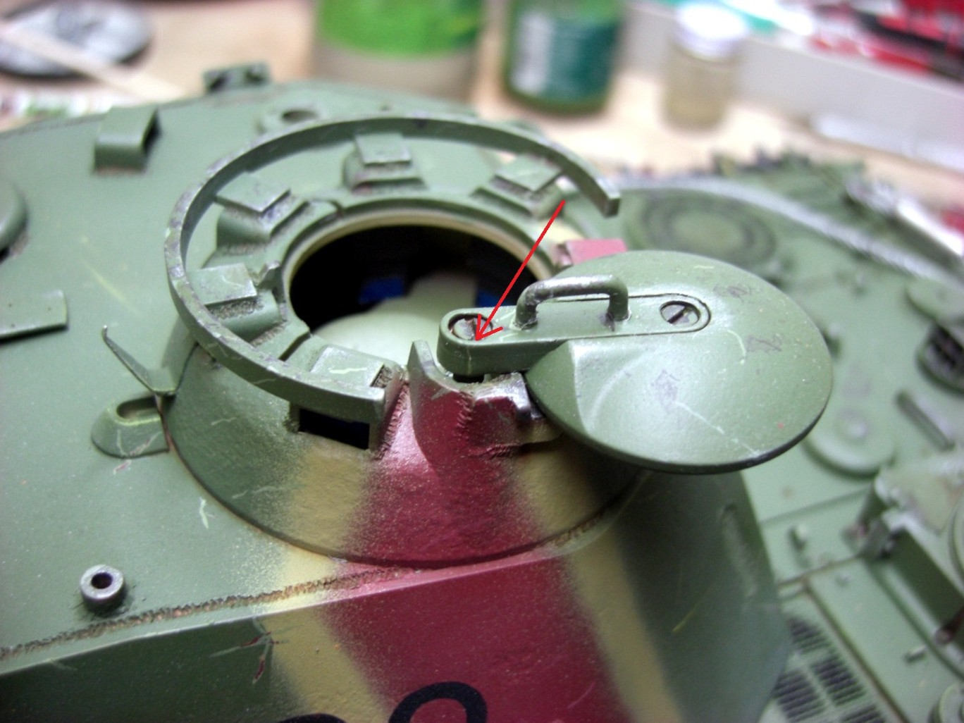

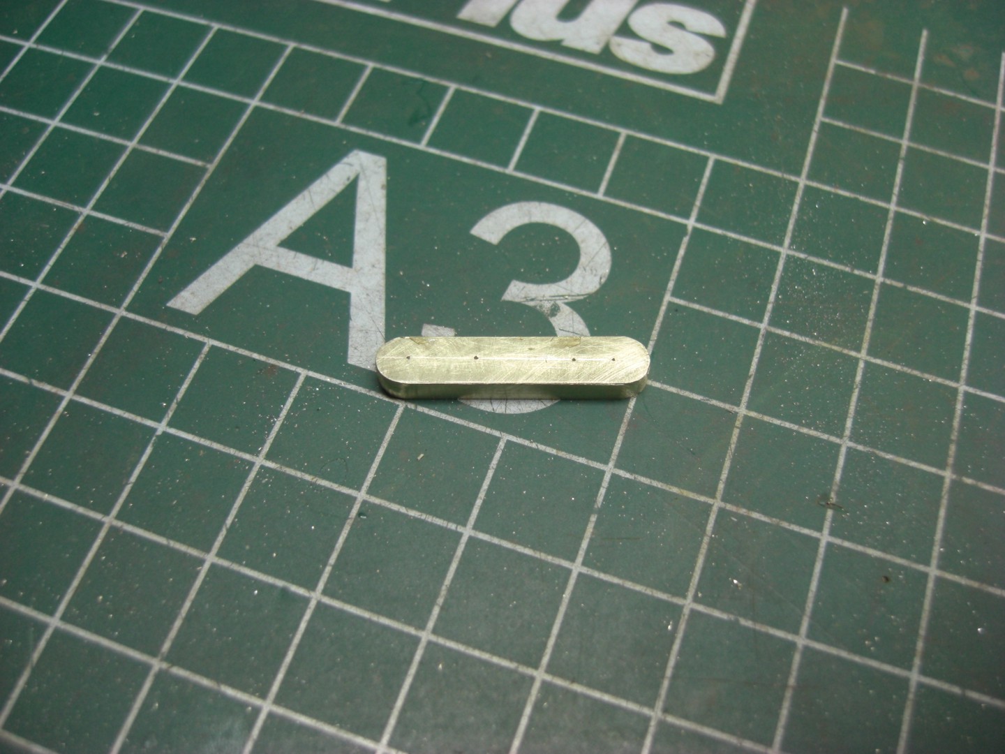

Still not the final working, because I had to eliminate a few little mistakes.

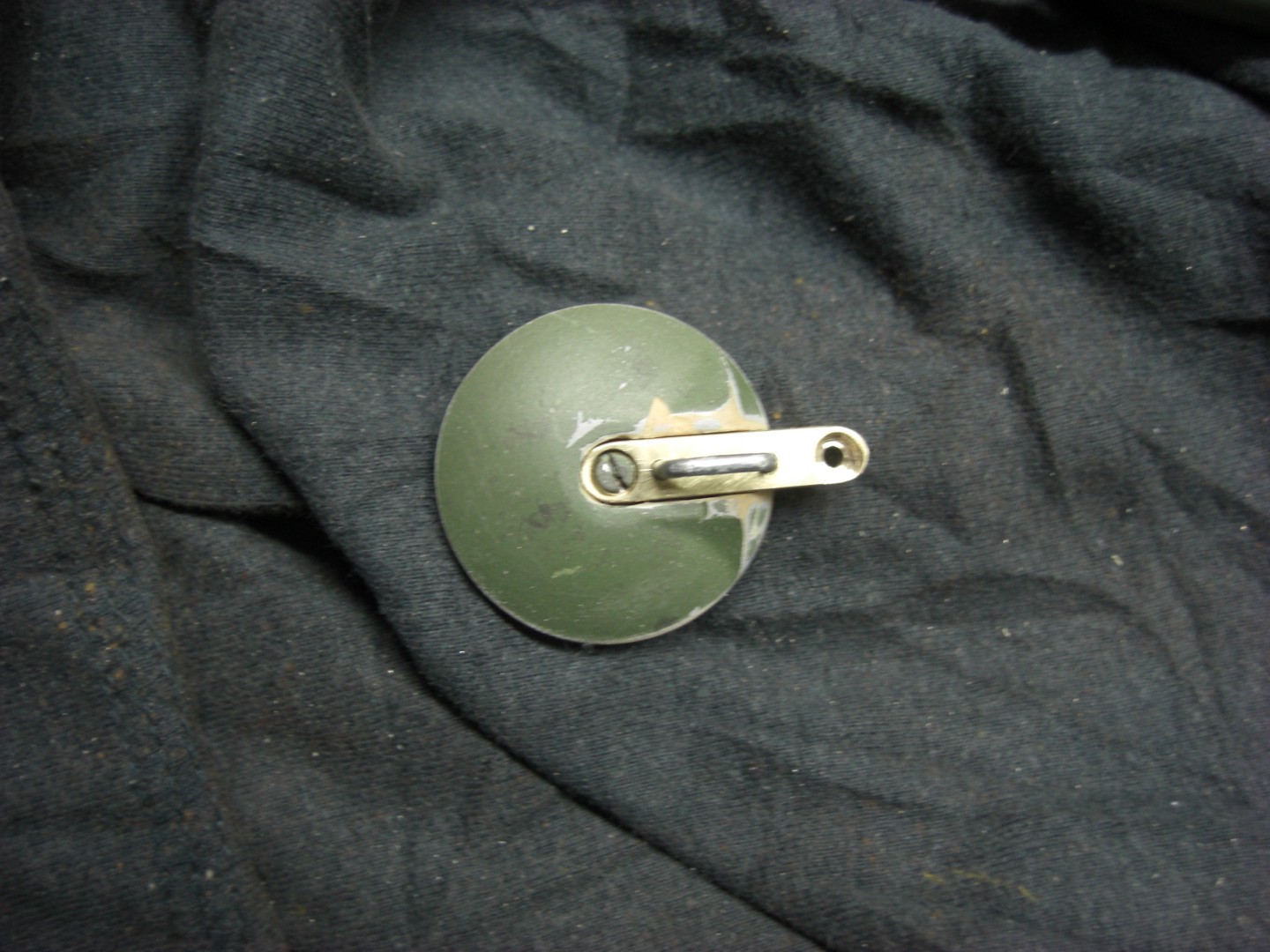

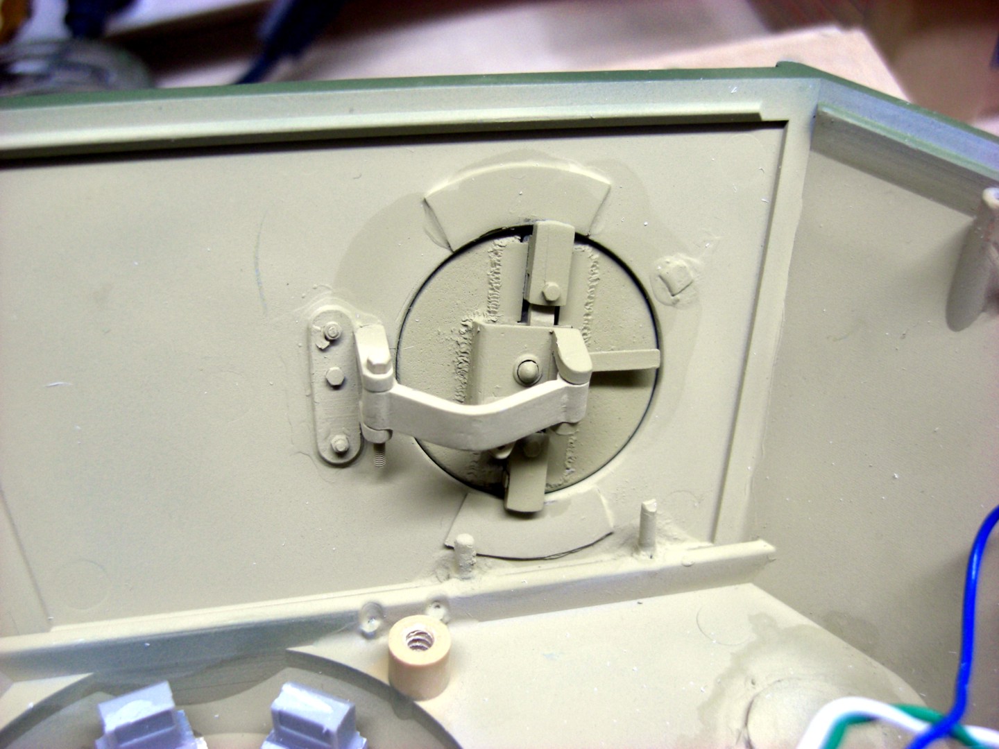

After a couple of times opening the commander's hatch I have to realize, that the original swivel arm is not strong enough. This was indicated by a little break line at the arrow.

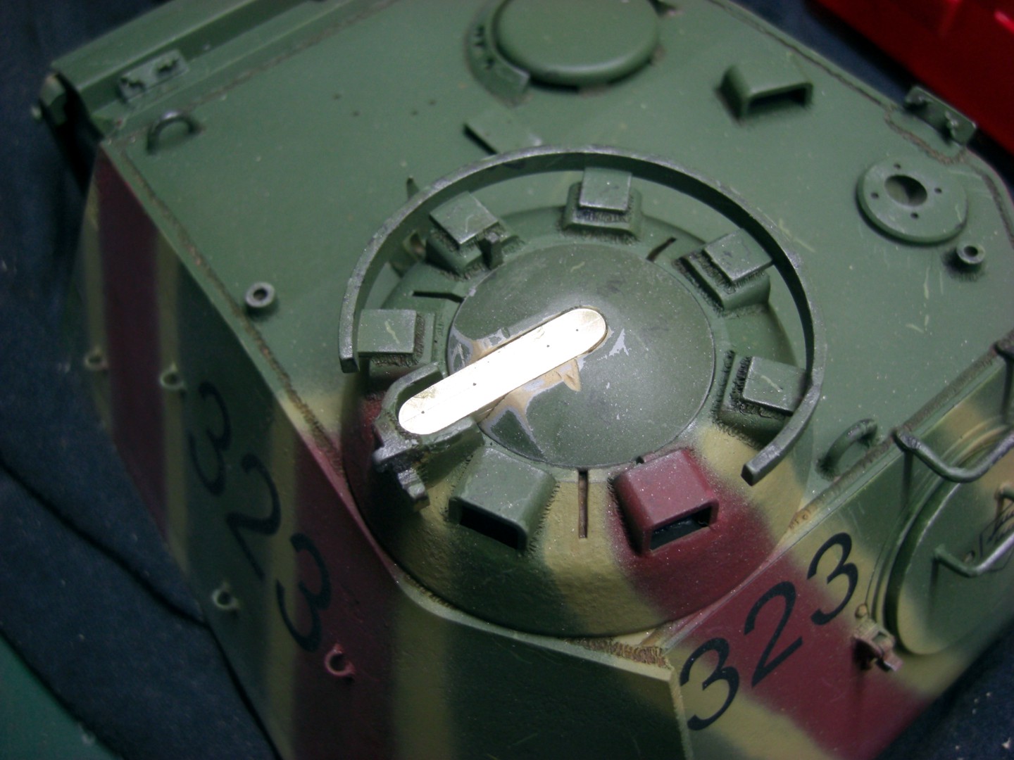

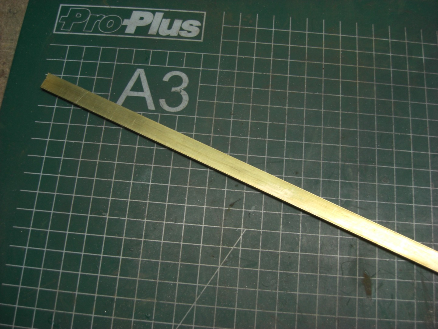

As material for the repair I've taken flat brass 10 x 3 mm.
The blank for the swivel arm is ready and the lid of the turret hatch was milled…
Then a first test with the parts on the turret, so should it go...
It follows the mounting of the parts...
Everything fits and works well…
Another small correction was made on the antenna foot. Tamiya has here 4 bolts mounted, but after short exchange of ideas with Jeff (many thanks again) and a look on many photos shows only 3 bolts on the type G (a few also with four bolts), but WeCoHe and Schumo Kits have also taken the latter variant. That’s why I made it too and it is also not a big problem. Old bolts cut off with a scalpel, drilled three small holes and screw heads M 0.8 glued in.
And again color thereon…
So, I hope I have now reached the point, to start with the final working.

Re: Panther G on the Eastern Front 1945

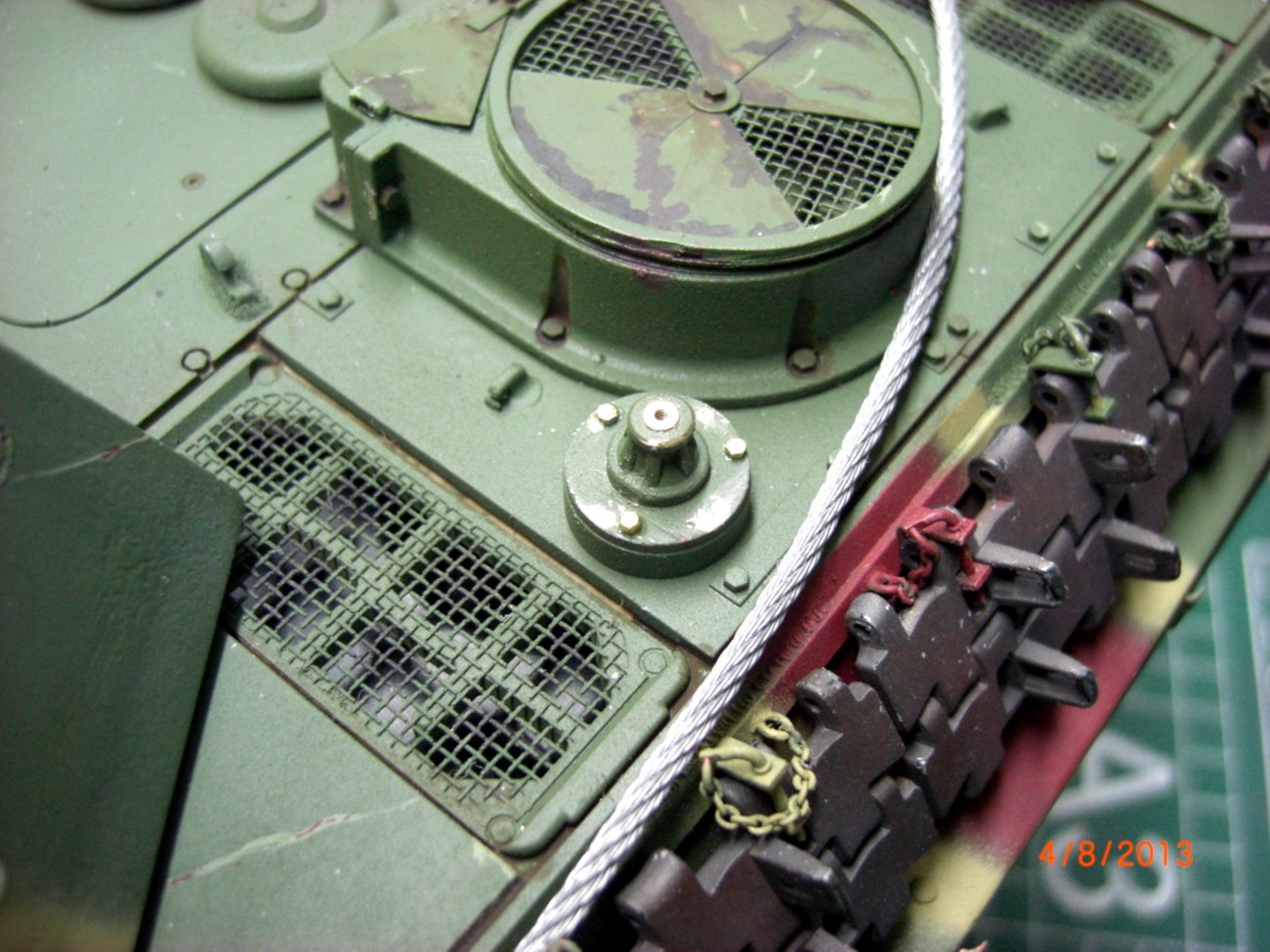

Thanks Eastern Front for the nice comment. To the tow ropes, I find, that rusted tow ropes are not really real. I have in my profession (hydraulic engineering, vessels, shipyard) many with wire cables to do and I know, that they become darker during use, but they rust only after many years and then already lying on a scrap heap.Eastern Front wrote:Hotte,
Boy this is a real nice build... I really like coming back to this and marvelling over the detail...
A good way to weather the tow cables that I use, is to paint them flat black then use a real thinned out rust and let it flow into the cable, then I use the Tamiya grease (from the 3 color compact) and rub the surface from there, it looks awesome...
Cheers!
But it's not a problem, each of us has it's own opinions and so should it be.
