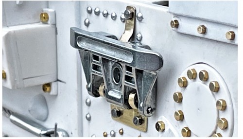

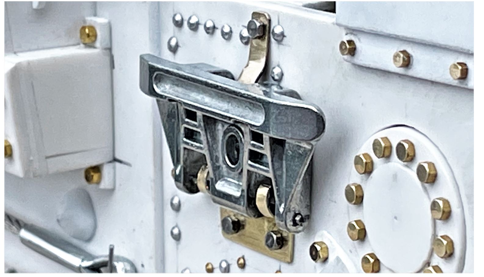

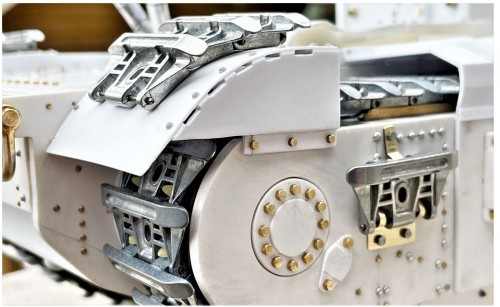

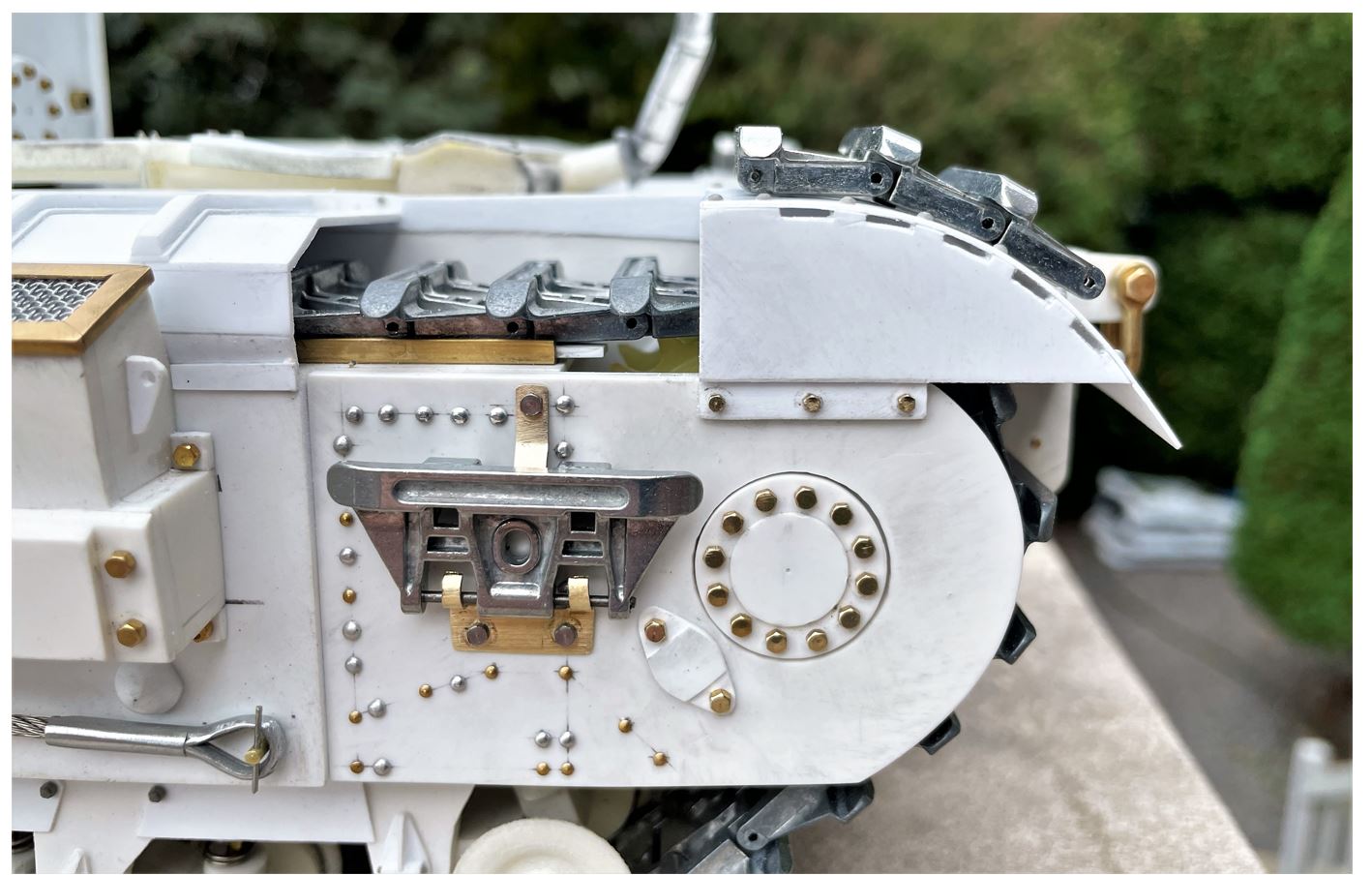

Additional close ups.
British tanks, like the Churchill and the Centurion i built two years ago, have a lot of little things on them. What you see are the kind of details that add richness to the model but it take time to analyse, find the right material and reproduce. If someone build a Churchill without these, the tank will look like a Churchill from far away but will otherwise look naked up close.

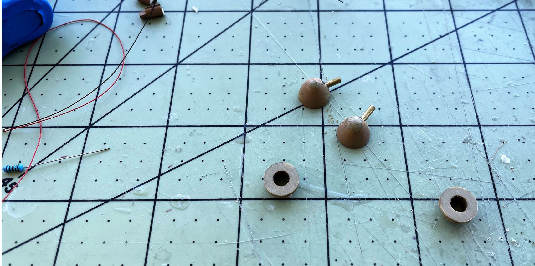

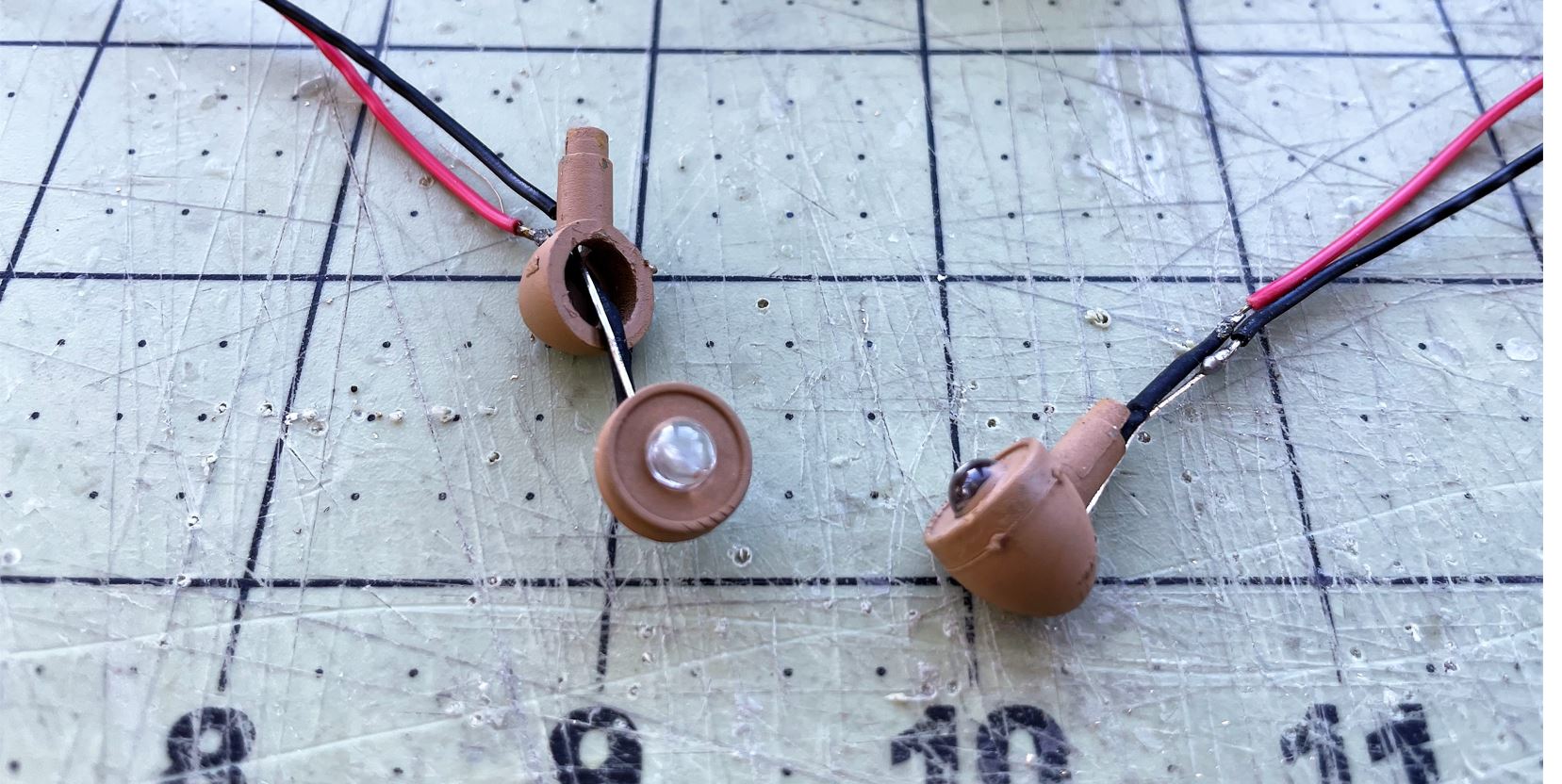

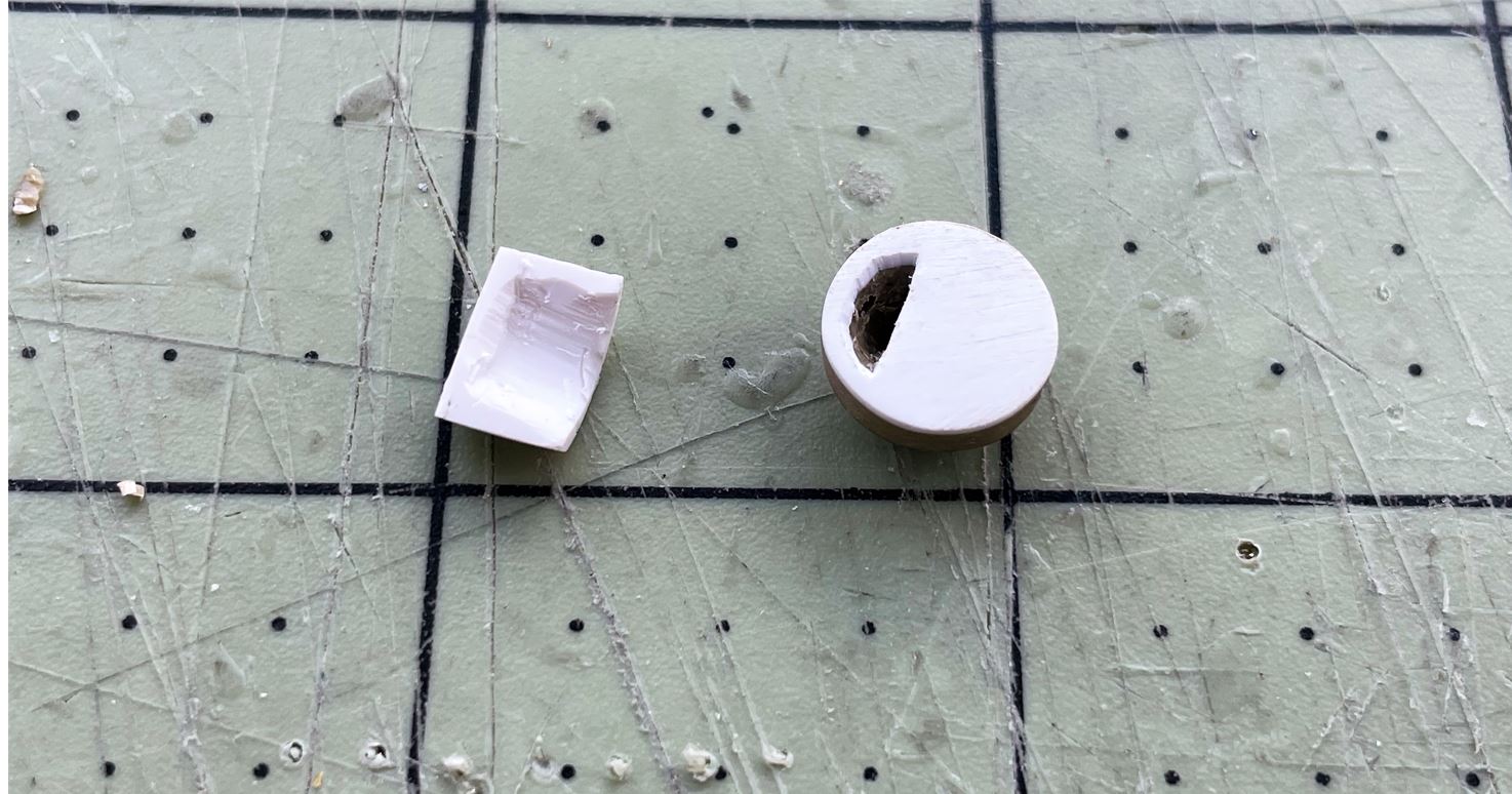

Crude plastic Heng Long Pz IV headlights are used as a base, and stripped out.
![Capture3.JPG (243.26 KiB) Viewed 1163 times RC 1/16 Churchill Mk III - Dieppe Raid 1942 - Build](./download/file.php?id=96633&t=1&sid=bacc0a1811f243378d5b2a577015b704)
- RC 1/16 Churchill Mk III - Dieppe Raid 1942 - Build
They are prepared for shape and also given new smaller LEDs with hidden wires going though a new brass tube base attachment.
![Capture4.JPG (241.4 KiB) Viewed 1163 times RC 1/16 Churchill Mk III - Dieppe Raid 1942 - Build](./download/file.php?id=96634&t=1&sid=bacc0a1811f243378d5b2a577015b704)

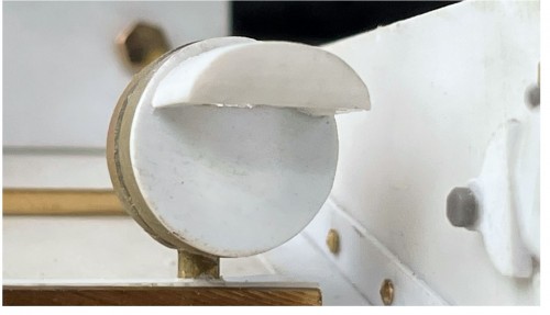

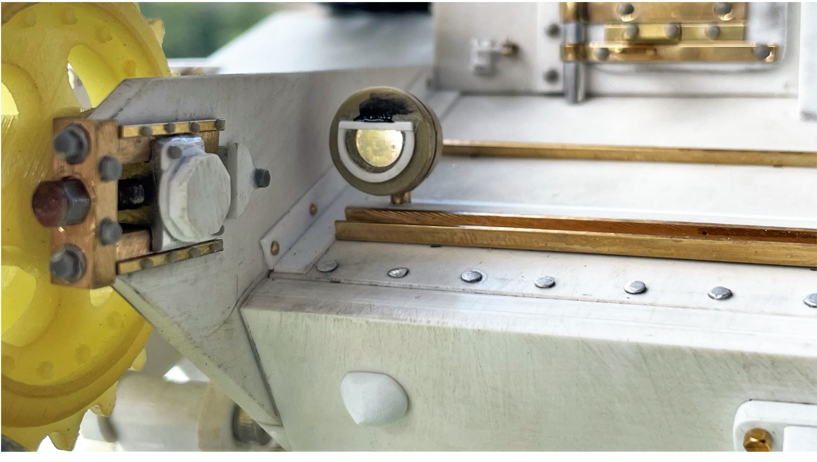

I figured the night headlight must be having an opening under its top cover to let the light come out. I tried to do something like that.
![Capture5.JPG (185.29 KiB) Viewed 1163 times RC 1/16 Churchill Mk III - Dieppe Raid 1942 - Build](./download/file.php?id=96635&t=1&sid=bacc0a1811f243378d5b2a577015b704)

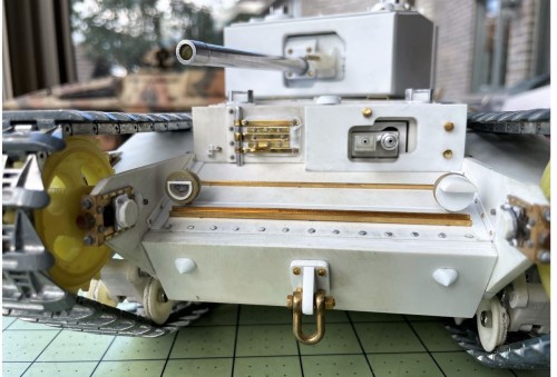

Here are the new "Painlesswolf" working headlights. You made me do it... and i thank you for it.
![Capture6.JPG (151.89 KiB) Viewed 1163 times RC 1/16 Churchill Mk III - Dieppe Raid 1942 - Build](./download/file.php?id=96636&t=1&sid=bacc0a1811f243378d5b2a577015b704)

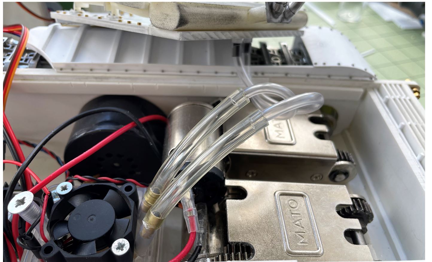

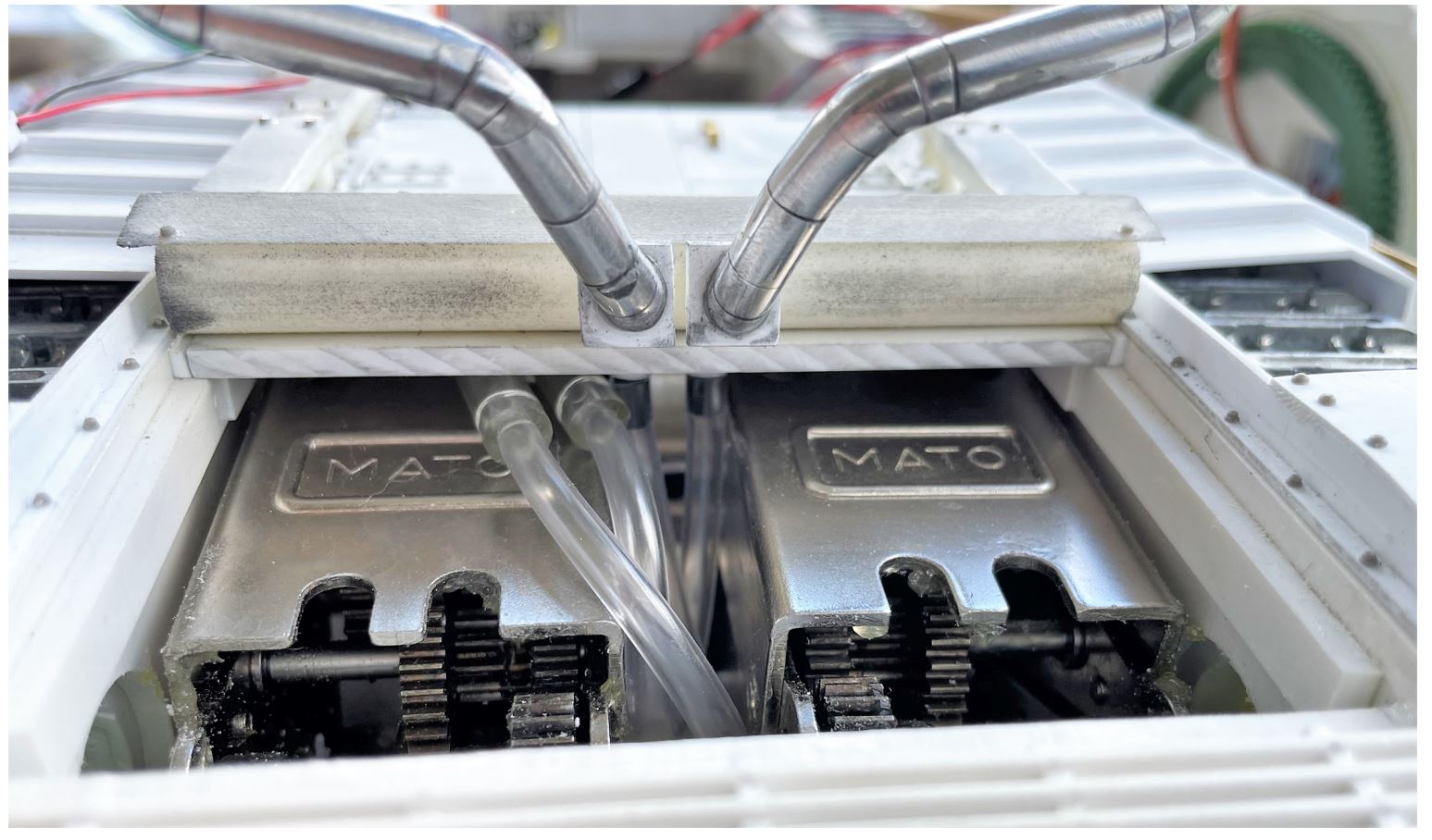

A DGS TARR translucid smoker is installed and connected to the deep wading exhaust pipes. At high speed, the smoke coming out is strong, strait and really impressive, but not too much either. This smoke unit is pure silence, not the loud chic-a-chic pump sound of the standard Heng Long smokers.
![Capture9.JPG (170.88 KiB) Viewed 1163 times RC 1/16 Churchill Mk III - Dieppe Raid 1942 - Build](./download/file.php?id=96639&t=1&sid=bacc0a1811f243378d5b2a577015b704)
Space is very limited over the gearbox, no room for 90 degree joints for the tubes. So, the larger flexible tubes come out of the smoke unit, go towards the back over the left gearbox which has the motor at the bottom, then the large tubes switch to smaller flexible tube, they go to the left and down, do a loop back between the two gearbox and then upright strait into the exhaust pipes.
![Capture10.JPG (171.02 KiB) Viewed 1163 times RC 1/16 Churchill Mk III - Dieppe Raid 1942 - Build](./download/file.php?id=96640&t=1&sid=bacc0a1811f243378d5b2a577015b704)

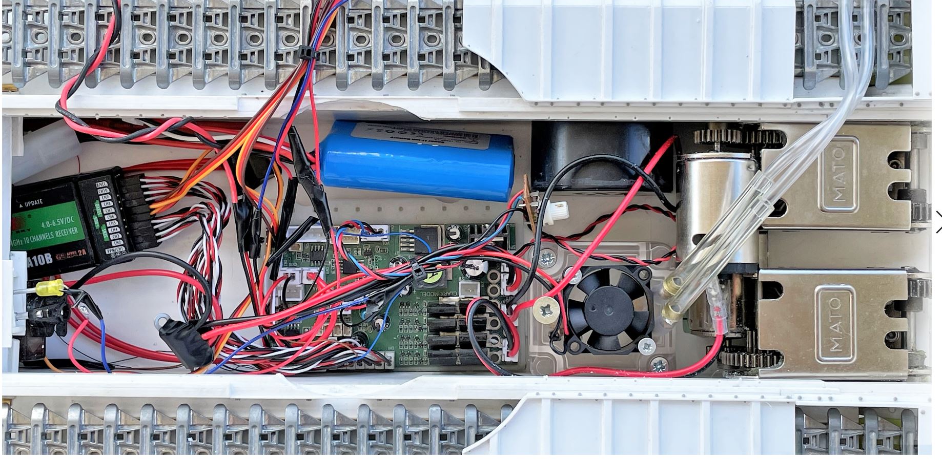

View of the electronics under the hood. The Churchill setup like this is providing exceptional access to all electronics by simply lifting the desired section (there are 4), including the turret. No need for magnets, the removable sections firmly slide into their allocated slots and supports on the chassis and turret.
![Capture11.JPG (289.91 KiB) Viewed 1161 times RC 1/16 Churchill Mk III - Dieppe Raid 1942 - Build](./download/file.php?id=96641&t=1&sid=bacc0a1811f243378d5b2a577015b704)
Layout of the electronics from front to back: Flysky receiver, Bow machine gun servo with flash wire, headlights wires, Clark TK-60 board, switch for battery and smoker, HL 1800 short battery, HL speaker and sound volume, DGS smoke unit, Mato gearbox. Turret has elevation and recoil servo, with flash wires for gun and coax mg. I did not receive the Elmod Fusion i ordered so the TK60 will have to soldier on.
![Capture12.JPG (335.88 KiB) Viewed 1161 times RC 1/16 Churchill Mk III - Dieppe Raid 1942 - Build](./download/file.php?id=96642&t=1&sid=bacc0a1811f243378d5b2a577015b704)

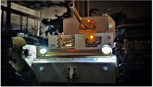

Night shot with headlights and Besa MGs shooting. But until the tank is primed and painted, these light effects are just candy. I also need to adjust the resistor's strength.
