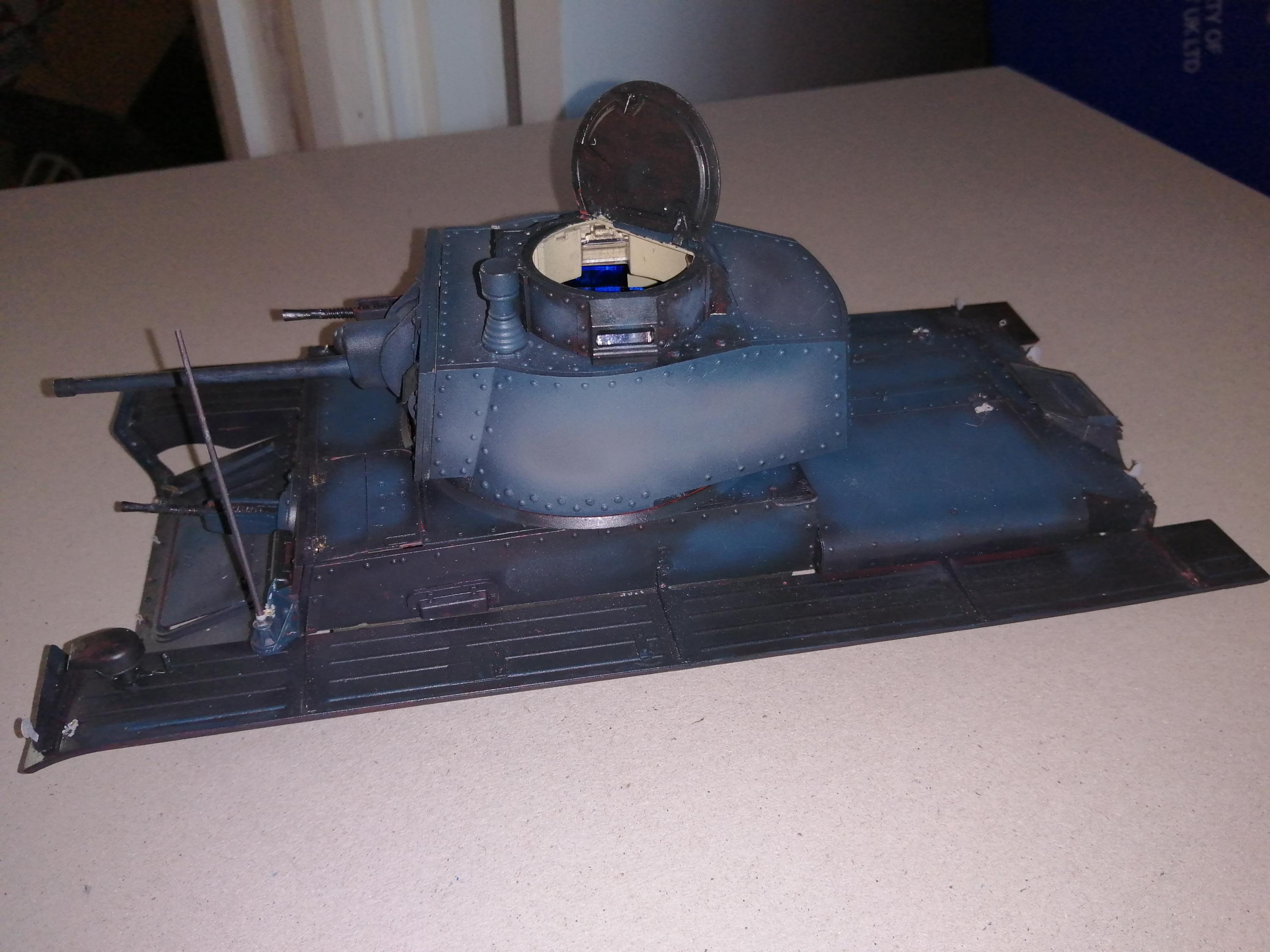

Somewhere along the way, I managed to misplace one of the turret mounts so had to make a replacement from scratch. I completed it yesterday so I test fitted the turret to the upper hull.  It also gave me a chance to see more of an overall picture.  It definitely looks like a tank!  It is also obvious that I need to do a lot of work with the airbrush to get a more harmonious appearance between the turret and hull.
The flash has accentuated the edge of my attempts at shading.  It does not look quite so bad in real life, but I realise I have a lot to do.  I have a question though.  Once I am happy, I have a blue wash for the whole tank (It say it is for panzer grey on the jar) which I understand will help tone things down.  My question is do you brush it on or airbrush it?

Gloss the entire model first so that the wash doesnt stick to the paint, then using a fine brush apply the wash to all the crevices and panel lines. I have the same wash at home and use it on a regular basis, do not airbrush it.
