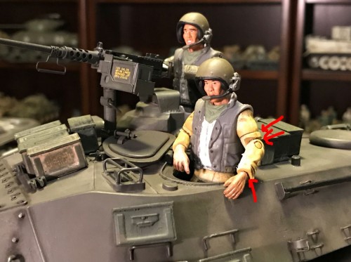

Here is the ARVN tank crew, part 1
The plan is to have 2 tank crews and 4 infantry riders. They will make the tank come alive on its own.I want to show an ARVN crack armored unit so I will make them very well equipped in terms of uniform and weapons. There will be no drivers because he would be decapitated by the rotating turret. I have seen someone that created a mechanism the lower the driver when the mantlet is over him, it's cute.
The core body of the crew and infantry will come from the Ultimate Soldier 1/18 M48 US tank crew figure of which i bought 6. These figures sell for between $20 and $25 on eBay. They provide flak jackets (with ARVN style scarf... cool) for everyone, helmets for the tank crews, and legs with jungle boots for the infantry. Most components need some kind of modifications. I never saw a shirtless ARVN soldier so the torso will be modified to show a uniform under the flak jacket. Also, the arms will come from elsewhere.
ARVN 1/16 tank crew RC for Walker Bulldog
Compared to a Verlinden 120mm figure of a US infantryman, the 1/18 scale provides a realistic size for the South Vietnamese crew.
Most of the heads will come from Ultimate Soldier 1/18 Imperial Marines set. They sell for about $8 to S10 on eBay. Ok, they are Japanese and most Vietnamese will likely be insulted but there are very few options available. However, I think they are all very expressive and good looking faces. I won't even have to repaint the head and hands.

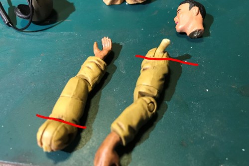

The Imperial marines are totally dismembered for the purpose of providing body parts for the tank crew. The head, arms and lower body are reused. The arms are too long and were cut at the highlighted line and reprofiled to fit the flak jacket.

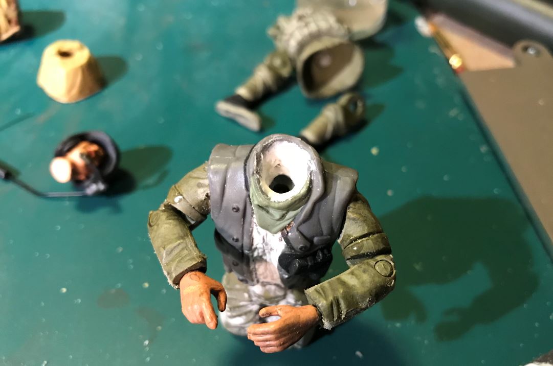

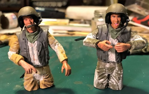

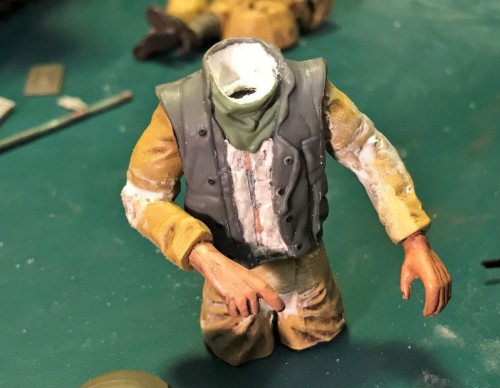

The two tank crew figures are built with the selected body parts. Putty is used inside the Jacket to make it fit the Asian head. A shirt is also improvised over the torso. The arms are still flexible at this point.

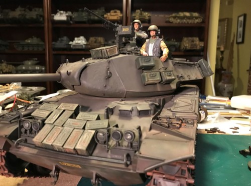

The crew is positioned on the turret so that the position of the arms can be tested and chosen. Each arm have 3 adjustments points that are enough to provide a lot of flexibility in designing the pose. The arms are then superglued in the selected position. The tank commander will be manning the M2 Machine gun in both hands.

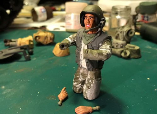

Then putty is applied to remove all signs of the flexible joints. It will be thoroughly sanded for seamless joints.
These are very cool tank crews. Pretty sure they are unique in the world... The loader has the head of Pvt Yamato, while the commander has the head of Pvt Higashiyama. They look good to me. Before painting them, I will build the infantry. I am still waiting for a few items in the mail but I cannot wait to start.
Tank crews are important. When they are well positioned in a lively pose, they bring a lot of authenticity to the model. Having them is worth the 3 hours it took so far to make them, it was actually quite fun and easy.
Now, the infantry riders...
Regards, Louis

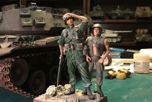

Well, thank you everyone, I am glad you like it. And believe me, there is still room for a lot of improvements for those who would like to push it further.
Here is the first infantry rider.
In similar fashion as the tank crew, 1/18 parts are assembled for the first prototype of the infantry, but with the Vietnam US tank crew legs and 1/16 infantry gears. You can see a Reedees miniature M-16A1 rifle (Vietnam era A1 version of the M-16), a Verlinden M-72 LAW anti-tank rocket, Tamiya WW2 US steel helmet, the rest of the gears are mostly from the Dragon Vietnam Seal figure which fits well.

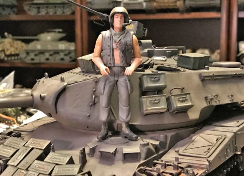

The first infantry rider is sitting on the tank. Be aware that the putty is still wet here and the finishing and polishing is not done. Painting will be done later.

The plan is to paint the uniform Olive green, the flak jacket a bit more Olive drab, the scarf will likely be red as seen on documentaries. Not sure if it was wise to wear a red scarf around the neck in combat... but it looked good and was likely important for morale.
M-41A3 Walker Bulldog Infantry rider 1/16 RC
The figure is still very dusty and unpolished but it gives a good idea. You can also inspect the quality of the M-16 rifle.
