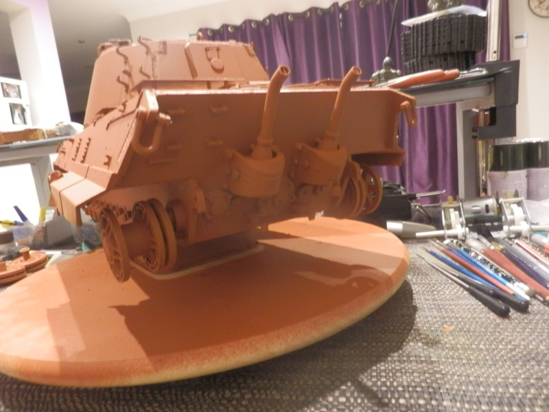

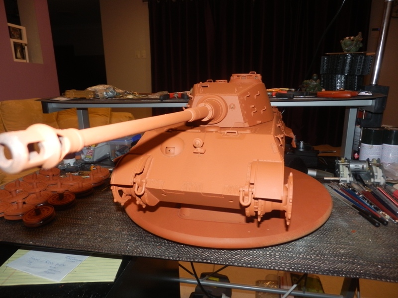

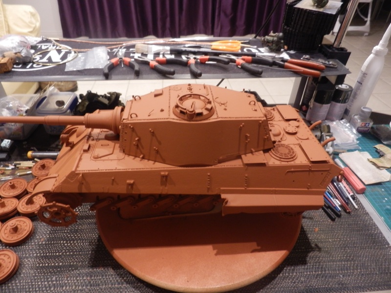

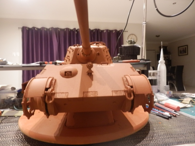

Took him outside to the Alfresco paint booth.
Ran the red primer over all the new additions while steering the turret with my foot(controler on the ground) so that no paint would settle in patches.
Turned out pretty good.
One thing though...............forgot to pre-prime the armour plates on the engine deck :problem:
If I look a certain way I can see the bare brass in the tiny gap between the grilles and the plates. :{

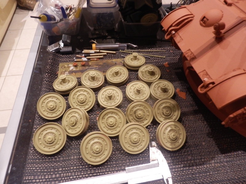

Not much progress. Got the hairspray on the lower hull and roadwheels.(Mmmmm.........hair.....spray) did the wait to dry thing (about ten seconds in the heat right now) and got the Dunkelgelb on the wheels.
Will use the airbrush for the lower hull sponson area to ensure no overspray.
Upper area will be a mix of tamiya XF43 J.A. Green & olive green.
Then the gelb over that with the 'puss-rings'
