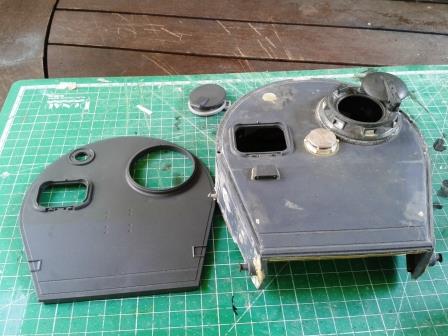

Replacing the loaders hatch
One other correction I had never planned to do was on the loader's roof hatch. For some reason the shape of the hatch on the HL turret is wrong: too big (wide) and the corners of the original were more rounded. This is not an error which is easy to spot, especially when the hatch is shut. However, I happened to have a spare Tamiya turret roof (bought with a whole load of other sprues quite cheaply on ebay a while back) - so I planned a 'transplant'.
Heng Long turret with BB switch panel removed from loader's hatch - beneath you can see Tamiya turret roof with correct smaller apperture.jpg
Heng Long turret with BB switch panel removed from loader's hatch - beneath you can see Tamiya turret roof with correct smaller apperture.jpg (23.16 KiB) Viewed 5969 times
Comparison between the HL turret and Tamiya turret top showing the latter's correct size and shape.jpg
Comparison between the HL turret and Tamiya turret top showing the latter's correct size and shape.jpg (30.63 KiB) Viewed 5969 times
So now all I have to do is remove the HL hatch surround on the right and transplant the Tamiya one from the left....jpg
So now all I have to do is remove the HL hatch surround on the right and transplant the Tamiya one from the left....jpg (35.53 KiB) Viewed 5969 times

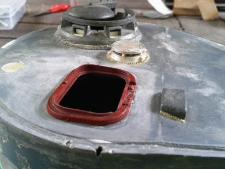

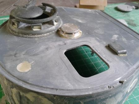

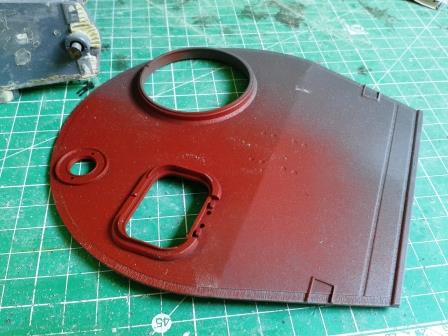

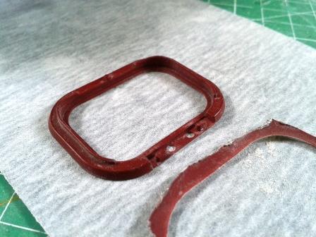

Actually there's not much skill involved - just a lot of patience and sandpapering. The Tamiya roof was first sprayed with red oxide primer so that I could see when I had finished sanding away the grey plastic. I will let the pictures do the talking:
The HL loaders aperture is carefully sanded away.jpg (30.17 KiB) Viewed 5969 times

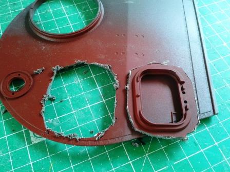

Next I used a spare Tamiya turret roof....jpg (35.61 KiB) Viewed 5969 times

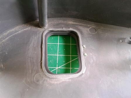

...and cut away the laoder's hatch aperture.jpg (37.1 KiB) Viewed 5969 times

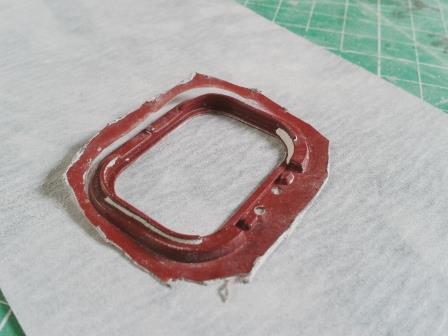

This was sanded down from beneath until only what was above the turret roof remained.jpg
This was sanded down from beneath until only what was above the turret roof remained.jpg (26.31 KiB) Viewed 5969 times
With patient use of fine sandpaper it should be possible for the excess plastic just to fall away.jpg
With patient use of fine sandpaper it should be possible for the excess plastic just to fall away.jpg (35.6 KiB) Viewed 5969 times

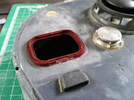

And here is the Tamiya loader's hatch aperture finally transplanted onto the HL turret.jpg
And here is the Tamiya loader's hatch aperture finally transplanted onto the HL turret.jpg (31.37 KiB) Viewed 5969 times
Note: This hatch surround is correct for both early and mid-production Tiger turrets - however the late version of the tank (with steel wheels) had a reinforced roof with a flush fitting hatch (similar to the Tiger II) and no splash guard...

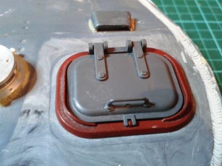

The other advantage of the Tamiya hatch is all the interior latch detail - which can be improved further with photo-etch from the 'Build Your Own Tiger set (or Aber). I've been doing that tonight and I think my eyes will need a day to recover...

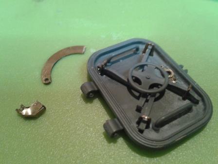

Work in progress on the interior latch detail using Tamiya parts and photo-etch.jpg
Work in progress on the interior latch detail using Tamiya parts and photo-etch.jpg (24.41 KiB) Viewed 5963 times

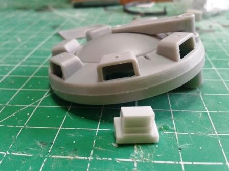

A while back I installed the Taigen mid/late cupola and I fitted some pretty rudimentary periscopes (see above). Don't get me wrong - I was very pleased at the time. Then recently I came across some Schumo periscopes. These are made from resin to fit the Tamiya King Tiger and they also make a set for the Panther - but unlike the cupola on the Panther (which was taller in profile) those on the two Tigers were virtually identical.
Well curiosity soon got the better of me so I ordered a set. They look great and they're not too pricey. The set provides ten in all - seven for the cupola, one for the turret roof and two for the driver and radio operator. Only the top halves are present, and only the ones for the cupola have the detail of the inset glass block (moulded as part of a solid resin casting).

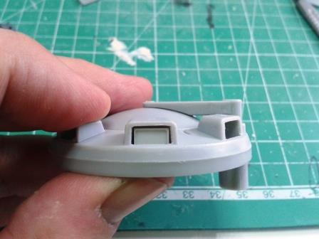

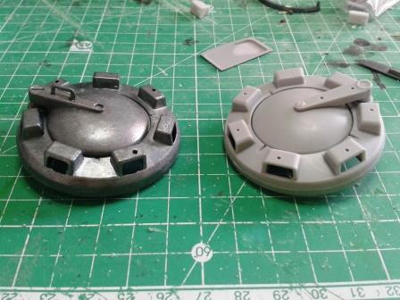

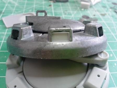

The problem came when I tried to fit them into a spare Taigen cupola. They do fit, but only just. It then dawned on me that this was because the Taigen casting, good though it is, is just not quite right. The apertures for the periscopes are too narrow, too tall and too thick.
They do fit into the Taigen metal cupola - but only just.jpg (25.2 KiB) Viewed 5886 times

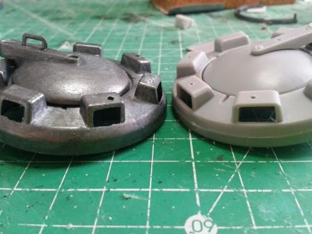

So I dug out an old Hachette cupola which I had from Issue 12 of the Build Your Own Tiger magazine (as I have said before, these can be found occasionally on ebay in a job lot from people who have given up on that very expensive and ultimately flawed project).
So what happened when I test fitted the Schumo periscopes? They fitted like the proverbial glove, that's what.
The Schumo periscope set include seven identical resin castings for the cupola.jpg
The Schumo periscope set include seven identical resin castings for the cupola.jpg (28.75 KiB) Viewed 5886 times
The Schumo periscopes fit perfectly.jpg (26.53 KiB) Viewed 5886 times
Taigen cupola on the left, Hachette on the right - note different size of periscope apertures.jpg
Taigen cupola on the left, Hachette on the right - note different size of periscope apertures.jpg (36.31 KiB) Viewed 5886 times
Here you can see how the Hachette periscope apertures are (correctly) both lower and wider.jpg
Here you can see how the Hachette periscope apertures are (correctly) both lower and wider.jpg (30.8 KiB) Viewed 5886 times
So the Hachette cupola is just better all-round than the Taigen equivalent. I especially like the fact that the hatch cover is noticeably separate from the pivot and bracket - this is how it should look (and I have read somewhere that the hatch cover could actually rotate).
It's far from perfect, however. First of all it's all plastic, so although it's sprung like the metal one I remain a little nervous about how much handling it will take. The anti-aircraft rail around the top is also very unconvincing, being far too thick (it looks a little better on the Taigen metal version). The real thing was actually quite thick - as you can see in the shot above (I will soon post some more shots of the real thing) but it still needs to look in scale.
Also note that Schumo do make their own cupola up-grade, but this is prohibitively expensive (£34.99) and the hatch cover has to be purchased as a separate part!
There weren't any real issues fitting the new cupola into the Heng Long turret however. I simply prised the old Taigen one off and put a fillet of plastic card around the bottom half of the Hachette piece. I also cut out a circular template to fit to the underside of the turret roof which was slightly smaller than the hole I had left in the turret roof (something I should have done before) so that the cupola simply sits in the aperture.

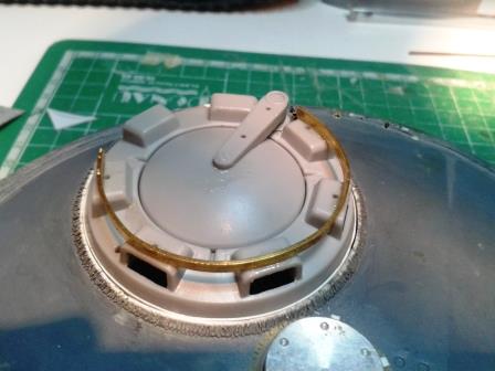

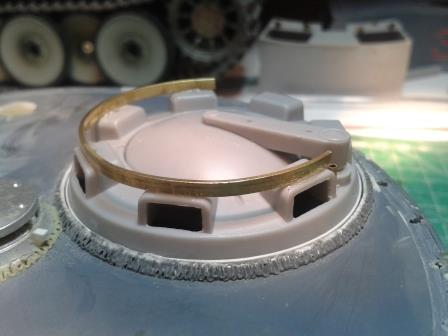

First off I have replaced the AA ring with a better looking rail made from bent brass strip. This I carefully bent around a suitably sized item - actually the handle of my drilling tool - making sure that the circle was regular without kinks. I actually bent it to a slightly smaller circumference so that I would take out some of the 'spring' before opening it out to the correct width. It was then glued it in place with strong five minute epoxy glue. I will have to add small weld beads.
The Hachette cupola is very slightly smaller than the Taigen version.jpg (28.1 KiB) Viewed 5886 times
The anti-aircraft rail replaced by bent brass strip.jpg (24.76 KiB) Viewed 5886 times
