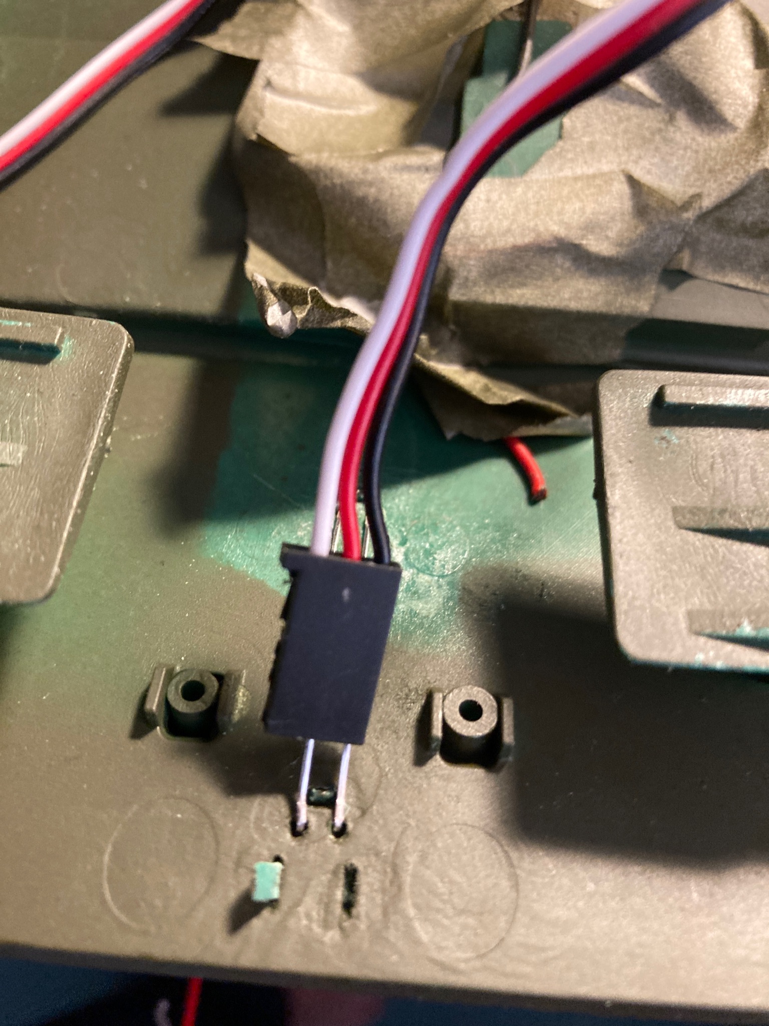

HAYA Centurion KIT. LED Voltage?
I have threaded the two headlight bulb legs through the glacis plate, but before I solder them together I want to test them each individually to make sure that they are working OK.
The long leg of the bulb has been pushed into the positive (red) socket and the short leg has been pushed into the negative (black) socket of a servo extension lead so I just need to know what voltage I should connect to the lead to test the bulb without burning it out.
I did try connecting it to an AA battery and it didn't work, but I am guessing it needs a higher voltage to illuminate it.

Re: Amateur Build. HAYA Centurion KIT
I have two AA batteries taped together in series (end to end) to produce 3V. 3V is usually what an LED runs off of. It just ends up being a long AA basically.
HAYA Centurion KIT. 3V LED Power.
Thanks Derek.
I like good simple solutions and I will give yours a go.
UPDATE.
Your idea worked perfectly - and both of my LED's light up.
Now I know that the bulbs are OK and working, I can take a look at finding some thin wire to solder the two + positive legs together (and the two - negative legs together) and then fit the lead that will connect them to the Clark board.

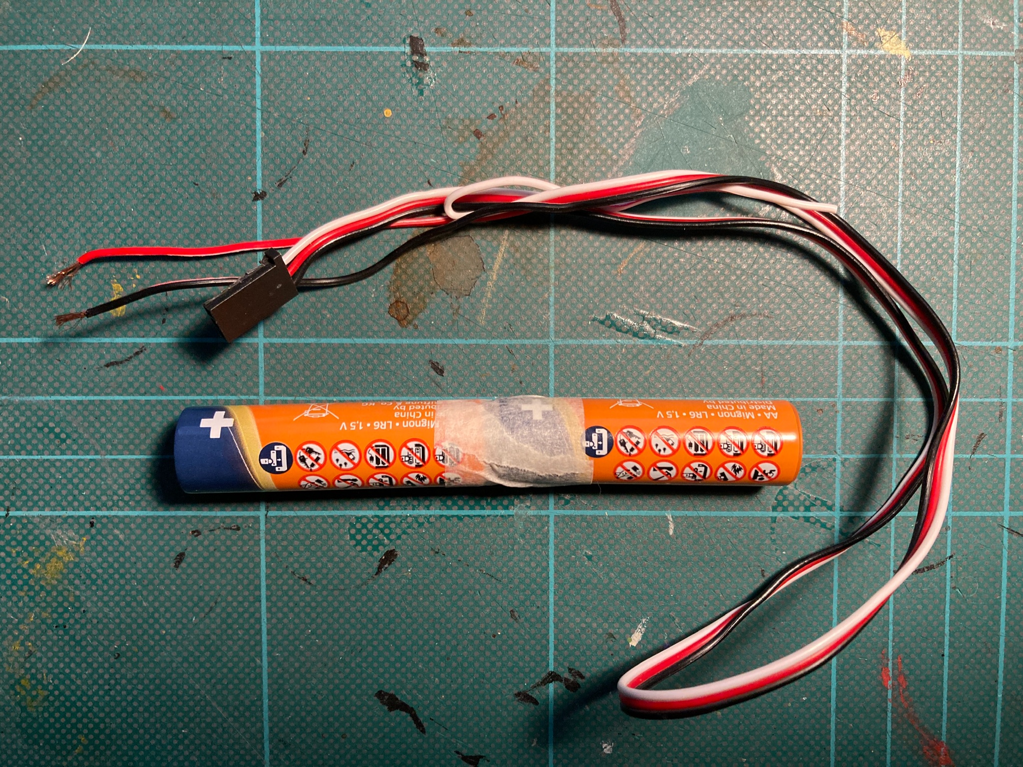

HAYA Centurion KIT. Cheap LED Test Kit
Two AA batteries, a small length of masking tape, and a servo extension lead make an effective LED test kit that works well.
The idea of taping two AA batteries together to give the required 3V was given to me by tankme and it is such a nice simple solution, I thought I would picture it and share it here.
Combine this good idea with a spare extension lead to plug the LED into and it becomes very good little test rig..
Plugging the longer LED leg (+ positive) into the red extension lead socket, and the shorter (- negative) leg into the black socket secures the LED bulb securely enough to hold it while touching the bare black and red wire ends onto the correct polarity terminals of the temporary AA battery pack to light the LED.
Even better is that when the LED testing is completed, the batteries and the extension lead can be used for something else - simples !
