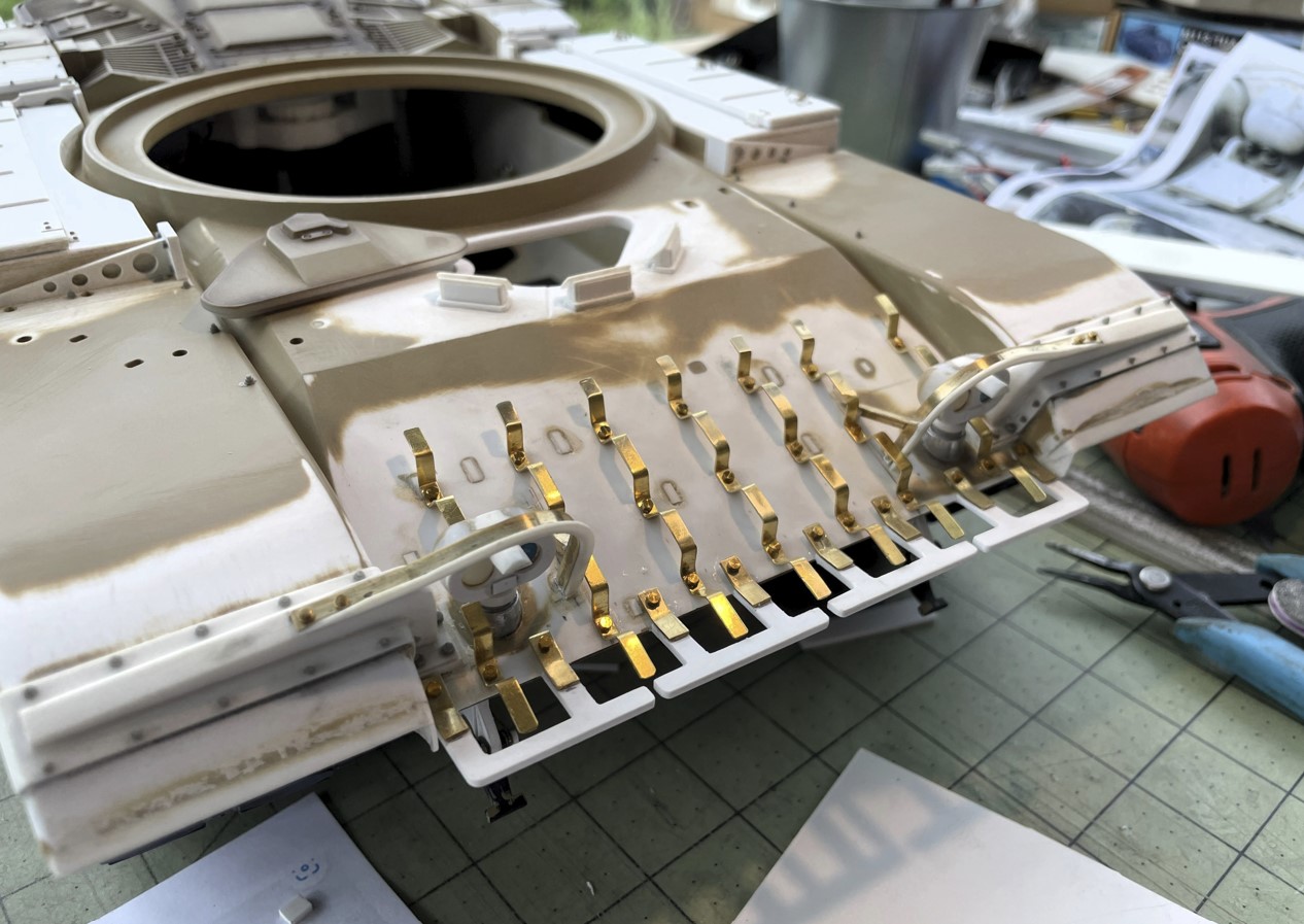

Now continuing today with the built, i got some energy back.

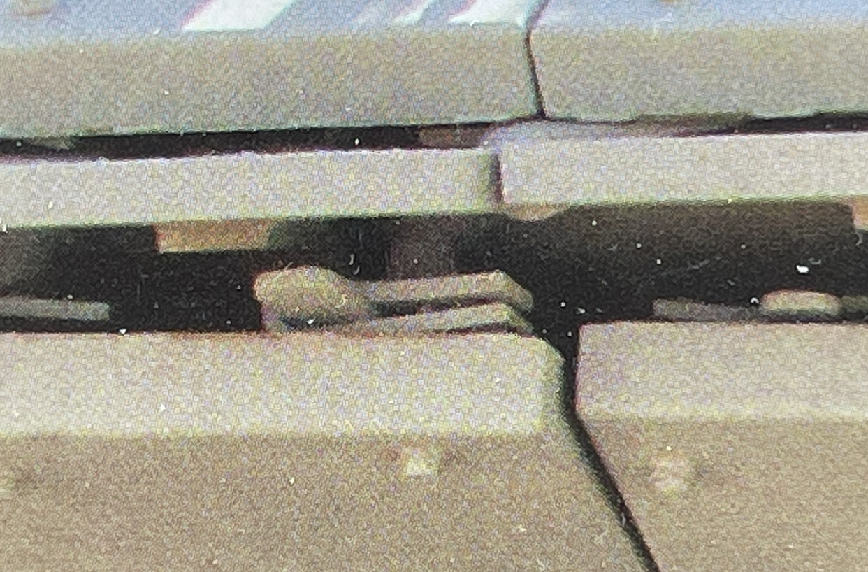

Brackets are positioned and glued in place, then reinforced with a M1.2 hex bolt.

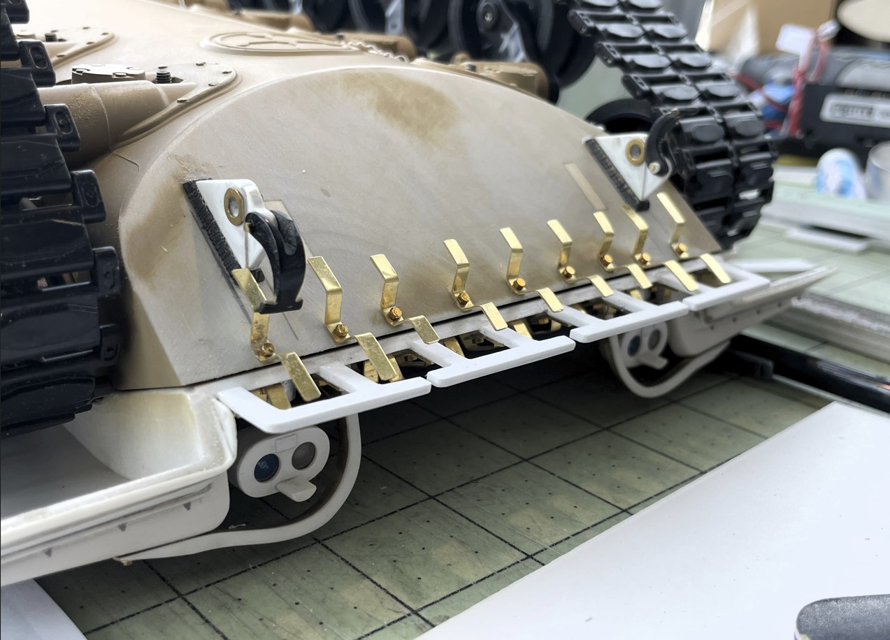

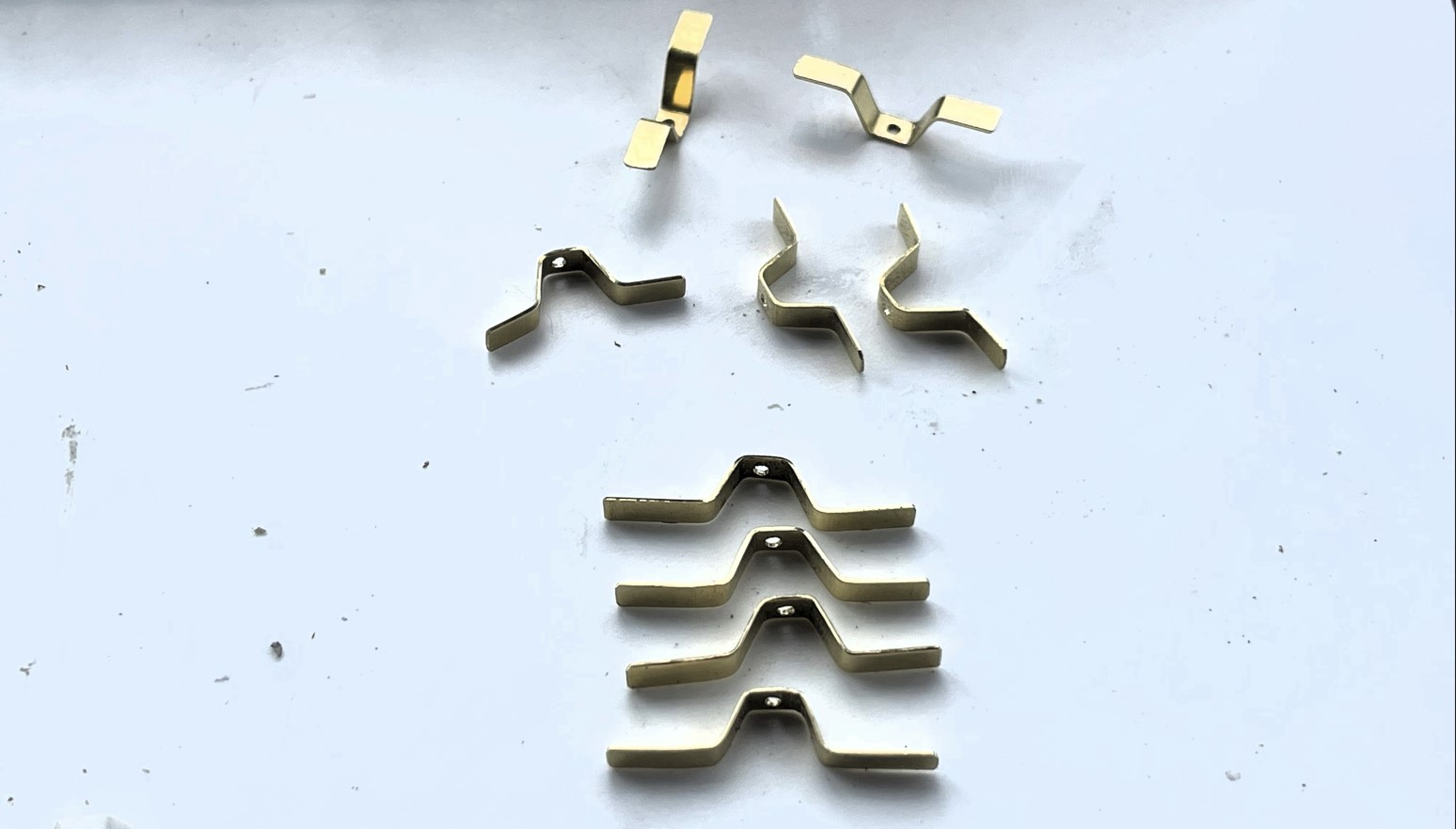

Brackets are made for the front lower hull, i tried to do something similar as seen in pictures. The 4 outer brackets needed to be extended on one side, this is because i cannot glue the bracket over the hull joint, which need to remain removable.

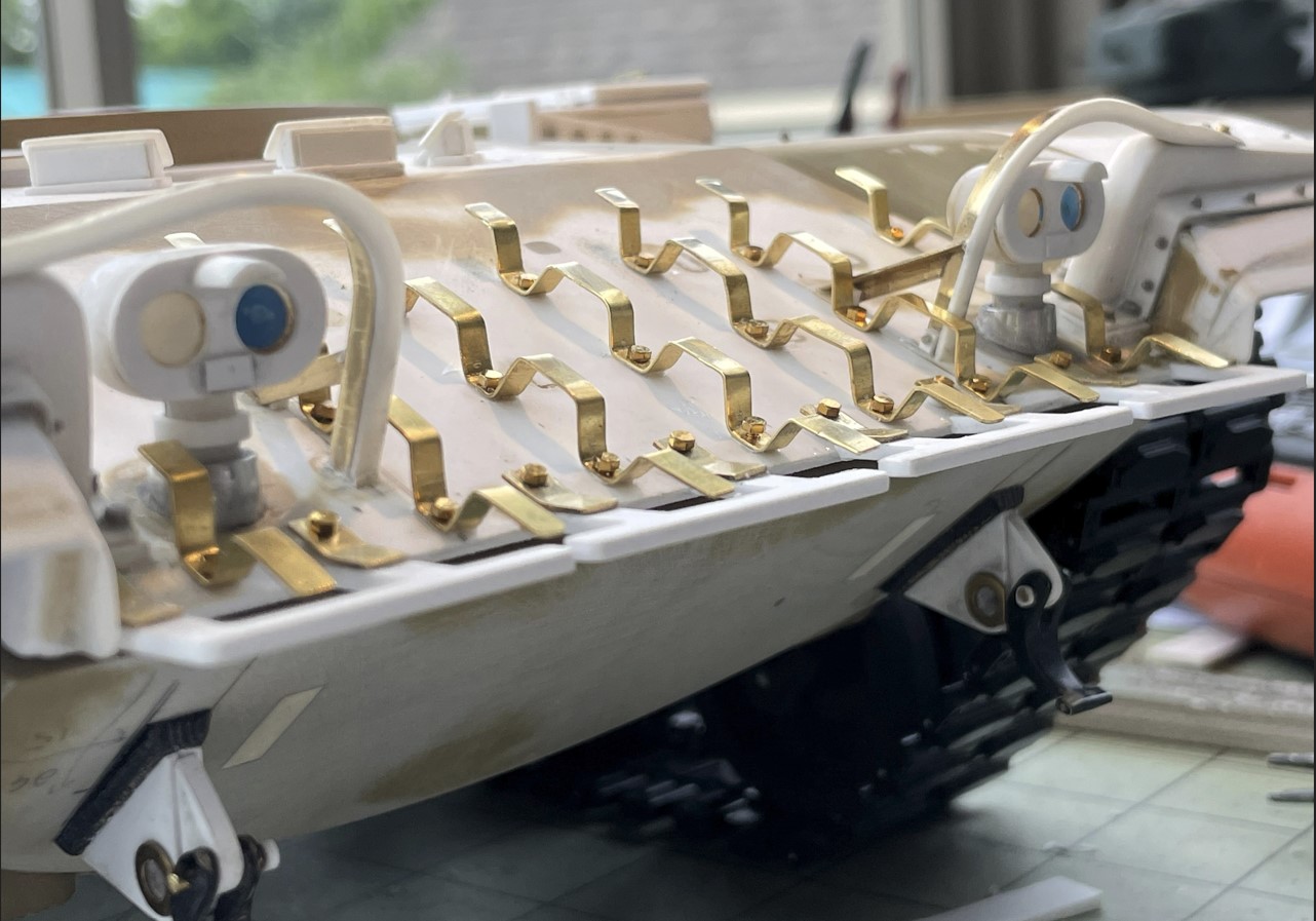

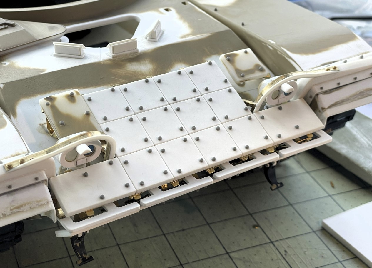

Lower hull brackets are installed.

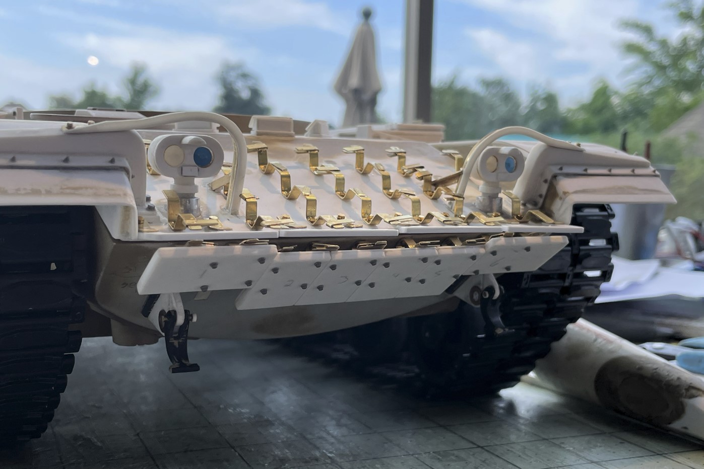

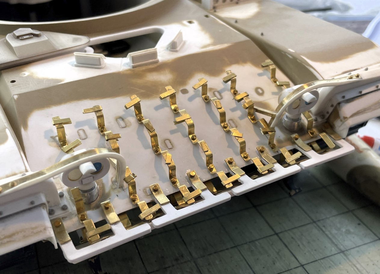

One more look at the ERA attachments. Each loop around the brackets and connect to one of the 4 bolt on the ERA blocks. The ones on the sides do show a lot.

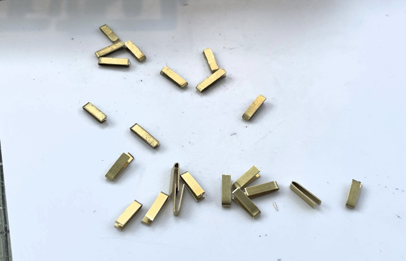

They are made using thin 2mm wide brass strips.

The attachments are positioned and then glued to the brackets. The middle attachments are only spacers because they won't show.
