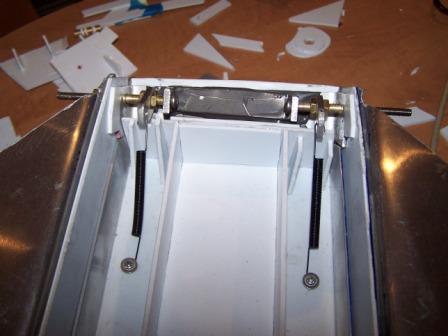

well FV432
here is a pic of my idler tensioner, The springs are from a muffler on a 1/10 buggy, the bolts everything sits on are stainless with brass nuts. There is sections of brass tube that sit over the threaded bolts and then bearings at the pressure points in the hull and on the outside of the posts. It moves quite freely with rising tension. With the rear wheel drive I am hoping I only need to keep the pressure on the idler from a downward motion as the track will be pulling on the idlers. when the tank is reversing there will be no tension on the idlers at all. If i run out of tension all I have to do is move the screw on the floor plan farther back stretching the spring more. I think this should work quite well, I love the rising tension of the spring when stretched a bit it becomes quite strong.
The bolts you see sticking out at the front will be cut off, now that both sides work I need to make it look better.

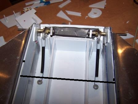

Post by Saxondog »
Might I suggest another bar across the hull,using this to retain the springs,it will also act as another stabilizing member for the hull sides?
Also this will remove any interference with your suspension system?

Post by FreakyDude »
Saxondog that spot is where the SLU will go when I get it. I am going to try and get everything I can in the front now as it does seem to be rear heavy at the moment.

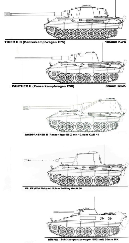

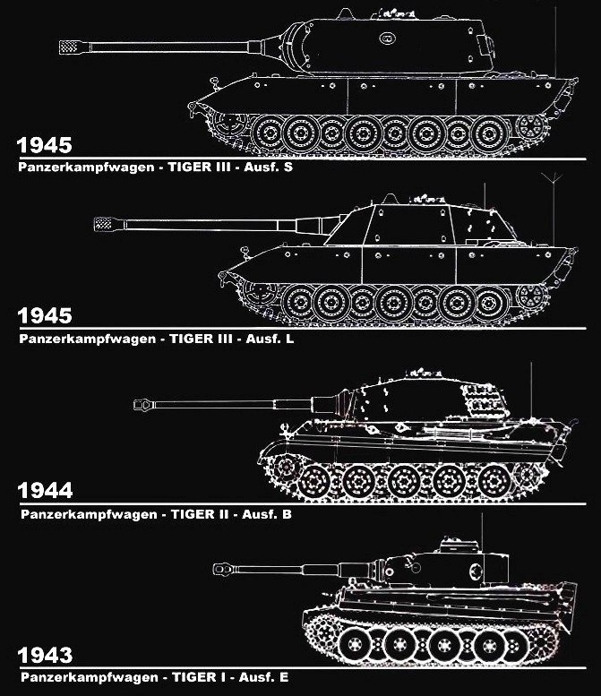

Saxondog
Posts: 4293
Location: Tennessee-U.S.A.
Re: German Armour What If?
Post by Saxondog »
Ok give me a moment to find them,be right back
These I POSTED BEFORE
i DON'T THINK i posted these but the middle one possibly
