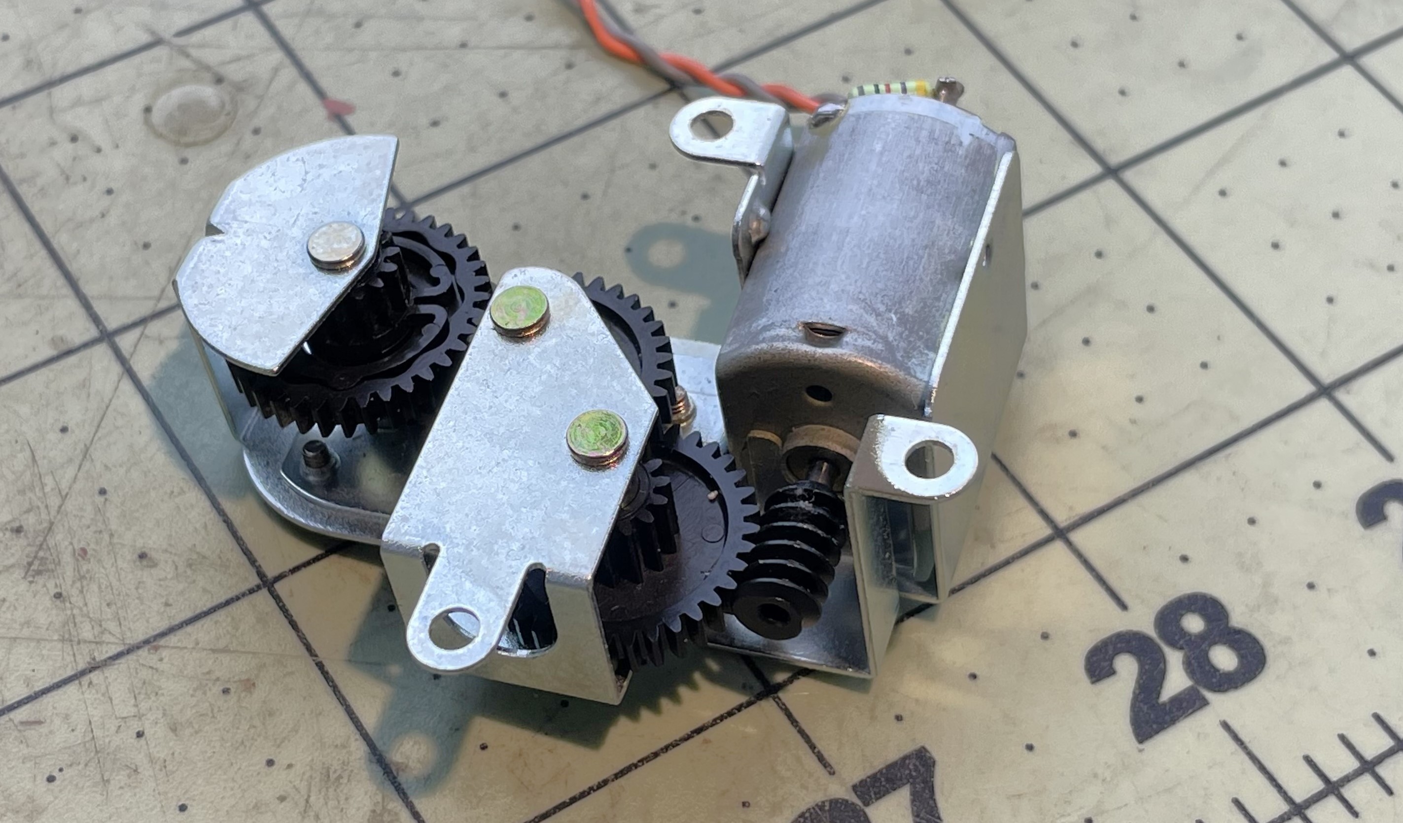

After extensive tests this morning, i had a failure with turret rotation. It started with one click, then followed a bit later 3 clicks, then a bit later 5 clicks and so on until the turret stopped rotating.
Looks like having to work harder to handle the tube for gun smoke recoil is taking a toll on standard rotation units.
I had to reopen and unplug everything.
1/16 RC M4A3E8 Korean war - Restoring Tamiya M4 with Takom kit - build
It worked well during previous tests. The little Tamiya rotation unit that i reused is no longer able to support any pressure, now its worthless and weak. I guess smoking cigars was too much for it...
Too bad. Lessons learned, gun smoke recoil needs a stronger rotation unit. Now i am starting to worry about the recoil servo.
The only reason for using it other than nostalgia is because it could be positioned at the front, allowing the reuse of the large Tamiya speaker at the back. No way around it, both of them have to go now.

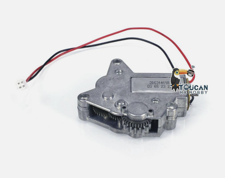

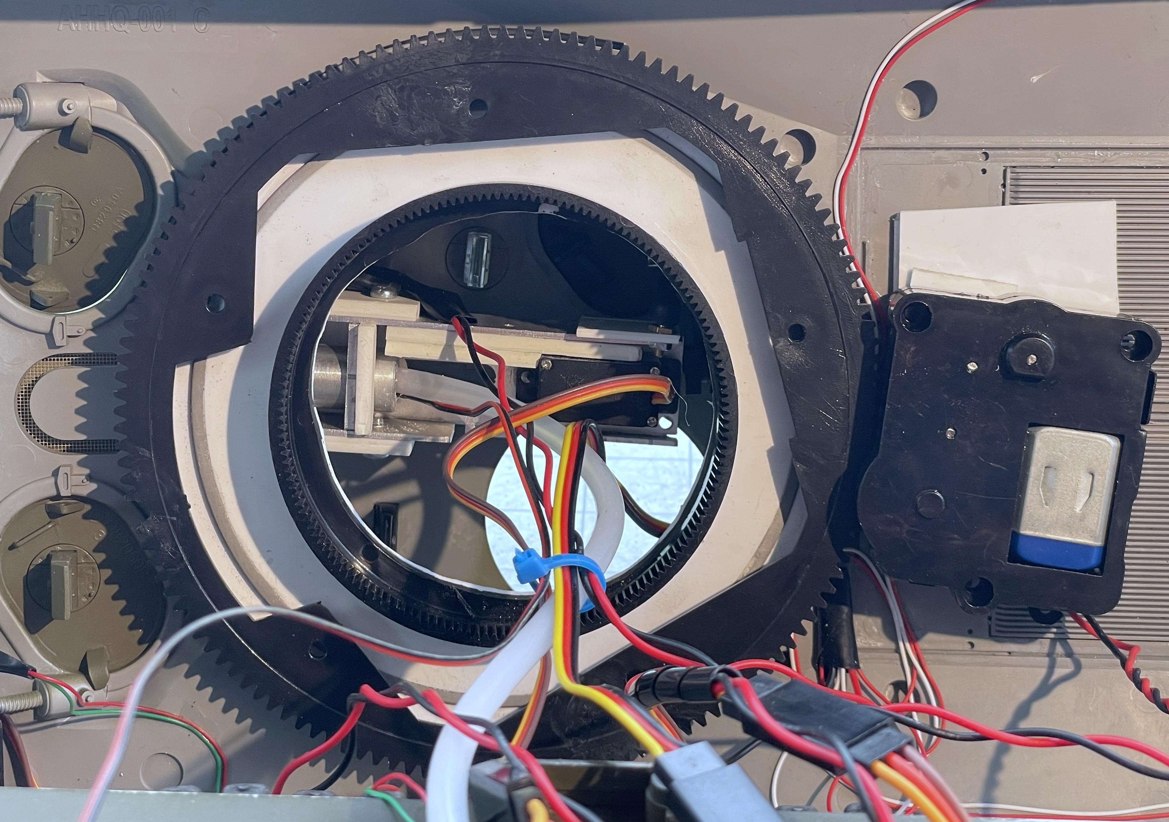

I redesigned the rotation and it's now using a large Heng Long rotation wheel. I temporarily installed a regular plastic Heng Long rotation unit i had on inventory so that i can continue my tests until it can be replaced by a metal rotation unit.
A new metal rotation unit is on order from China. Looks like the design of these was recently upgraded, taking less room. I'll see how it performs.

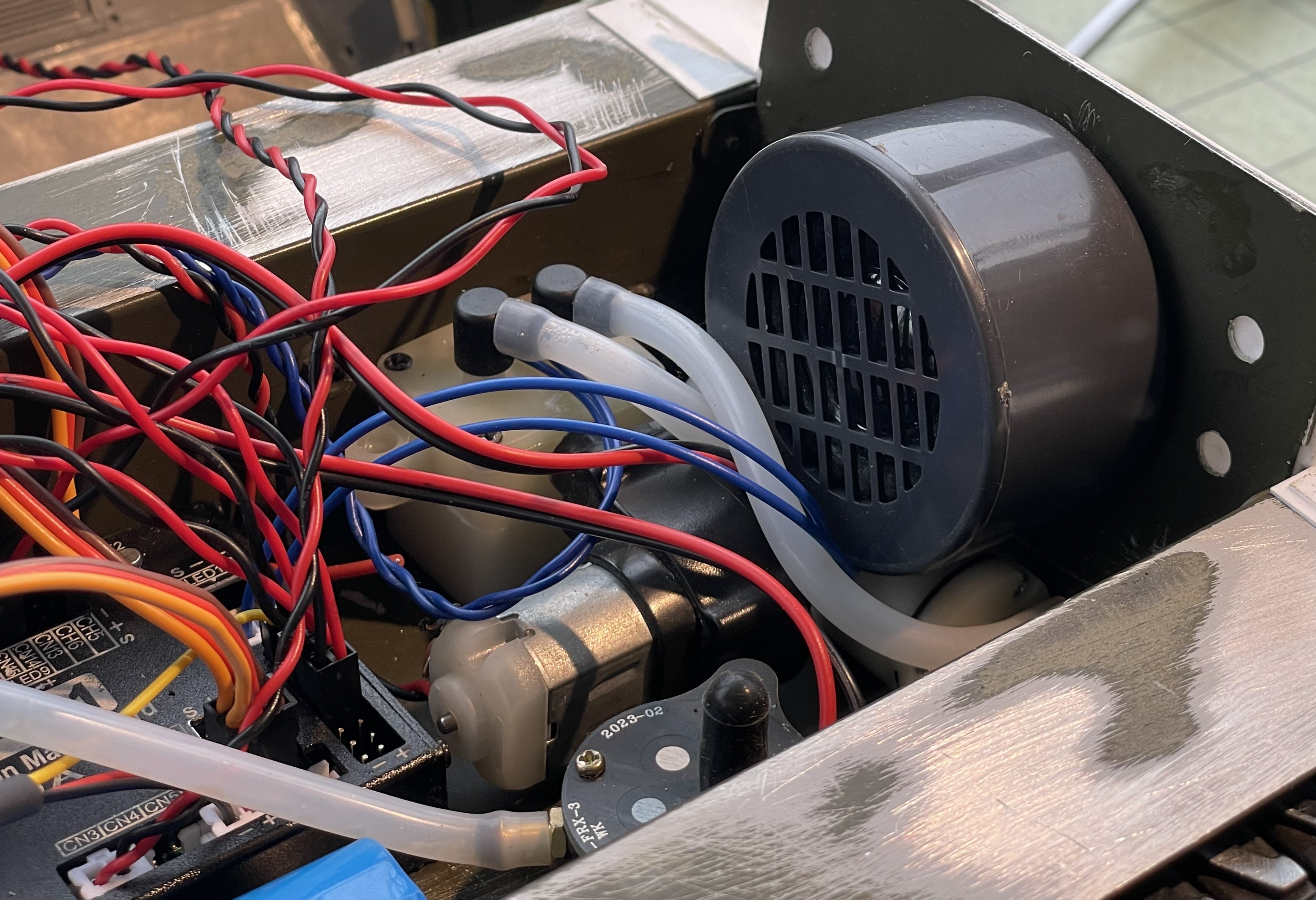

Smaller speaker now at the back. Feel sorry for the big guy, it worked well but was just taking too much room.

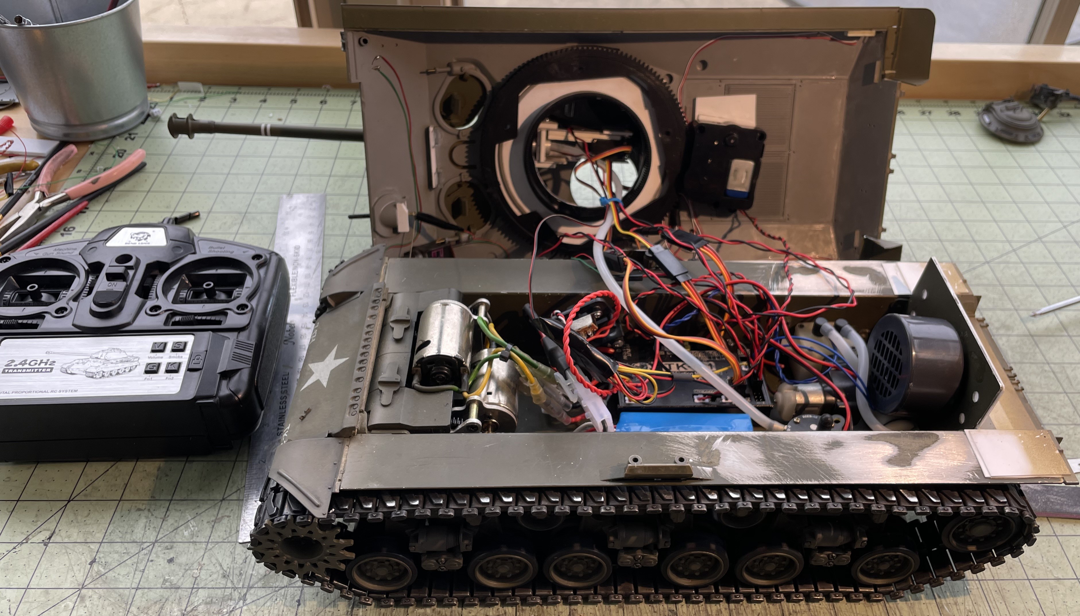

This is the new electronic layout. It's actually simpler and better spread out. Now only the Tamiya gearbox is reused.
