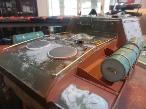

Bottom photo - leave one empty. Looks best in my opinion
- Son of a gun-ner

Believe me Mr lav, Ive chewed that over a lot !!Ad Lav wrote:Bottom photo - leave one empty. Looks best in my opinion
Its not off the list of possible outcomes yet either.
Actually, if it weren't for having to need rope to visibly retain it, I would almost use magnets to stick it on so I could have it both ways

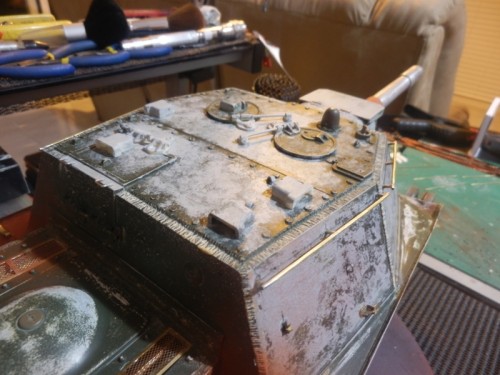

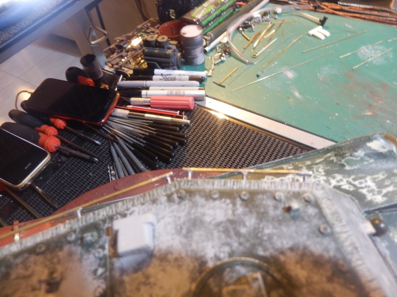

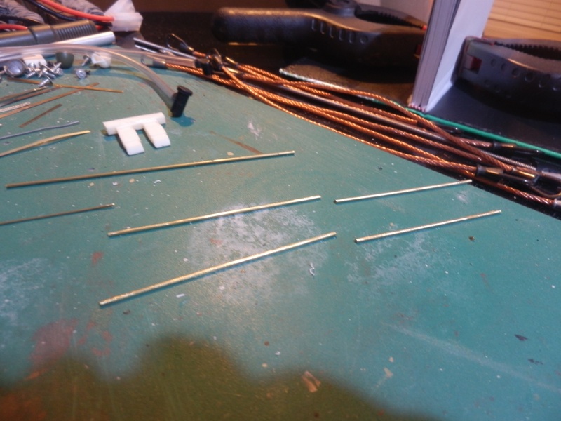

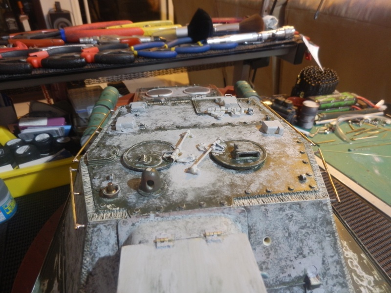

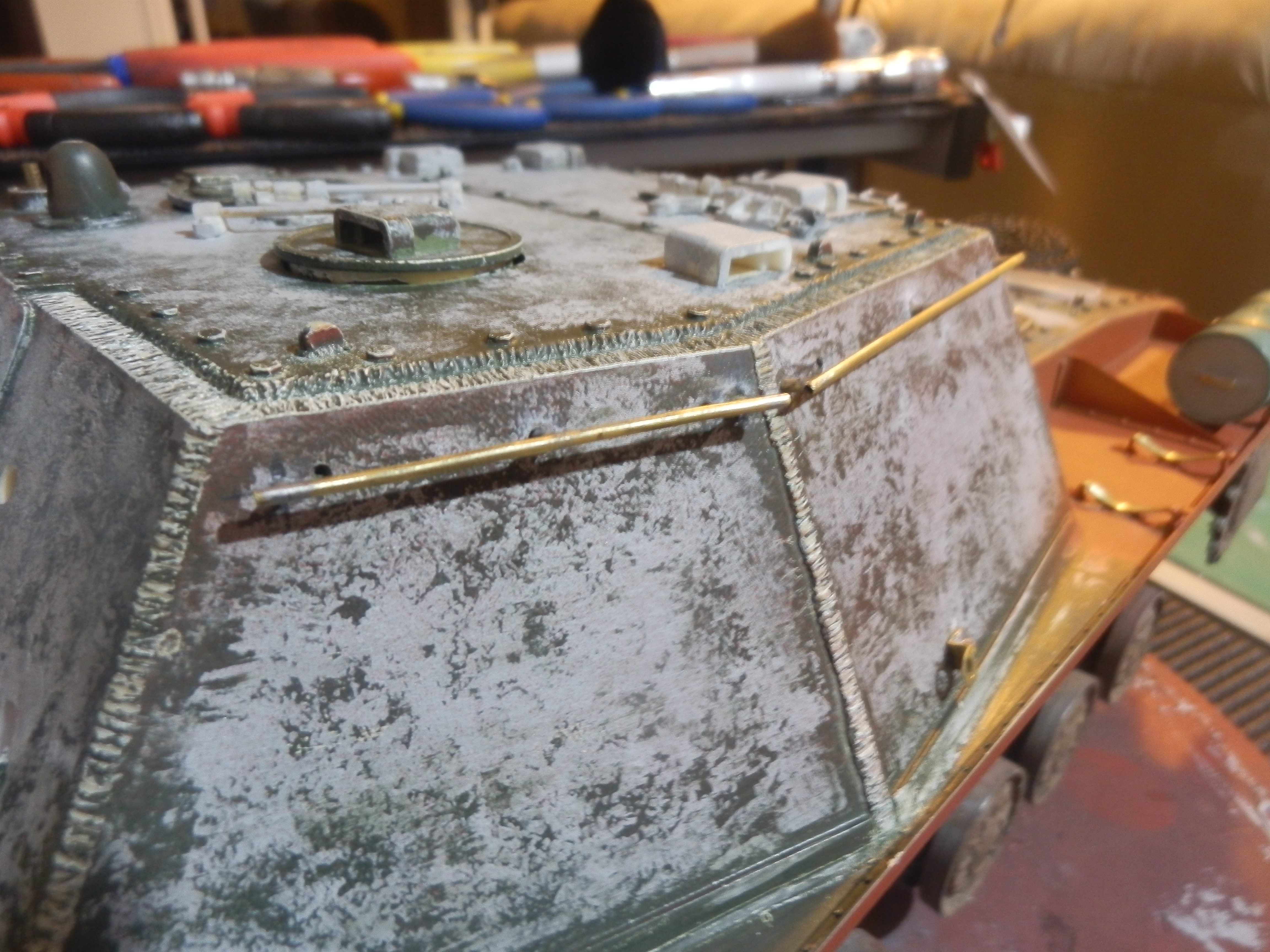

The grab handles on these Russian things are very iconic, all their AFv';s had them in some form or other, so on mine go.
Used brass tube at an O.D. of 2mm & sliced short sections off to make the points that go onto the hull sides.
cut with a pair of side cutters, the crimped end was dressed with a file to allow room to be soldered onto the long handle section, yet still retain a lot of solder after cleaning up.
The other end was cut square with an old razor saw.
I soldered the short bits onto the long handles with solder paste by simply drawing a series of lines on a lump of MDF to position them, chucking on the paste, and hitting each joint with a burner.
I used no more science to place them on the upper hull plate than marking a line to get the height, and pencil marked each mounting point across that line.
Then drilled through the resin casemate.
Super glue on each mount(for each hole) and a spacer block to ensure consistent stand off.
Job done.
I still have to do the engine deck ones, and the rear casemate one, but they look great on
Job done.

Looking good. Looks like the rails I did for my SU-152 build and I attached them the same way, but I didn't use a spacer block. No block because....Russian.

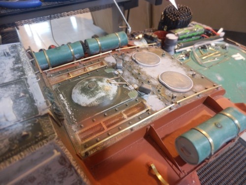

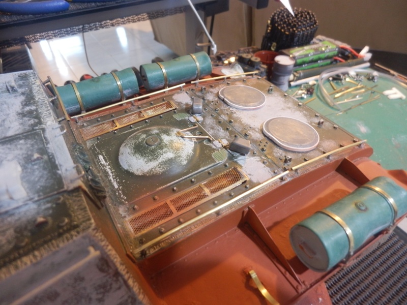

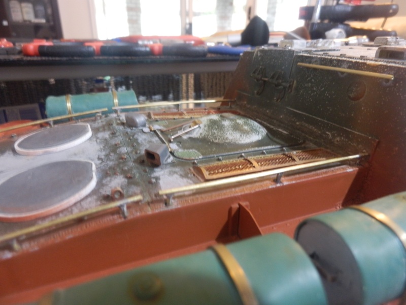

I made the rear deck grab rails the same way as the casemate ones.
Solder paste & minimal clean up.
