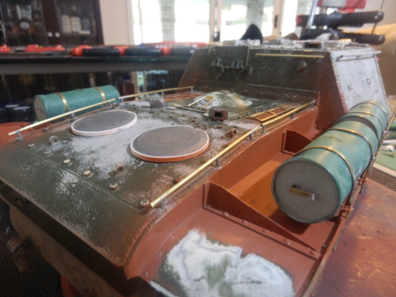

Bottom photo - leave one empty. Looks best in my opinion :)

Ad Lav wrote:Bottom photo - leave one empty. Looks best in my opinion :)
Believe me Mr lav, Ive chewed that over a lot !!
Its not off the list of possible outcomes yet either.
Actually, if it weren't for having to need rope to visibly retain it, I would almost use magnets to stick it on so I could have it both ways :/

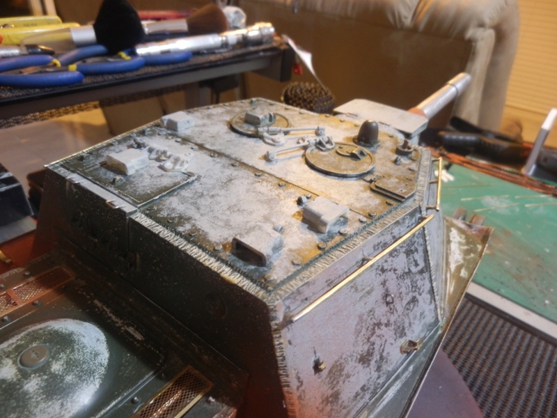

The grab handles on these Russian things are very iconic, all their AFv';s had them in some form or other, so on mine go.
Used brass tube at an O.D. of 2mm & sliced short sections off to make the points that go onto the hull sides.
cut with a pair of side cutters, the crimped end was dressed with a file to allow room to be soldered onto the long handle section, yet still retain a lot of solder after cleaning up.
The other end was cut square with an old razor saw.
I soldered the short bits onto the long handles with solder paste by simply drawing a series of lines on a lump of MDF to position them, chucking on the paste, and hitting each joint with a burner.
I used no more science to place them on the upper hull plate than marking a line to get the height, and pencil marked each mounting point across that line.
Then drilled through the resin casemate.
Super glue on each mount(for each hole) and a spacer block to ensure consistent stand off.
Job done.
I still have to do the engine deck ones, and the rear casemate one, but they look great on ;)

Looking good. Looks like the rails I did for my SU-152 build and I attached them the same way, but I didn't use a spacer block. No block because....Russian. :)

I made the rear deck grab rails the same way as the casemate ones.
Solder paste & minimal clean up.
A bit of a giggle moment last night. After I drilled into the engine deck, I wanted to remove the resin drill spoil that was curls of resin all over the show.
So, I took a deep breath & blew violently over the entire surface of the tank to get it all off..........................dropped a massive glob of (actually God knows what) out of me gob onto the engine deck :wtf: quite messy & not real good to remove :{ :/
Warning kids, use a brush or an air duster !!
