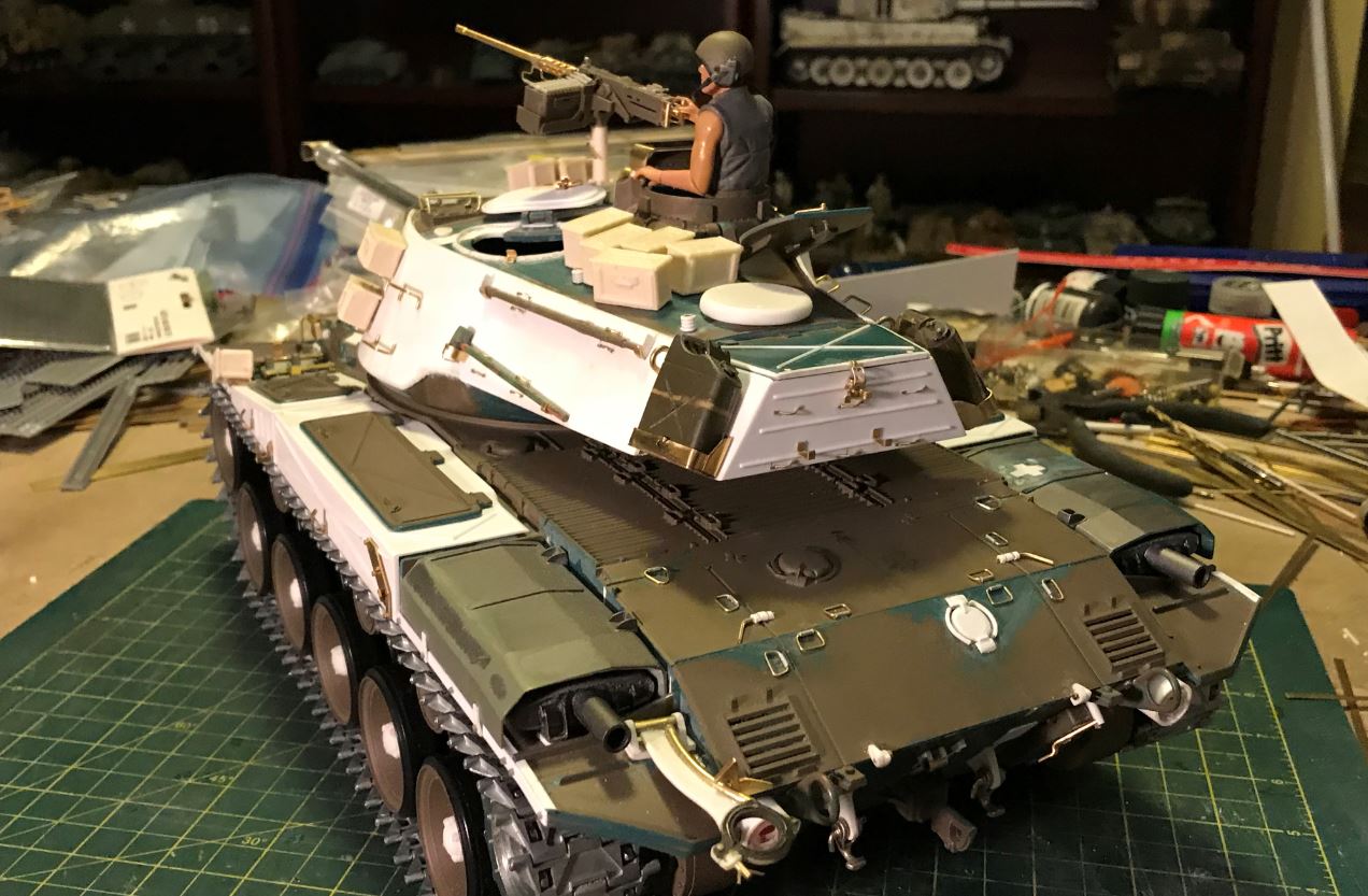

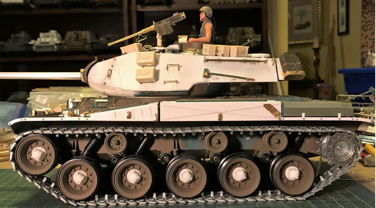

Now, the construction phase is finished and here are some details on the remaining work that was done.
Overall view
M41 A3 Walker Bulldog 1/16 RC Heng Long updated fixed

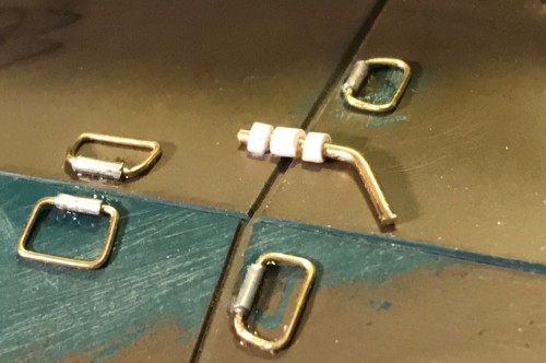

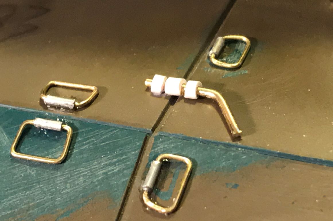

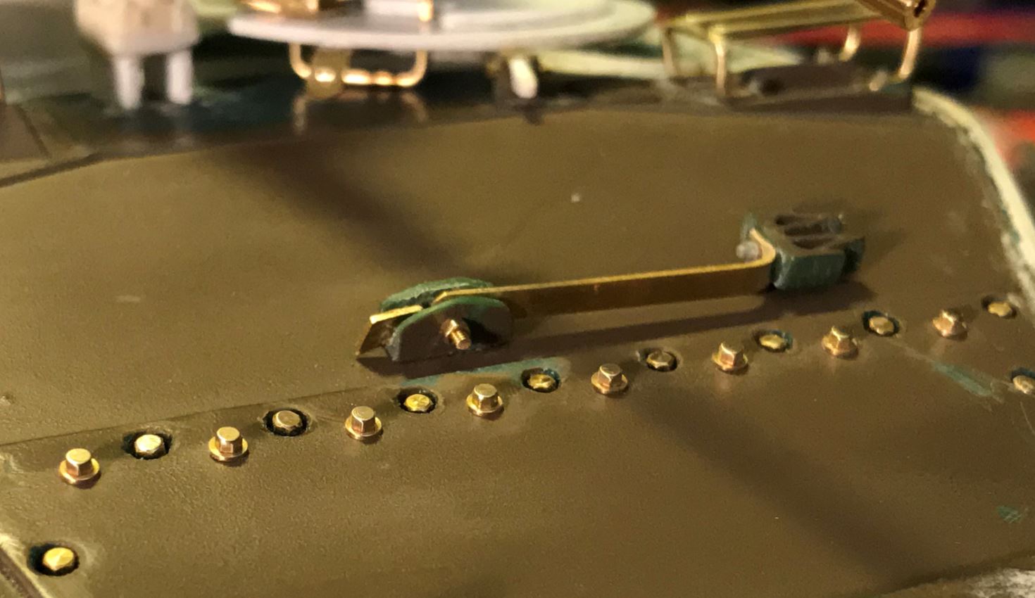

Latch on the rear deck
Storage holder for the tow hook when not installed.

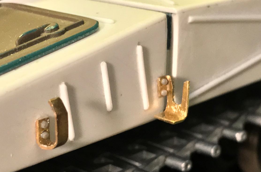

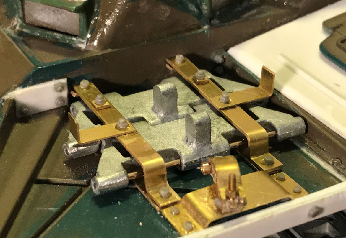

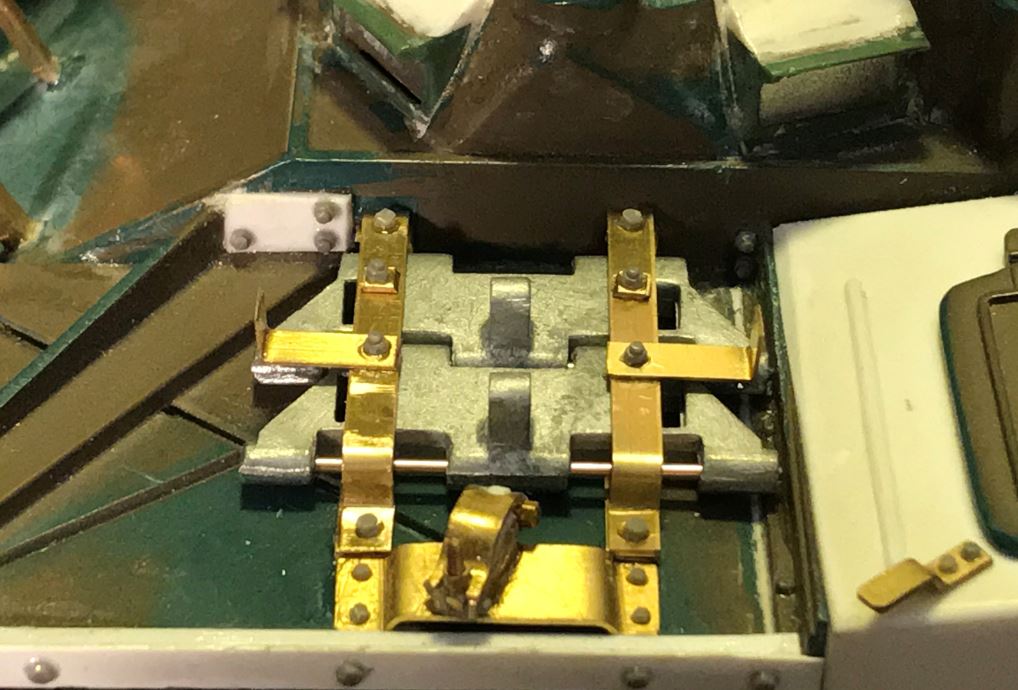

Spare track holder. I was happy to see that the new 32mm tracks fit perfectly in the allocated space. This is something that cannot be done with regular HL 40mm wide tracks. They do not fit. The holder was built as per reference picture.
I was missing a complicated bracket for the tow cable holders.

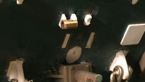

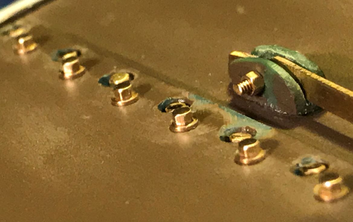

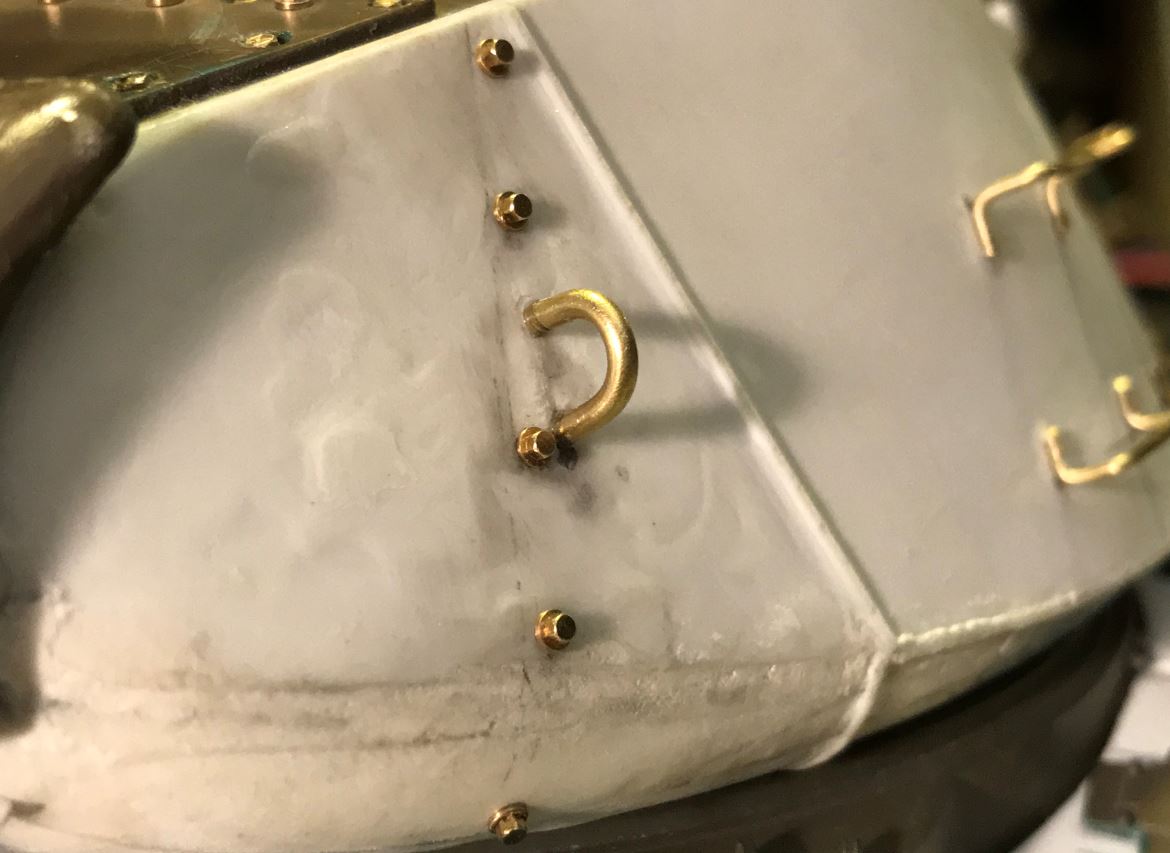

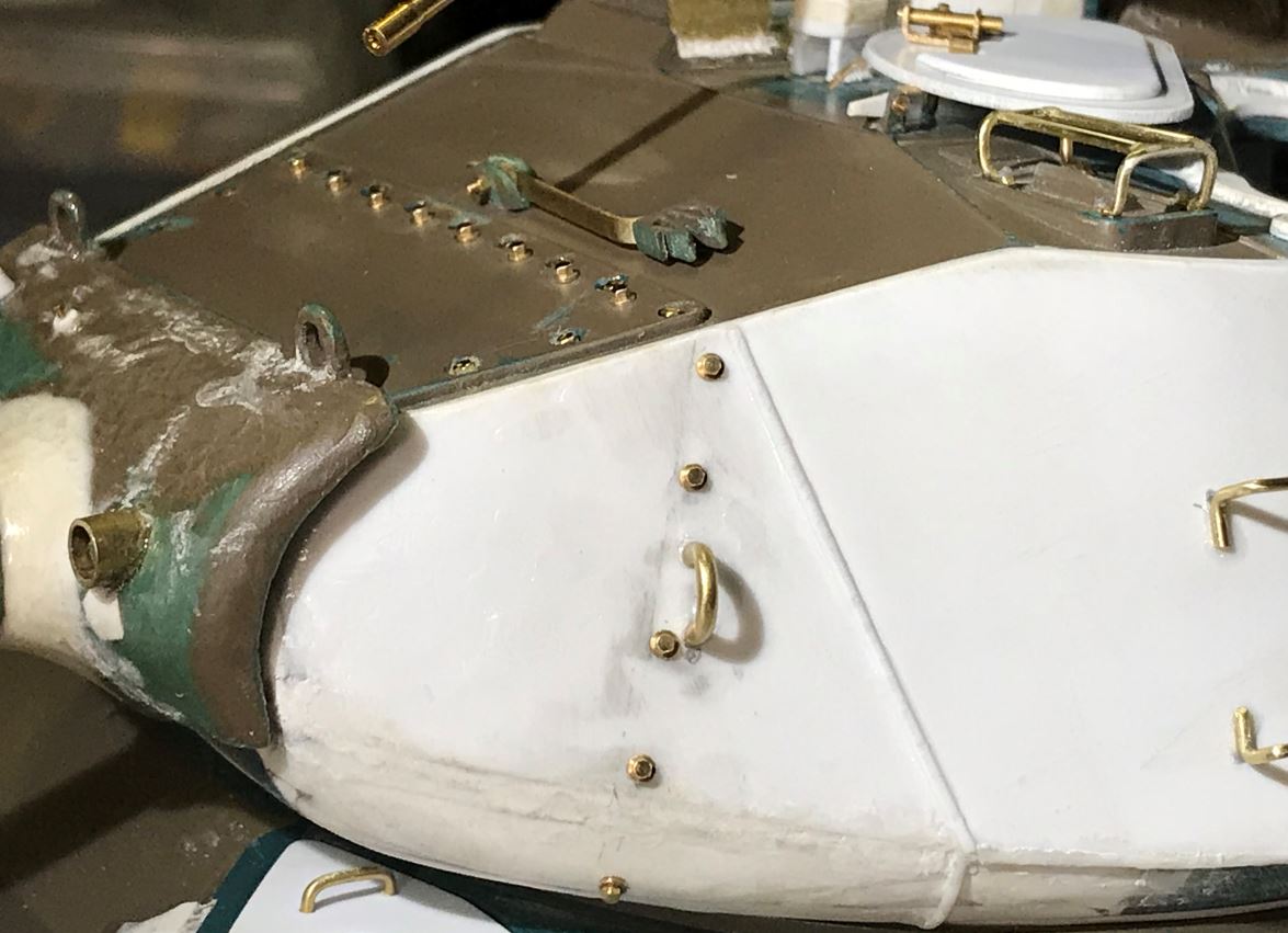

Brass job for the bolts on the cast nose of the turret. The HL molding on the top was showing pins instead of bolts.
I decided not to reproduce a canvas rain cover for the gun mantlet. Whatever I would have been able to achieve would not have looked good. It would have been easier if the gun was static but as it need to elevate and the barrel to recoil, it would have been extremely difficult to do a good job. I understand that in Vietnam, there is a rain season and a dry season. It would be logical for the crew to remove the rain cover during the dry season in order to preserve it. I also saw many pictures of M41 in Vietnam without it. However, the retaining bolts for the canvas need to be positioned.
The larger bolts for the cast nose are M1.0 size, the smaller ones for the canvas are M0.8 with washers. It would have been better with M0.6 but I am out. I need to replenish my brass bolts reserve after this build.
continuing on following post
Re: M-41A3 Walker Bulldog - ARVN Vietnam 1970s - Build

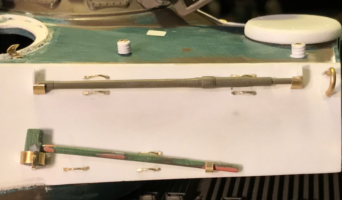

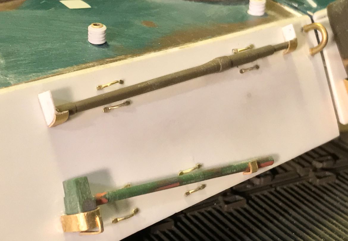

Spare MG gun barrel and hammer holders on left side of turret. The MG gun barrel is the Tamiya one, leftover from the Aber conversion.

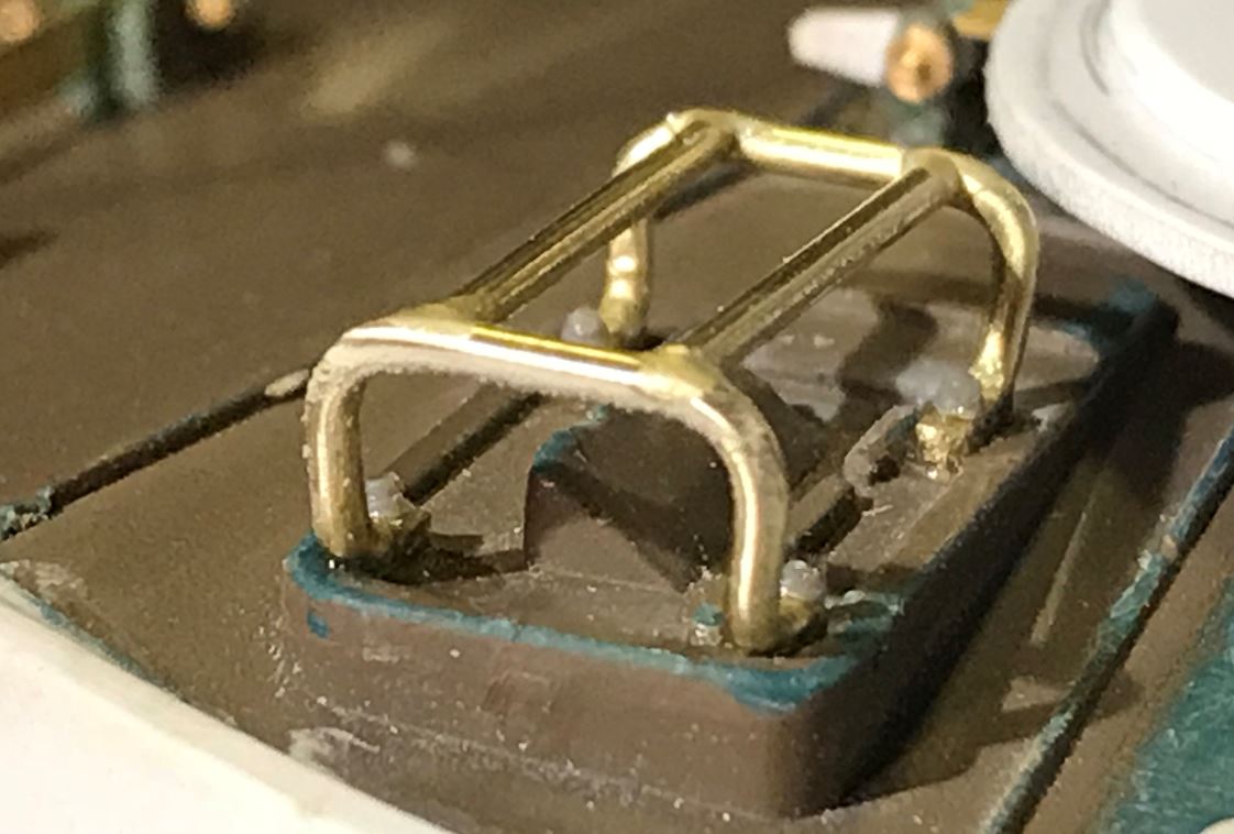

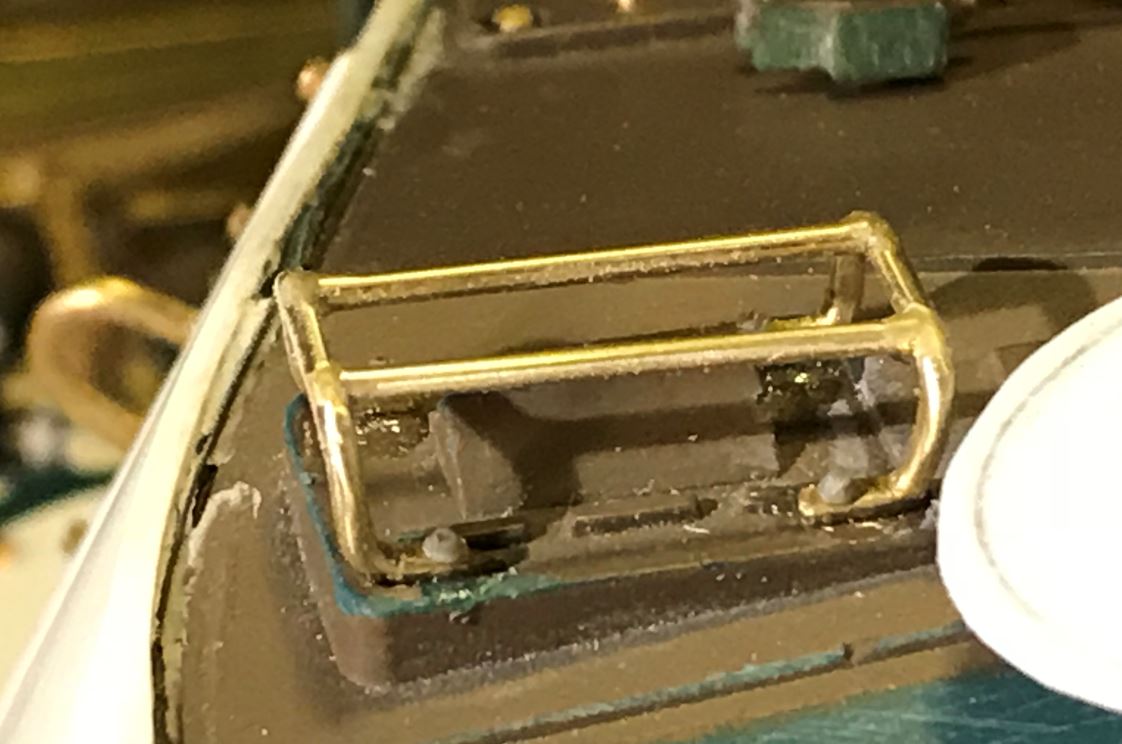

The guard for the loader's periscope was redone in brass.

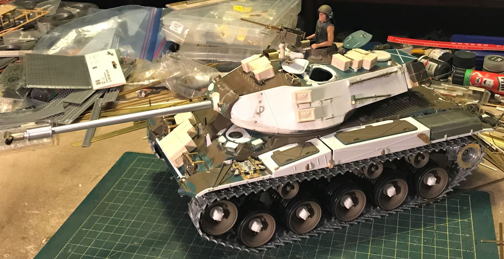

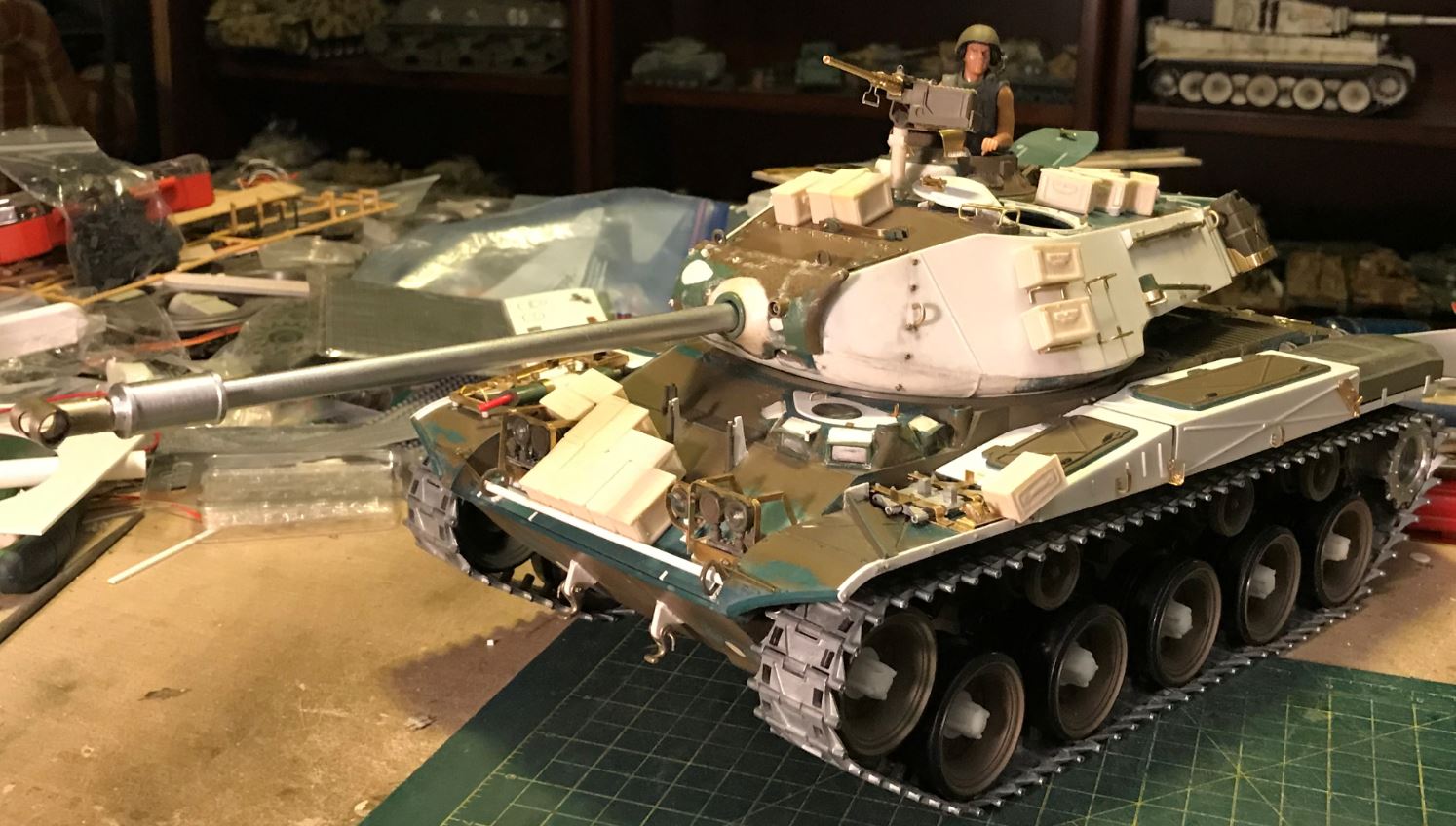

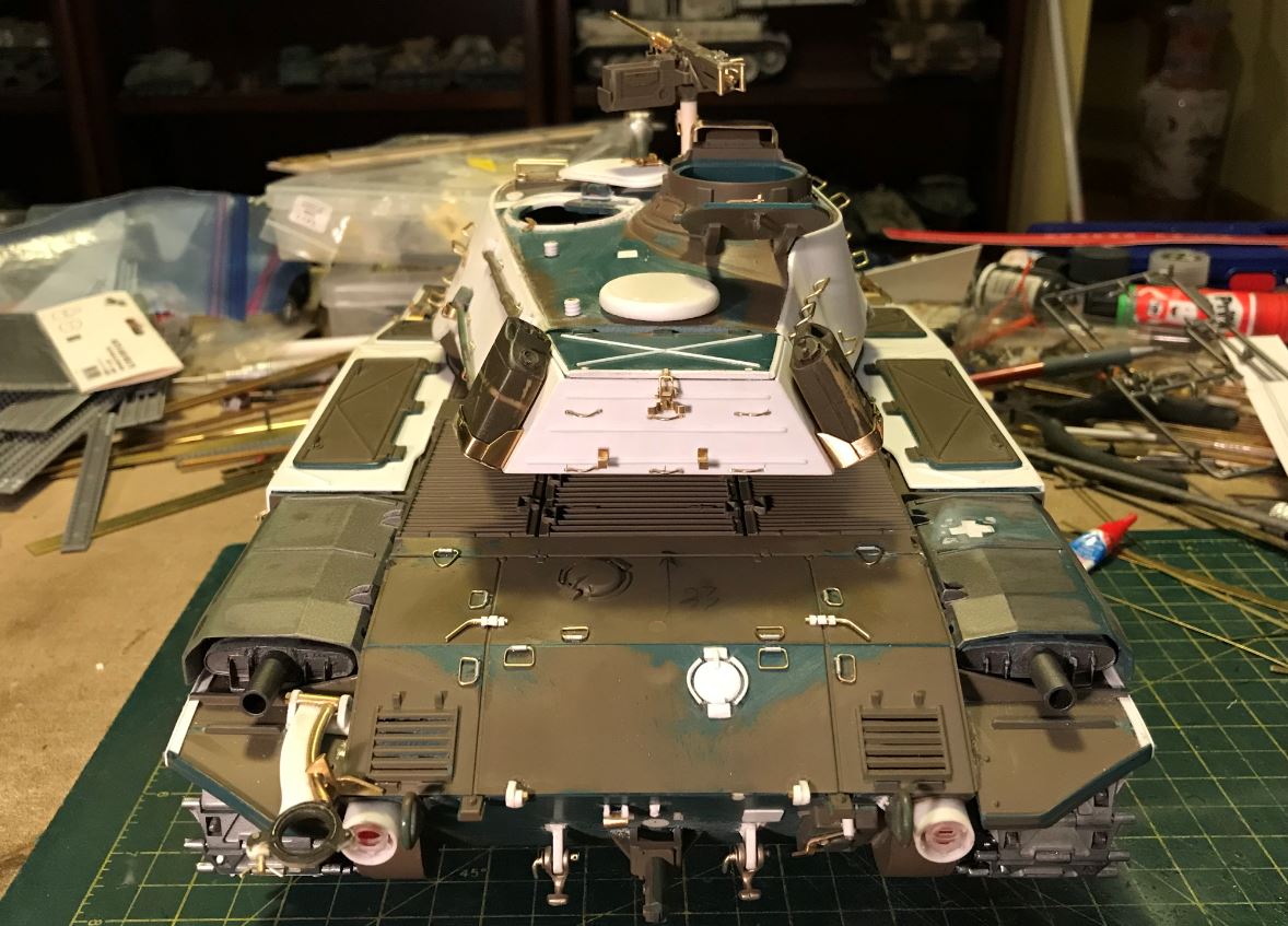

Last views prior to the painting and weathering job. From pictures I have seen, ARVN M41 were painted in a very dark Olive green with a dark blue tone. I will have to do some more research. In the meantime, I will give it a Tamiya OD oil based primer prior to acrylics. Yes Barry, it will have some red dust too.
This is it, construction is over. The model and the whole work place need a thorough clean up, dust, tools and material everywhere, I lost control. I have never done such a dusty project in the past.
Also need to start assembling the ARVN crew and infantry and I will show that as well soon.
Regards, Louis

Yep, that's an awesome build!
The idler can be correct as it is. There were three versions of the idler on the M41. Two with variations on the rubber tire and one without the tire, which had the oval cutouts.
Looking forward to the paint job, even though all of that work is an art piece of itself.
