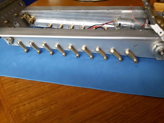

New suspension arms.
IMG_20190506_104152 (Small).jpg (58.19 KiB) Viewed 4785 times

New and old arm.I added two O rings to the new arms.
IMG_20190506_102016 (Small).jpg (62.57 KiB) Viewed 4784 times

Another view.
IMG_20190506_101915 (Small).jpg (63.69 KiB) Viewed 4783 times

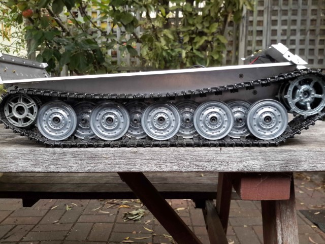

New front left side look.

Left side.

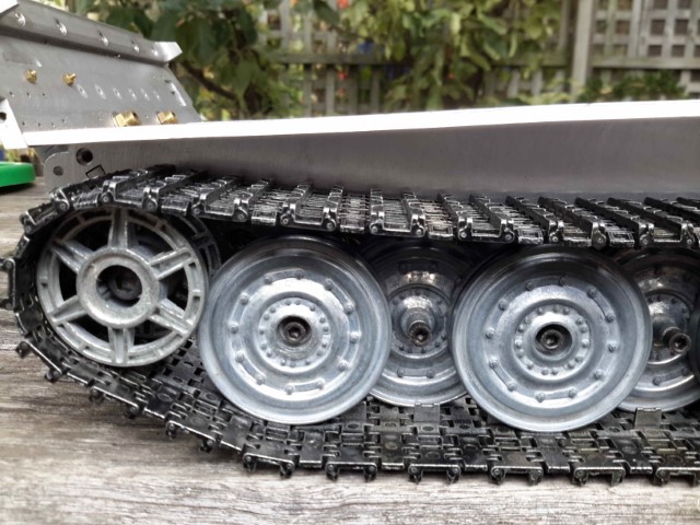

Right side.

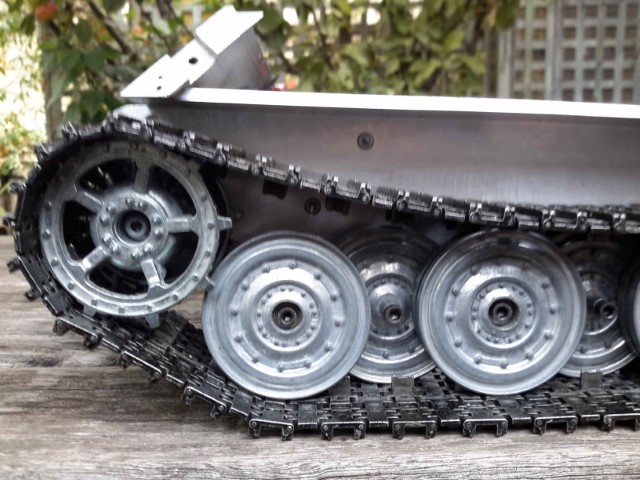

Right back.

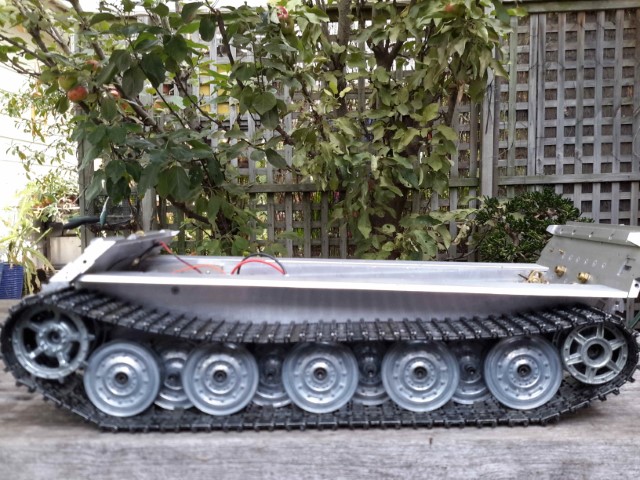

New suspension arms fitted.
IMG_20190215_105401 (Small).jpg (94.09 KiB) Viewed 4782 times
