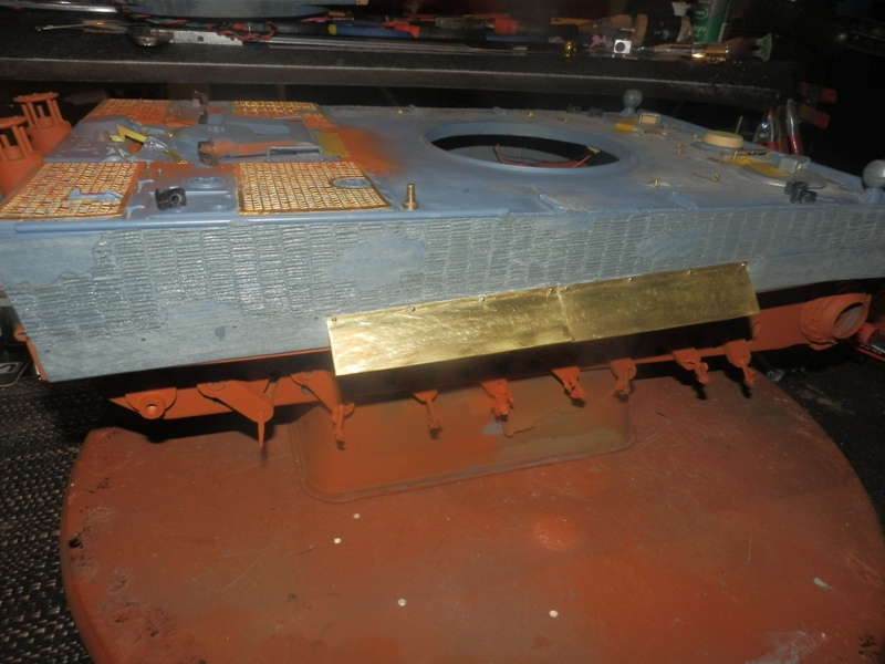

PainlessWolf wrote:Good evening, Herman!
Drill those brass 'fenders' for mounting while they are off the vehicle. I learned this lesson reattaching a couple of the ones that came loose during shipping on Jack's Tiger. I figure as or if the others come loose while running, I will drill them and mount with Tamiya hex head screws until they are all down as such. Your Tiger is really coming along, Doc. ;o)
Yip, marked each one to match the holes I made in the hull as datums for what I thought then would be simple square mounting blocks.
Got the impact resistant gel super glue along the inside edges of each guard, placed all 4 pins into position & squeezed the lot to the hull.
Once the super glue dried, I ran a bead of PVA along the joint to add some substance to the mounting.
Had to go to the little girls end of year dance concert/show so no more done, plus I ran out of super glue :/
As for Tamiya screws, I took all of them out of that King Tiger I have to get the guards off it and tidy the outside up, and I swear I will never inflict such difficulty on myself if thats the way them things roll :wtf:
Still to do the obligatory dings and deflections on the guards once the gel and PVA has completely cured.

PVA = Elmer's glue, correct?
Posts: 11885
Re: FEHRMANN GRUPPE TIGER 05
philipat wrote:PVA = Elmer's glue, correct?
I believe so Sir, yes.
I have used an equivalent "school glue" in the past, but the stuff I use now is pure woodworking quality which seems to be a lot tougher.
It cures like a slightly flexible epoxy so it copes with a lot of impact.
Drys very clear and under the guards is invisible anyway.
Adds sort of a giant fillet weld of support underneath the triangulated joint area .
Time will tell of course but these things seem pretty tough.
I used a similar method to secure the single mudguard section to my Jagdtiger and it has copped a flogging- deep scratches and all with no loosening off.

Awesome! Thanks. We have various versions of Elmer's glue - school and wood. I used the clear school glue with a little transparent green paint to make the glass effect in my PzIV. Handy stuff.

Very nice work indeed, your zimmerit looks awesome! The Tiger is my favorite WW II German tank and you are doing a excellent job!!! :thumbup: :thumbup:
