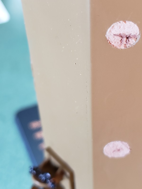

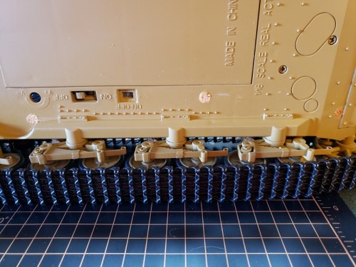

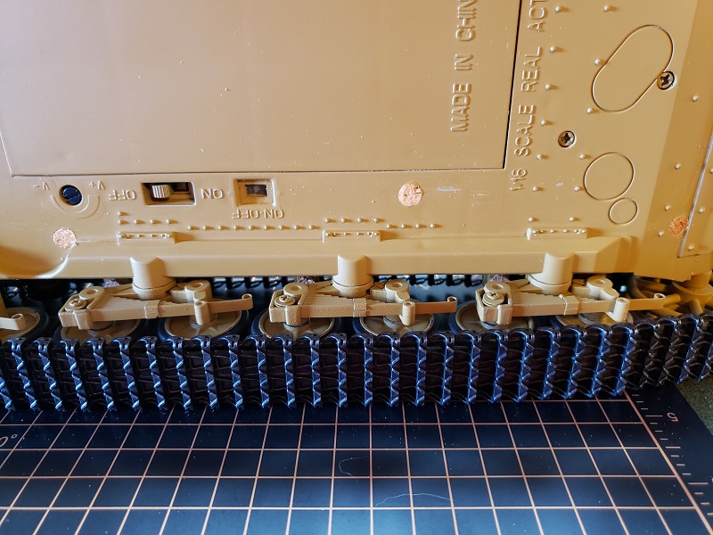

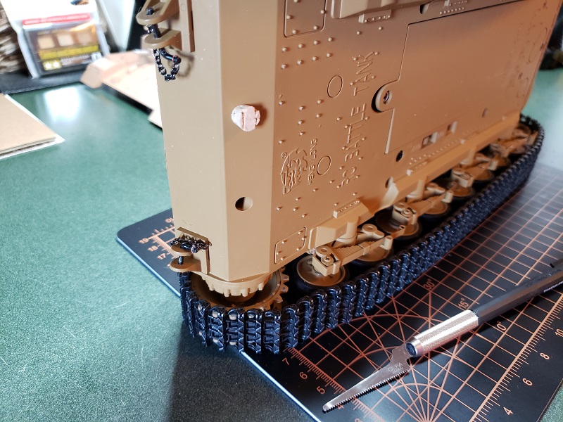

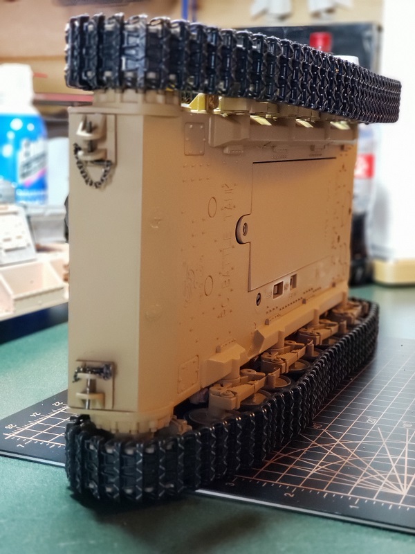

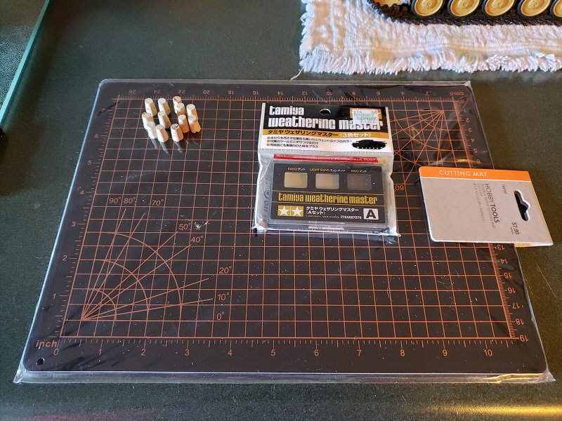

Today saw a project lined up for the Office but I was still able to grab an hour to work on the Pz IV. I had sourced the right diameter corks to plug the eight screw holes on the Lower. Installation was simple, insert as far as the cork will go then then trim the excess off ( I use a Tamiya hobby saw ). Use a gel cement to harden the face of the cork plug. Follow this step up with primer and paint and once the weathering is done on the completed Tank, you should have a hard time locating those screw mounts.
Excess trimmed off.jpg (69.96 KiB) Viewed 3075 times
Corks and fresh Weathering Pigments and a new Cutting Mat sourced from the local Hobby store and Hardware.....jpg
