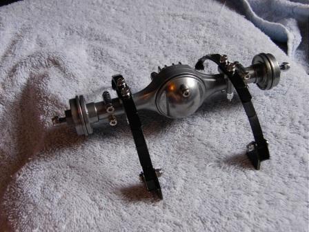

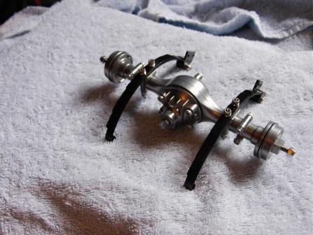

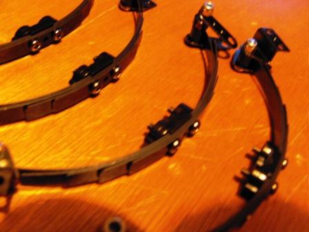

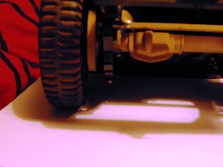

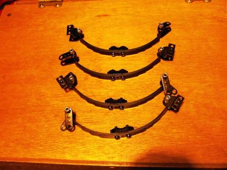

hi all a package arrived for me today containing the tamiya leaf :D springs they look like they were made for this jeep i have assembled them and have taken some pics they are only blutacked in place to get an idea of where they will go cant really fix them on till i get the axles they also look too low so will have to alter them :think:

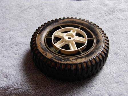

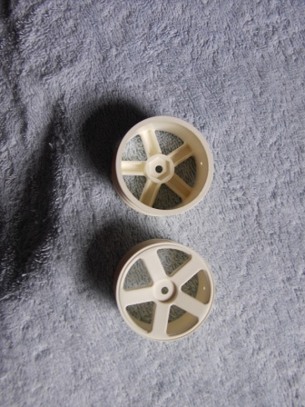

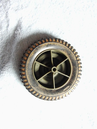

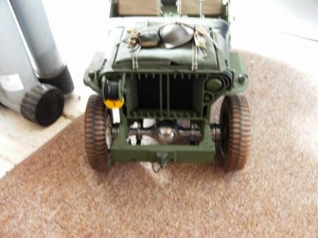

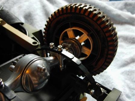

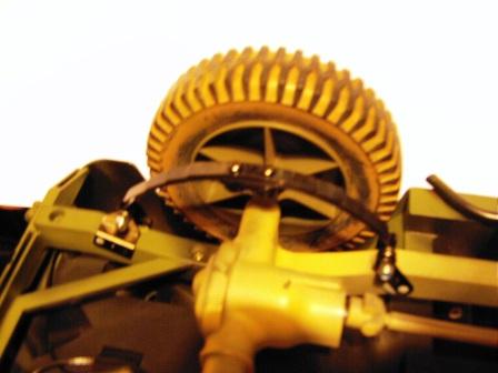

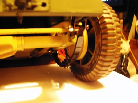

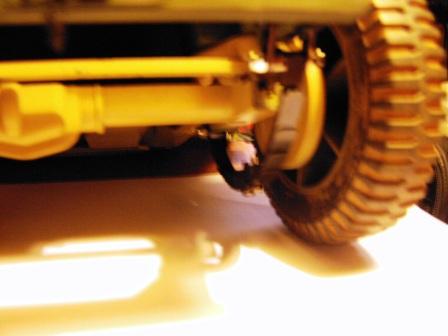

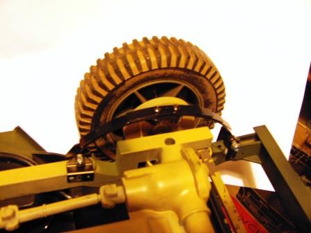

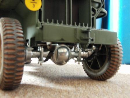

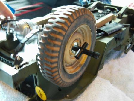

hi all i had a parcel on monday the axles have arrived :D here are a few pics.
The leaf springs dont line up with the chassis rails so i mounted them to the body floor i had to modify a set of tamiya style wheels to fit the originals and cut the center caps off so i could get my spanner in to bolt them on.
The pics only show a mock up they werent perminantly fixed i had to modify all four wheels so i could line every thing up to get the proper stance they are now all bolted on and turning smoothly i will etch prime and paint then take more pics in the meantime enjoy hope you like :thumbup:
