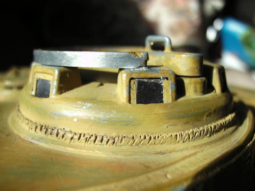

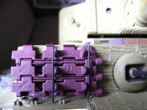

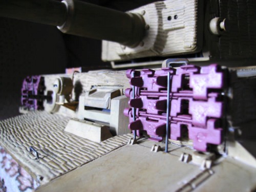

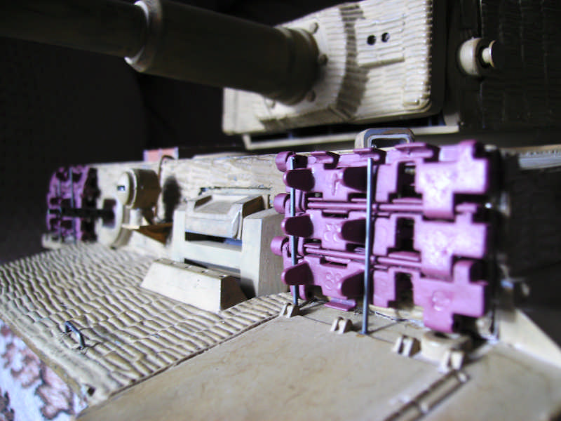

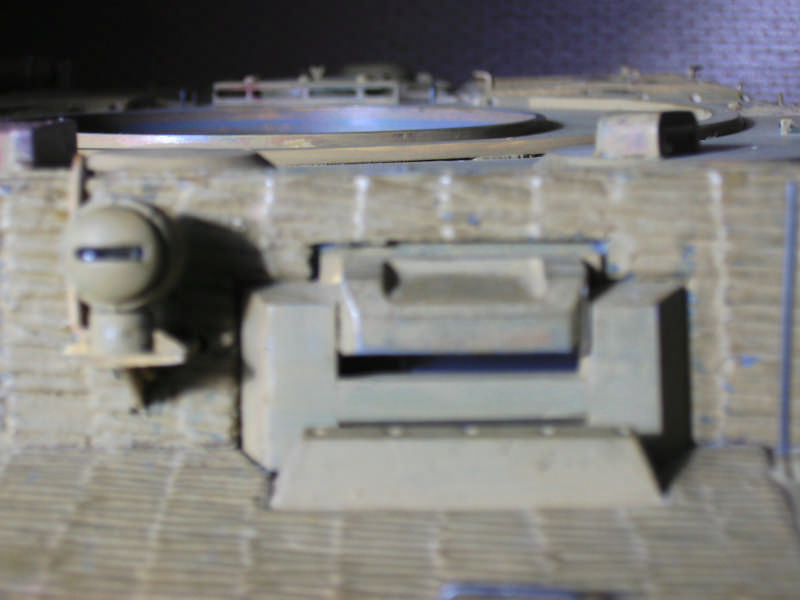

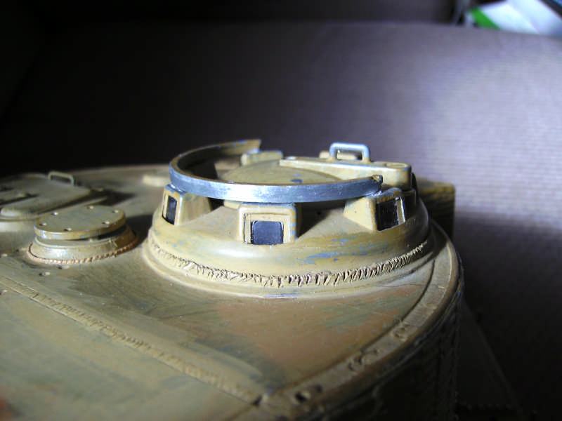

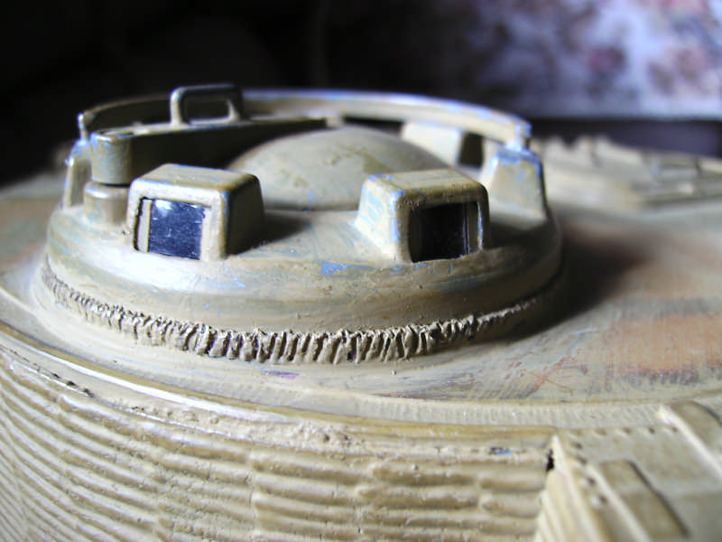

have done a little more on tiger,opened up vision port/made bracket / fitted metal headlight and wire and four bars for extra track links on front/drilled out mg for flash.

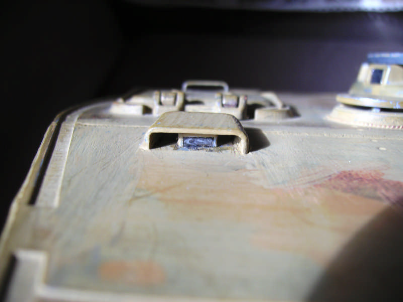

done a bit more on tiger
fitted metal vent/coupler/and a few other bits.

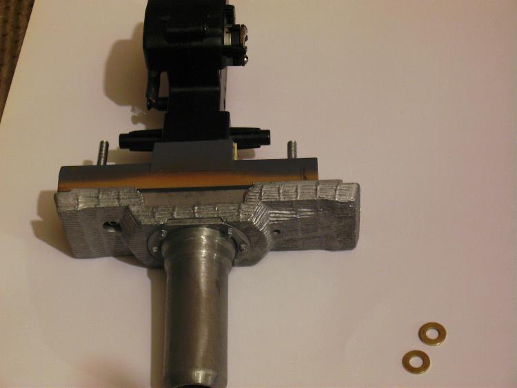

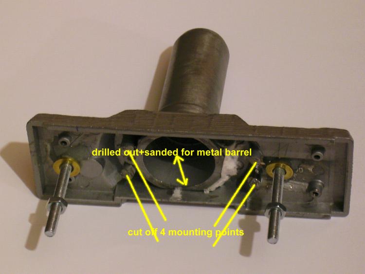

long time since my last update on tiger rebuild, had one of those hachette metal mantlets laying around so i fitted it with a panther recoil unit and metal mato tiger barrel.
Copy of 43.JPG (34.36 KiB) Viewed 2487 times
drilled out the mantlet/to take the metal barrel/cut off the moutings points/araldited on 2 screws.

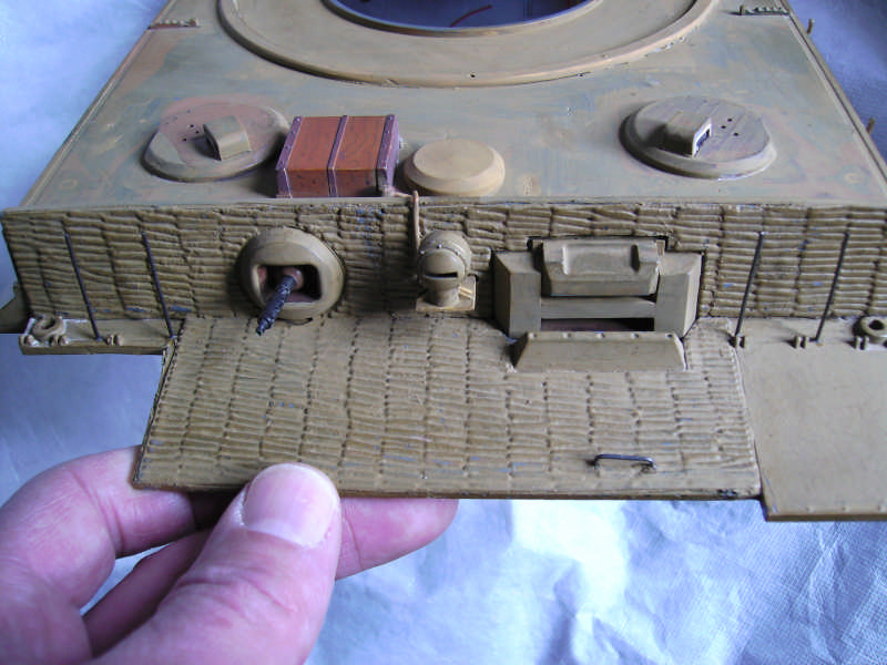

Great build. How did you do the vision port mod? Have also gota hachette mantlet...Worthwile mod ? Cheers

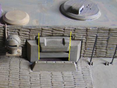

Copy of 27.jpg (19.23 KiB) Viewed 2442 times
remove drivers vision port from hull with a sharp blade take your time me be alot of glue on it, then cut out the middel bits rebuild it with the vision port open. i used off cuts of old plastic card/rod on the inside,then filled it all in with model filler then sanded it flat. cost nothing :thumbup:

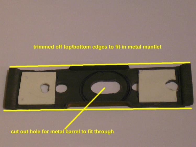

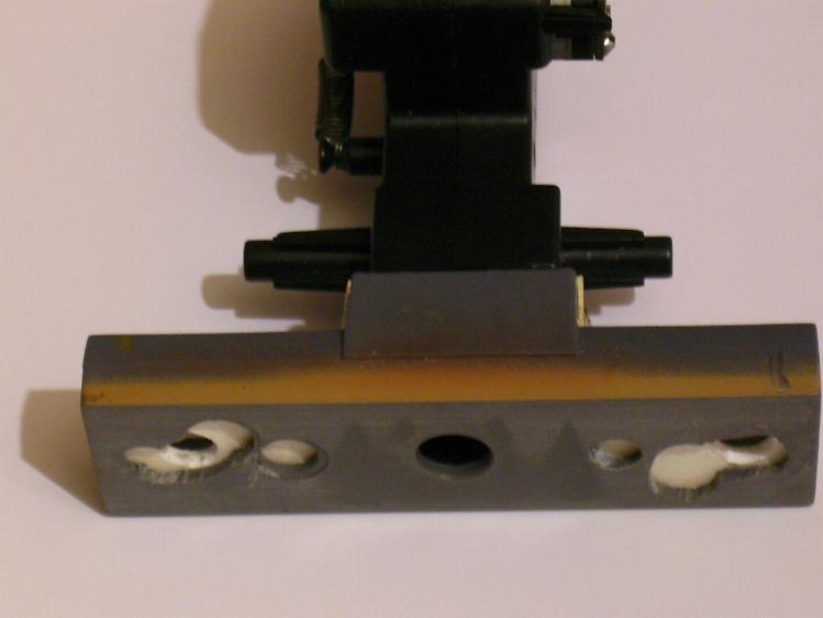

next bit, cut down this plastic heng long part and fit it too metal mantlet.
Copy of 45.JPG (31.89 KiB) Viewed 2416 times
then fit the other heng long part to recoil unit
then bolt in together
you will need to remove over hang on one side and glue it on the other side
