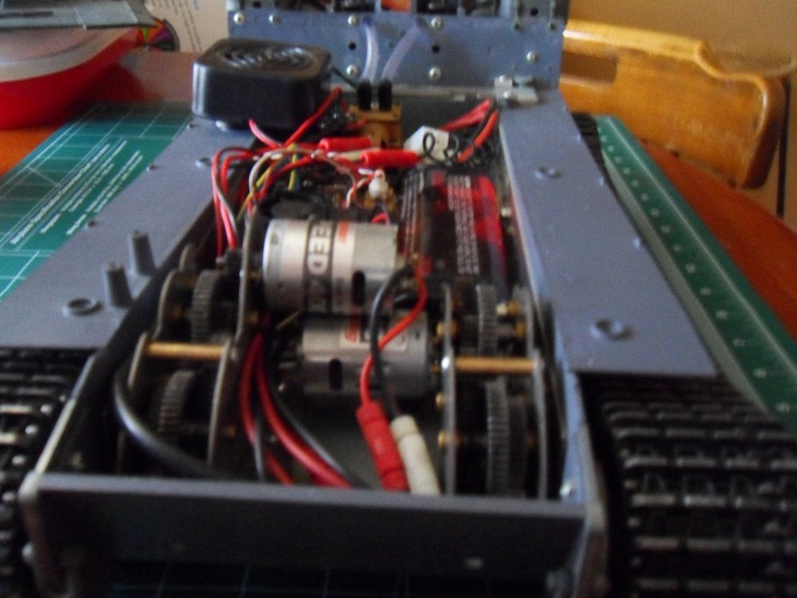

The steel Asiatam boxes, not brass are in my 20+lbs Tiger 2-13 and are still in perfect condition. I have run them in once with cam grinding compound. After that I have run my tank through every thing without a problem. You guy's should hook up with Dave(forgebear) and get a set, these are not very expensive but they really take the running with out issues.Now these are not the best,that would be the set XRAD posted.But these do last,at least in my Tiger S13 they have lasted well over a year and maybe 50 hours total run time. cheers Saxondog

The Asiatam boxes I posted look very similar to the H/l boxes with one difference the bearings.The bottom picture is from WelshDragons site, When Steve sold me the Asiatam hull these were part of the drive package. After cam grinding treatment they ran very smooth with a big reduction in noise. The torque with the Gruapner Speed 400 motors is amazing, these are good for metal tracks and sprockets and have lasted since March of 2009.
One other point, from time to time I give them a good spray with silicone spray lubricant, and my control arms are tapped 3.5mm with shoulder bolts for axles which eliminate any play in the wheels so the tracks rum tight this is the key to my Tigers good running record. All the little mods add up in the end, and the result a very strong, durable and fun Tank to drive.One other improvement,12-tooth pinion gears with grub screw for shaft position.
