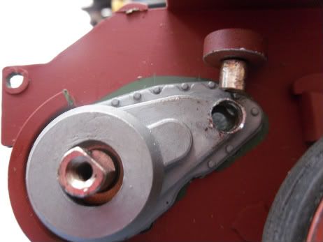

Hi, drilled out the holes to take the small wheel, then found that the small wheel was hitting thr drive cog, so cut its length down.........but still a tight fit. Needs more work, but all I can do at the mo, off to Africa for a bit with work, so tank is relegated to the garage again
Here you can see the cut down small wheel, and the support bearings are just underneath the cover....you can also notice the difference in size by the paint to the new covers..

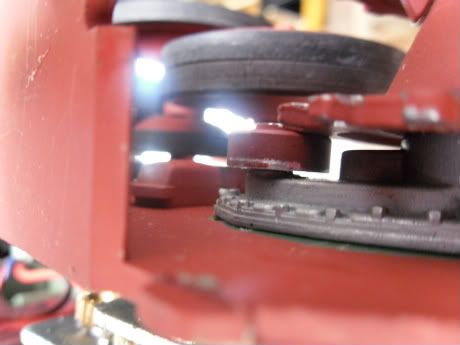

Here yoyu can see that the cut down small wheel is still fouling the drive sprocket, so will have to cut a bit more off, but its a really tight fit....A lot of effort I think for something hidden!

Hi again............just got back from Nigeria, and had a look at the tank.....you will see in the picture above that the sprocket is close to the final casing.............well, I found out why, the small spacer I had put in had fallen out(You can get these, as I did, from Welshdragon), causing the drive sprocket to be closer to the small wheel, and so I cut it to short!....aaaargh!....Took me all of two seconds to see my mistake after not working on it for two weeks...never mind...
