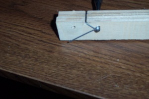

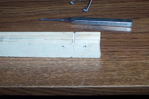

Here is how I am doing it. I made a jig out of plywood the same thickness that I wanted my upper bar of the spring to be. I cut a small slot in it to fit the size of piano wire I will be using. I then drilled two holes of about 3/32 dia. to fit my punch or section of rod threw. I then measured how much wire I would need for my spring, in my case it is 6 inches long. I found the center of the wire and placed it in the center of the slot in the jig. I wound the wire around my punch by hand, keeping the coils next to each other and I started from the bottom so that the tails would be on the top of my wheel bracket when the spring is installed.

Jig and punch with completed spring.

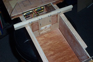

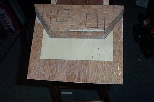

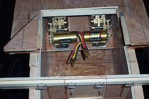

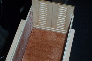

Here are some pictures of my progress on my LVT 4. I have been working on the cargo bay area details and mounting my gearboxes.

Fantastic Job Herman, a real quality build you have going on there. Mines lagging a bit due to a busy work schedule but a couple of days of this week should see a bit more done. You know your going to have to get a Jeep to ride in the troop compartment and deploy out when she hits the beach :-)
