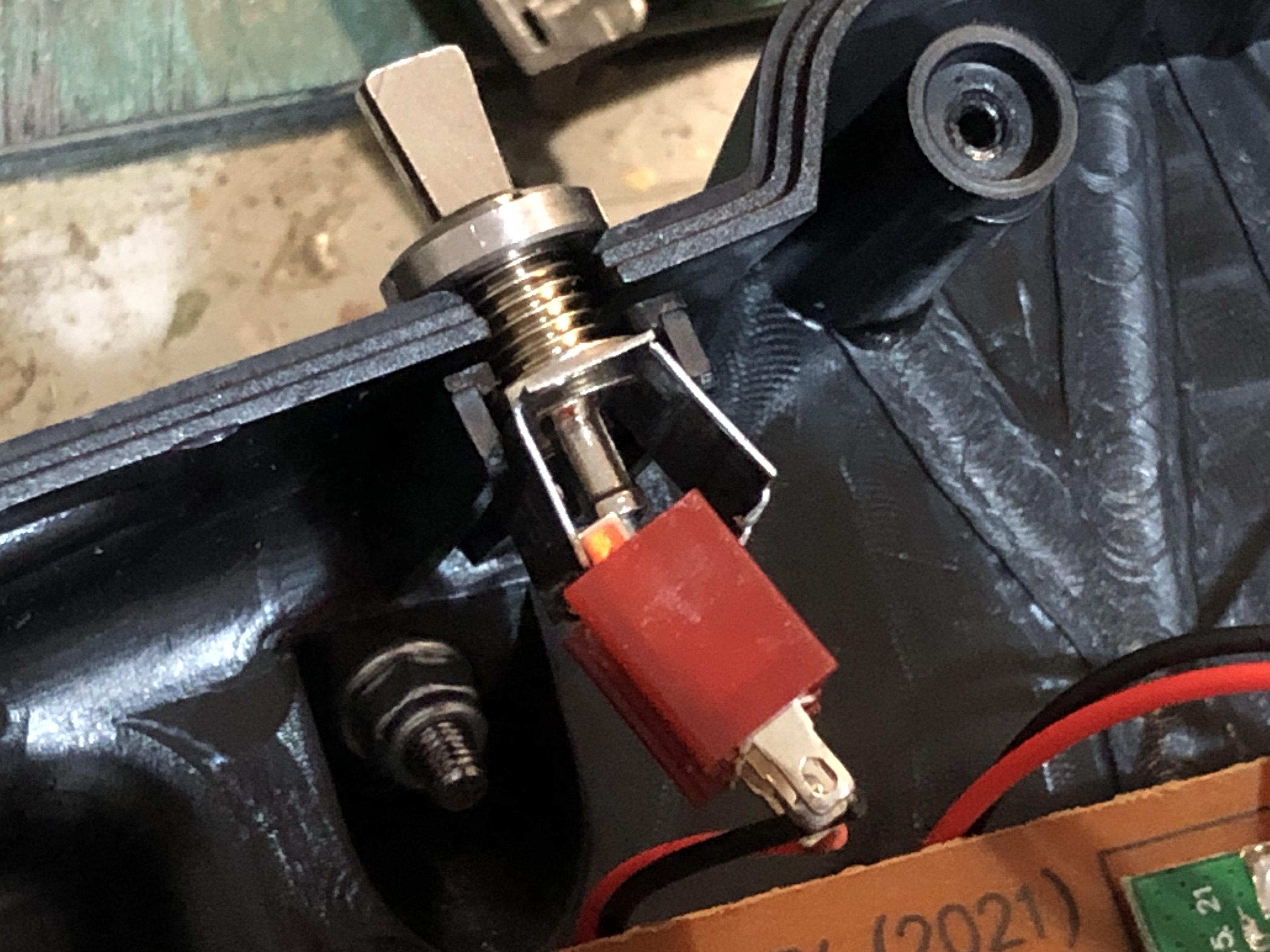

Ok folks, I have this alleged cursed tank in hand................
Out of the box :
- Transmitter start toggle has been punched into the body of the Tx with force so I cant even start the thing. Switch is munted. Unsure if it was during shipping or not.
- Smells "burnt"...........not sure of the source, but it could be the smoke unit.
- Confirmed its a BB firing, V3 Torro/Taigen and does NOT have barrel smoke as is the norm. Has the small sound module and was assembled in 2021.
- Tracks seem very overly slack. Will try adjustment first before anything else.
- The jack has broken the mounts off the lower rear hull , but we will see what can be done about that last of all.
Now, to try find a fix to get the thing started

- Lieutenant-General
- Posts: 12059
Re: Torro tank being weird
Oh, and I stabbed meself with a screwdriver trying to get the Tx sorted
Blood was drawn & air was blue..............
- Posts: 12059
I reassembled the switch. No go.
I bound the KT To my JS 2 Taigen transmitter & got the big Hua to fire up .
Sat up on a block, tightened the tracks, turned the volume off and ran it.
Slight ticking from the left motor but it’s still new and Taigen steel gears are rough & noisey .
The tighter tracks and grease on the gears made a big difference.
The exhaust smoker worked, but smelled burnt, then stopped working.
I will top it up and try again.
