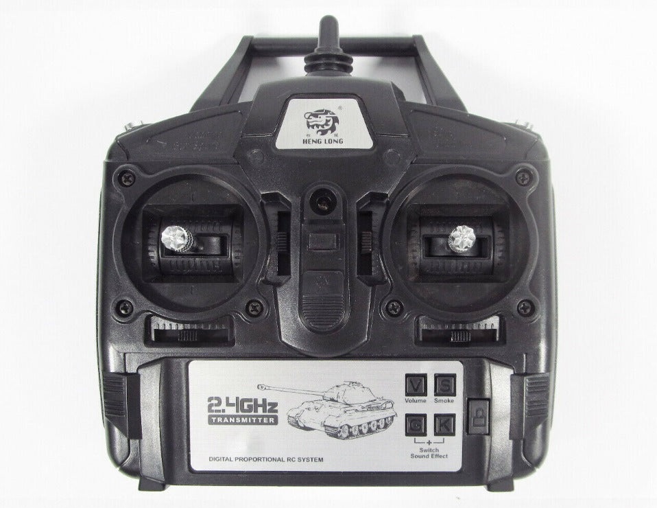

How old is your pantiger? Is it the old 27mhz system (uses a crystal numbered 1 to 4 on the tank and matching one on the transmitter) or is it a newer 2.4g system, transmitter has 4 small buttons on the lower right front, like this:

ColemanCollector wrote: Sat Feb 22, 2025 10:04 pm How old is your pantiger? Is it the old 27mhz system (uses a crystal numbered 1 to 4 on the tank and matching one on the transmitter) or is it a newer 2.4g system, transmitter has 4 small buttons on the lower right front, like this:

its the newer model

AEDM wrote: Sun Feb 23, 2025 9:48 am
As for an upper body and turret, check out Toucan hobby or one of the many other aliexpress vendors that sell hl parts.
Mike.
its the newer model
If you had the old 27mhz innards then yes, junk it. But you don't, you've got the good stuff! Jofaur gave you some good links for the upper hull, turret, and rear end parts. Looks like the rctanks.de shop has complete uppers for €59ish, and Forgebear has the rearend for €12ish.
