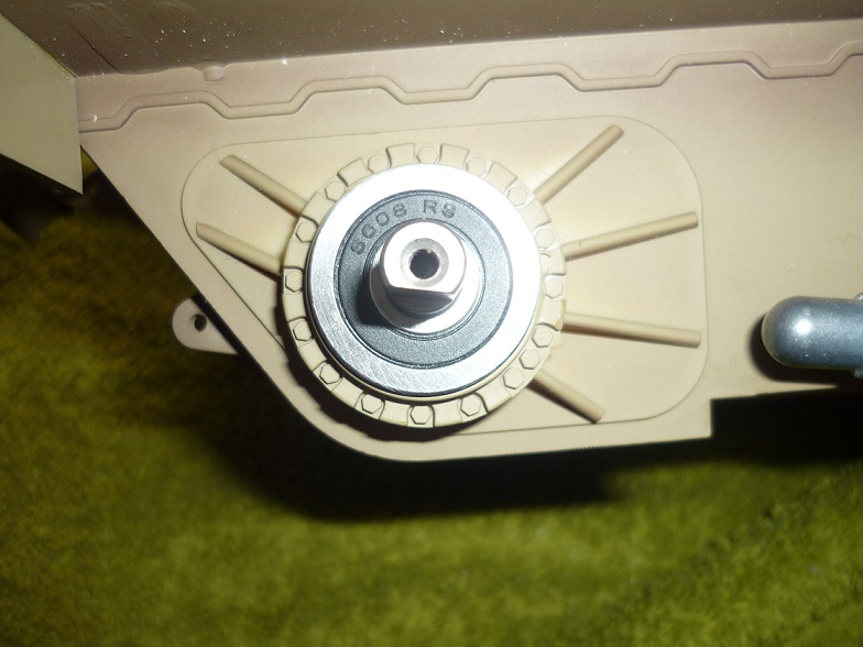

Hi, Look on Ebay uk, seller is ramparama, F608 2RS Stainless steel flanged miniature bearing 8mmx22mmx7mm, are the ones I fitted
priced at £4.99 each.
Regards John

This is the one that i fitted

Ludwig von wigbearer wrote: Wed Jan 01, 2025 10:41 am Hi, Look on Ebay uk, seller is ramparama, F608 2RS Stainless steel flanged miniature bearing 8mmx22mmx7mm, are the ones I fitted
Regards John
I have just found the bearings on eBay John and taken a look at them - that is another option for me to ponder over.
Did you just push the bearing in from the outside after removing the original plastic bearing?
I am looking for an easy (but secure) fix - preferably one that does not need any machining .
Bob.

Its a dead easy fit, it replaces the whole bearing plate/axle cover, much stronger than pushing a bearing into the original plate. :thumbup: :thumbup:

Hi, It pushed in from the outside without glue, I cant remember if it pushed straight in or if I had to remove any of the plastic to fit them. :thumbup:

Ludwig von wigbearer wrote: Wed Jan 01, 2025 11:25 am Hi, It pushed in from the outside without glue, I cant remember if it pushed straight in or if I had to remove any of the plastic to fit them. :thumbup:
As a typical "bloke", tradition dictates - that I really should take a look in the Heng Long handbook that came with the tank (better late than never?) and at the back it shows the "official' bearing replacement kit that has a turned flange that is pushed in from the outside - just like your flanged bearing idea!

Your Challenger might be an older one than mine. The bearing should just push in from the inside looking at your picture. Mine just pushed in from the outside as it has the bearing support in place. I have a pair of aluminium supports if you want them? I am not sure how they fit, as they were not required for mine. There are some pictures of my hull brace in my build thread. Page 5. It is simply made from 25mm x 25mm x 3mm aluminium angle, from B&Q. Pavel, I believe used a flange bearing from the inside and secured it with epoxy? He also seals them from the outside to prevent ingress of dirt. Something I have found unnecessary as my bearings have seals. I have now fitted these output shaft bearings to all my modern tanks.
viewtopic.php?t=32250
