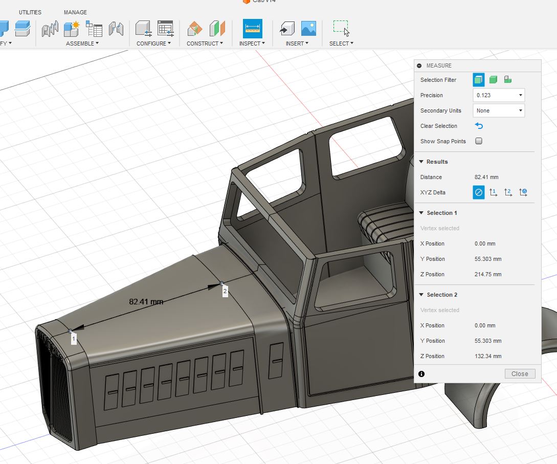

Ecam wrote: Fri Sep 27, 2024 12:50 am " measure the imported mesh"
Simply select the inspect tool, and click 2 points on the model that you wish to measure between:
Import 7.jpg (122.2 KiB) Viewed 850 times

Tiger6 wrote: Fri Sep 27, 2024 12:56 am
I think I may have been already doing that?
Screenshot 2024-09-29 at 8.12.33 AM.png (2.89 MiB) Viewed 794 times
