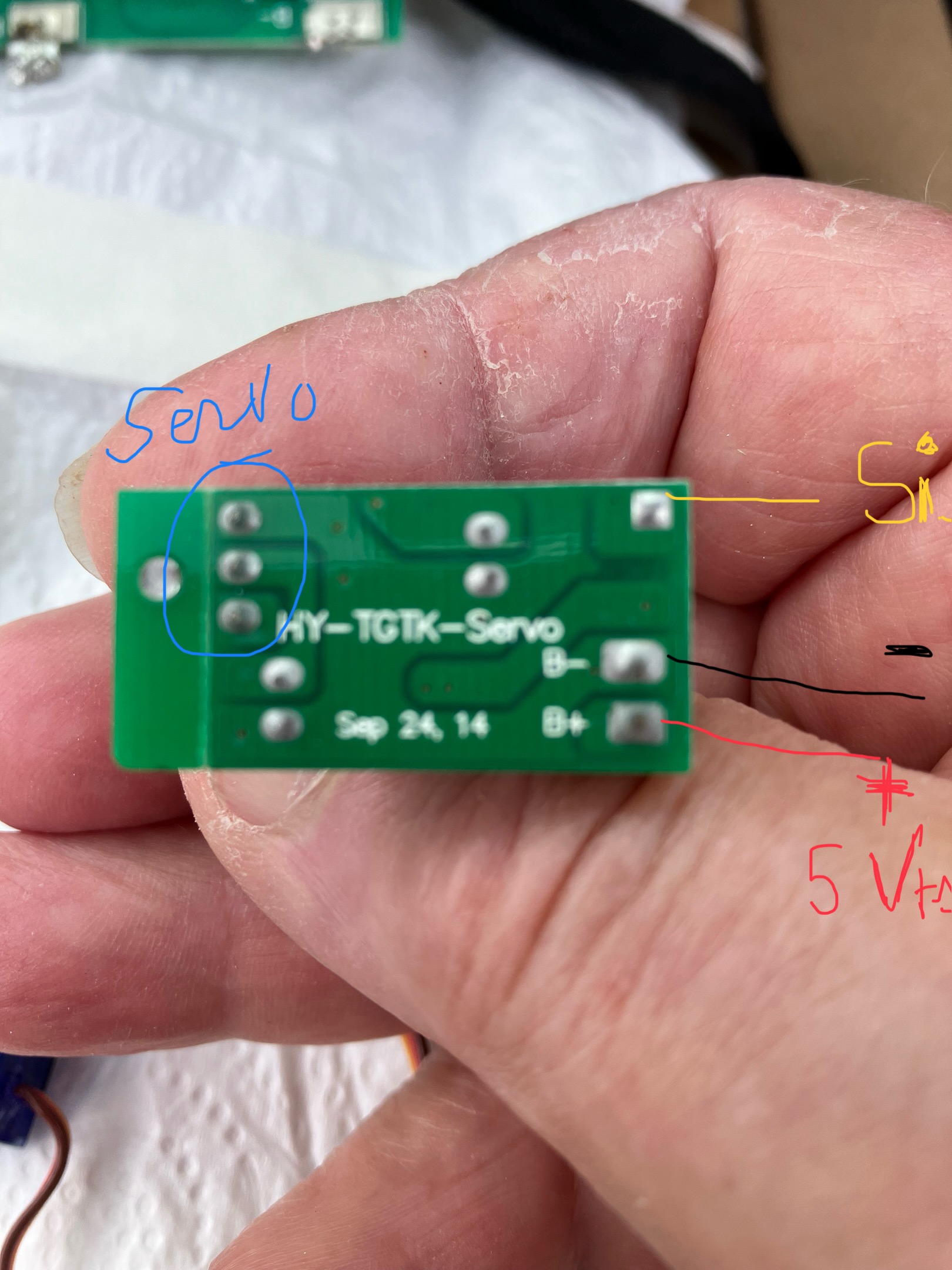

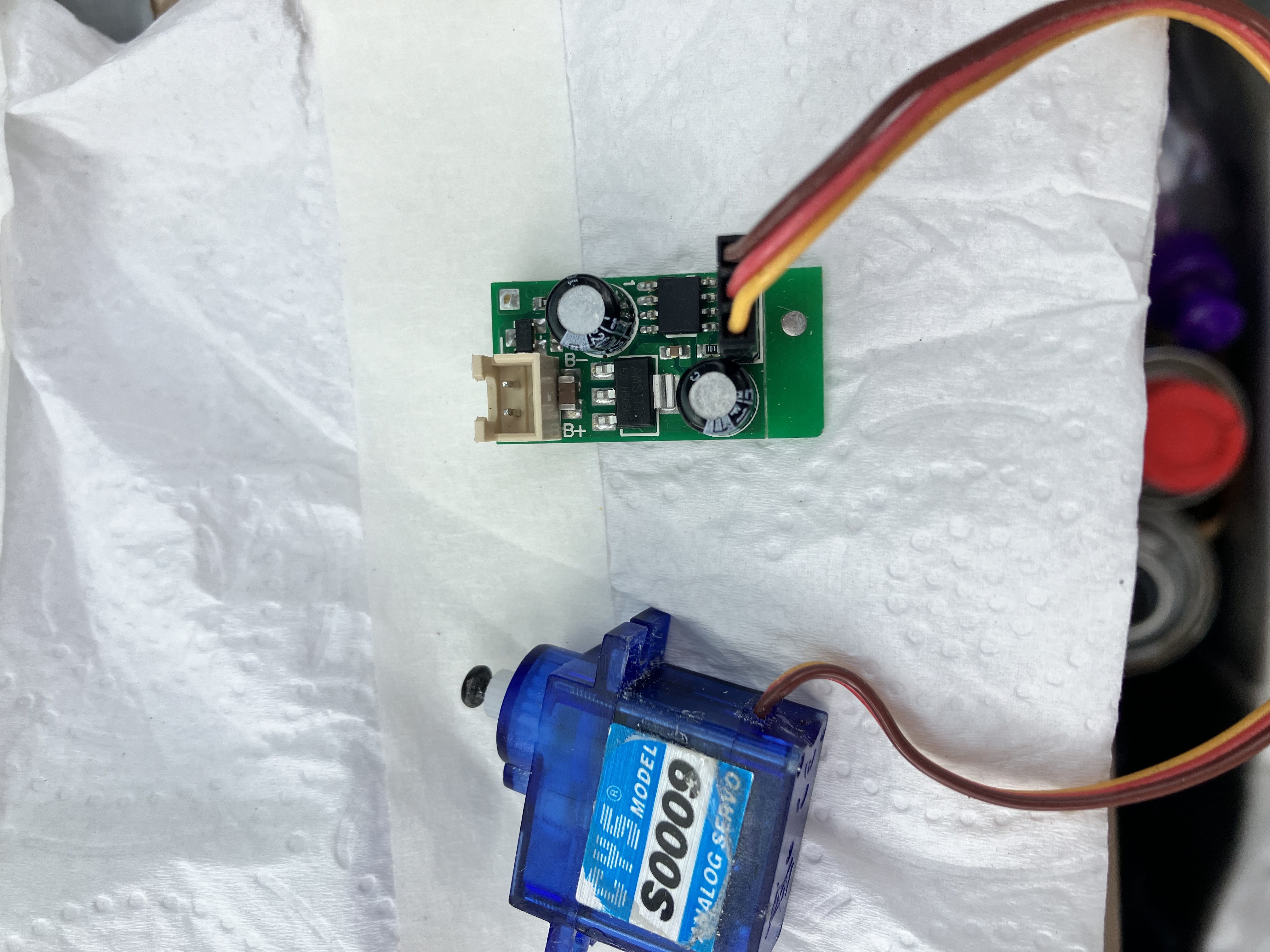

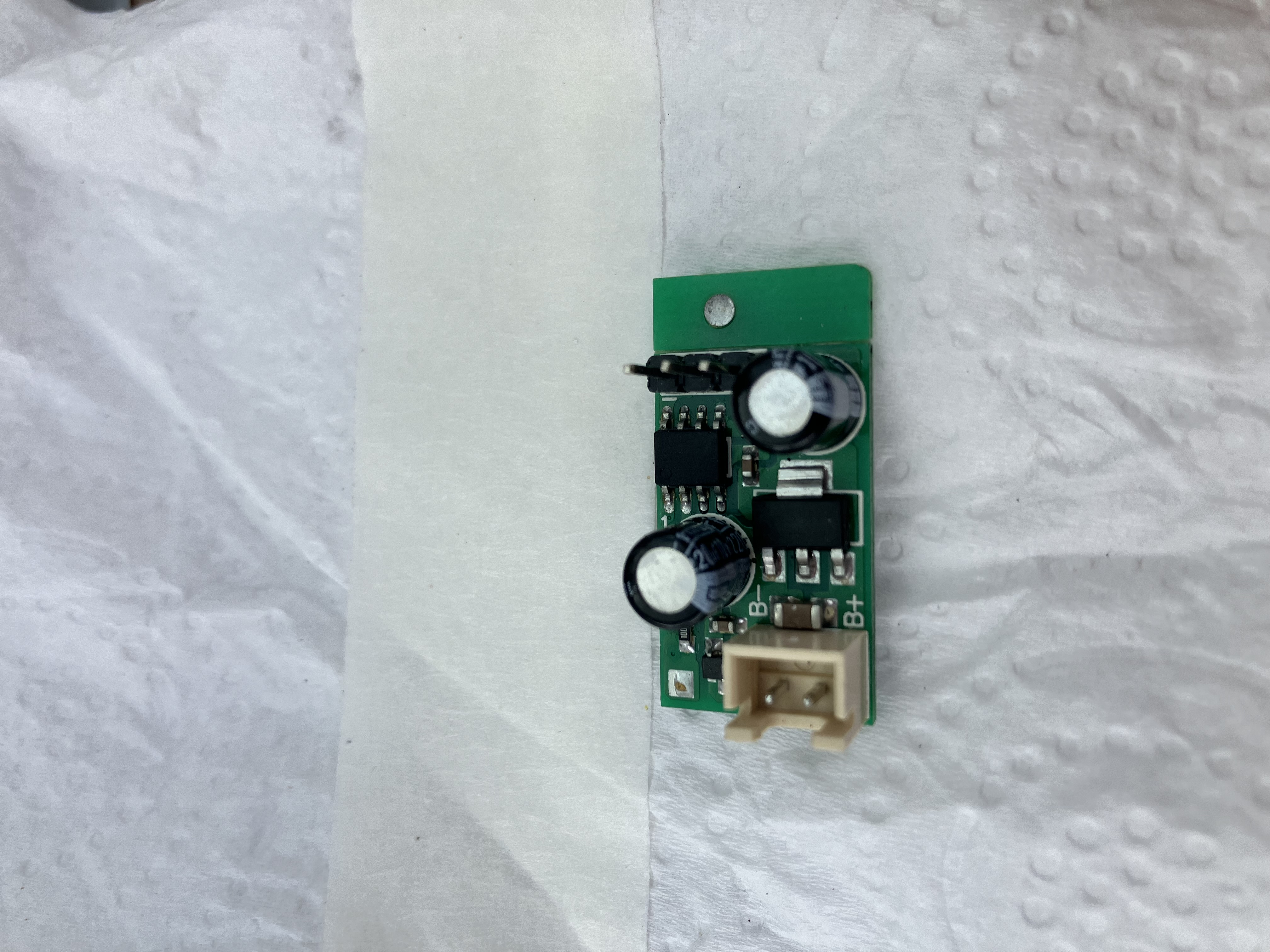

Hello, is there a solution to install a servo? At one time HL had a small module, powered with 5 volts input, and an output for servo, all functioning by applying + 5 volts to another input? personally used on a Tamiya tank, but will always remain the percentage of lateral movement, simple to adjust with a radio, programmable, but in your case? I still don't see how you are going to achieve this with a motor? but as "Her Professor" maybe there is a solution? I will follow this carefully, being curious by nature

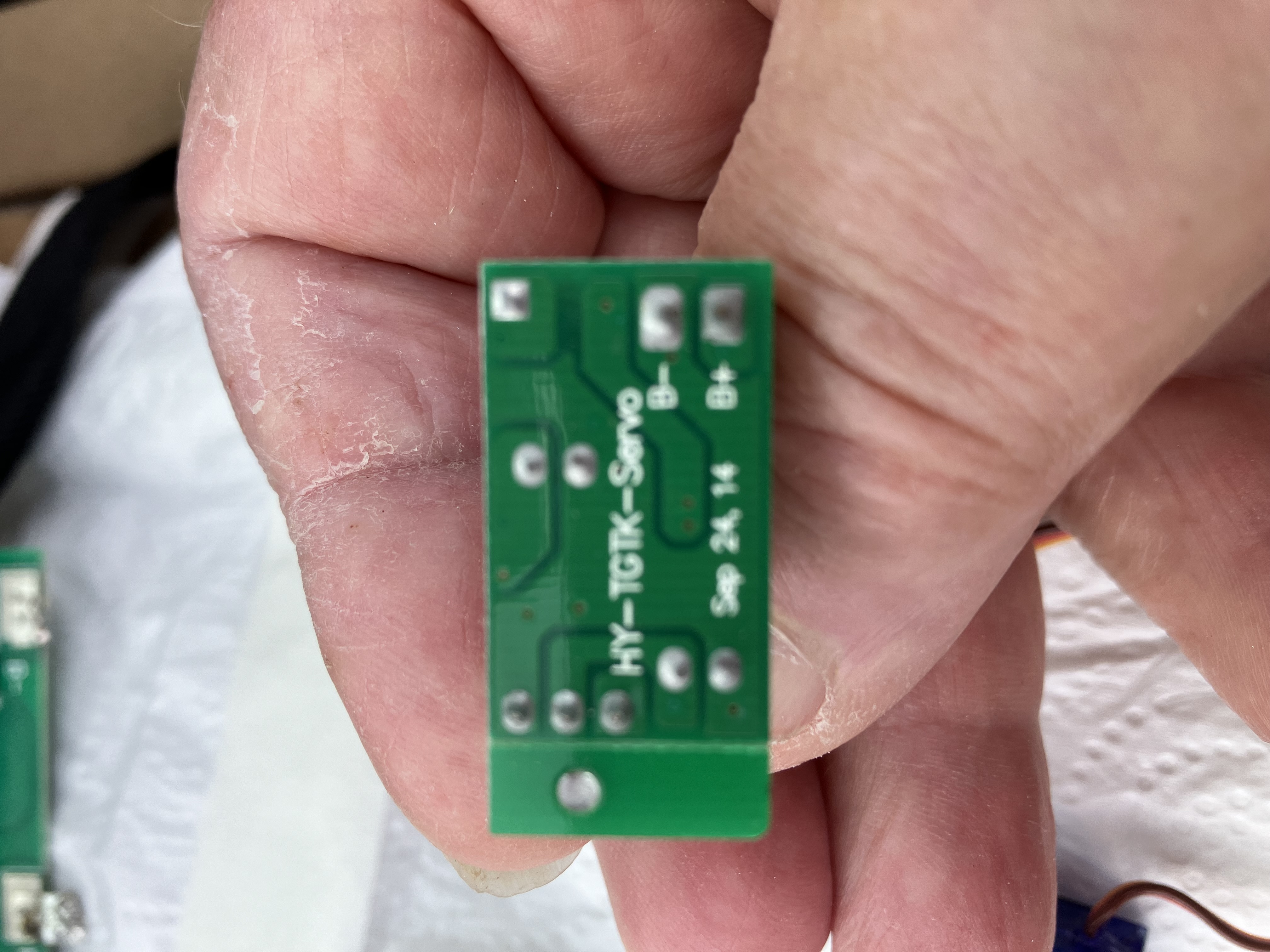

:'( Here is what I was talking about, servo adaptation plate, cannon recoil, used certain HL tanks firing balls
connection, just send a pulse + 5 volts to the S (Switch, or other buttons)
