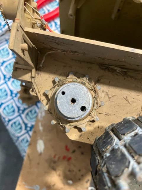

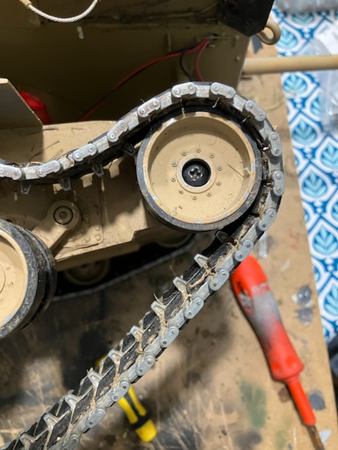

Instructions. Now with photos. Mine has metal tracks and wheels. The principal will be the same whatever version you have.
1) Turn tank on side and remove the 8 screws from underneath, to release the top.
2) Take out the cap from the rear drive sprocket. And remove the screw.
3) The sprocket should come off, or be able to split in half.
4) Remove the screw from the centre of the idler, and remove along with the track.
5) This gives access to the adjuster.
6) After you have made your adjustments, refit the idler, place the track over the idler, and drape it loosely over road wheels, and return rollers.
7) Fit the drive sprocket in place and pull the track over it. It should be tight, and it will be difficult. Just use a bit of brute force.
8) Lastly fit the other half of the sprocket and fix in place.
