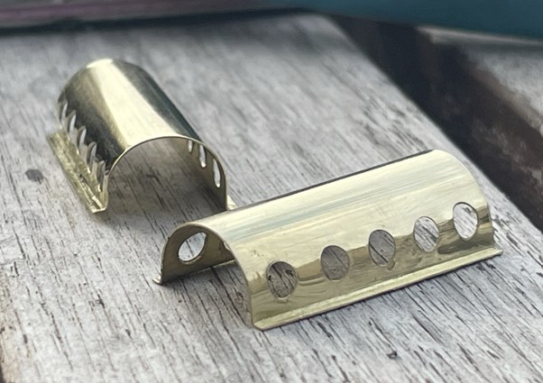

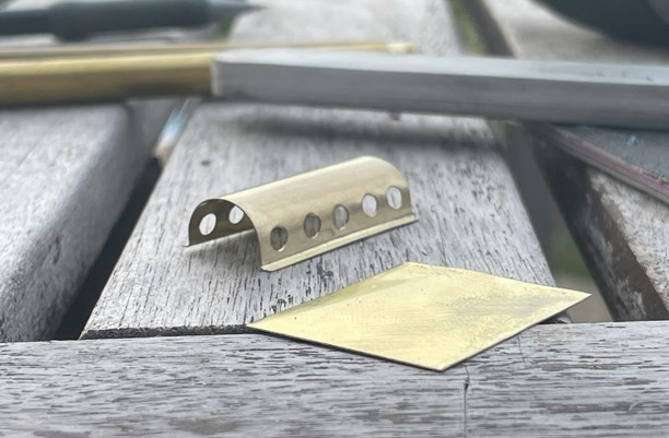

The heat shield is cut from a .25mm brass sheet, ventilation holes are made based on approximate diameter and position, determined the best i could from pics.
1/16 RC BRDM-2 Soviet Combat Recon Patrol Vehicle - Build
It's always a challenge to make 2 exactly similar.
The embossed stiffeners are represented by 0.8mm half rods.

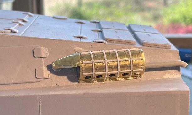

And here we have the two heat shields ready to be installed.
And then installed on the model.

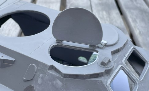

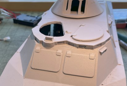

Now for the hatches. The top right side hatch is separately molded. Good, this will be for the on/off switch. As for the front visor hatches, i want to show them open.
Again, i had to browse some pics and do something similar.

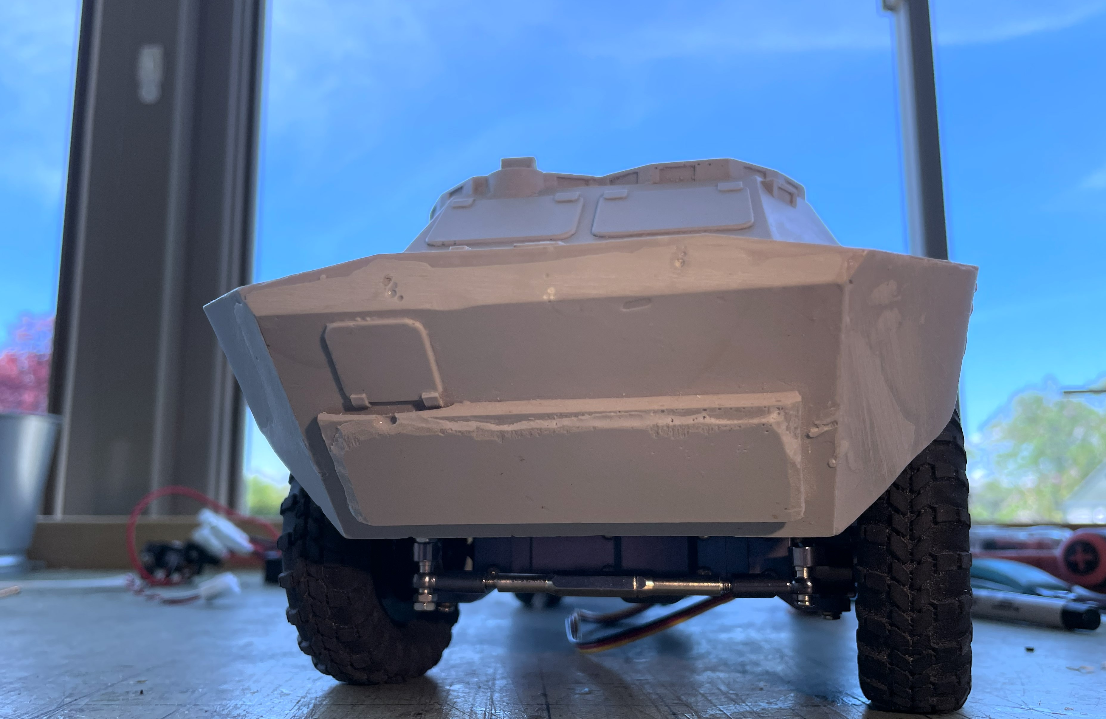

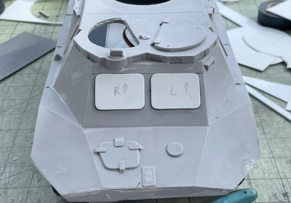

Getting rid of the front hatches, first by removing as much material with a drill before fine tuning with the knife and sanding.
Created new hatches and drew markings of the external shapes on the hull for the rain guards.
First, rough rain guards are installed on the markings, and they will be reduced in height, fine tuned, then given the external 45 degree weld lines around them.

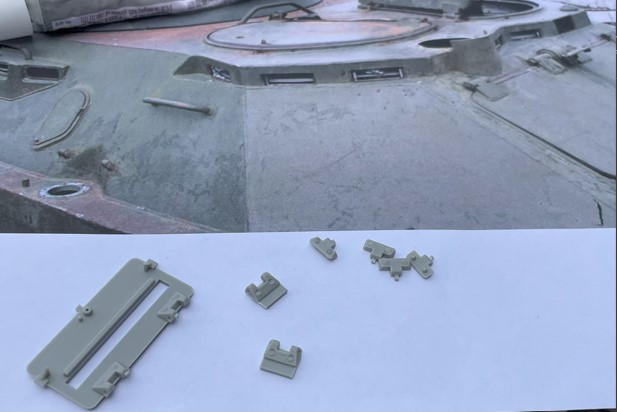

Working hinges are made from Panzer III engine hinges, leftover from the Trumpeter kit build, and highly modified to match pictures.
Raw material below
Top hatch is installed and the frontal hatches are given the weld lines, before cutting the area for the top hinges. The welding on the BRDM-2 is quite rough, i tried to represent it.

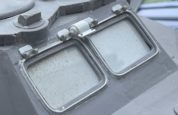

Hinges are installed, including the apparatus in the middle that seems to control the opening and closing.

Top view of the real vehicle hatches, used as reference.

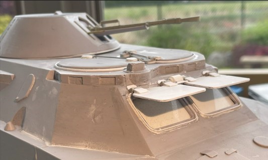

Overview of the model hatches
Rain guards were also added to the top hatches, as seen in ref pics.

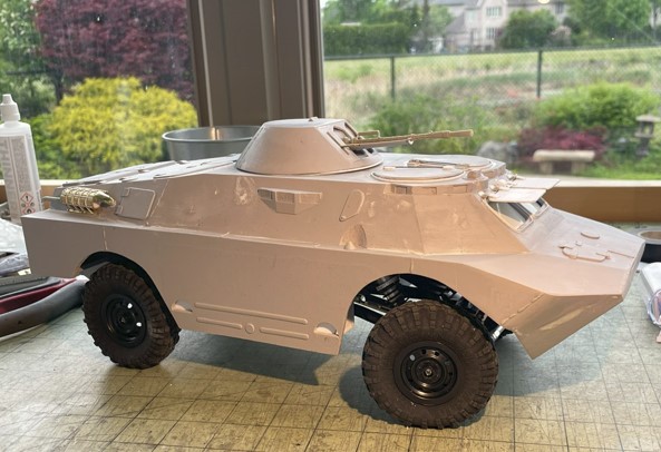

The model as it stands today
Next step, the deep wading trim vane.
Regards, Louis

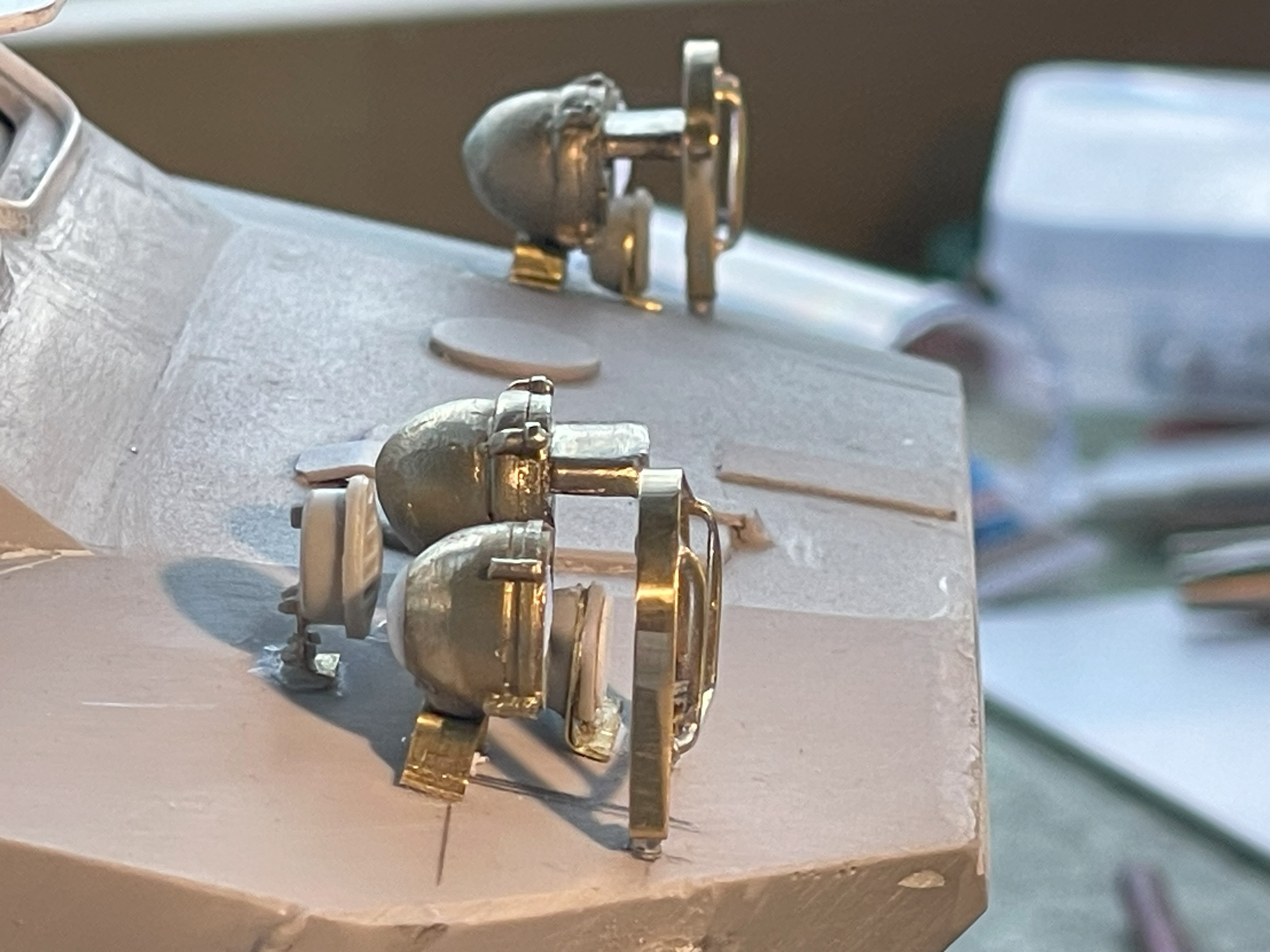

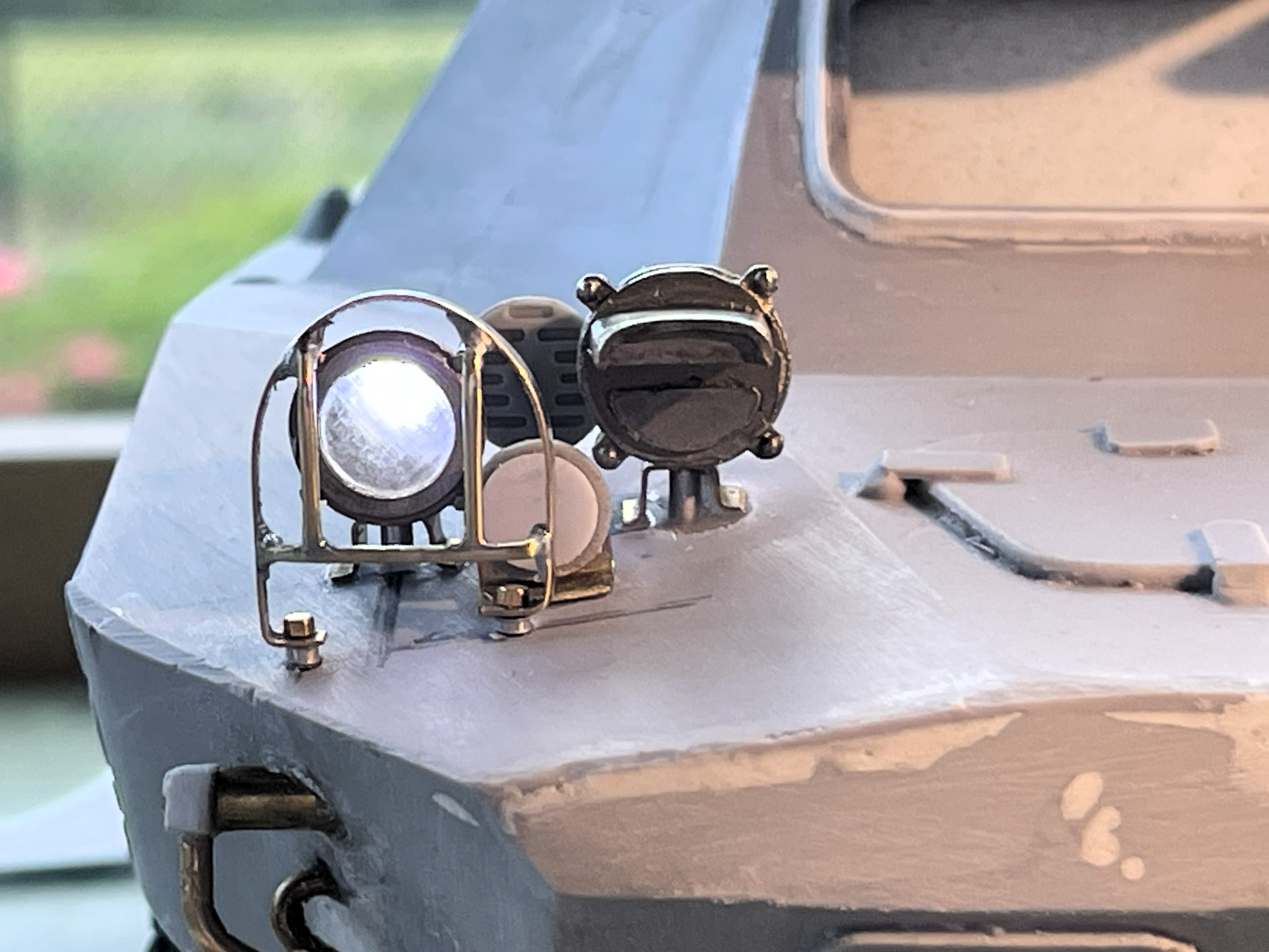

These posts are for the headlights.
Reference captured from the web, mainly Prime Portal. Complex arrangement, with headlight, low vis headlight, signal and an horn on the right side.

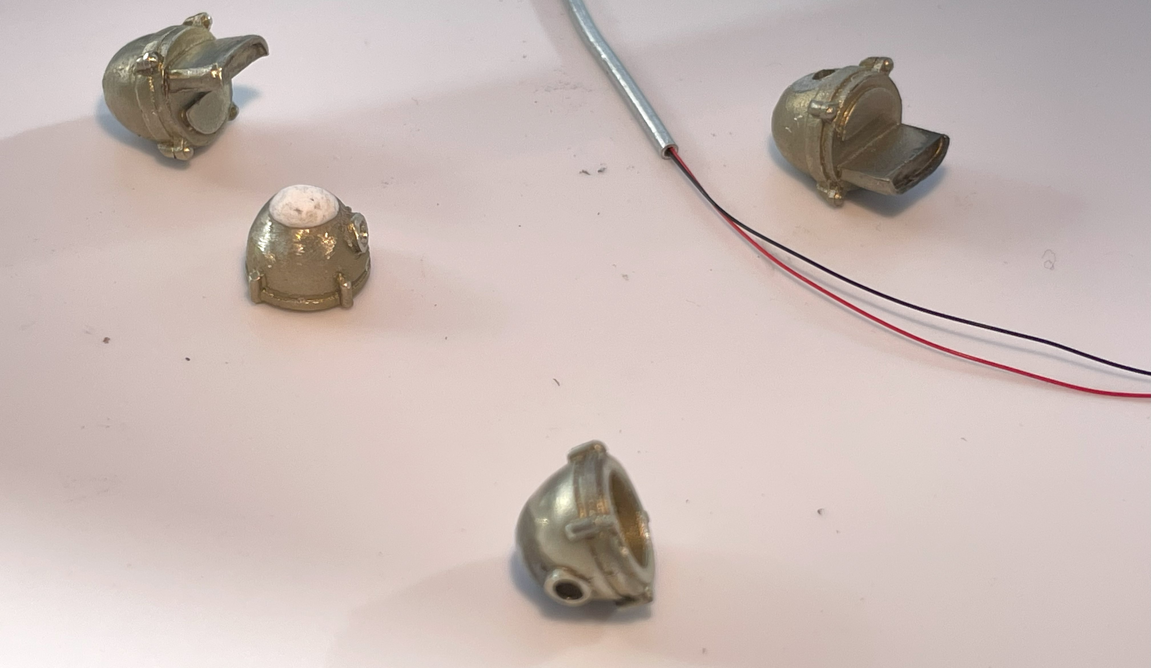

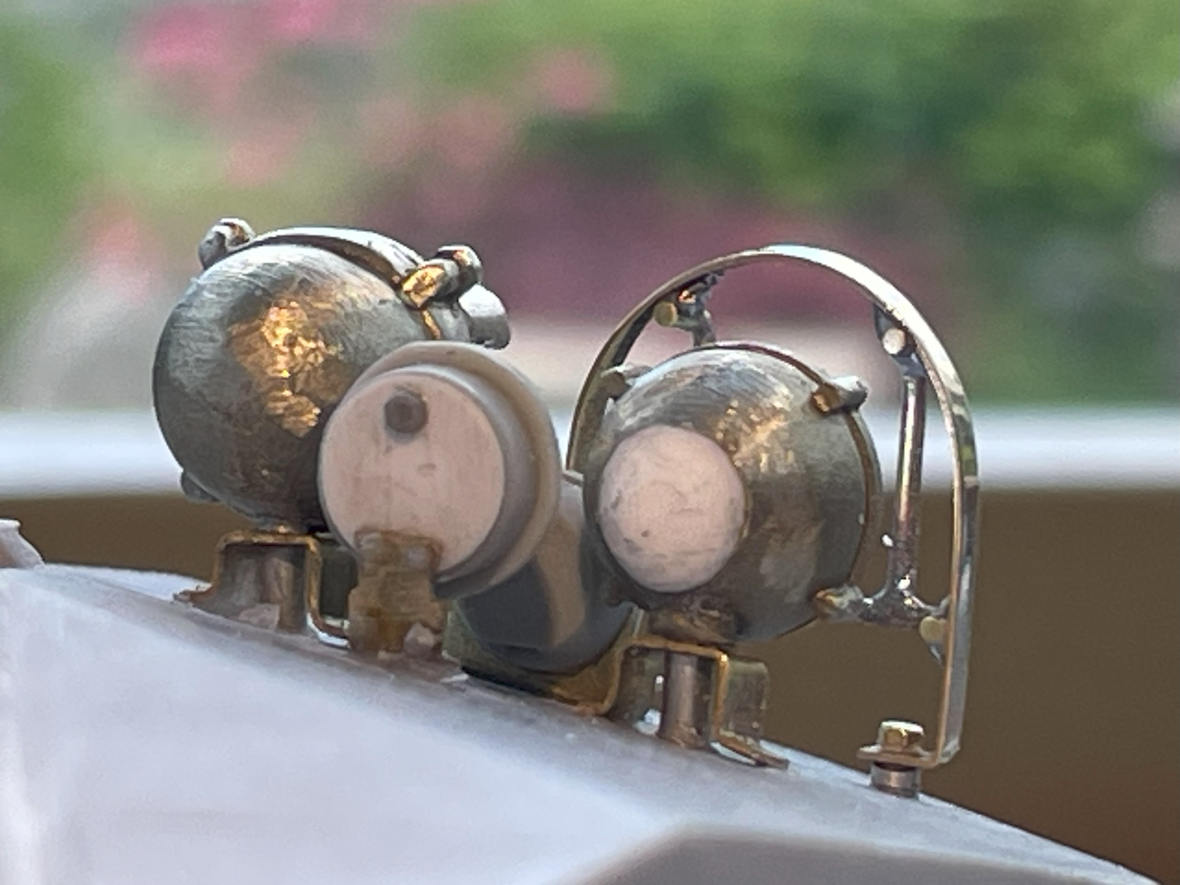

These metal parts are from the AFV-Model T-55 headlight set. They are compatible and seem like a perfect match.
They need some work to clean up and also plug the back of the headlight as is have decided to use small LEDs and run the wire through a tube that will be used as a stand, as per reference.

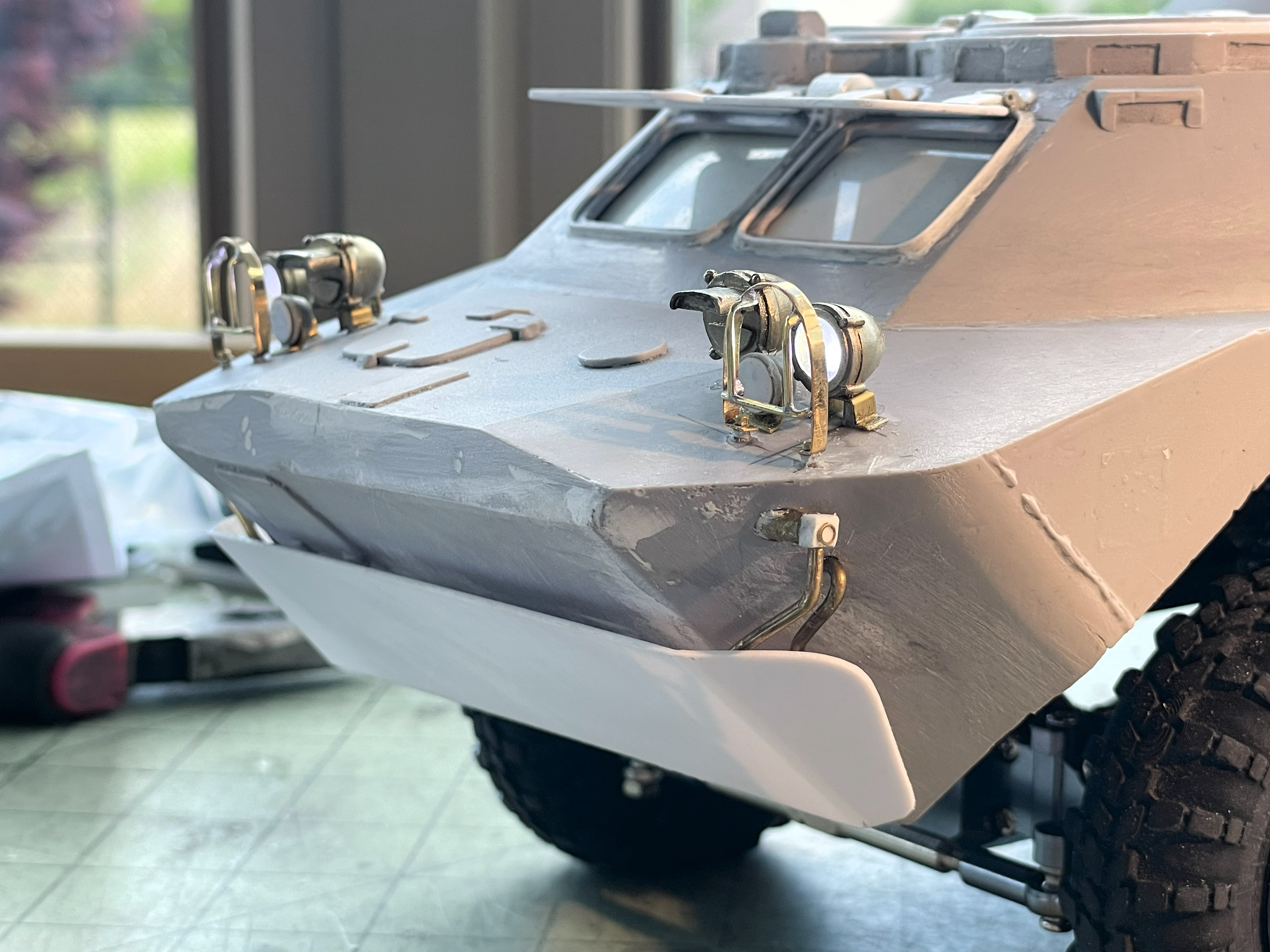

Mounted on the vehicle after much eyeballing and calculations.

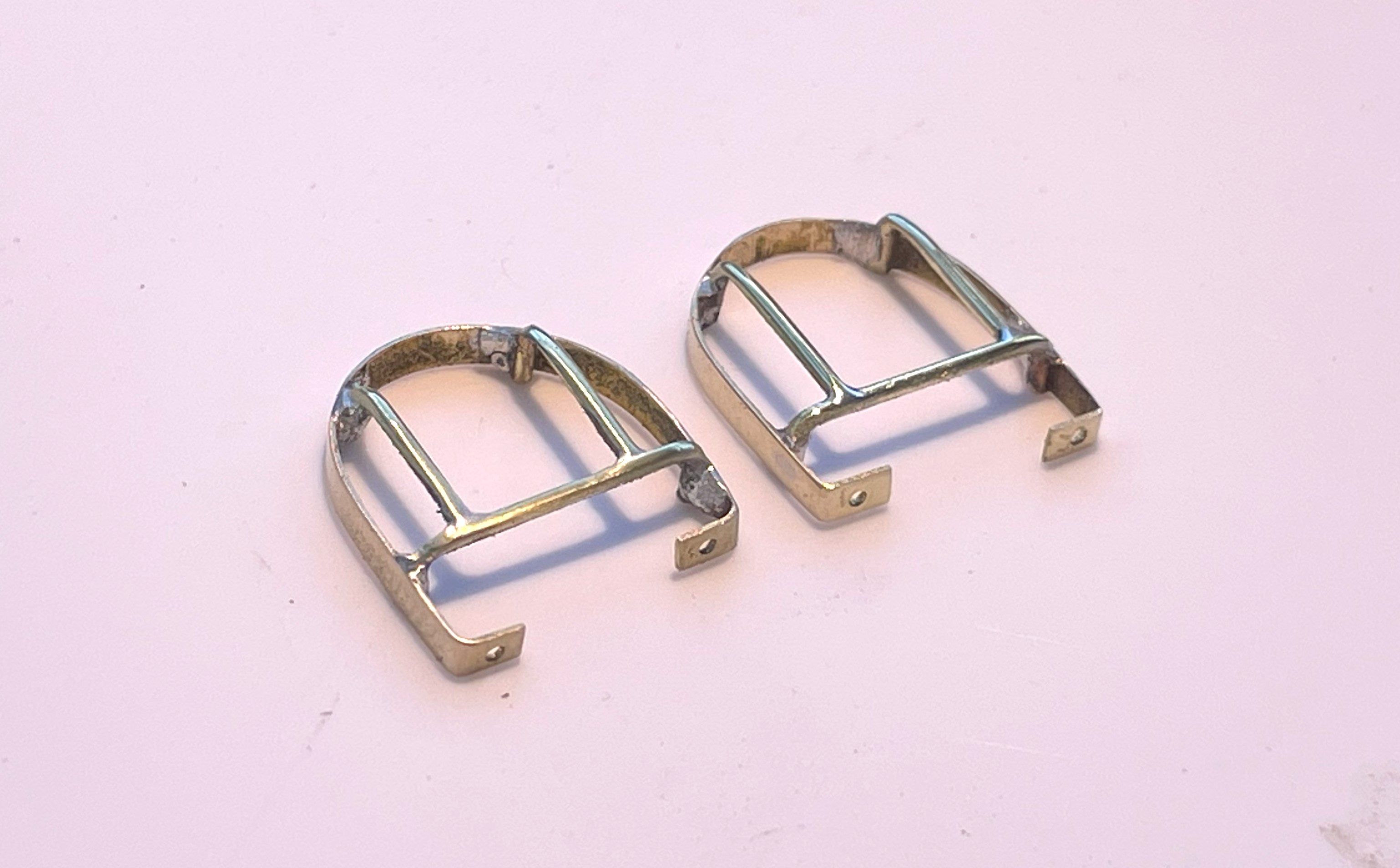

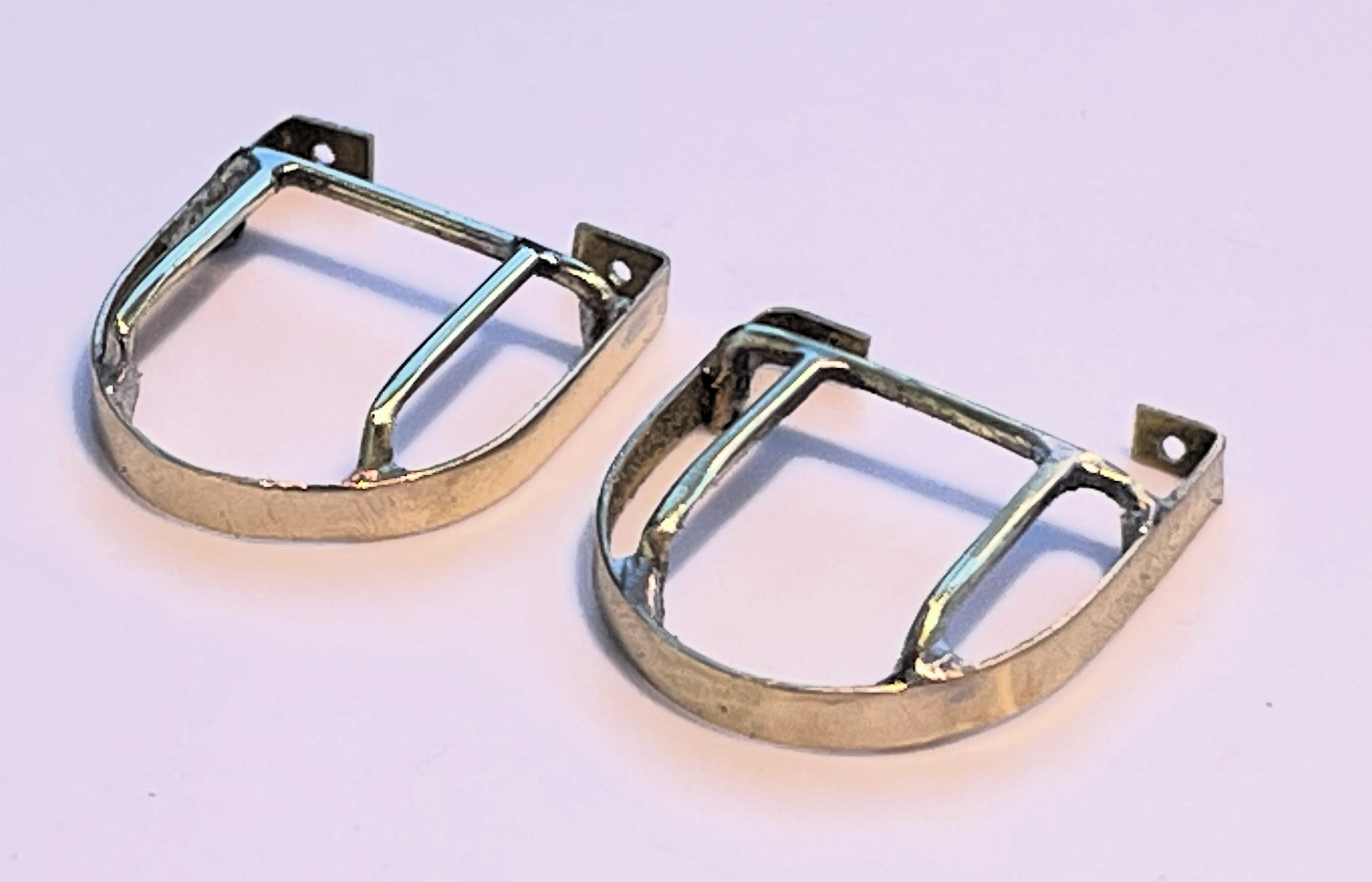

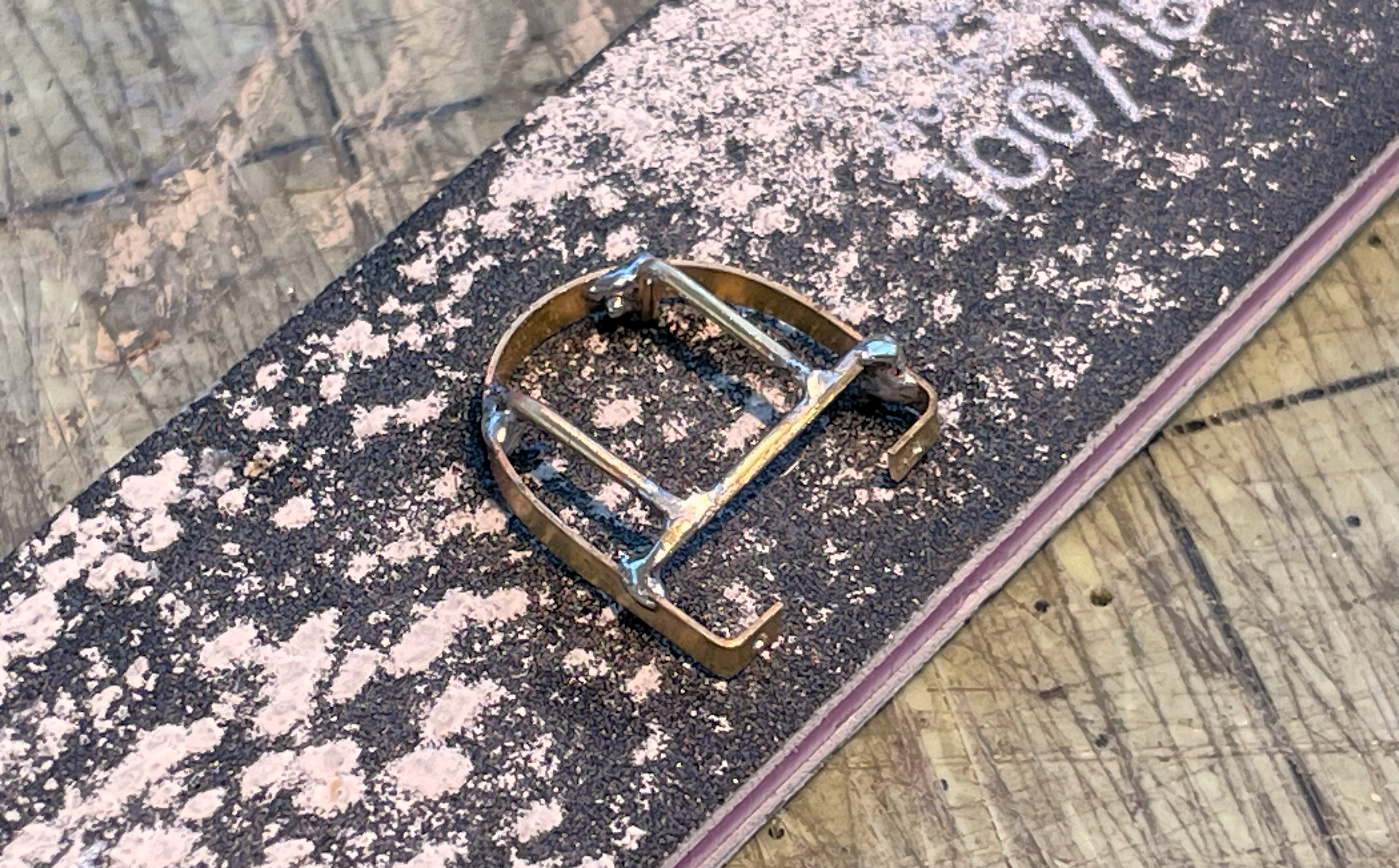

The guards are something, need soldered brass rods and strip for solidity. For the brass sodering of the brass strip with the 0.8mm rods, I had to create a jig using a nail file. I found that nail file are a good base for soldering. It can take the heat. I drilled holes in the nail file to hold on to the brass rod legs in the right position, allowing me to solder them solidly in place.
Then the brass strip component is added on top and soldered.
The guard before clean up.
After clean up with a set of files, these are the finalized headlight guards before installation on the model.

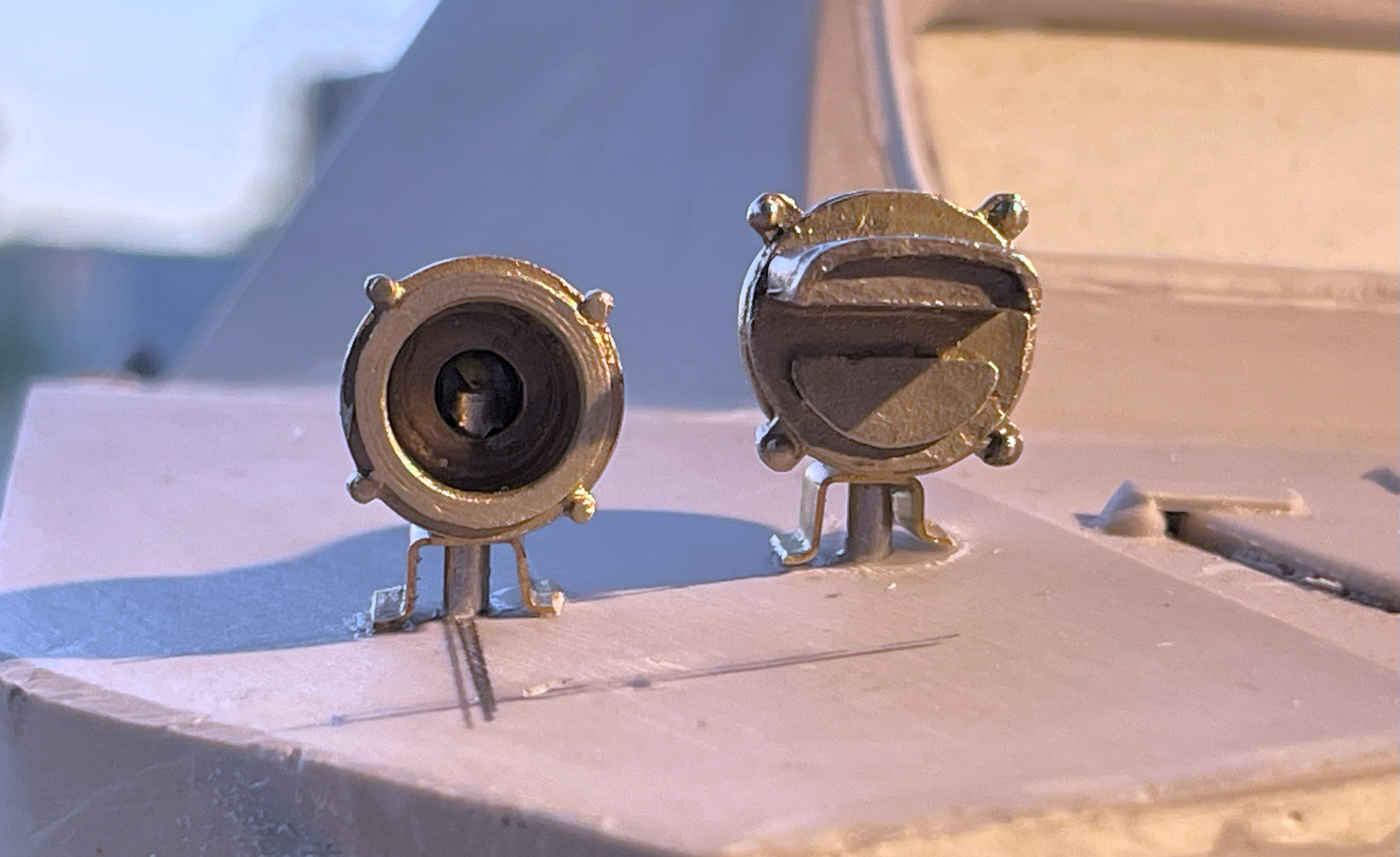

And these are the headlight arrangements, with the horn and signal.

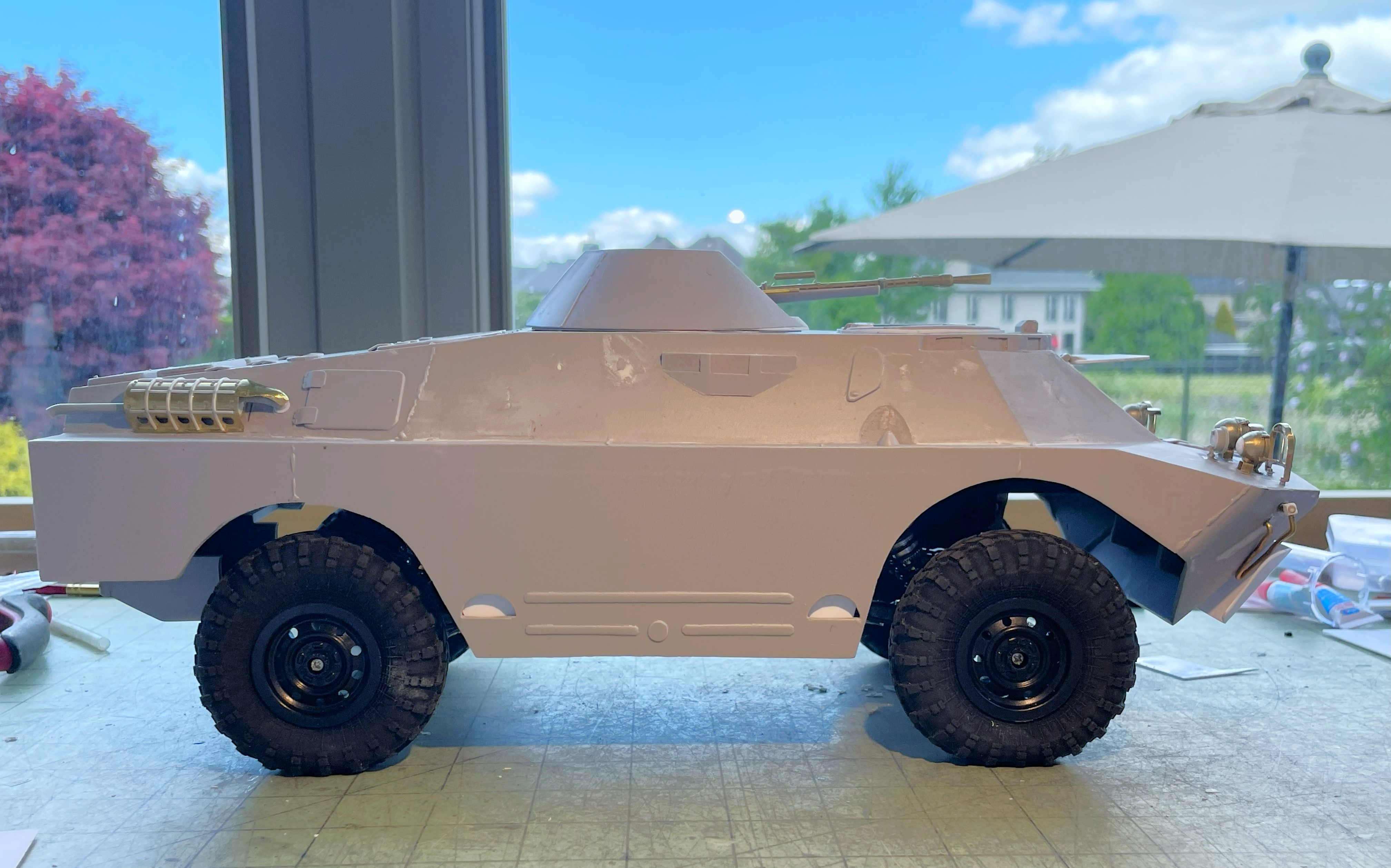

The model as it stands today.

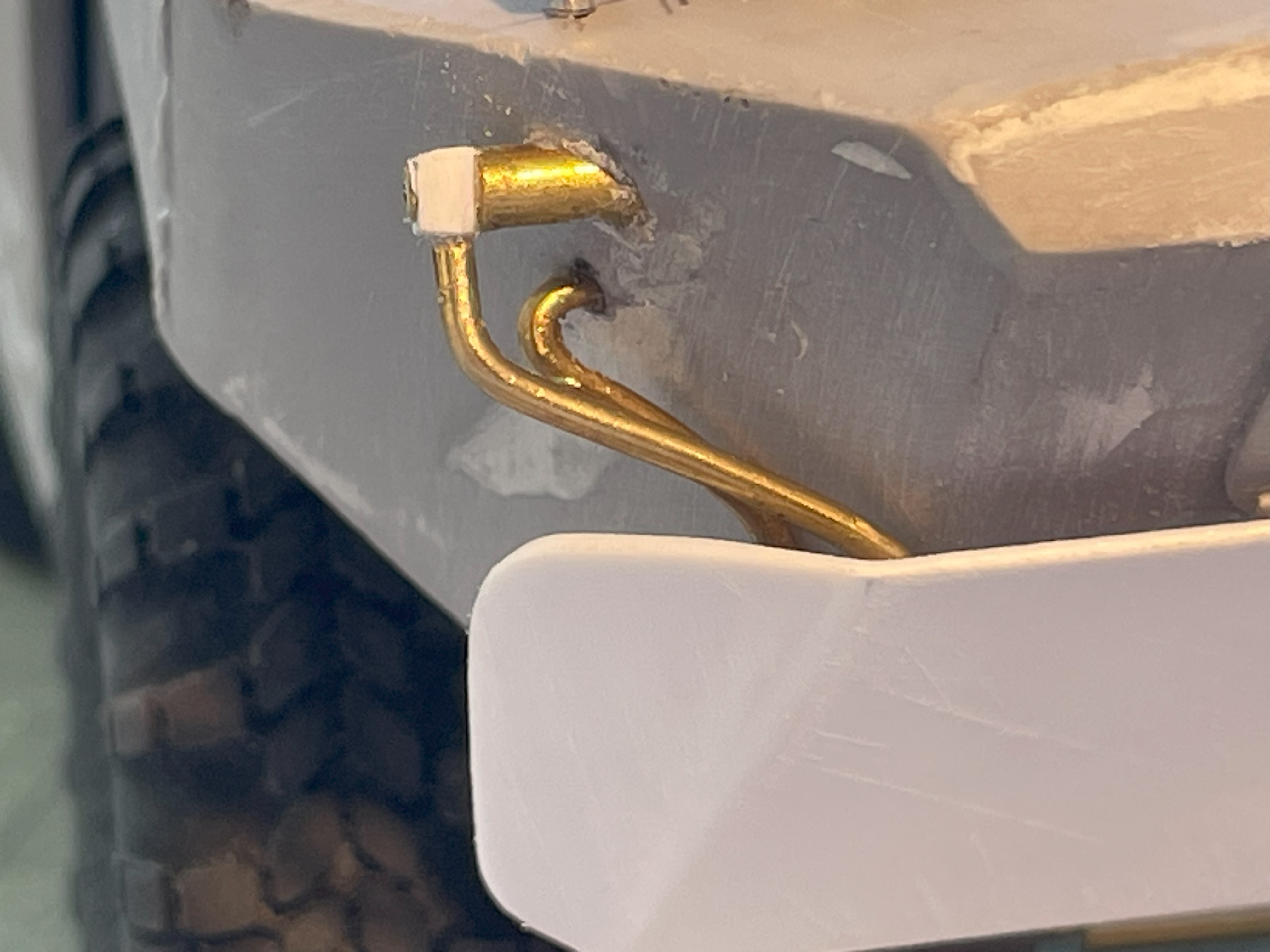

Next step, the tail lights, add all the brass handles and hooks, and fine tuning the tons of imperfections on the hull.

Your soldering skills and creating beautiful details out of nothing never cease to impress.
