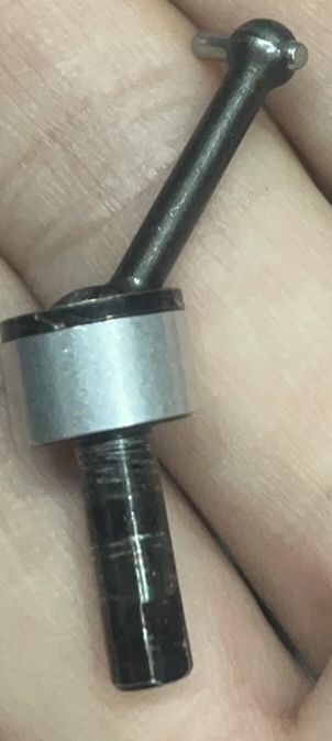

I want to know, how to fix this :) how its disassemble?

Not positive, but because of the two types of metal (steel and aluminum it appears) that silver sleeve was probably installed after the dog bone (axle) was installed. It could be pressed on glued or on but it might slide off with some effort. Many of that style that I've come across have a spring under the dog bone in the cup.
Why does it need to be removed, is it because the upper pin is loose? If so, there are ways to fix that...

I want to disassemble to make a slightly larger groove in the ball. If you rotate the bone in the extreme position, there are two positions where the bone jams. Because of this jamming, the bone rests on the counter cup and the wheel rises.
