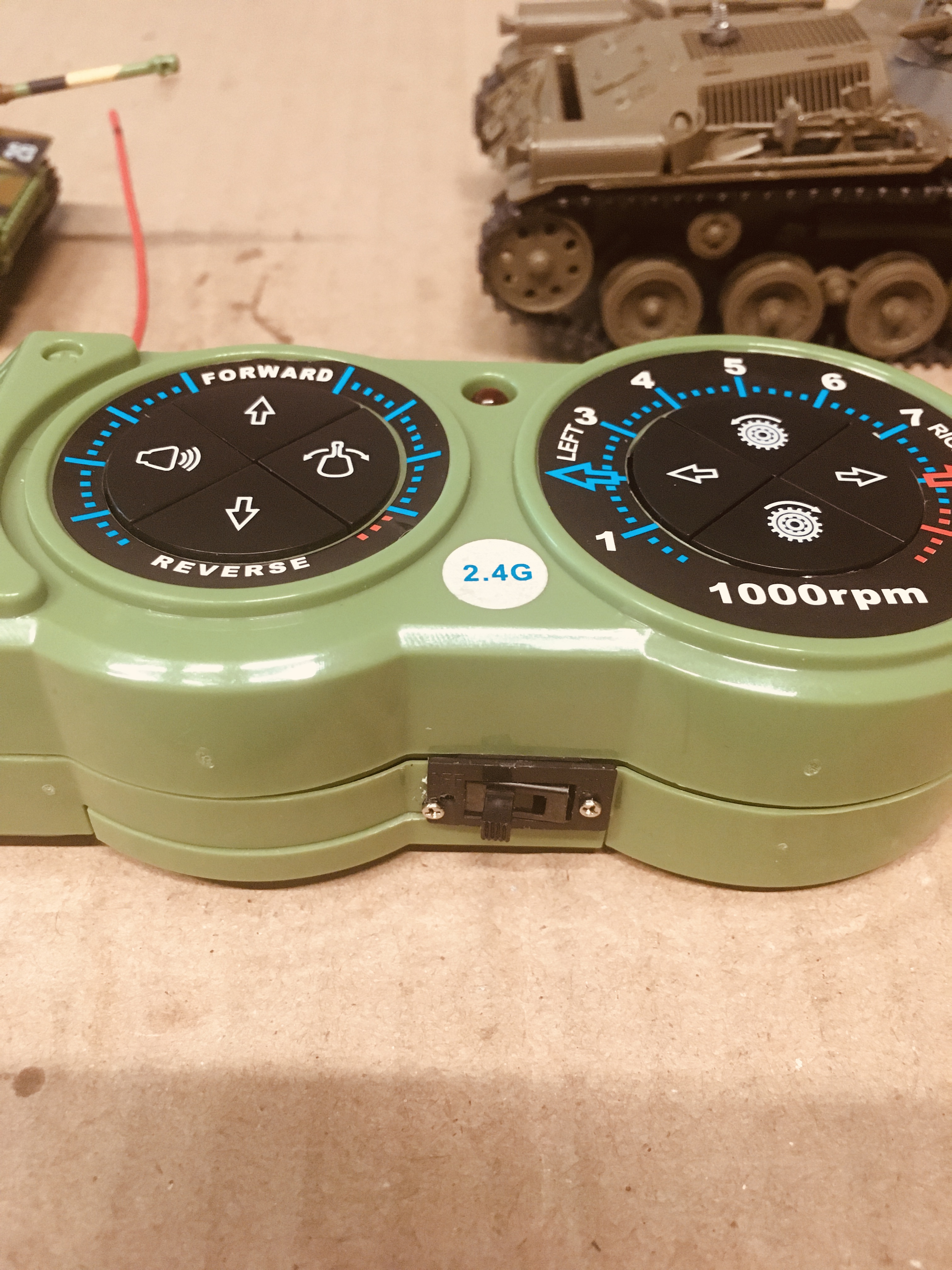

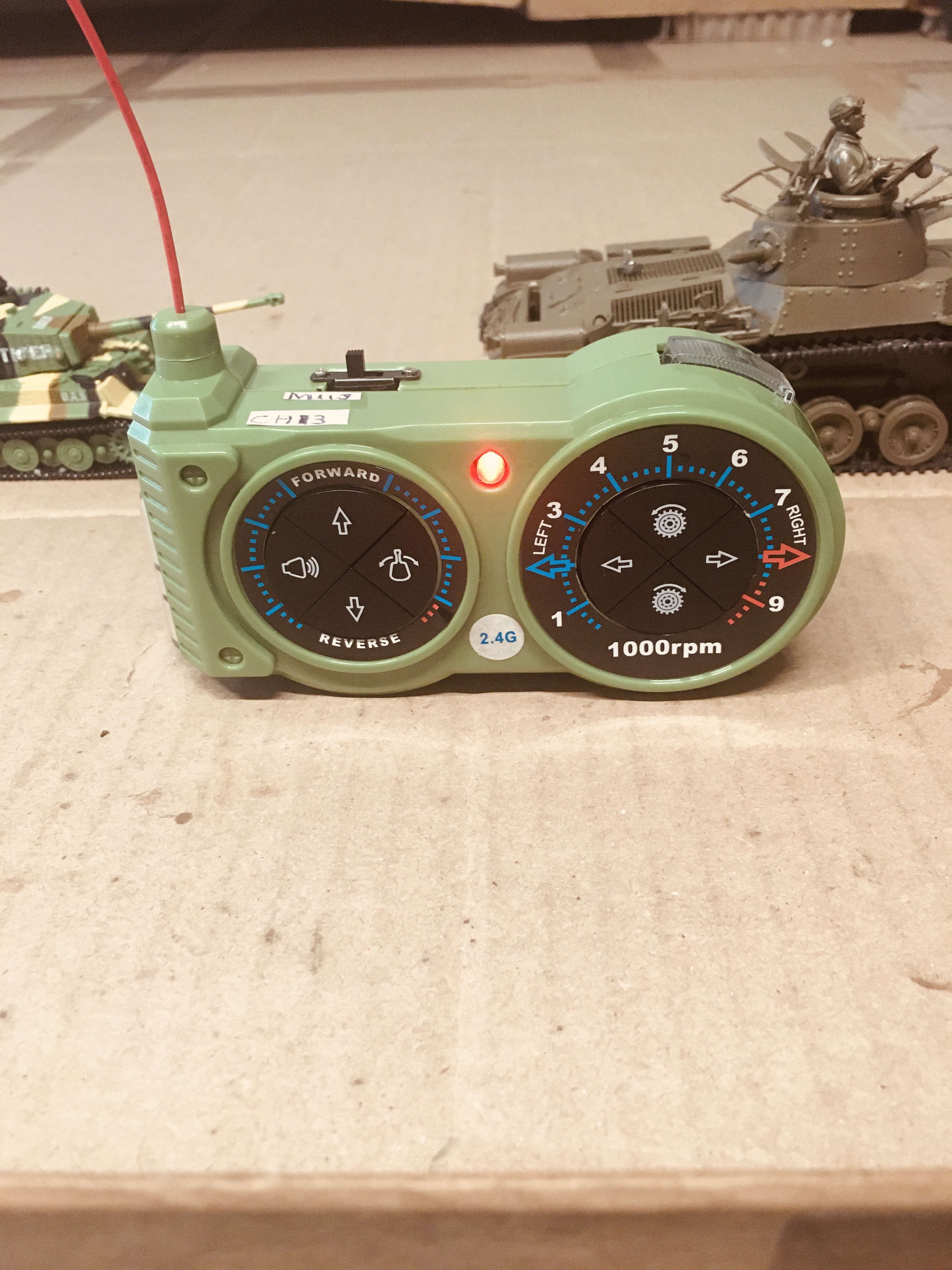

I added a topside micro SPDT switch to the TX to enable constant Forward speed to be switched on\off. Works in parallel with the Forward push button control on the TX. Once switched to forward, the low\high button can be used. A momentary push switches the low\high speed.
I also added a bottom side micro SPDT switch for on\off of the TX AA batteries. The AA batteries will be depleted if the TX sits arounds for extended periods.
I added a 1/4 watt 2.7K ohm resistor to the CHARGE LED so that the LED is on when the on\off switch is on.
I extended the 2.4G Antenna with a 5'' piece of stranded wire with heavy insulation coating to extend the TX range. Not really needed for small model operation but just wanted to see how much range would be improved.
Lipo Charge in progress LED connected to on\off switch via 2.7 K resistor.
on\off slide switch saves the AA batteries from storage depletion.
Forward slide switch added to enable hands off forward speed.
